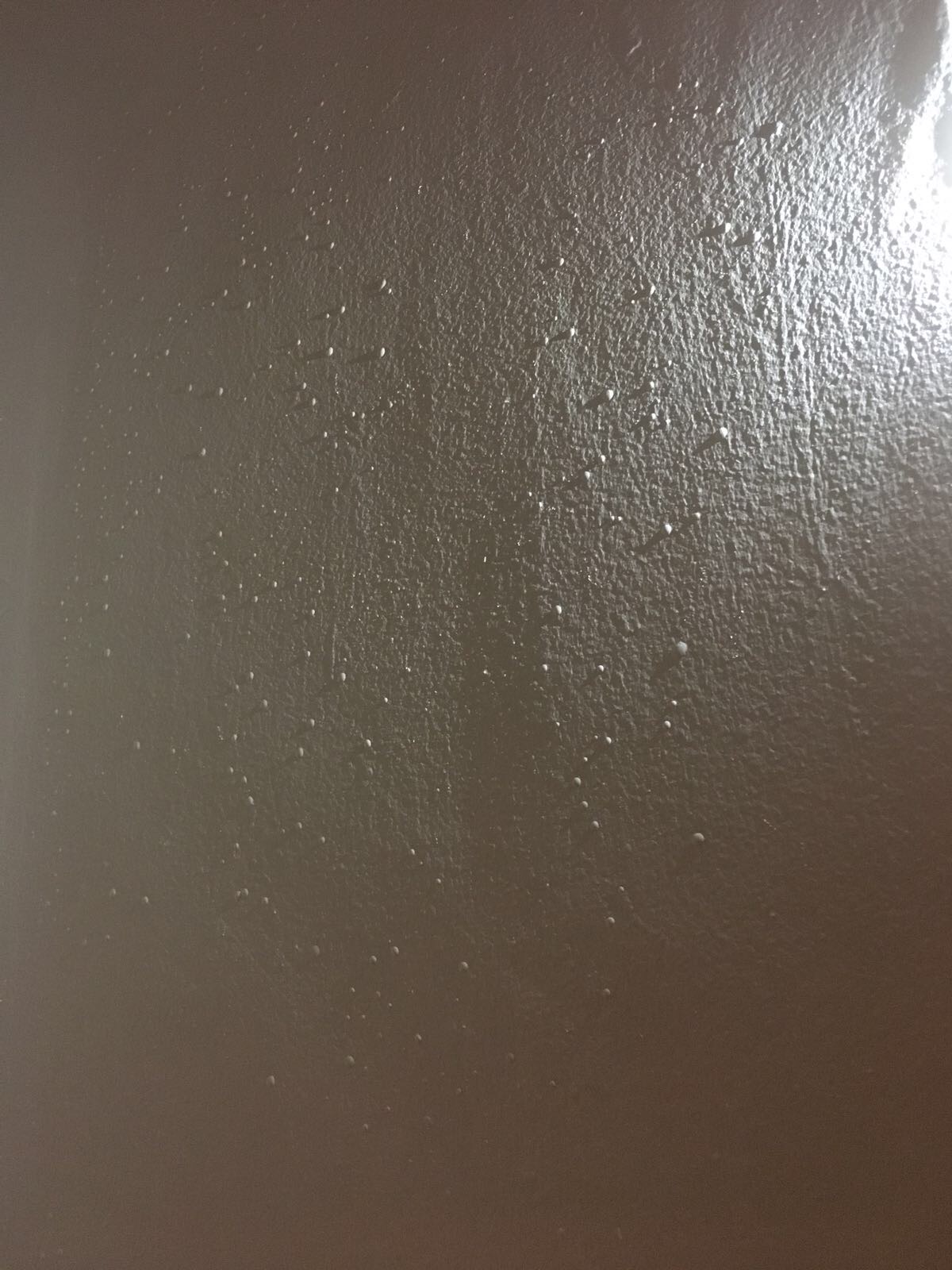

  1. Thanks for your thoughts @Nickfromwales . I asked contractor about sanding beforehand as you suggested, but he said he's never removed paint before. On previous jobs he's used pva and plaster to cover painted walls and so far no issues, as a pva creates a barrier. With our problematic wall though, and this is in the shower room, will not sanding the wall down cause an issue later?
  2. Hi again, would this solution work -- pva coat, replaster and then repaint. Would there be any problems adding more layers on top of this wall that is currently bubbling after showers?
  3. Ah right. I didn't know they were supposed to soap and scrub the old painted part clean first. This definitely didn't happen because they applied primer straightaway on their first visit. To remedy bubbles appearing after showers, is the "u/s coat" you mention this current layer of paint? As in they'd have to scrap this layer (and the bottom old layer?) off? Then scrub it, wait a day to dry, and apply primer. Wait, and then new coat of paint? Painter suggests coming to have a look at the bubbling wall later (which means we turn on the shower to steam up the room for bubbles to appear), he'll take a look, then he'll prime and paint it, all later today. Presumably, with no waiting time in between, this issue won't actually be resolved? Thanks in advance.
  4. Thanks all for your replies. The painter that did our walls just gotten back to me -- he said it was probably the new paint reacting with the old paint on that particular part of the wall. It looks like we might have to pay extra to get this sorted. The walls were not scrubbed with soap, nor was the shower room used for at least a week before painter came previously, so trapped moisture shouldn't be an issue. Our contractor claims he has never encountered this problem before. Can I check -- was he supposed to have sanded down the old paint prior to painting as a preventive measure against blistering? Or do anything else to the part that was painted previously? Any advice gratefully received, thanks in advance.
  5. Hi @Nickfromwales, thanks for the reply. The plaster was given the full weekend to dry (Sat and Sun). I don't know what paint was used, but thinking back, I wonder if the plasterer didn't plaster over that section of the wall because that one happened to already have paint on it. So then when the painter came, he just painted over that old paint plus the other newly plastered walls. There is a slight different in colour between that section and the rest, so either that was the case, or a different paint was used. Do newly plastered walls and old painted walls require different primers?
  6. Hi all, We got our bathroom redone a couple of months ago, and the walls were replastered and repainted. Just recently, bubbles have started appearing just on one section of the walls. They only appear after showers, and when the bathroom has cooled down the bubbles disappear. Our contractor is insisting that he's never seen this problem before, and that he had paid for quality bathroom paint for the painter. Can anyone advise what could have caused it? Wrong paint / primer / waiting times not sufficient? I attach a photo below, I hope it's clear enough. Many thanks in advance.

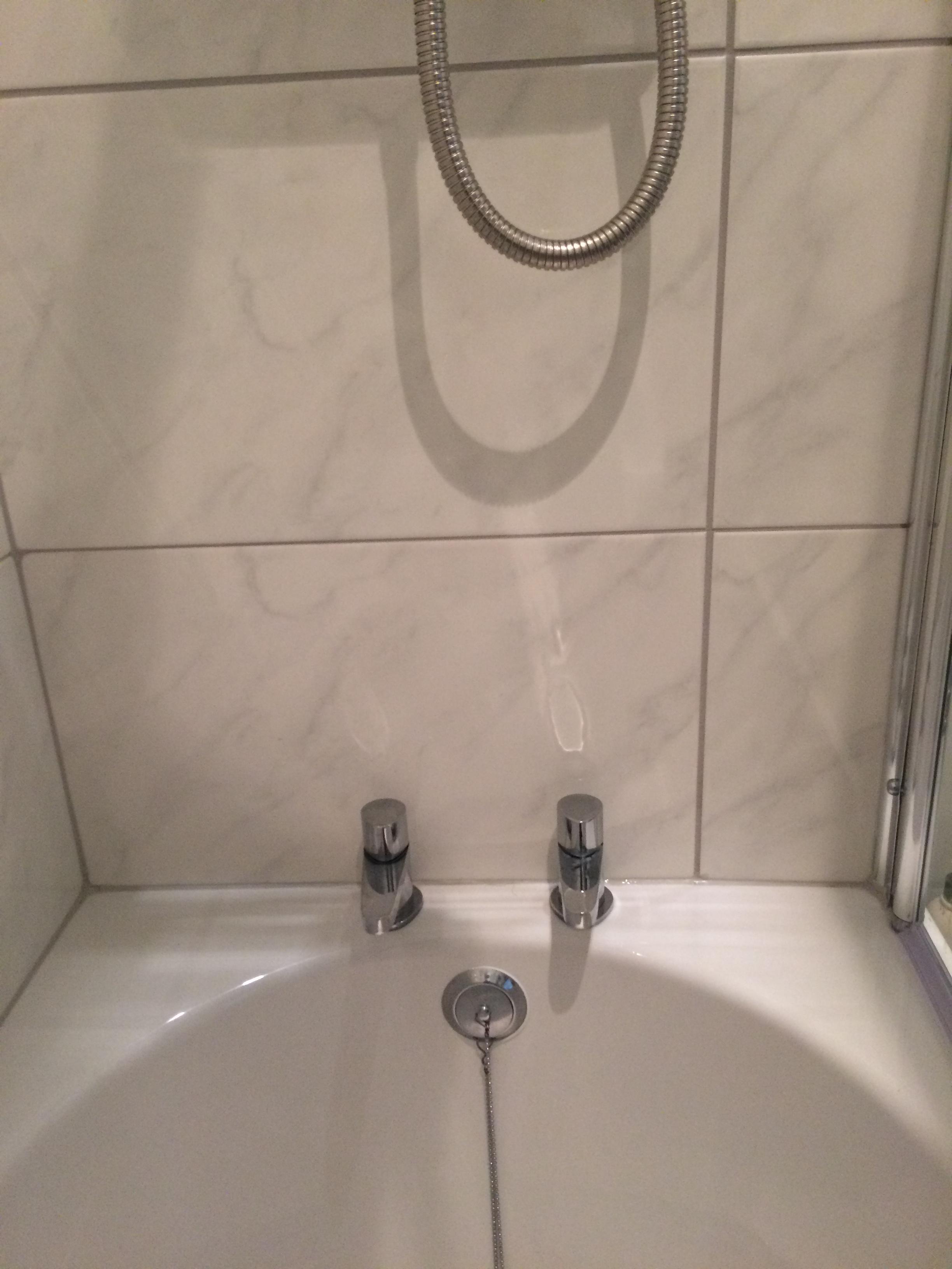

  9. Thanks very very much for the helpful input. @Nickfromwales Thanks for your advice. I've emailed Victoria Plum, informing them of the dipping and distorting of bath. I had a look for Trojan baths on their website, but they don't stock any so I've requested for a refund. If that doesn't work then I'll have to settle for credit but buy the bath elsewhere! About bath installation: 1. Our bath is about 3-4mm thick acrylic. The contractor assured us it's secure because it's attached to wall by brackets. (I note you say you usually reinforce with a wall mounted batten). The fitter (different guy from contractor) confirmed that it's not even secured with brackets, but just with legs, and double seal at the wall. Is this normal? Surely the sealant at wall is not a strong and durable enough reinforcement? 2. When these issues finally gets sorted and we get a new bath, I can only request strongly it be fitted with a wall mounted batten. But the fitter can insist that's not necessary -- legs and sealant will hold it up, then I'll be back at square one. Do they have to comply with the customer's request? Currently fitter is adamant all the problems are due to quality of the materials we ordered, and there's nothing he will do to further reinforce the bath (aside from the piece of CLS timber). @JSHarris Ack, sounds like you've had quite some issues with your bath items too. So many contractors that came to our place to quote for redoing our bathroom suggested Victoria Plum, so I just went ahead and ordered from there... should have done more research beforehand.

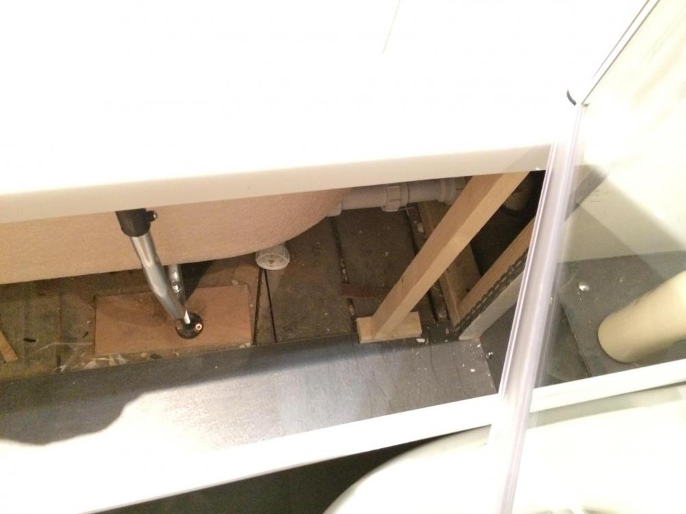

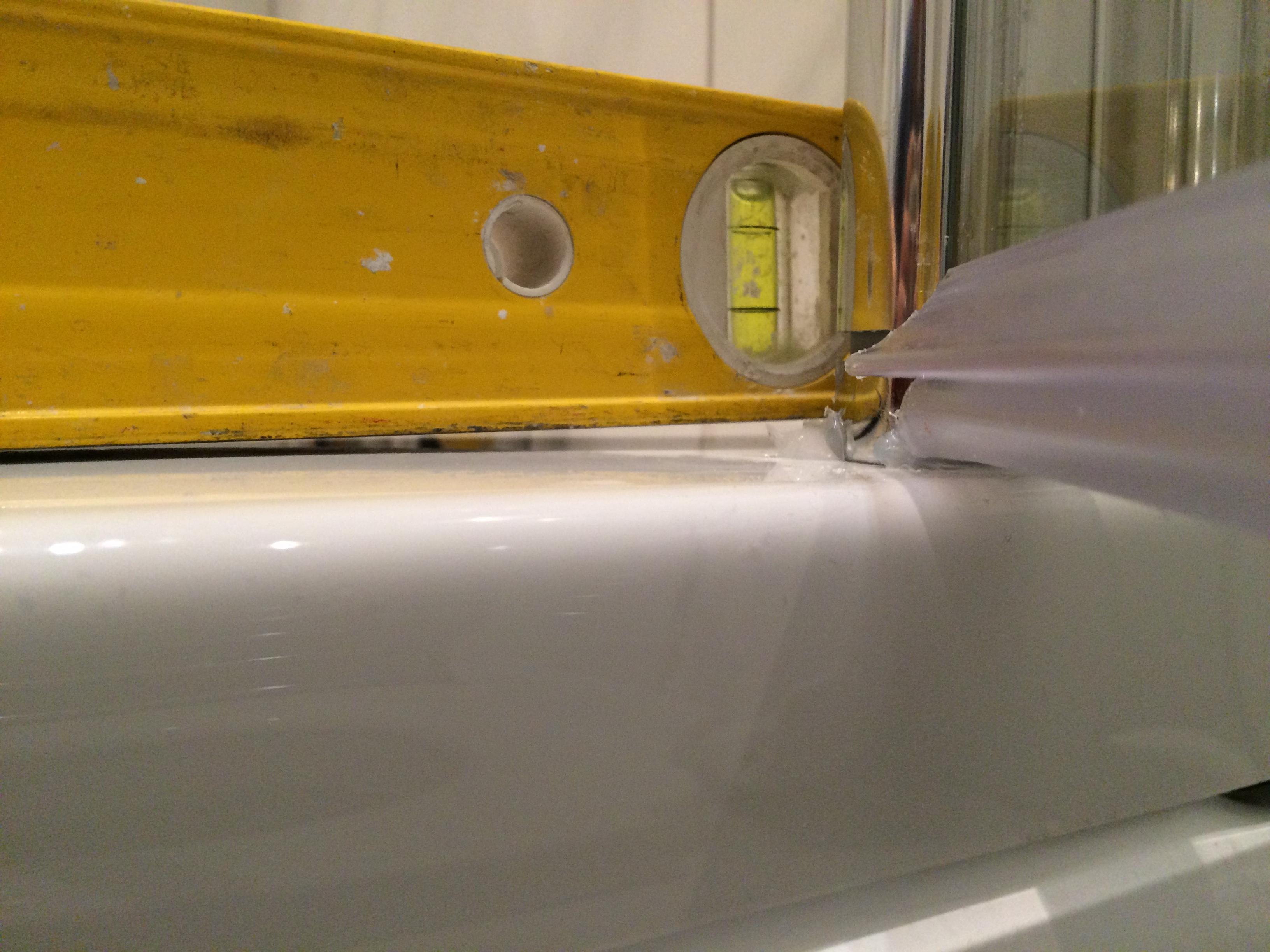

  10. So it turns out the corner is dipping about 2mm. We currently have a wooden batten wedged underneath (pic below), and then fitter said he will change this for a piece of CLS timber. I asked for some plywood on the underside of that corner for the CLS timber to be wedged up against as you @Nickfromwales suggested, but the fitter is confident that the acrylic will not crack. In regards to your earlier question, there is no timber both in the width and lengthwise of the bath. The fitter said because the bath is so flimsy (he reckons it's about 3-4mm thick), the corner where it is dipping is probably due to the weight of the bath screen. That outer corner also has a bulge (pic below) which is rather unsettling. We asked whether the other corners of the bath will move over time if we wedge up the offending corner. The other corners are not actually held to the wall by brackets, but just by a double seal. Again, he assured us they wouldn't. I seem to be getting contradictory answers, like -- the bath is so thin and flimsy, that it is dipping and bulging. On the other hand, it is not so flimsy that it will crack or move over time, nor does it need further support at the corners..... I am not convinced just one piece of CLS timber will solve this issue. Some questions: 1. To prop up with CLS timber, the fitter only needs to remove the 1 and 1/2 tiles above that side of the bath (pic below) and not the whole bottom row of tiles on all sides? 2. The other corners of the bath are held to the wall by a double seal. Are they really not going to move? 3. Should we change to a 6mm thick acrylic bath? Regarding #3 the bath: the fitter is convinced that the problem is the quality of bath -- either because it is so thin, or it has a manufacturing defect (which he said would be a hassle to get VP to exchange). We bought this bath on the advice of the contractor, we asked him about the quality and durability of the bath, and he repeatedly assured us that this bath wouldn't give any problems. Had he advised us to pay slightly more for a thicker acrylic bath, we would gladly have done so! Can we tell the contractor and insist -- the bath is unsuitable, and we will pay the difference for a sturdier bath? It will definitely be difficult to get him to agree, as who then would be responsible to pay for the workmanship? And if we strip off the whole bottom row of tiles to change the bath, there's no telling how the plasterboard behind will hold up. But we certainly don't want the headache of having more problems with the bath in the near future! Advice is much, much needed. Thanks in advance.

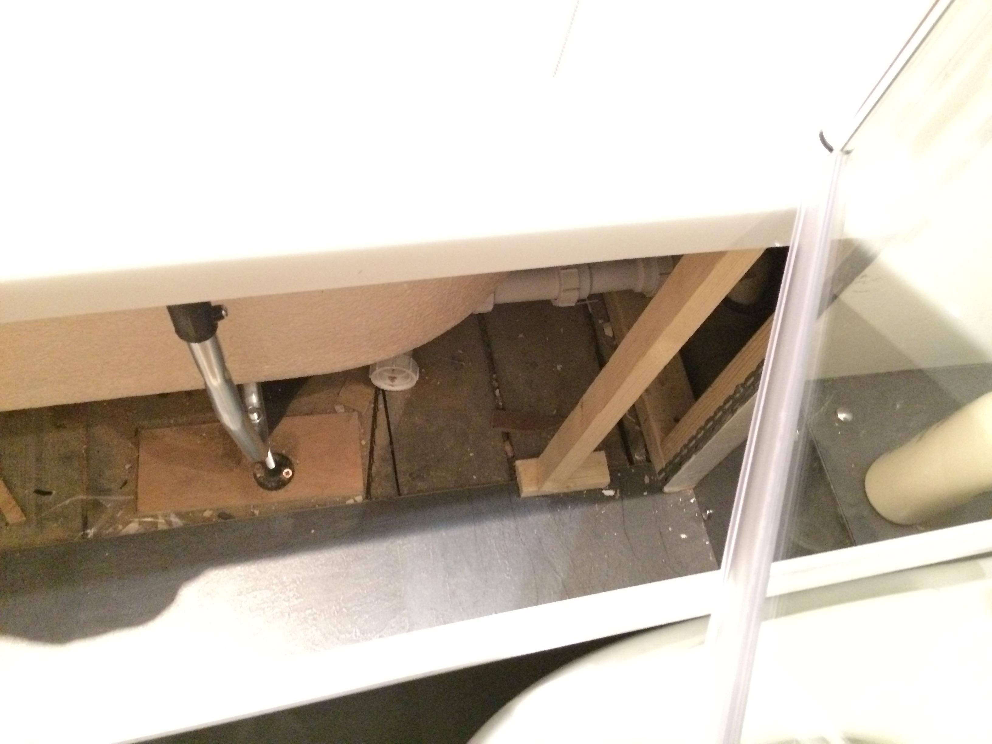

  12. There was no timber that came with the bath, but I'm not sure whether the fitter built one. He's coming within the hour, so I'll take pictures when he removes the bath panel.
  13. There is a frame higher up for the shower (bulkhead?), but not below to support the bath where the bath taps are. I've been told on the other sides where the bath meets the wall, the bath is secured to the wall with brackets. There isn't a frame supporting the bath on the outside, behind the bath panel. Should I ask for one there, to prevent further flexing of the bath?

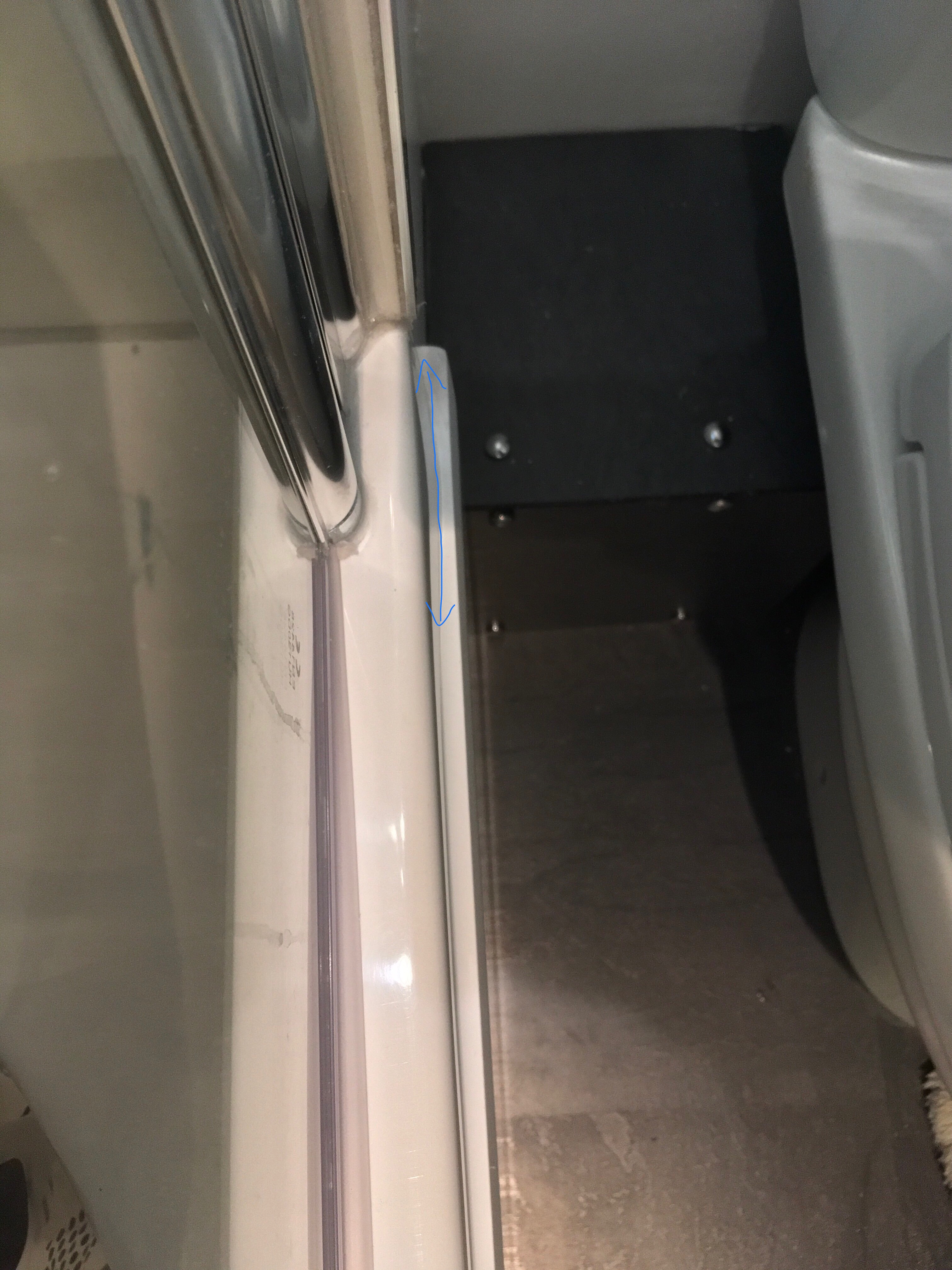

  14. Thanks @Triassicand @AliG, the contractor brought a different bottom seal for our screen, and with a U shape channel too, which really helps stop the leak. @Nickfromwales A wooden batten is currently used under the offending corner of the acrylic bath, haha. I'll check with the bathroom fitter that this is only a temporary measure in use till he makes the time to come back to complete the work, and perhaps to use plywood as you suggested. The old bath in this place had a wooden frame propping it up under the outer side (length wise), i wonder whether are frames used for steel baths and not acrylic ones because of how much heavier steel baths are? Our acrylic bath has brackets holding it in place at the walls, and no frames on the outer side. many thanks for all your advice.
  15. Pools and stays there in the corner.
