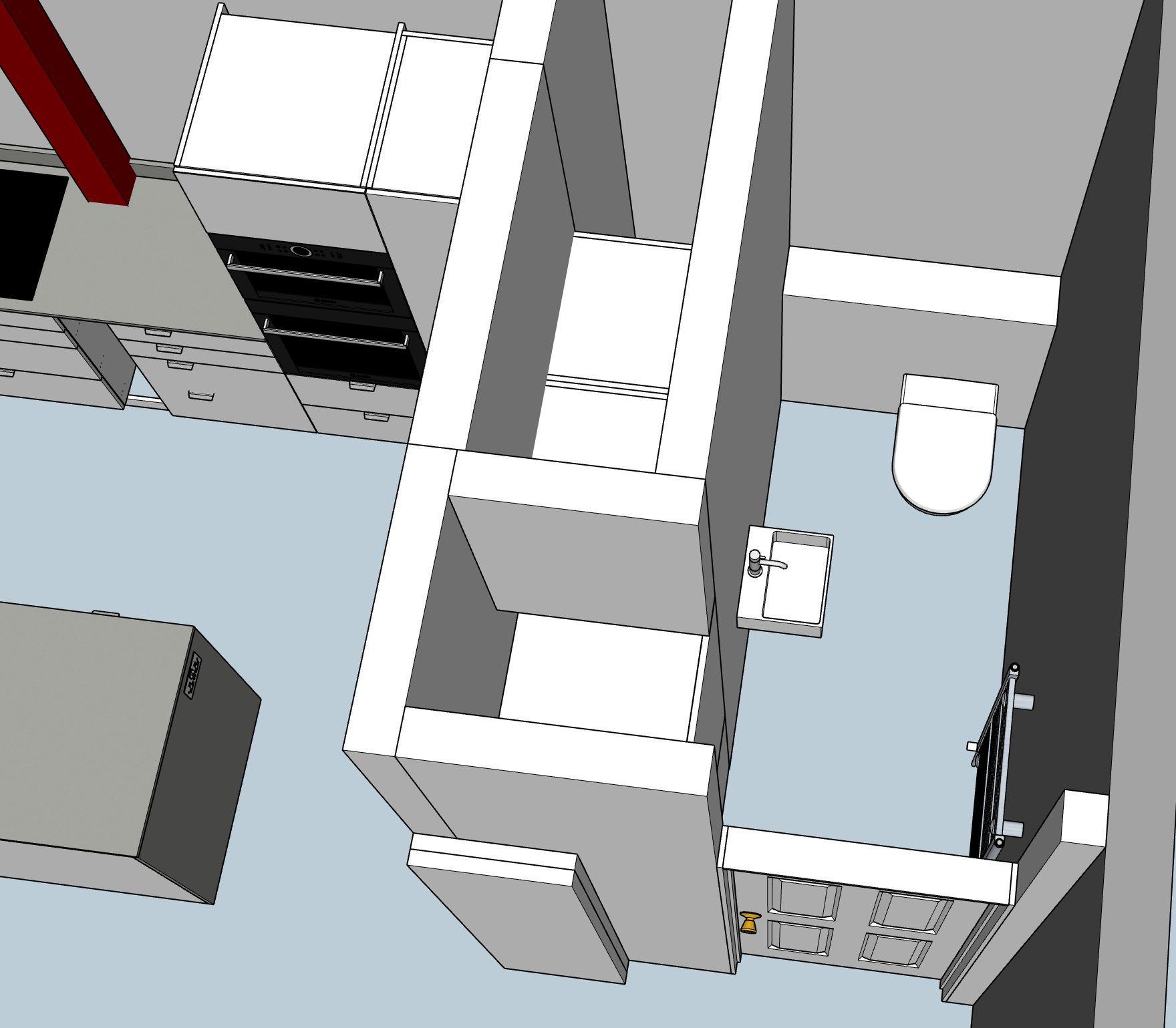

I believe the flue will work. Please see the below image. The flue is brought outside to a lightwell just past the red beam, this would be classed as outside air. The total length of the flue is 4m and it can be hidden as the ceiling in that part of the house is 2.8m high where as in the extension the ceiling will be around 2.4m high. I can fit two 300 x 300 flue inspection hatches along the top of the boxed in flue which should satisfy gas safety requirements. The below ground drainage for the WC and kitchen sink will be included in the final plans. So if both of your issues are resolved you have no other issues with the peninsula. -

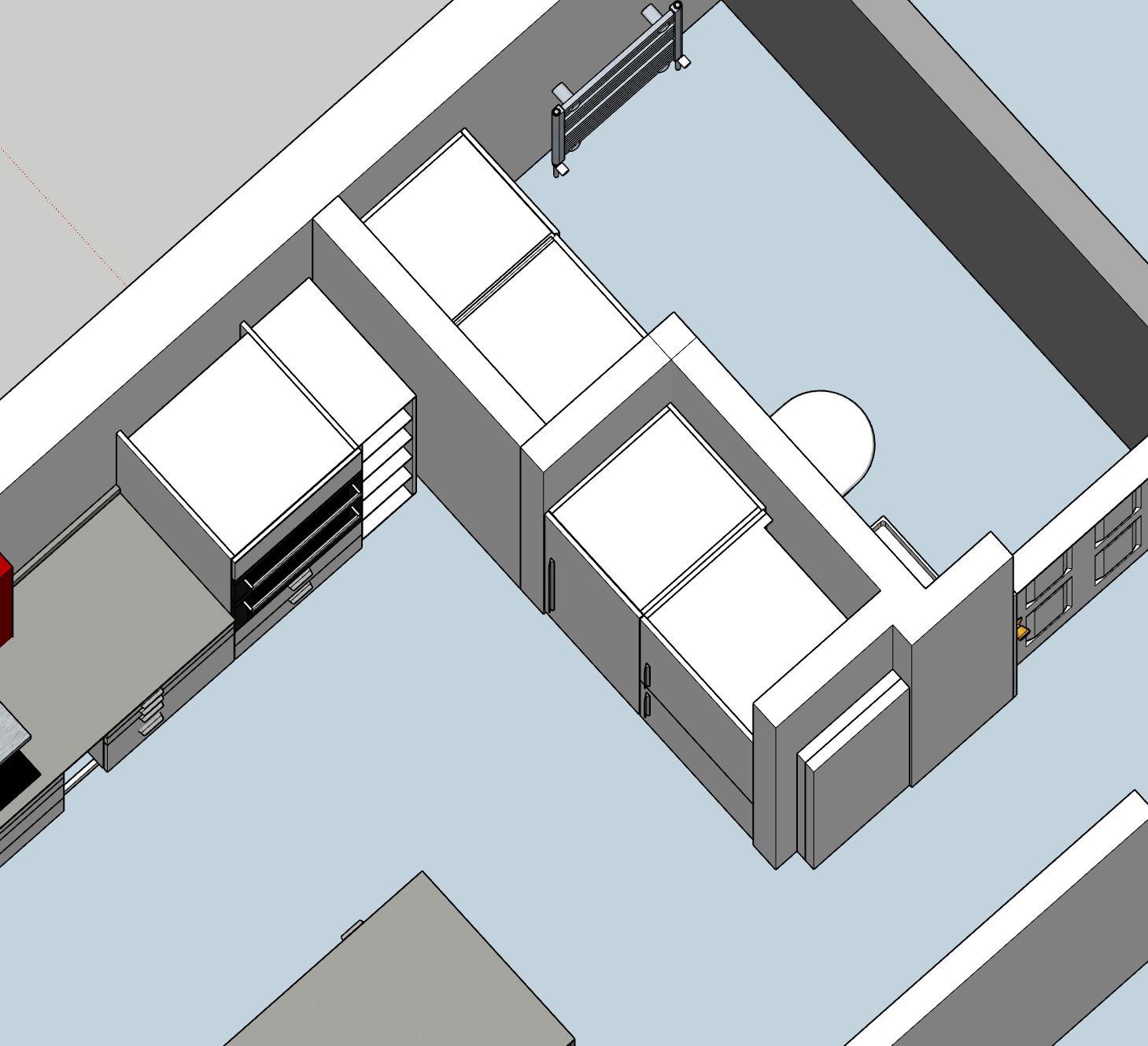

I really want the living at the back too. The views are nice out the back. I have decided to ditch the kitchen island and make it a kitchen peninsula. I do not know if this is cheating or not. This gives me 1100 wide between the two kitchen worktops. The pinch point is 880. The door for the understairs storage has 923 to the back of the peninsula. The laundry is behind the stairs inside a cupboard with two doors. This can be seen on the third image. I could make the peninsula 650 wide to give even more space at the pinch point. Would apricate peoples thoughts. -

I have decided on a ground floor layout and was wanting peoples thoughts on it. I will place the gas boiler along with the consumer unit in the downstairs toilet. I assume this will be ok regarding building regulations. I will place the washing machine & drier in a cabinet in the kitchens behind the stairs. This can be seen directly behind the kitchen island sink in the images. The hallway into the kitchen and downstairs toilet will be 900mm wide. When the door is open I do not have enough space to rest it against a wall. If I place it on the left hand side it will protrude into the bathroom door and on the right it will protrude onto the beginning of the stairs. My solution to this is to use either a fr30 bifold door or my preferred option a folding pocket wall door such as https://www.scrigno.co.uk/product/frames-for-sliding-doors-applauso-p20. I assume the scrigno pocket door meets fire building regulations. I am knocking down a load bearing wall so I have to place a support beam in to support the upper floors. To the side of the steal beam there is a wall that juts out 91mm so I was thinking of just plastering the bridge between the two walls. This does mean I lose 61mm of space in the kitchen. I have made the space between the kitchen and island 1050 but I could afford to make the 800 island 750 to allow 1100mm space. My one concern is between the island to the support beam is only 768 wide, is this wide enough? It does means the passageway is far narrower than the kitchen passageway. I can afford the island to be 300mm shorter at the top so this would reduce the narrow corridor from 1000 long to 700. I will have 45mm of space beside the hinge side of each of my 400mm kitchen cabinets. Will this be enough clearance to allow drawers to fully extend from the cabinets, I intend to use blum zero protrusion 155 hinges. On the above two images you will see the wasted space behind the two corner cabinets. I intend to leave the chimney breast in place knocking down 554mm of it as seen in red. This makes me feel less guilty about leaving that wasted space as to knock down the whole chimney breast would cost extra money. Would love to hear peoples thoughts on my plan.

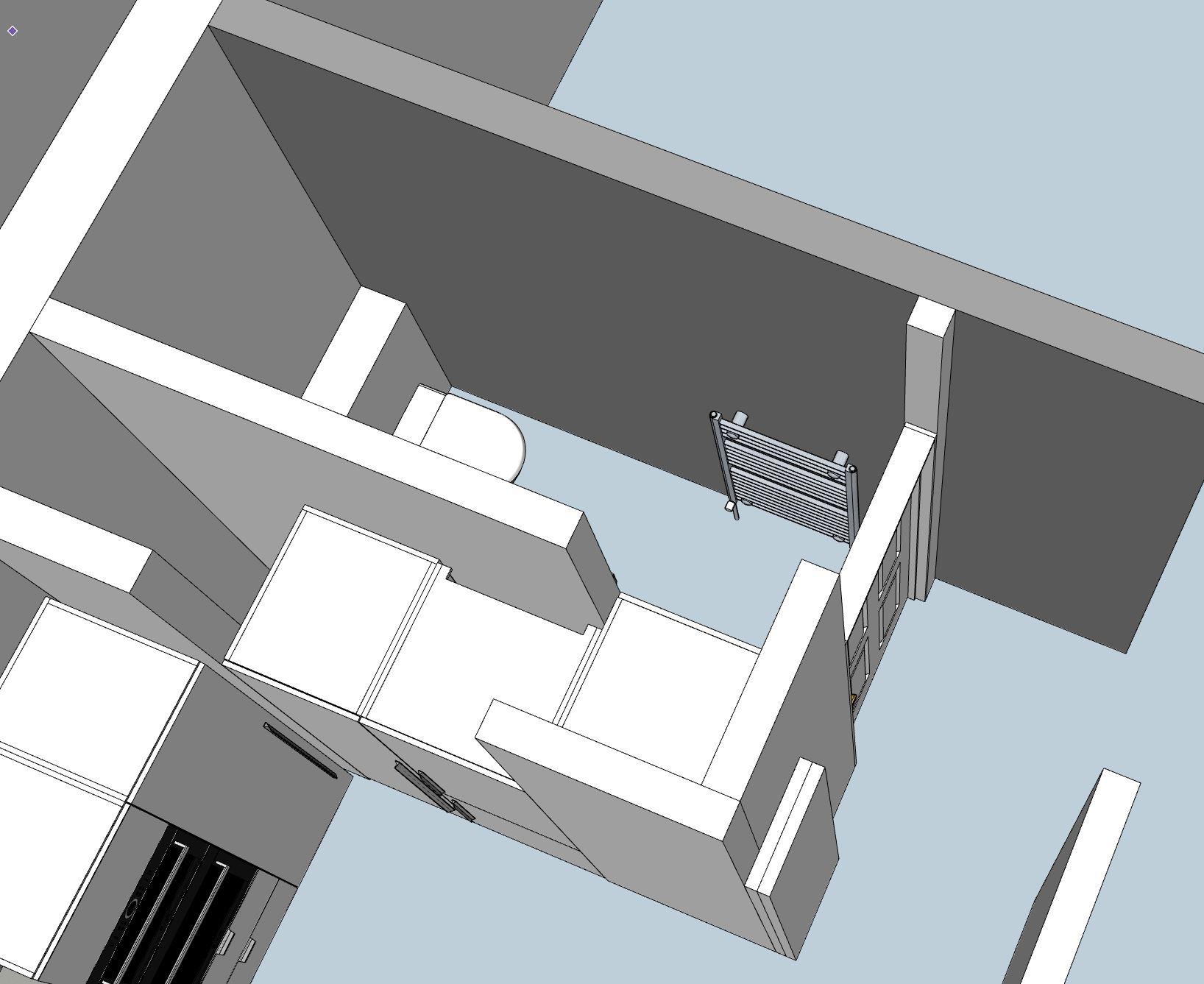

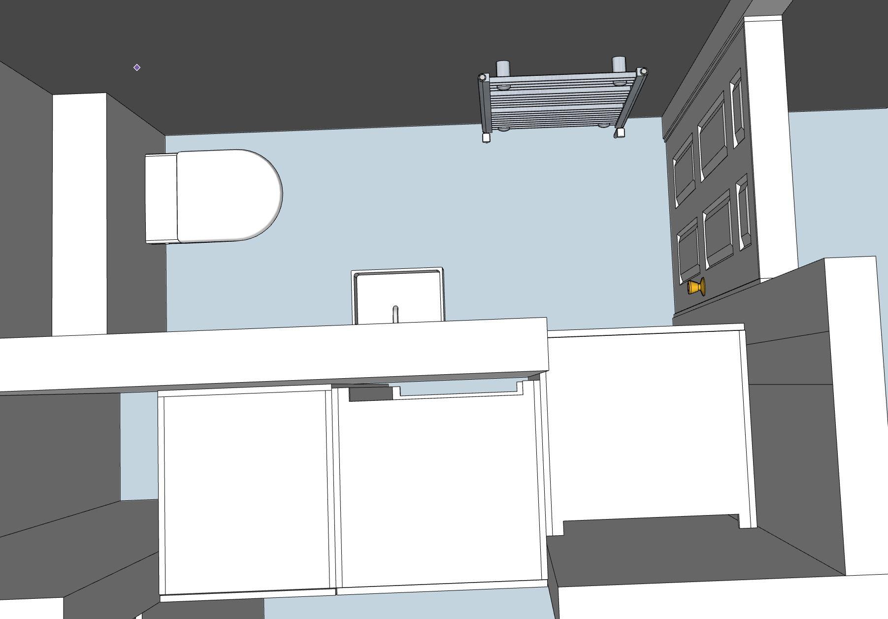

This is another option for the downstairs toilet, it involves moving the washing machine and gas boiler along the party wall inside the downstairs toilet. It would allow proper sound insulation and give ample room to work around the washing machine. The downstairs toilet is 1200mm at its narrowest point. The toilet goes into a stud wall giving a front projection of 650mm. The sink is next to the toilet. The aspect of this design I hate is there is only 1030mm from the front of the fridge/freezer to the island which I feel the island might get in the way. The other option gives much more room around the island and would even allow me to extend its size by 200mm

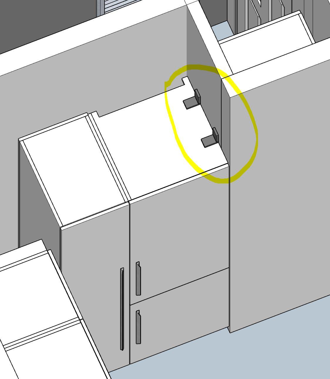

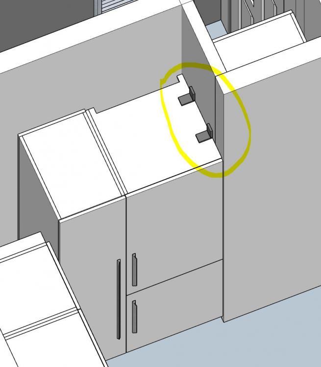

I am yet to build anything but In my quest to fit in as much cabinetry into my future kitchen as possible I am contemplating the idea of not building part of a cavity wall between a downstairs toilet and the kitchen. The two rooms would still be technically sealed. The weak point of the seal would be two 18mm pieces of wood of the cabinetry of a washing machine in the downstairs toilet and the fridge/freezer in the kitchen butt up against each other. Above the cabinetry would be sealed by joining the two cavity walls at the top. Are there any products which would be 40mm thin where I can seal the two rooms from each other rather than having to relay on the cabinetry. Cheers
