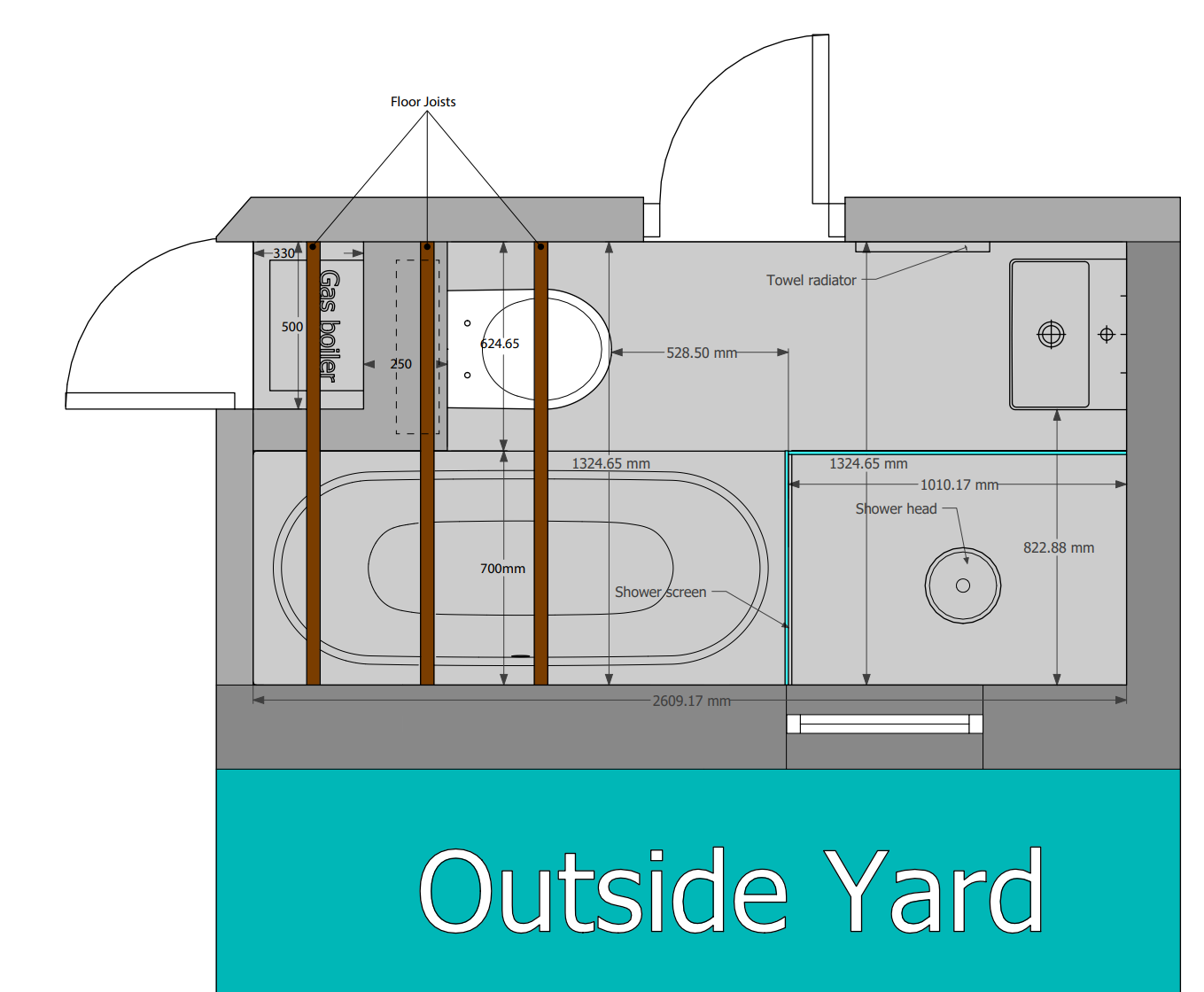

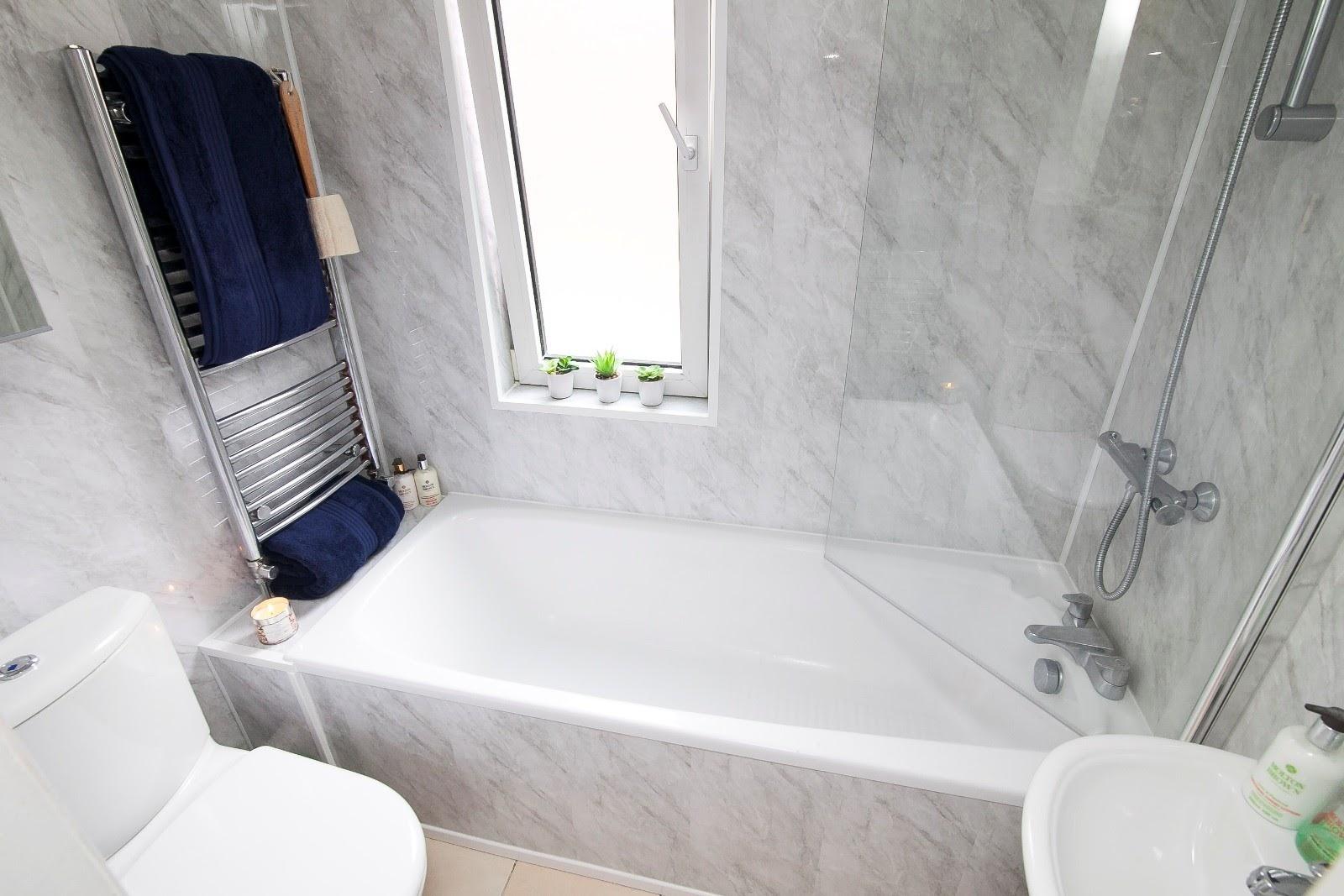

  3. The photo I shared of a neighbours property has exactly the same issue with the toilet next to the bath. He is 6 foot 6 and seems to have no issues using the toilet. One thing to point out is that he is slim build. If the toilet was against two walls it would certainty be an issue I agree but having the low bath helps I feel. From research it seems, The space around the toilet should be at least 760mm, with at least 510mm in front. My space around the toilet falls short by 135mm. I do agree with you knee space is cramped.
  4. No room to move any walls unfortunately. I am struggling to see where it would be cramped at. With the shower screens folded away there should be ample room. The toilet beside the bath is not so bad as your arms are higher than the bath.
  5. This is a neighbours bathroom. They still have the tightness issue with the sink and toilet being so close to the bath. I have a slightly longer bathroom as I am making the cupboard for the gas smaller than theirs.

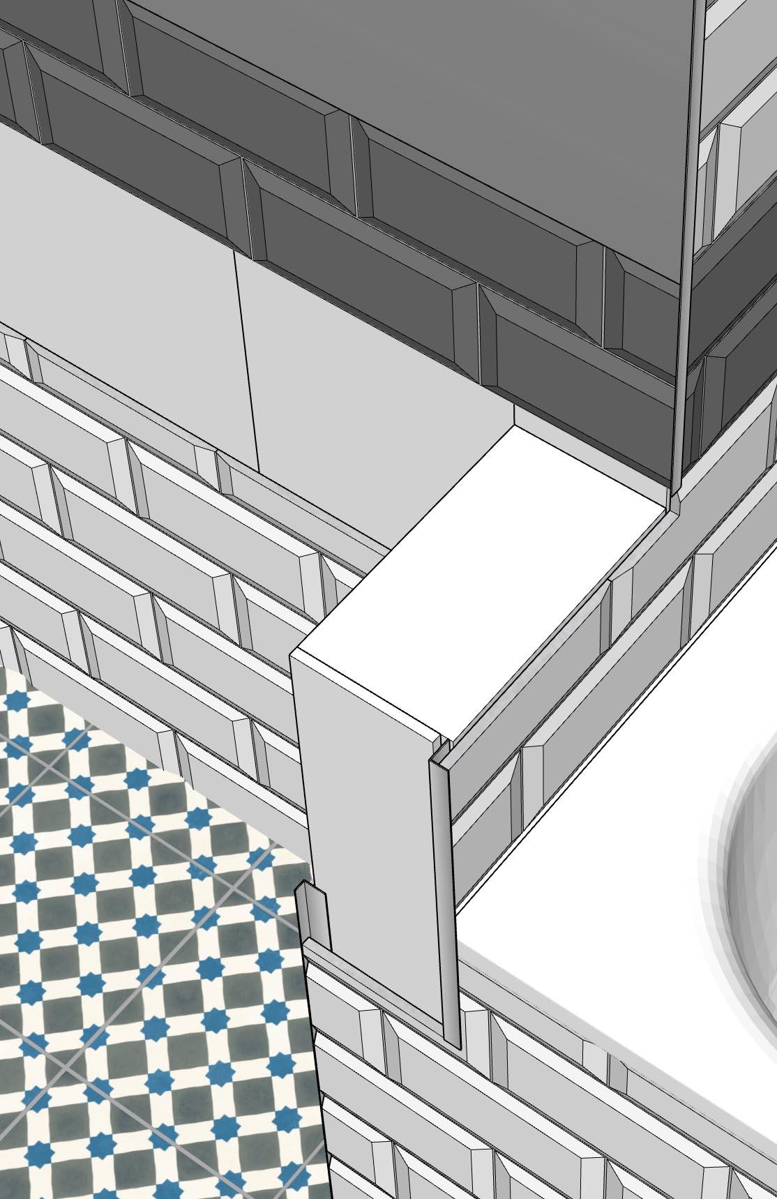

  7. I have managed to squeeze a 1600 x 700mm bath and 1000 x 700mm shower side by side in this extremely small bathroom. I want the shower tray to be flush to the floor so was looking at a bettefloor shower tray. My main issue is I can not make this a wet room due to the proximity of the bathroom door which would get damaged by water splashing. To prevent water splashing when taking a shower I would have a glass panel over the bath and a bifold shower door. The shower door would rest along the back wall making the shower totally open allowing easier access to the sink. You can see the bottom two images are the type of door I am after however this particular door seems to need a bottom rail which is not what I want. I want the threshold between the shower tray and the floor to be seamless to allow your foot to not be impeded while standing at the sink. I understand there would be a small gap between the shower door and floor but I was thinking of fitting a rubber bottom to the glass which would seal the gap and I could slide with the door into the wall. Will my idea work?

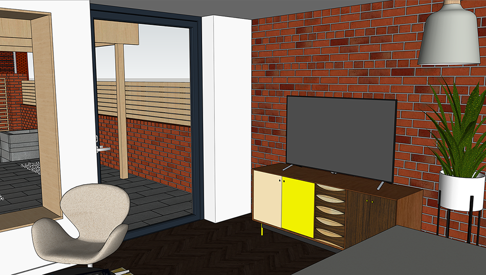

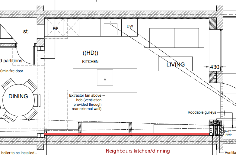

  9. Currently the exposed brick wall is in a yard. I will not know about any sound issues until I build the extension. I did speak to a neighbour who has a similar setup and they did not complain about sound issues except for hearing plug sockets being turned on and off.
  10. I am about to start on a yard in fill extension on the ground floor on a mid terrace house. On the ground floor I want to leave the party wall red brick exposed inside my kitchen/dinning area. The brick work of the wall is made from Belfast red brick and it is of solid wall construction. The wall has headers running through it every 3 bricks high and from these I assume the wall is approx. 250mm thick. On the neighbours side of the wall is their kitchen/dinning area and to reduce noise travelling between the two properties my quantity surveyor has suggested that I should fit sound insulation along the party wall and use brick slips to recreate the exposed red brick wall. I would like to know what other people in my situation would do? Would you go to the extra expense to fit sound insulation and then fit brick slips on top and accept at 100mm loss of space internally? Please see image of the proposed insulation below. One good thing is having the brick slips would create a flush join with the plastered pillar but I am losing access to the internal pipework which I would have to move up 90mm. Many thanks

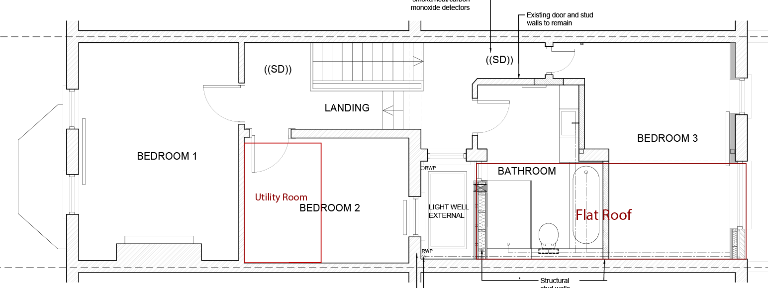

  12. Does anyone have any answers to the suggestion of putting the ASHP on the flat roof and my idea of having the ladder access through the landing window.
  13. Will day to day running costs with the Hitachi Yutaki-M ASHP and Sunamp for hot water will be roughly the same as the Combi Gas boiler?
  14. Do you mean a shed to house the hot water tank , under floor manifolds etc? Would that be even practical. The only place I can fit a shed would be at the very bottom of the garden as marked on the first image.
  15. Would that not be expensive to run, i.e. I want to run a bath surely its just like boiling a massive kettle? £10 to have a bath?
  16. I am in Northern Ireland and there are only two MCS registered installers. The other one I have not contacted as they did not get good reviews. Thinking about access to the ASHP could I not allow access through the landing window. (I have put an arrow to show which window). So you would open the landing window then walk on the glass light well window to a ladder fixed to the bathroom wall?
  17. There is a flat roof upstairs which the ASHP could be mounted on. I saw one other post on here where someone did that. The ASHP fitter refuses to fit it on the flat roof though.
  18. Yes I have space under my stairs. This is a house for life so I will be living in it for the next 40 years at least. In your opinion will I have to rip out any Gas boiler I would be fitting within that 40 year time frame? My theory is yes I will have to rip it out and replace it with ASHP within my life time. So my thought was to get it over with now rather than worry about it down the line.
  19. Thank you Conor, If I get the monoblock system will the hot water tank, buffer tank, pipe work, and underfloor heating manifolds all fit inside my utility room ok? please see the drawings. The drawings show a gas boiler which does fit ok. The utility room is 1500 wide.

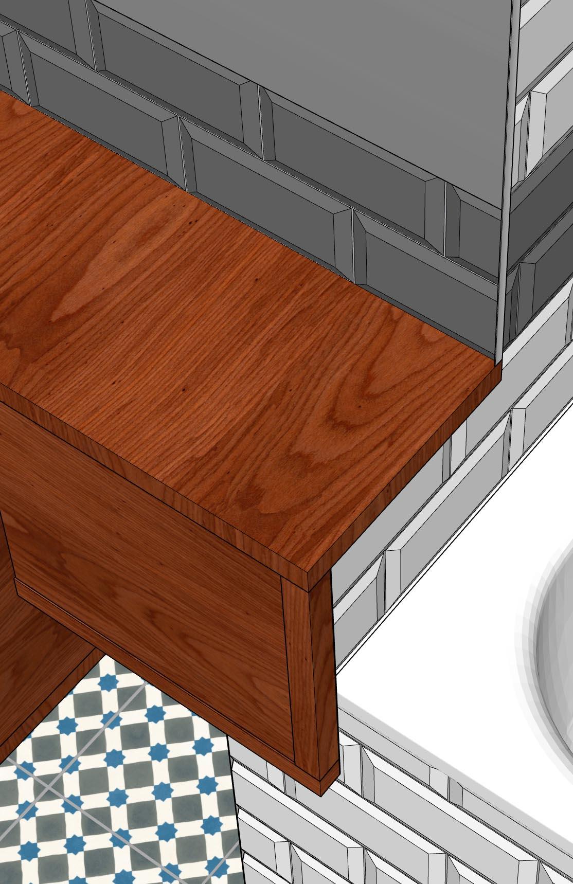

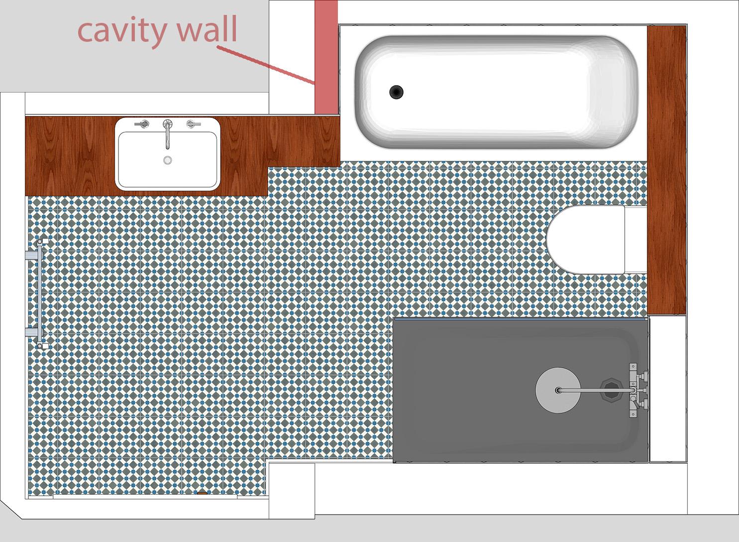

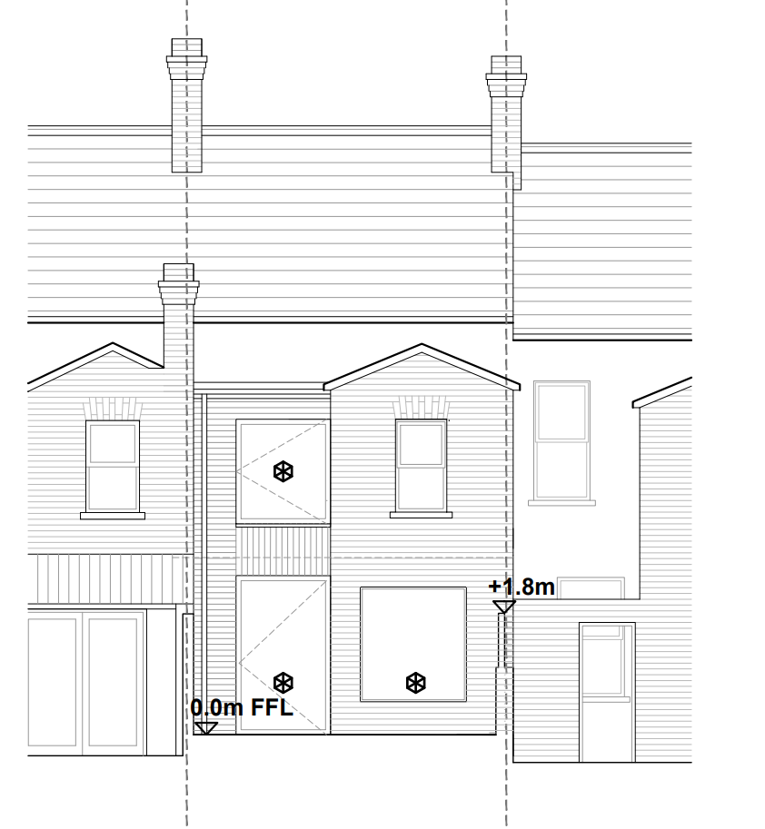

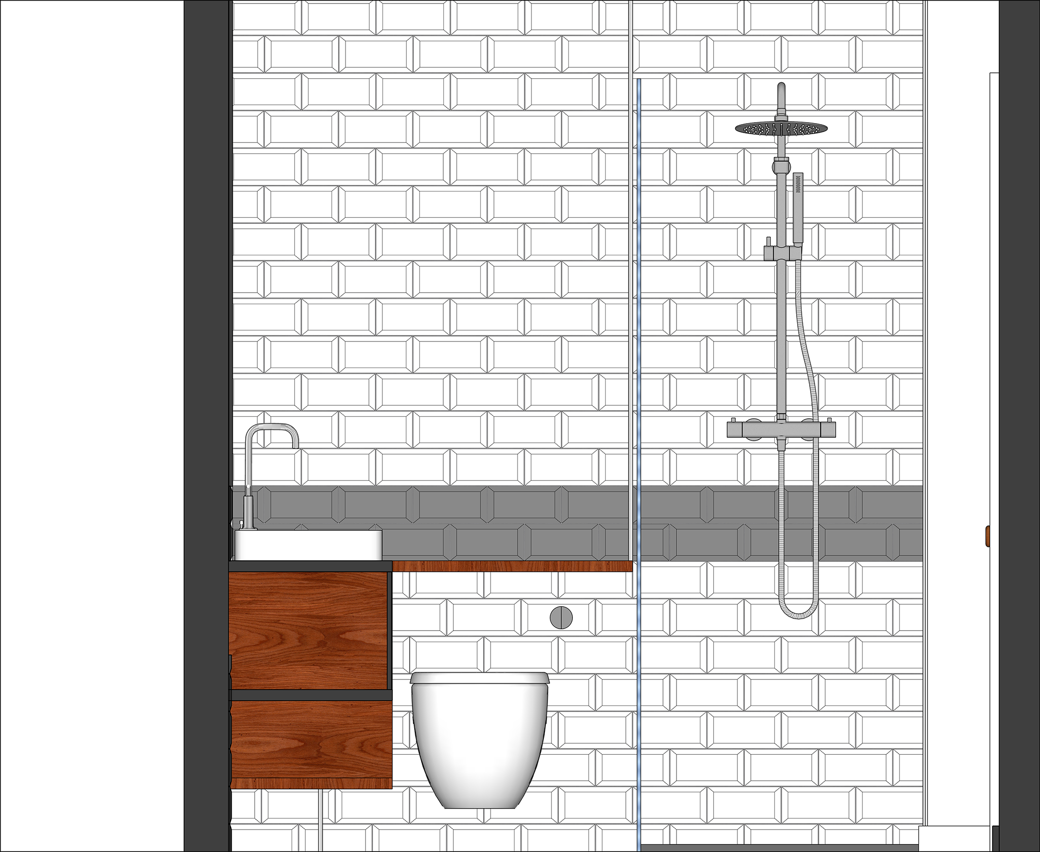

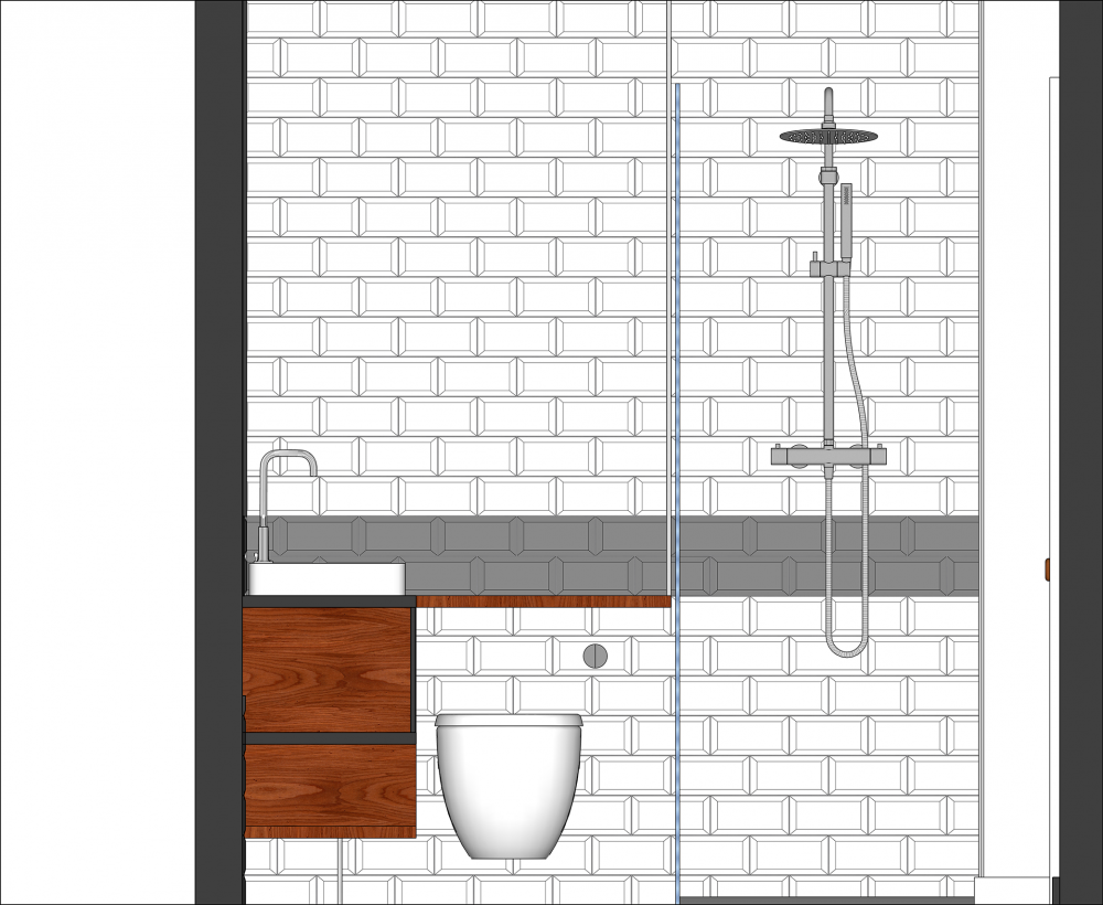

  21. Hi folks I would appreciate peoples thoughts on my upstairs bathroom layout. I will not be having bath taps but instead will buy a bath overflow filler. The bath will be 1700mm long 750mm wide. If I am laying in the bath facing the sink should I place the overflow filler on the opposite side? I have a cavity wall to allow me to fit the bath in and to make the vanity unit longer. I am restricted in the depth of the wall unit where the toilet is hung as I do not want to make the tall bathroom window narrower. Should I remove the cavity wall and make the bath 100mm longer and make up the gap from the stud wall on the opposite side even if it means I have to make the tall window 30mm narrower? What are peoples thoughts on my vanity unit? The sink pipe work would be hidden behind a sliding door on the left hand side. Directly next to have is open storage with a glass shelf. The issue I have is I need to find a sink with an off centre plug hole are these easy enough to find? The toilet shelf will be 790mm high so this means I will need a small wall hung frame. This frame would be short enough I assume. https://www.victorianplumbing.co.uk/bauhaus-low-height-wall-hung-wc-support-frame?gclid=CjwKCAjwi_b3BRAGEiwAemPNU0knLBdTR9e53d9TeZRqZfqE84B5GL_DkzAsnrJ550v2TrFlzjDZfBoCTHgQAvD_BwE&gclsrc=aw.ds Ignore the shower on this image as I will probably opt for an inbuilt shower to keep it clean. Should I use the extra space to stick the shower niche behind the shower instead of building an extra window for the shower niche? I could put the shower controls next to the window. How the vanity unit interacts with the bath is crucial. I have tried my best to make it so that water can't touch the vanity unit but maybe tiles laid on wood looks messy? Many thanks for your thoughts.

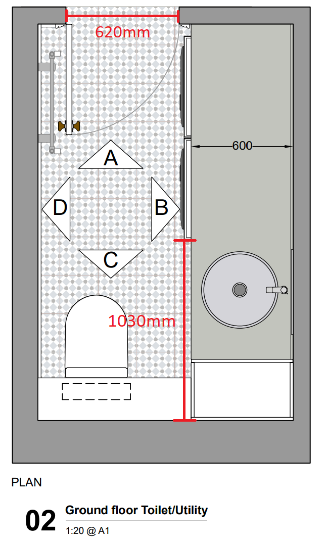

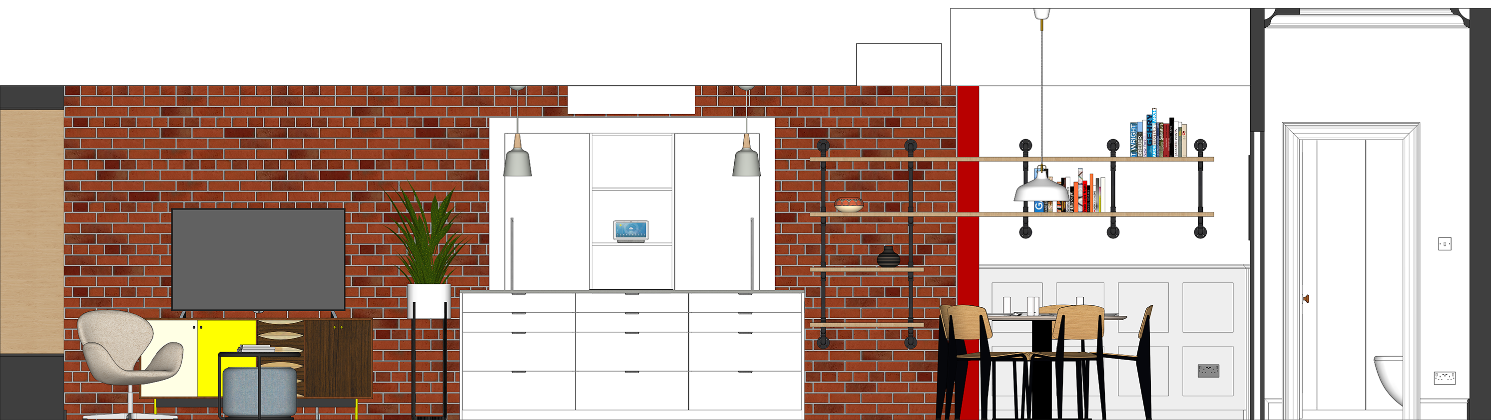

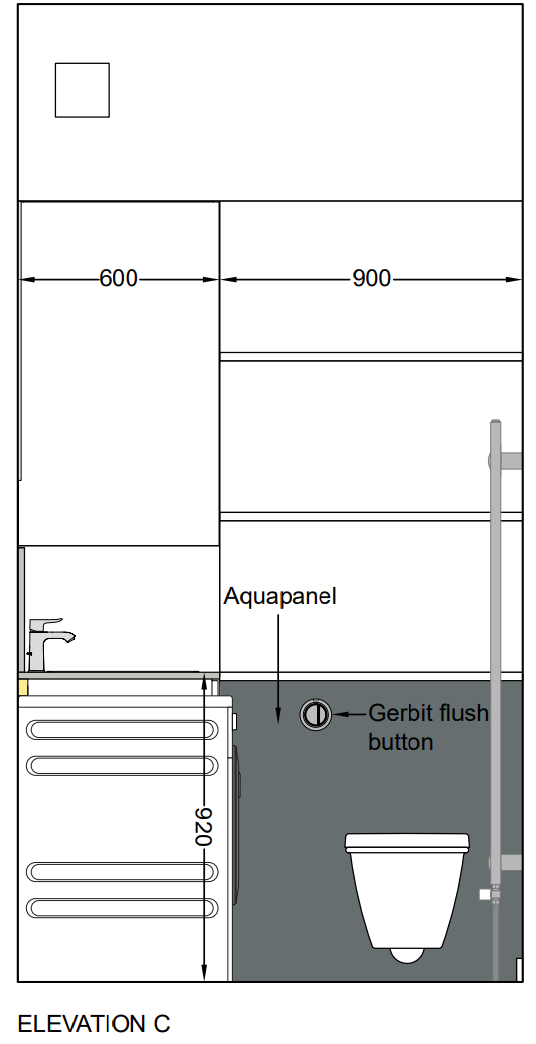

  22. The laundry is in the downstairs toilet. I plan to put the toilet lid down and use that as a set down for the laundry basket. I am in discussions with the architect about moving the toilet back to the stud wall if I can make room what with the pocket door and wall hung cistern. This would make the laundry/downstairs toilet 1400mm wide which I feel is sufficient, the toilet would have a front projection of 930mm which is more than enough. The shelves will just be industrial style pipe work. The software is sketchup.

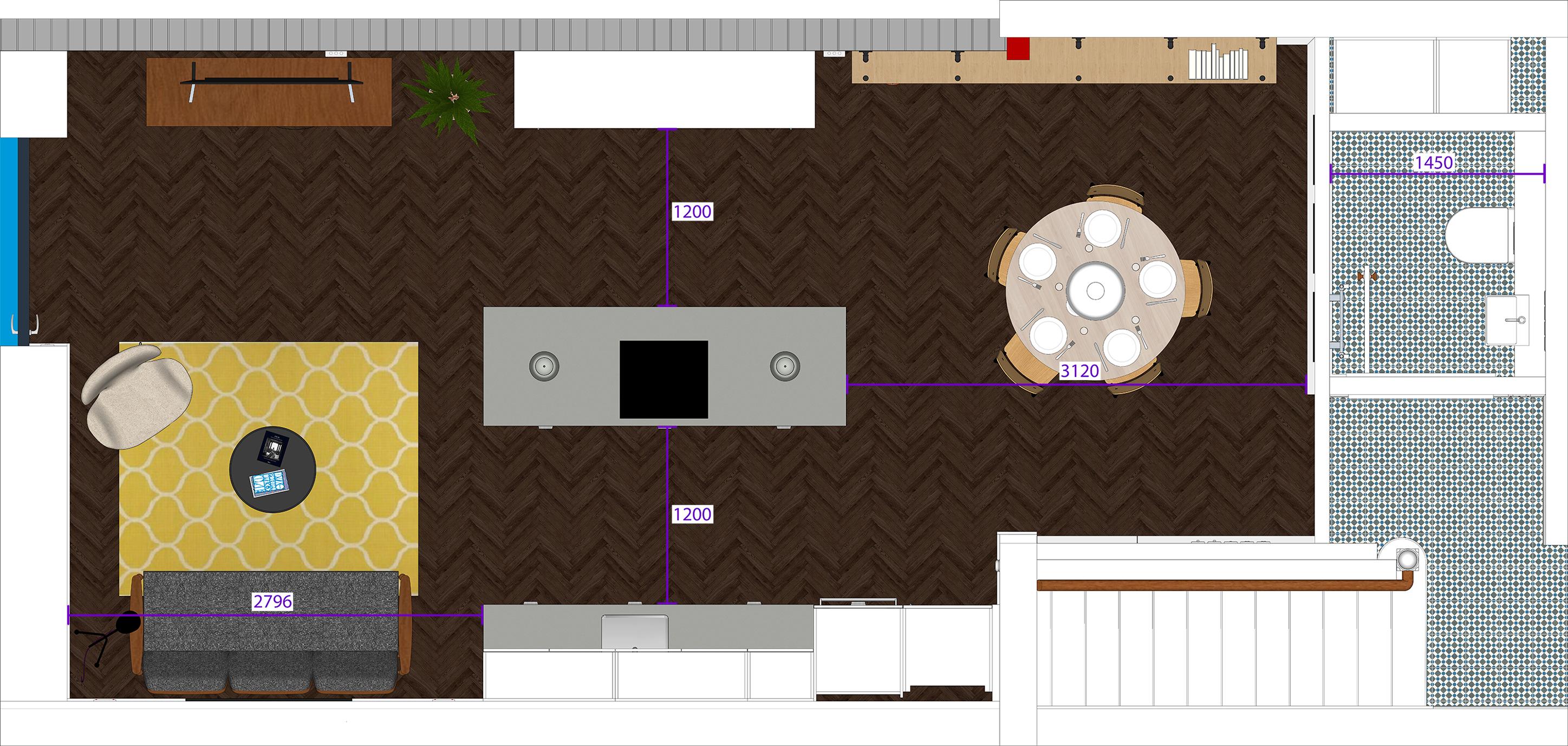

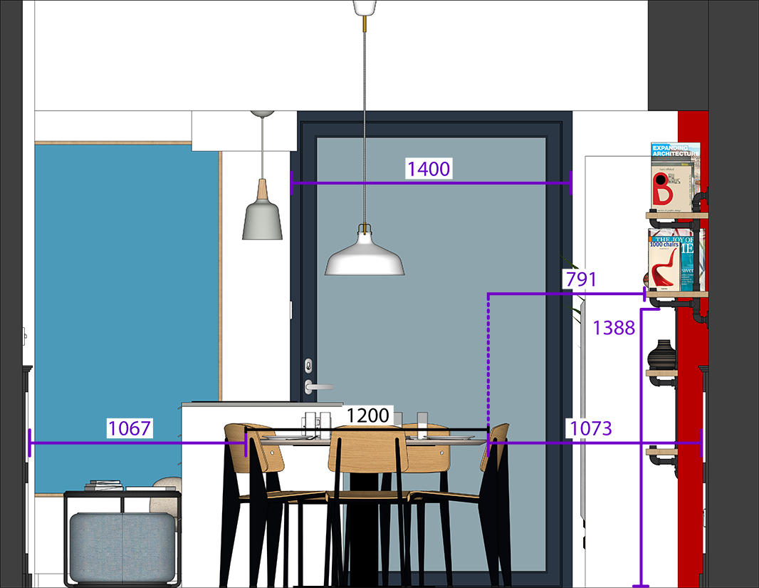

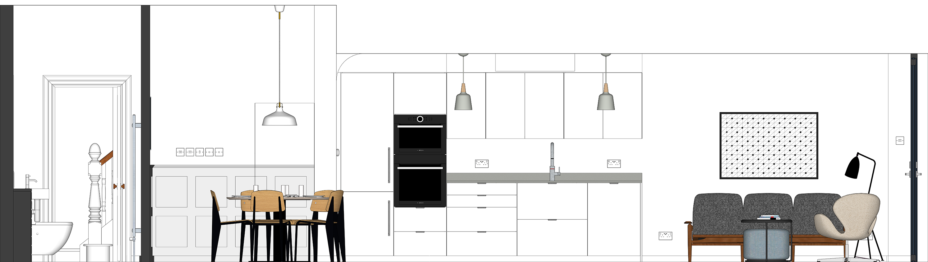

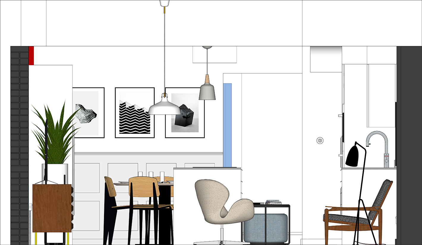

  23. Thank you Mr Punter. There can be no accusations that I have do not enough space around the island now. I have cleverly eaten into the empty area on the dining and living side to make room around the island.

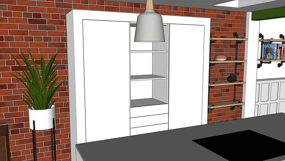

  24. Hi, I have plans for a renovation of my terrace house. I actually also have a front living room with a bay window but I have not included it in these plans. I would appreciate peoples thoughts on my design and layout. My only concern is that the living area is quite cramped but I must repeat that I have a second bigger living room at the front of the house so maybe this mitigates this somewhat. The downstairs toilet will house the gas boiler and an integrated washing machine & dryer stacked on top of each other. I have the complete kitchen on two sides with the cabinet against the brick wall not critical to the kitchen triangle. My only flaw with the kitchen is that I wanted a floor to ceiling food larder unit but have had to settle to splitting up the dry food storage. I am using the left set of drawers on the island for the majority of my dried food, I will use one of the overhead cupboards for tinned food storage and the prep cabinet next to the sink cabinet to store fruits and vegetables. I could use one of the floor to ceiling cabinets for bulk storage of food. I also do not like how I have had to place the fridge/freezer and oven beside each other but I believe modern appliances are insulated enough to not effect the operation of the fridge/freezer too much. Top view Side view 1 Side view 2 Back view Front view
