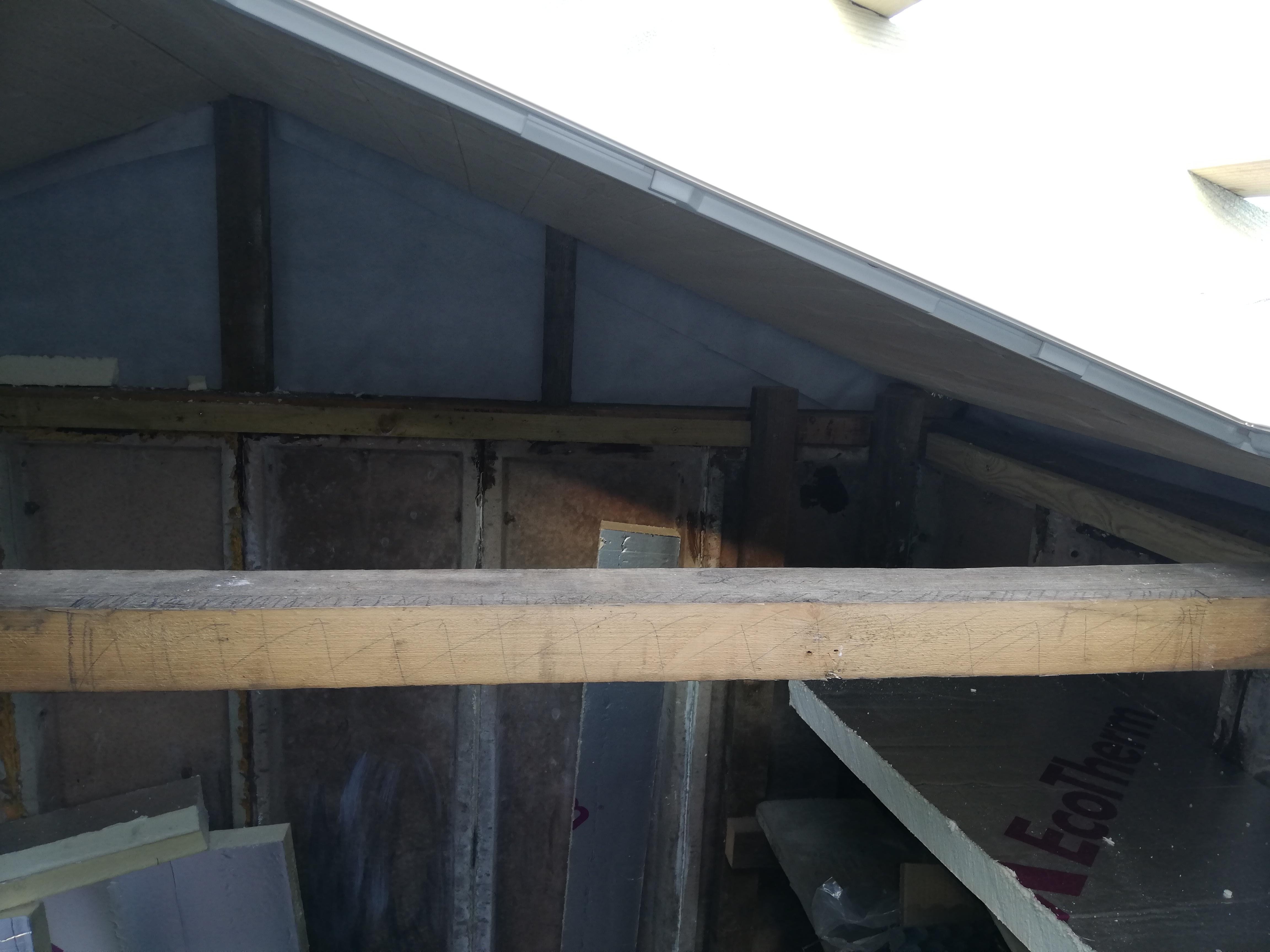

  23. Hi all. After a bit of advice please. I'm doing up an out building come shed. I'm putting in loft hatches as open and shut option to give ventilation and a bit light now and then. What's everyone's thoughts on cutting a 20mm notch/slot as shown in a joist that's 75mm wide? No load bearing other than the corrugated metal roof above it and 5 joist/rafter across the whole roof ceiling space. Thx
