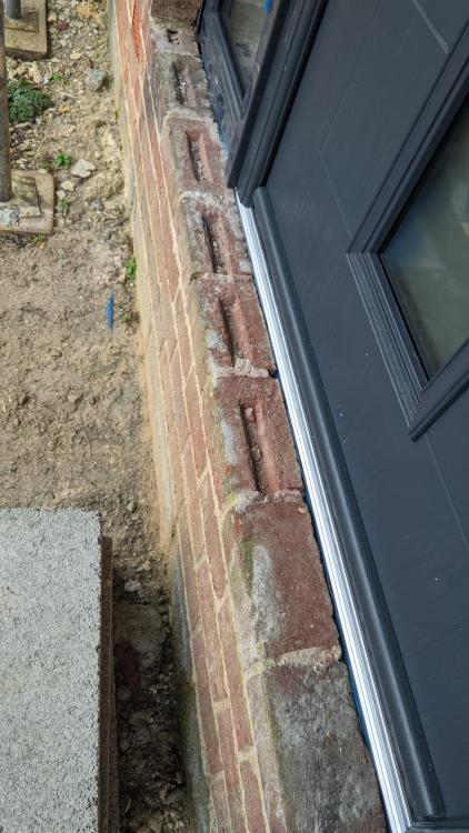

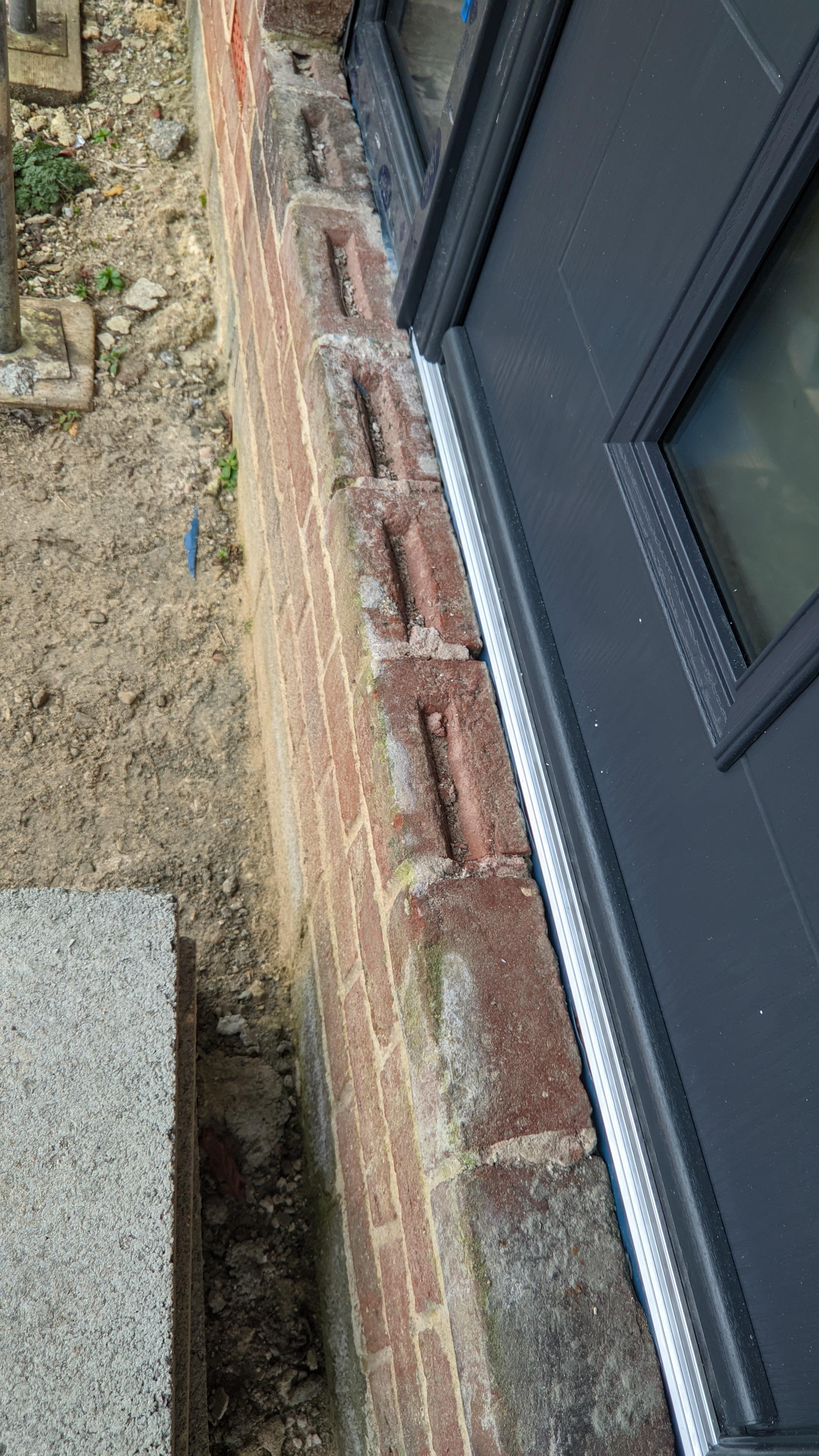

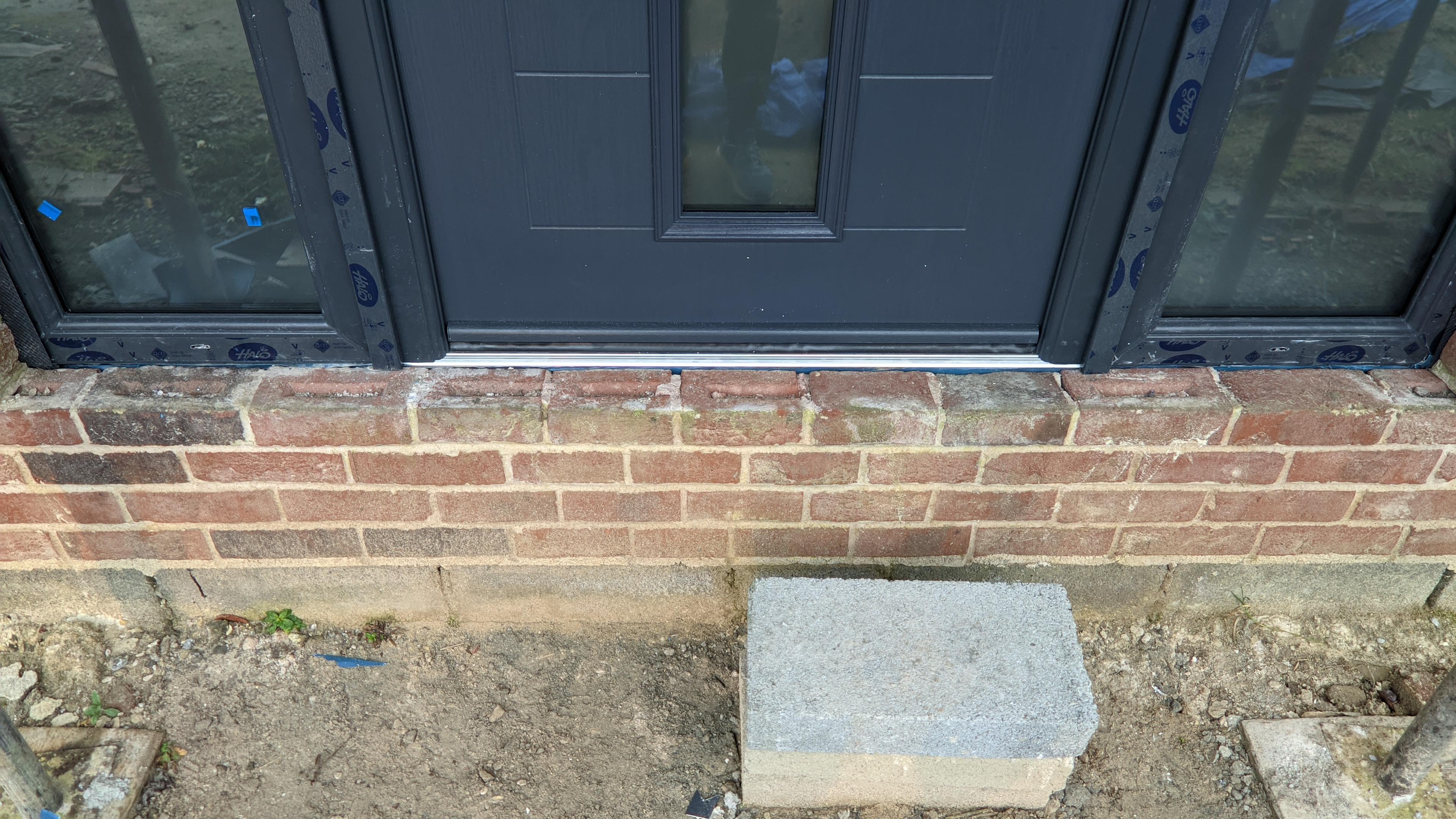

  20. I don't think I can chop out a row of bricks and set a sill in because the cavity is concrete filled, so even if I do take a row out I can't set a sill back far enough under the door 😔 Annoying
  21. Yeah I've seen that posted here a few times. That's got a sill by the looks of it 🙄
  22. I think I know the answer to this. Had our front door fitted this week and to my suprise was fitted without a sill? Door has been installed within the cavity to avoid thermal bridging but now without the sill exposes a possible water ingress issue. The cavity below the door is lined with DPM and concrete filled so is sitting on this. Before they fitted the door I had the DPM pulled up at the front and lapped backwards behind the door so the door could sit on this but they trimmed it off flush at the front?? I queried the fitting at the time of install and they assured me it was correct, it was for thermal bridging and a sill couldn't be fitted for the level access for regs? The rainwater running down the door can now flow behind the visible DPC and soak the cavity filled concrete? 1. Is this wrong and 2. How do I fix it?
