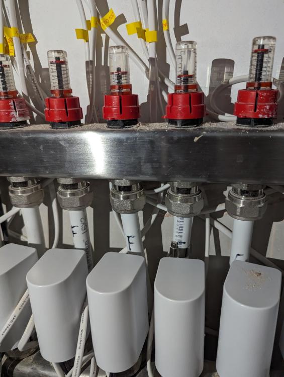

The pin on the manifold? Just checked them both and they all seem to be at the same height. But I think replacing the actuators may have fixed it! When I initially installed them circuit 5 was still stuck open but I let that zone (that was stuck open) run for the last hour and now when I turn the zone off and turn on another circuit the former dodgy circuit stays closed! I think maybe the new actuators need power for a bit to calibrate fully. Heating is off now as the house is roasting after all the testing but I will try it again next time I need heating and see if it behaves.
I had 2 spare actuators so have actually just changed them over. It has fixed the issue on pipe 4 but pipe 5 still opens when i call for heat in another room. I have also tried to recalibrate all the actuators on the manifold but that has not resolved it either. Not sure what else to try.
Hi all, I am having an issue with my UFH which is causing me to scratch my head! Whether it has existing since I moved in on whether it’s a new issue I am not sure. I have noticed in the past week (since the heating came on) that my hall has been warm whether I have the zone calling for heat or not. After a bit of experimenting today i can see that the pipes to the hall are getting warm and the bits that move on the top of the manifold that you use to balance the runs move (sorry I don’t know the technical term - I have the self-balancing actuators so these are just open to maximum - image is attached). It doesn’t matter what other zone is calling for heat these two circuits open and the hall heats up. I have attached an image of the bits I am talking about – you will see the actuators are off but the circuits moving water! Any suggestions on what it could be? I thought maybe dodgy actuators but it’s unlikely to be both of them?

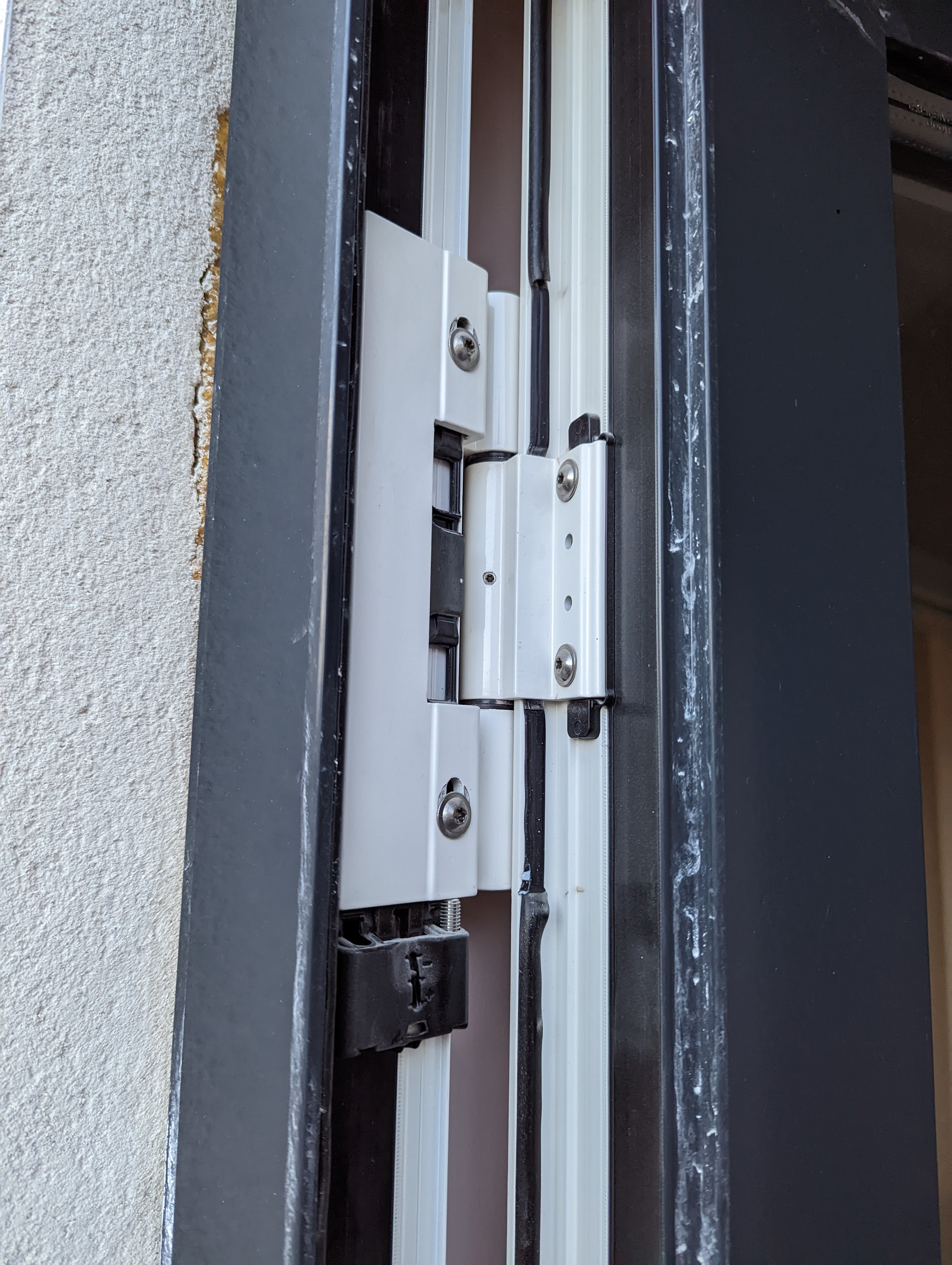

Hi, I ended up with Rationel windows at my self build however just about no one local to me wants to work on them or adjust them! They were installed by both the builder and a good albeit unreliable joiner. To be honest it was all a bit of a mess and I regret chosing them now! In any case there is one window which I just can't get adjusted right - I have tried a few joiners/windows fitters but finding someone who has dealt with these type of windows and hinges (and who actually turns up) is proving to be a challenge. I have tried fixing/adjusting it myself but can't quite get it right either. If anyone has anyone they can suggest who is local or indeed is willing to travel then please let me know. thanks.

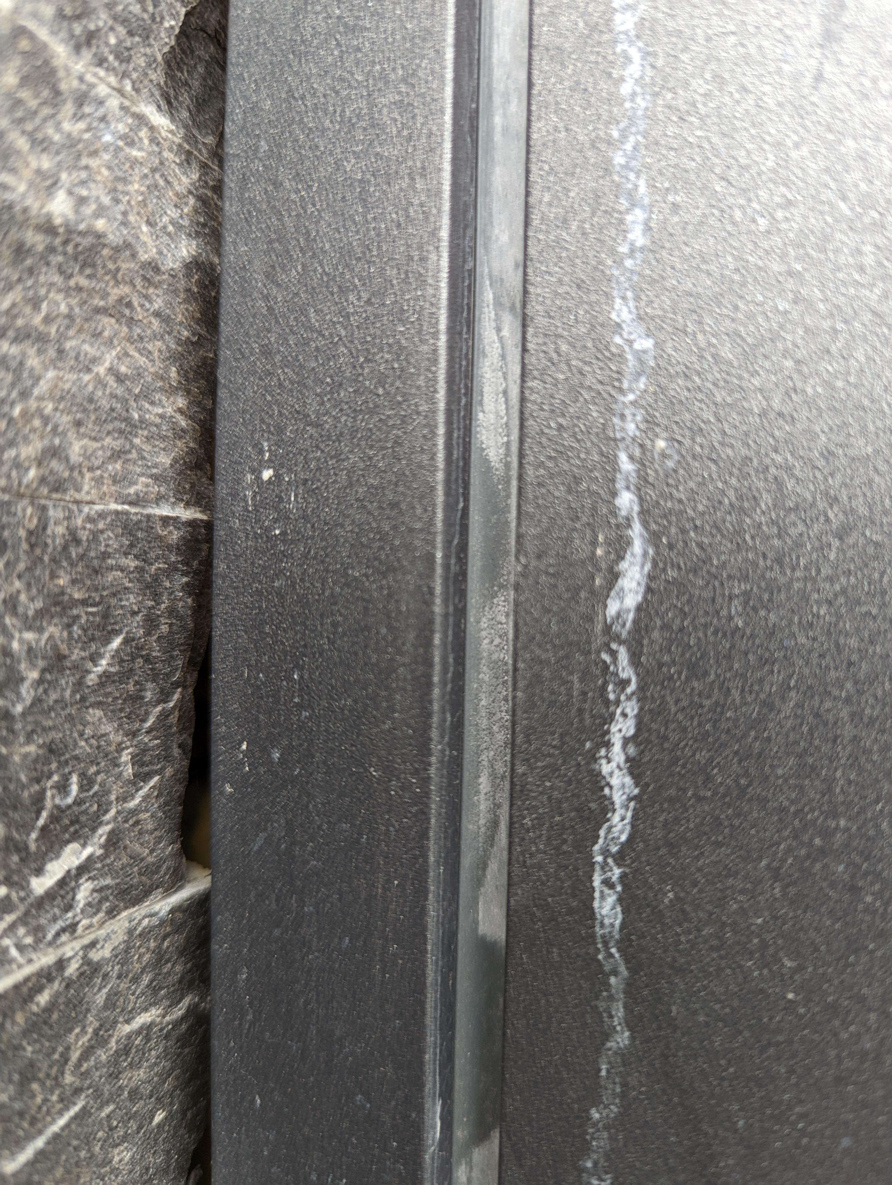

Thought I would update this for anyone that might come across this in the future - I had a couple of spare cills so soaked them with cleaning vinegar (neat) overnight to see if that would stain them - it did not so I tried the cleaning vinegar with a non abrasive brush this morning on the window itself and it cleaned up a treat. Who would've thought it would be that simple!
Hi all, I have a window at my self build which have been marked with some mortar / water residue left by some careless brickies. The window was covered but obviously not good enough. The marks are not coming off with regular cleaner. Can anyone suggest anything that might work to remove them but won't damage the paintwork? Image attached. Luckily you can't see the window unless you go looking for it so not the end of the world if I can't get the marks off but I'd like to give it a shot!

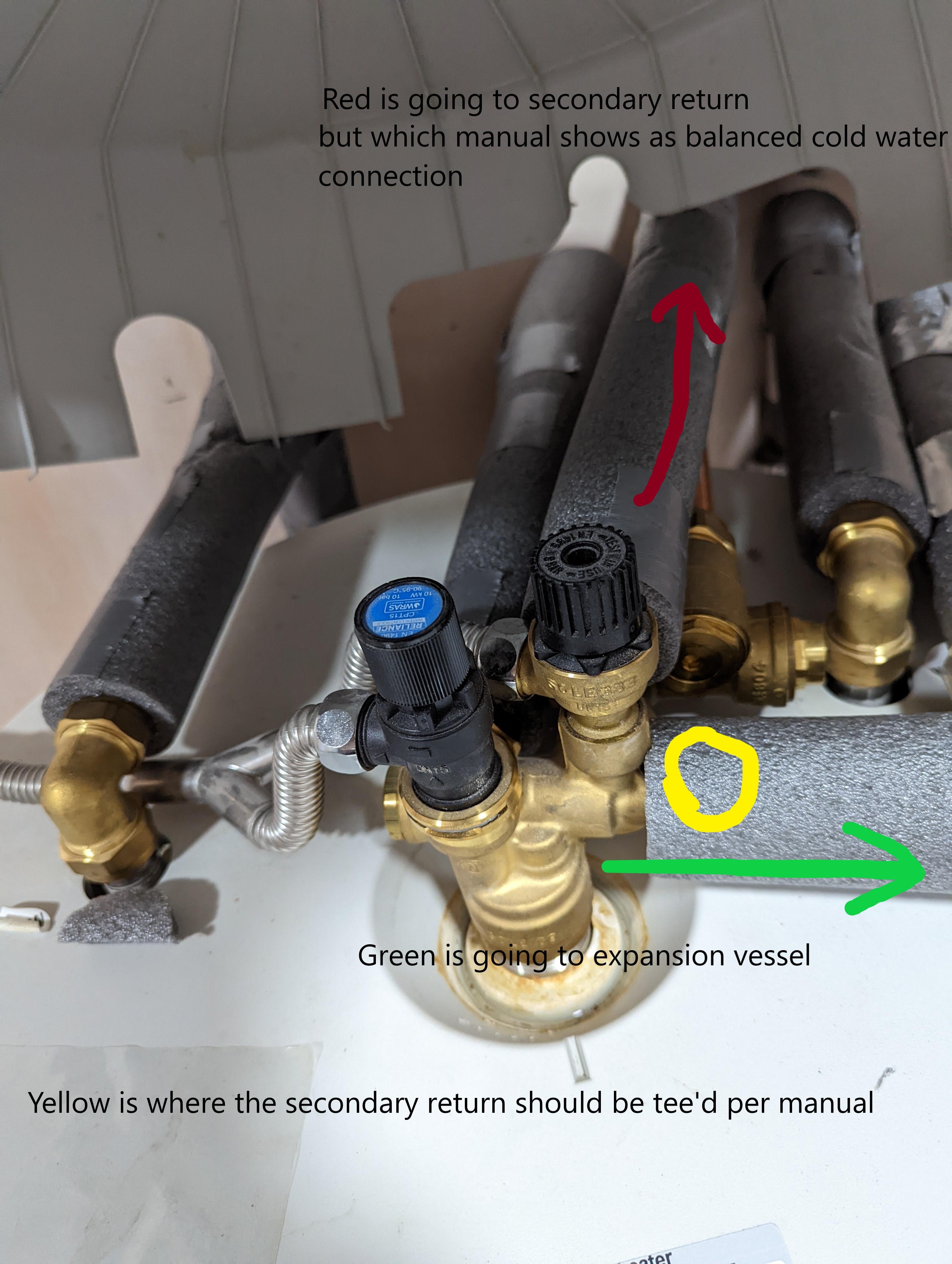

Hi all, I thought i would update this thread as this saga with my hot water has continued to run and run (or run out as is normally the case)! The installer came out and installed a NRV between the bronze pump and the tank - that solved the lack of hot water when the pump was switched off but I am still losing a whole lot of heat through the tank and it can go from full hot to room temperature overnight. the plumber was out a few times and couldn't see anything wrong and I have lived with it until last night when I wanted a bath and what do you know! No hot water despite us being out of the house all day!! I have the bronze pump on a smart plug and so its only on when motion is detected in the landing - so most of the time this pump is actually off and so i shouldn't be losing any heat through the secondary return. I ended up checking the piping myself last night and on the SC300 manual for the secondary return should be connected via the expansion vessel connection and the combination valve but my secondary return seems to be plumbed into the balanced cold water connection. Could this be causing my issue? To my layman's eyes where the connection is supposed to go and where it does go on the combination valve are not miles apart but surely this can't be right? The plumber has said it doesn't make a different and OSO technical hasn't responded to me. Can anyone chime in while i wait for OSO? -

Thanks Peter. The uvc is a OSO Super Coil - so preplumbed for secondary return / system boiler (which we have) and the secondary return looks to be where it should be per OSO manual (via the expansion relief valve). However even the manual says to install a NRV - I have ordered one now so will try that and and take things from there. -
Good evening all, Quick question about a secondary return pump - i have one in my house and my plan was to switch it off at night so that the hot water is not continually circulating at night. I have put it on a timer but what I am finding is that when it is switched off I don’t get any hot water! Maybe its a bit tepid but certainly not hot - as soon as I switch the pump back on I get the hot water returning! A couple of things to add if it might help diagnose: 1.Our first pump failed, and we ran the system with the pump disconnected (so turned off at the valves on both ends of the pump) and it worked fine and we got our hot water albeit having to wait 30/40 seconds for the hot water to reach us and 2. When the pump is switched off the brass fittings on both ends of the pump are COLD to touch - almost as if ice cold water has been running through them - could anything obvious be causing this? Surely i should get hot water when the pump is switched off? What could be causing presumably cold water to be running through the pipes when the pump is switched off? p.s. After a bit of googling it seems that I need a non return valve between the pump and uvc - can't see one on the system so hopefully thats it but if anyone can corrobate that would put my mind at ease.
