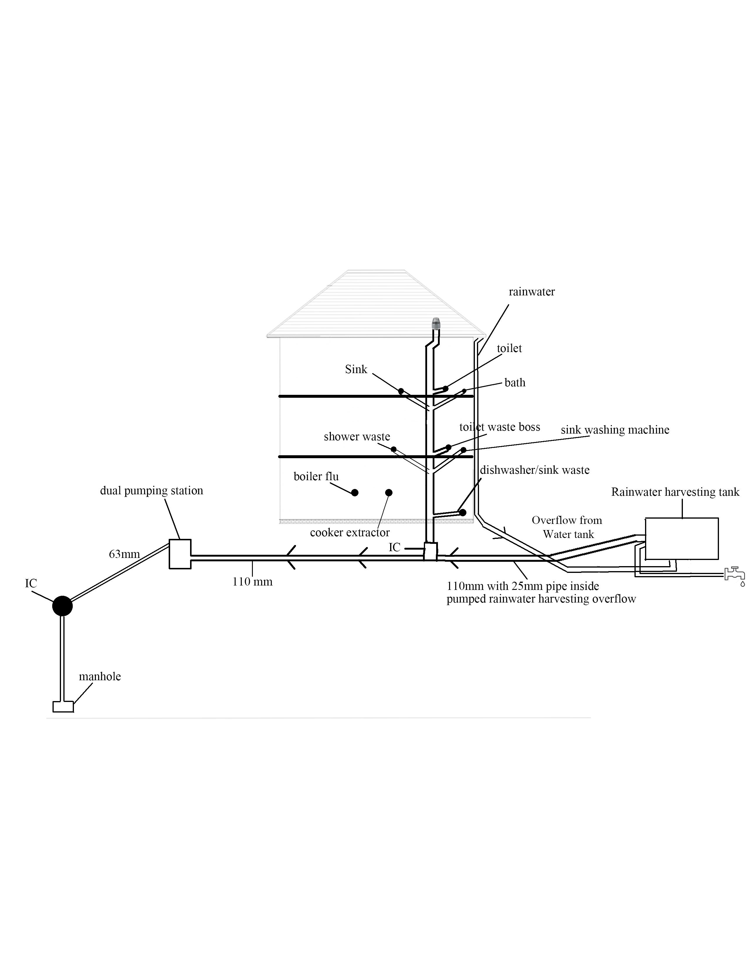

Hi, Yes I was told to do this by the manufacturer to protect the 25mm pipe from being damaged. It needs to be pumped as it is lower down than the IC chamber it's connecting to. The garden slowly slopes down. So all looks then :)?
Hi guys, just did a course in Drainage and am now working out the design for my Newbuild. Here is the soil stack design let me know if that looks ok? I'll a fresh water and hot water one this weekend

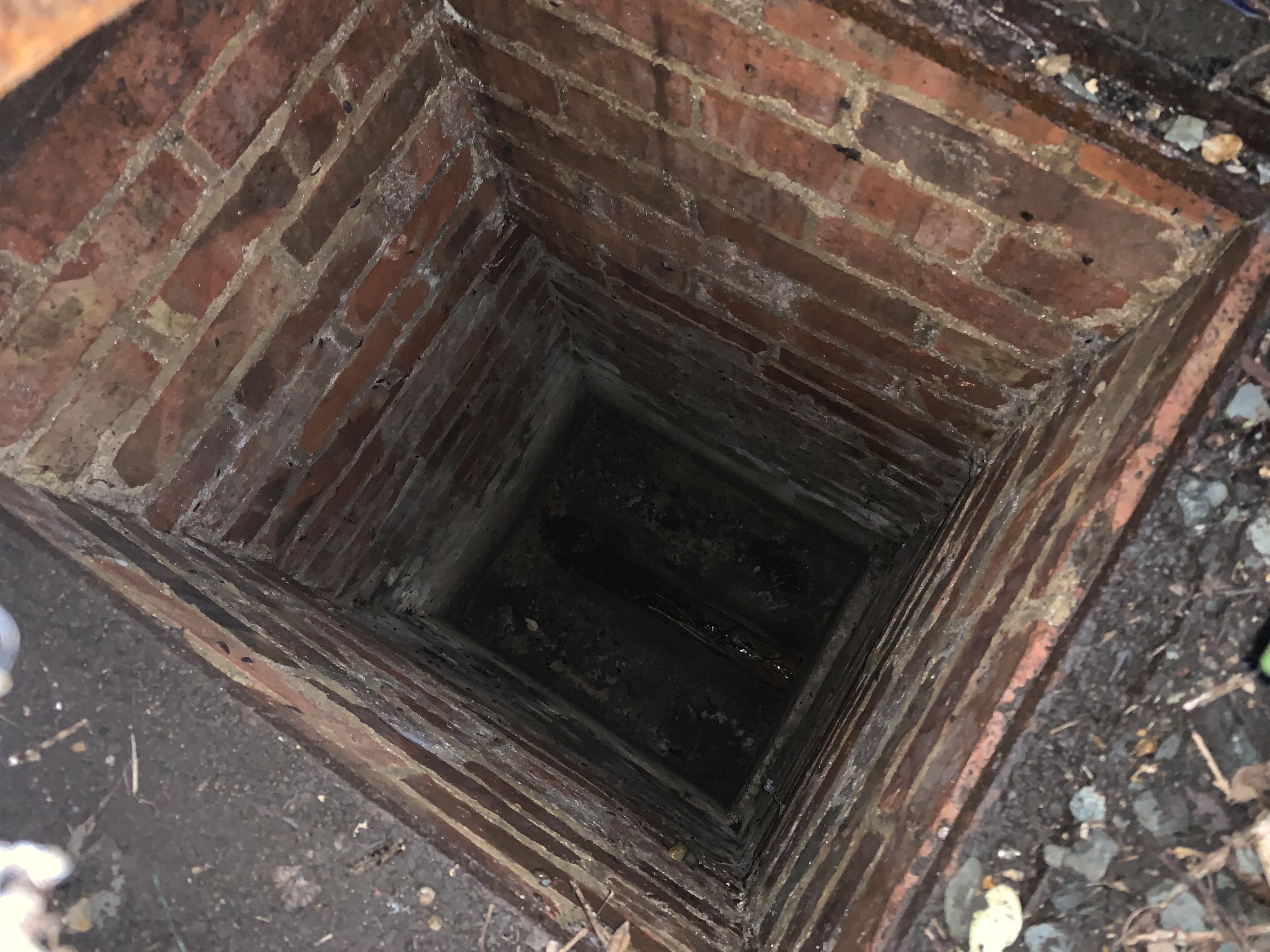

Hi, So i've been following some great threads on drainage on this site, and was hoping to pick someones brain if possible. I have to connect to a public sewer on private land that's 2 metres down for the invert level and I wondered whats the best way to do this? It's in Surrey so thames Water will be inspecting it, if that makes any difference. Thanks,

Hi, Yes I have details about the pump from the pump company, and thanks for the info on the pipes from the pump to the sewer. Sadly the person that did my prep for building control said they did not do drainage and won't help. The main issue is getting from the pump station into the sewer where the invert level is about 3 metres underground, do i do a backdrop connection or slowly go down to that depth? The rest like you say isn't too complicated.
Hi, It's the design for the foul water, which will need pumping up to the sewer on the property next door to me. I have a ground worker that is happy to do the work, but normally works from a plan done by somebody else. Can't find someone to do this plan.

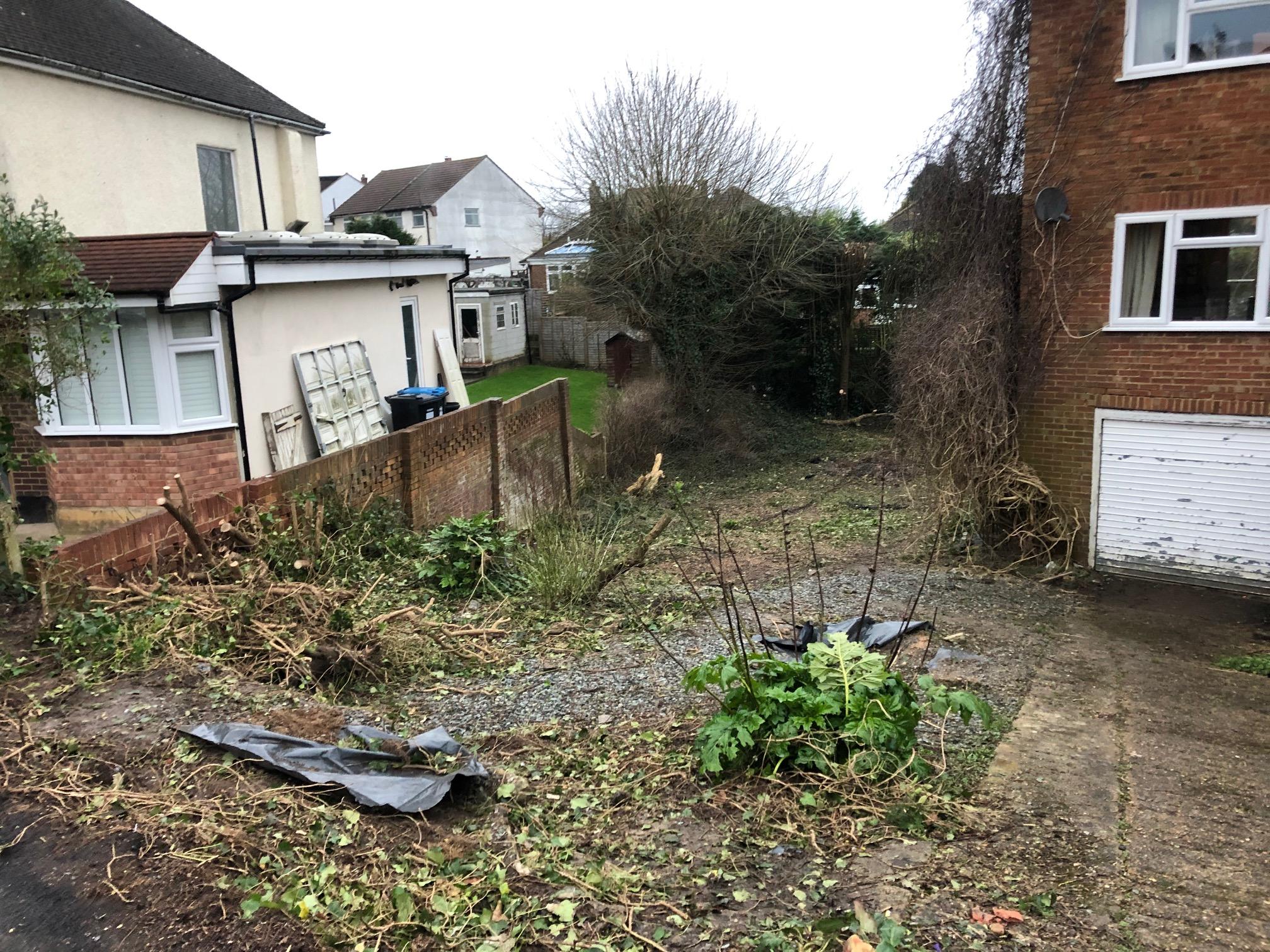

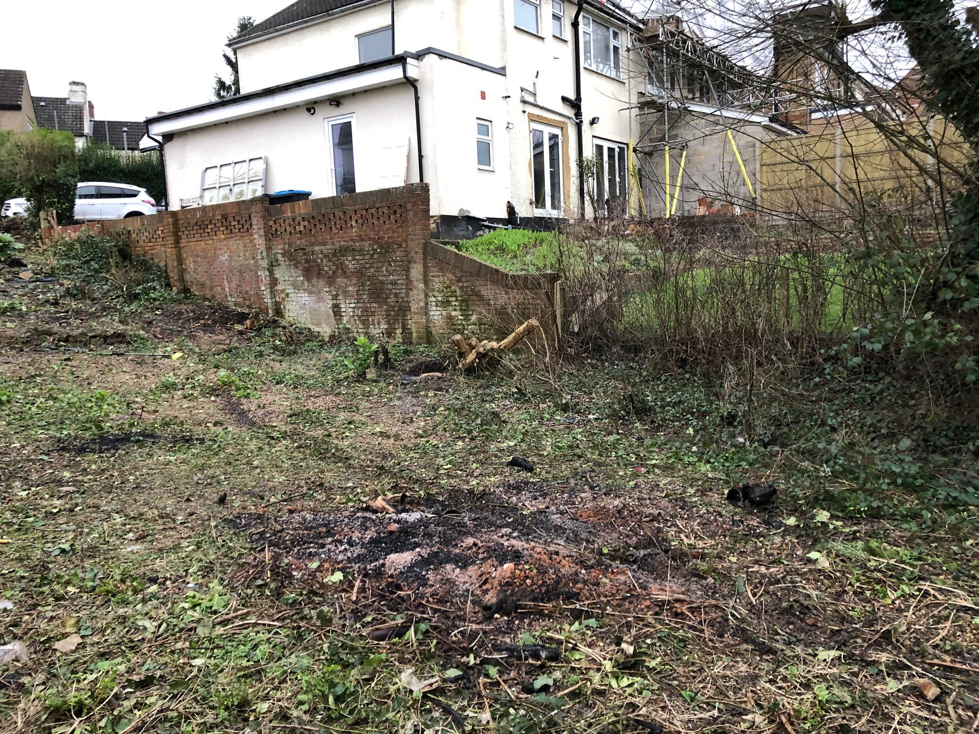

It's not a basement it's simply building on the ground there. Here is a photo (taken in summer) of the back of that plot showing the height. -

Hi I am building a house 1 metre from my neighbours (on both sides) and the SE is worried about the retaining wall holding up the house next to my house. They have proposed raising the foundation level so as not to have to dig next to the retaining wall which could potentially be dangerous. The issue with this is I would have to go back to planning to ask to change the heights, which I doubt they will say yes to due to the fact that it matches next door. Anyone know of a foundation where I wouldn't have to excavate? Or any suggestions like cheap retaining walls i could on my side of the property? RJS76A_000 - Proposed street scene and elevations.pdf
