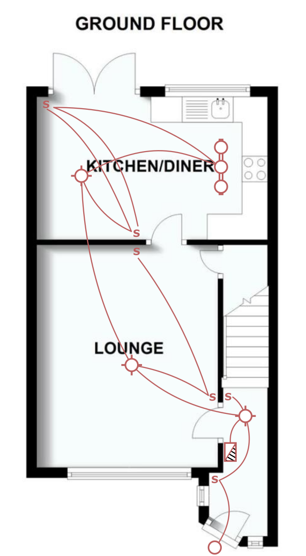

  3. I've recently bought a small 3 bedroom house in Bristol. I'm looking to retrofit a wired semi-permanent smart lighting system that could easily be removed or made dumb when I eventually sell again. Also the home automation system in general is going to be a hobby project, and I'm quite competent with software and electronics engineering. I think my motives are not to dissimilar to those over at SuperHouseTV. With that being said has anyone else done anything similar? My current plan of thought is to use these AC DMX Dimmers underneath each light fixture and pull a load of cat5 cable to a central location. I've already done this to some extent with cat6 ethernet wiring. Some of you might have better ideas however which I'd be interested to hear. Also see attached a crudely drawn diagram of the existing ground floor wiring. First floor I'm not so worried about as access is incredibly easy from the loft.
