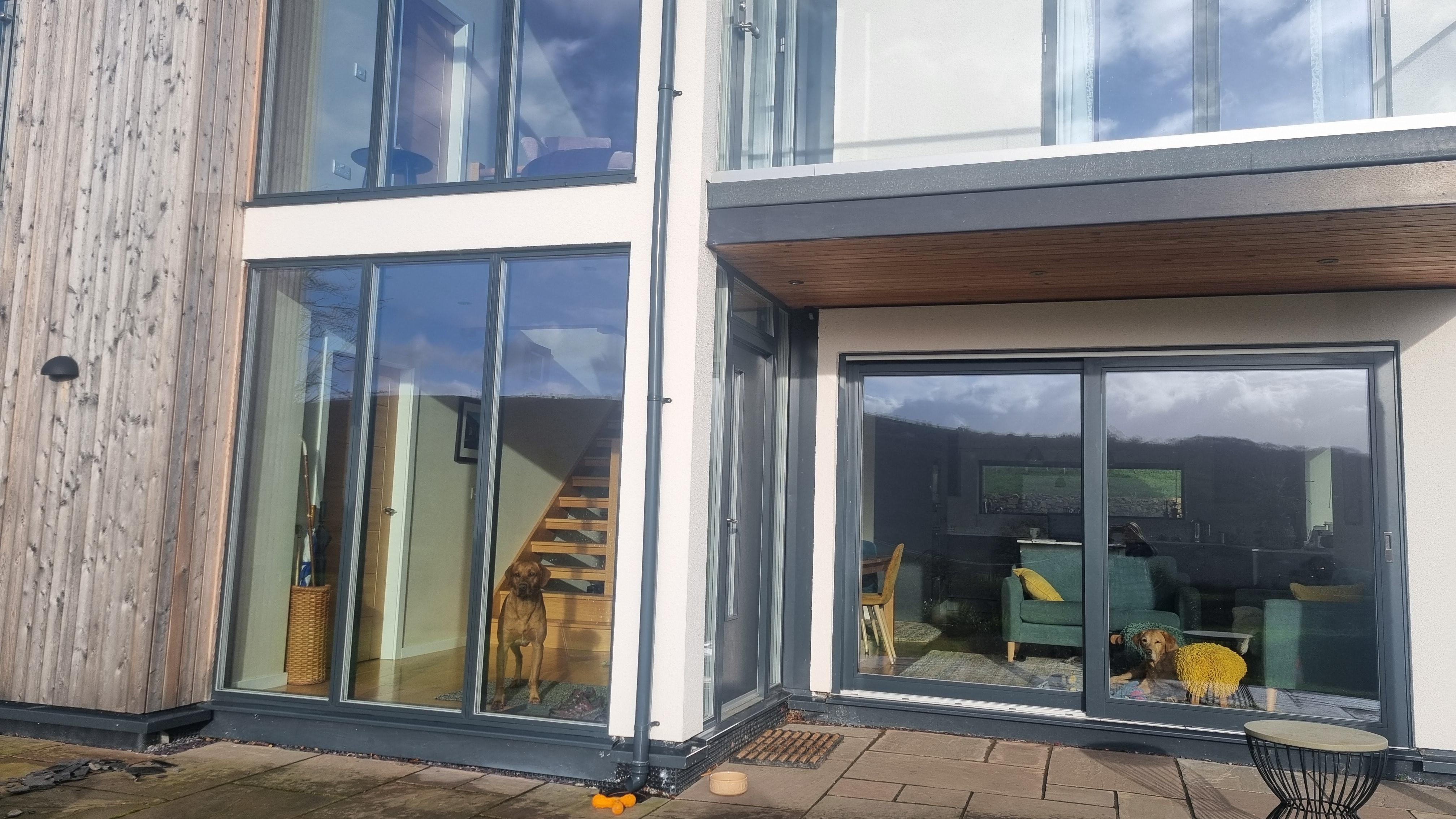

The timber frame engineer said he thought it was a good chance it was from the balcony. They asked if there were cavity trays on the balcony. We do have those but i am not 100% confident in the job there. The timber frame is wrapped then there is render board and render on top so i struggle to think where it could go in as its a sort of envelope The window folks sealed up the windows on the ground floor and the ledge of the windows above. They have been back at least 3 times to check this and re-do it. This stuff makes you lose confidence in just about everything i think. I will see what decent photos i have of the outside during construction. -

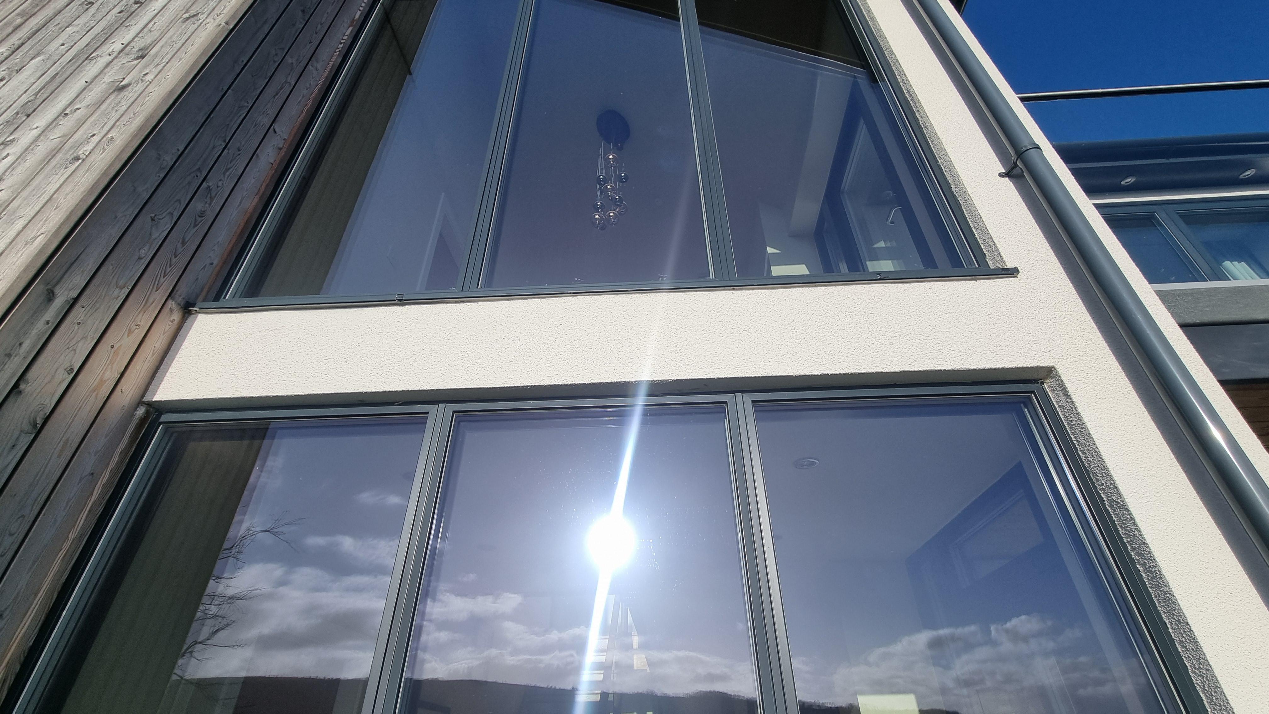

hi Kelvin, thanks for the reply. The windows that were in originally were only here for a couple of months during the build and boarded up as they were too small for the aperture.it was pre-render. We werent in the house then but I didnt see any leaks then but as it happens so infrequently its not that conclusive. I have attached a photo of the front of the house. The water is coming in above the downstairs lower triple panes in the left of the photo, and appearing somewhere in the middle of the 3 and towards the corner nearest the balcony. You can see the balcony is on the right alongside this. You are so right about water travelling. Do you think surveyors have these little cameras, i would have thought it would be in their tool kit? -
Hi all, i am seeking advice on the best course of action to track down the cause of water ingress into my house. Its a timber frame, nearly 3 years old, triple glazed rational windows. We have large ceiling height windows in the hall at the front of the house. When the wind drives into the front of the house (v infrequently but last night it did) we end up with water coming in through the ceiling above the windows. I have had the window company back a number of times, who have sealed stuff up further to no avail and the timber frame company think it may be coming from the balcony at the side of this ceiling. As a bit of background the timber fame airtight test was done with different windows in this space as the original windows they delivered were incorrect. Hence me suspecting the windows at fault, though the airtight test taped up all the windows and doors. I am wanting someone to come and investigate and wondering what profession would be the best. I am thinking perhaps little cameras up through the light fitting in the ceiling to see if we can see any gaps? does anyone have any suggestions. Is it a job for a surveyor? I didnt have a main contractor on this job so the things that fall between the trades is down to me unfortunately. I am getting a bit desperate now as it happens very infrequently (this is the first time since a storm last march) but is v annoying when it does as i end up catastrophising every time it happens. I would be very grateful for any advice/suggestions from the forum. Thanks all.
