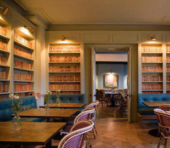

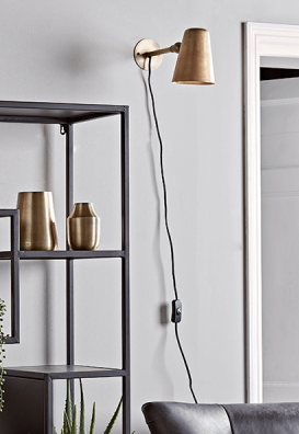

Hi all - after much searching online, I have found the lights I'd like to put in our sitting room when our house is built (start in Jan after 2 years planning!). They are the ones in the picture, but they come with a cable and plug, and inline switch. In the other picture, it seems like these same lights have been adapted to be hard-wired. Is this a relatively simple thing for an electrician to do? Or do I need to go and find some other lights?!
