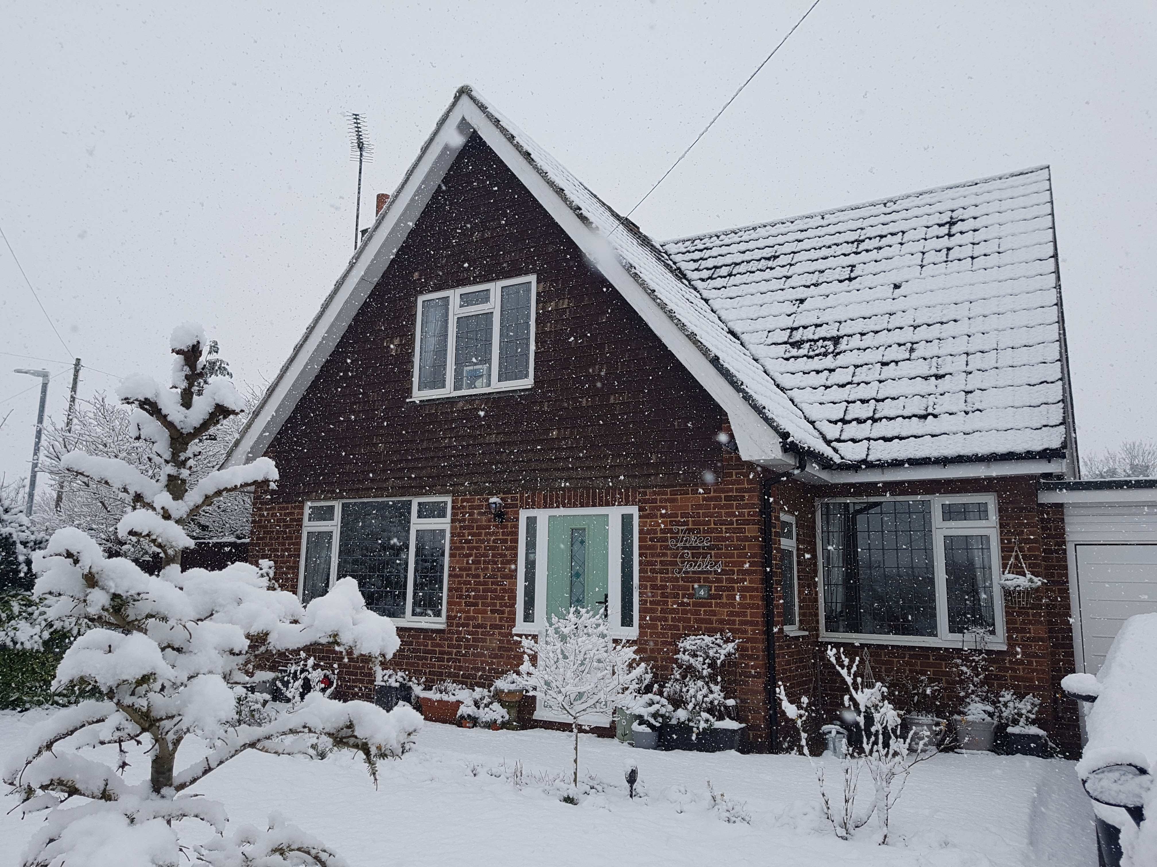

Just on that point ... we had assumed the same as well, but after a very thorough asbestos survey (which I would recommend you get) we found there was very little that needed to be done. The only asbestos in the heating system was a brown asbestos panel on the back of the furnace door (which was dangerous, and was removed for specialist disposal), and asbestos cement around the flue. The recommendation on that (as with most white asbestos) was to leave it in situ, with a suitable warning tag in the area not to disturb it. If your property is, like ours, a chalet-style roof (see pic) one of the most awkward parts of upgrading the building fabric was in properly insulating all the eaves spaces. Some of them were accessible as eaves cupboards, but some were sealed up. Existing insulation was 10mm fibreboard between rafters and on internal walls and a little (very little) loft insulation between floor joists. -
