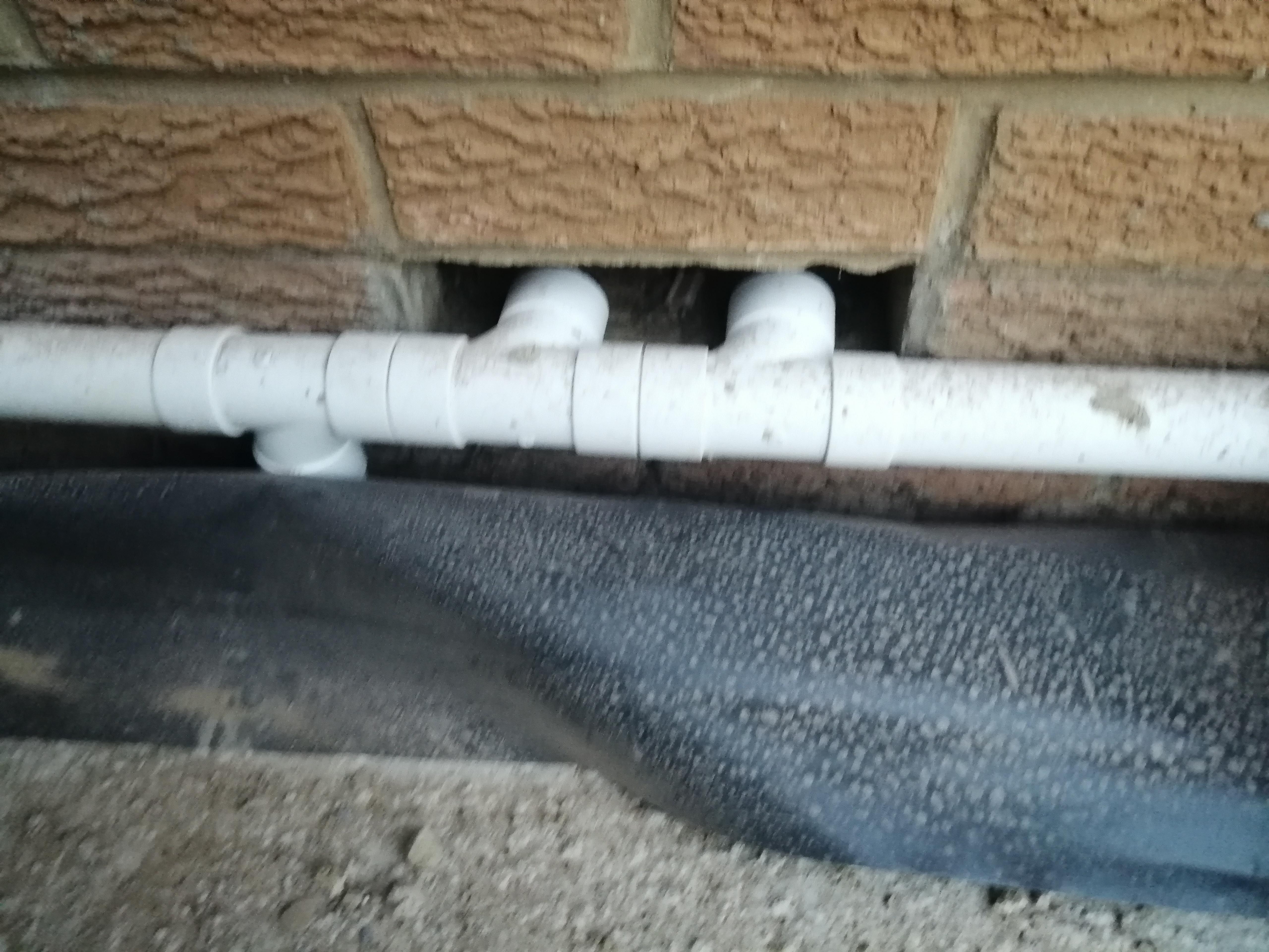

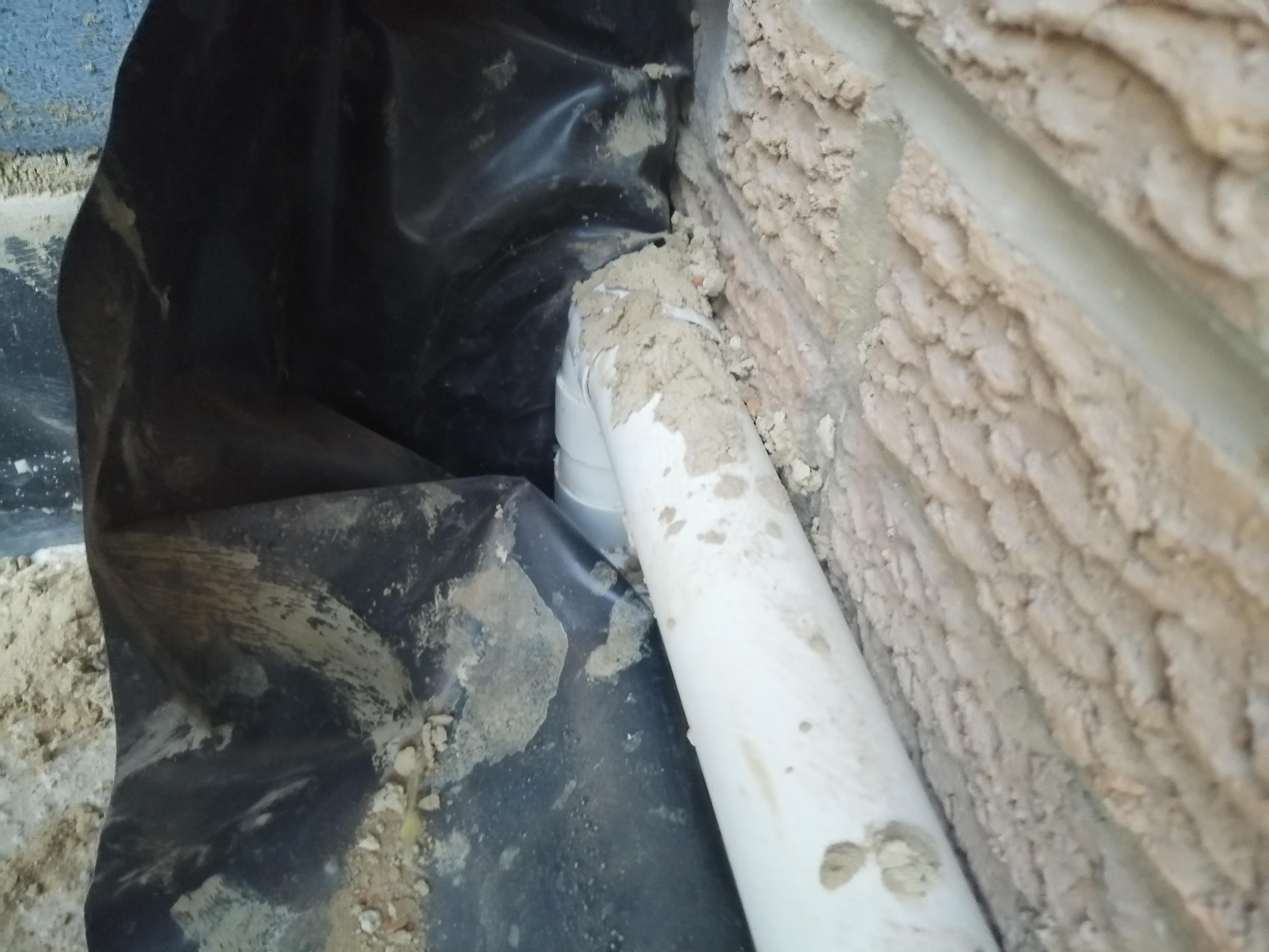

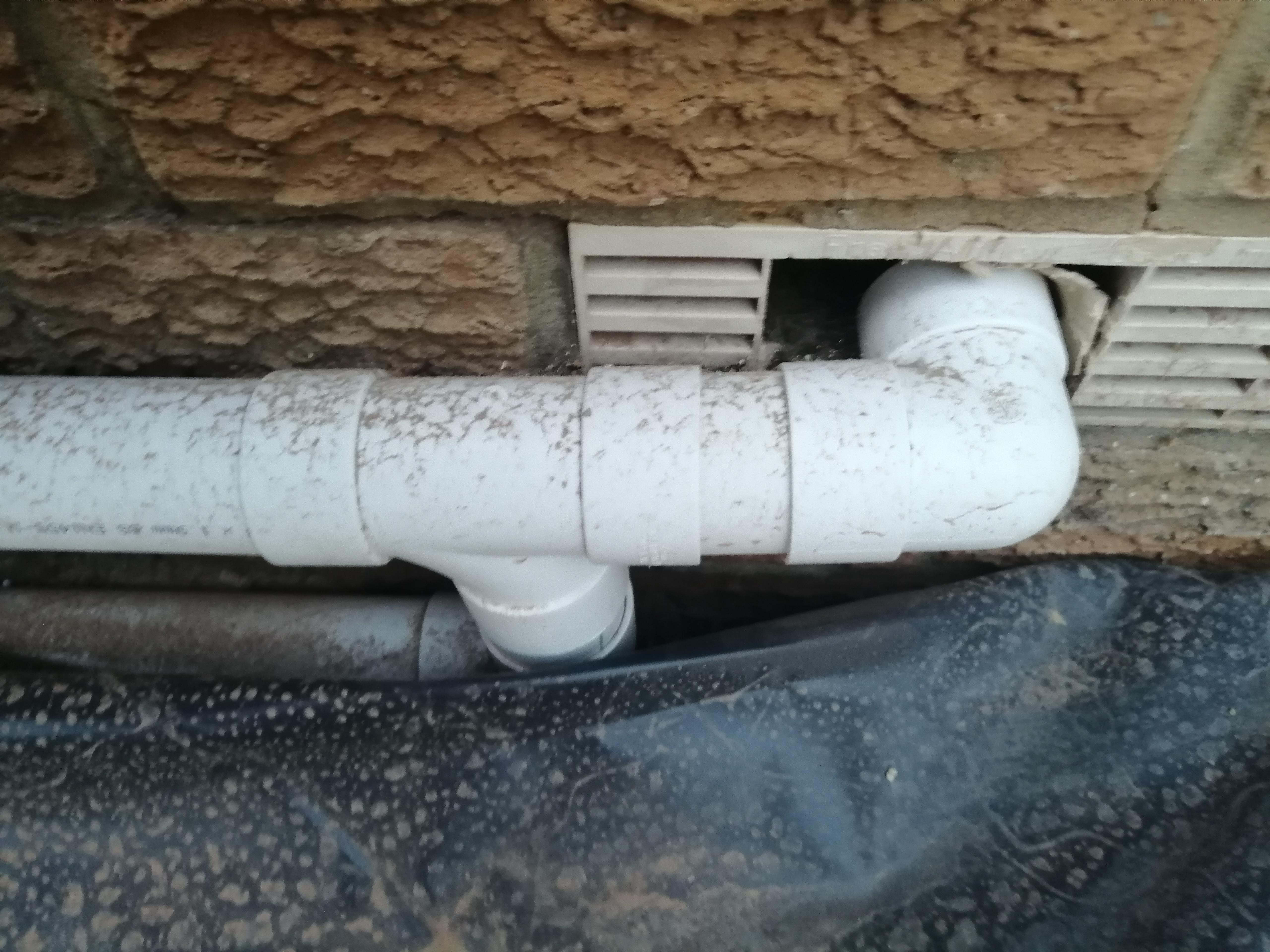

My extension / sunroom builder just extended air bricks - with 2x 48mm UPVC pipework, venting into the... cavity on the side wall, its air brick is about foot away. I am thinking WTF? Thats not even close to notional 1500mm2/mtr as the choke point in the pipework is 48mm pipe applied to each 2 existing bricks... Builder says its OK. Advice appreciated. -

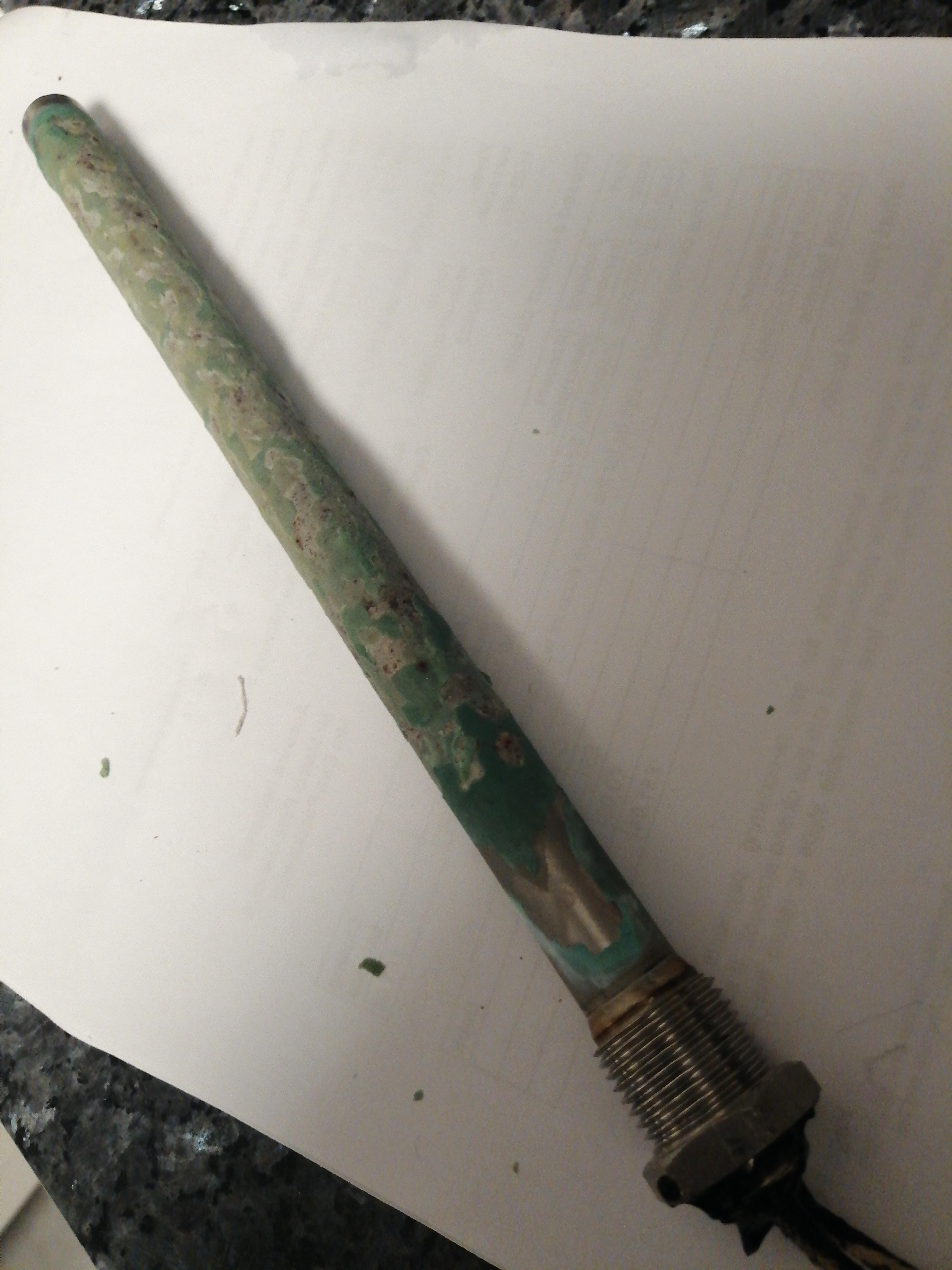

Yes its the PV. I think the overvoltage to 248-250 is part of the problem, element is rated 2800W @230V. That does not quiteexplain why the heating element would leak to earth - instead of burning out - is it simply ceramic getting wet due to leak caused by overheating/expansion of the tip of the sheath? It does looka bit like press-fit (photo of the old one)
Looks like my SunampPV killed its 3rd heating element in 2 years (and second one was on the day of replacement of the 1st one). Its not burnt, still steady 17Ohm when cold, just leaking to the earth (about 260kOhm there) so RCD trips away. As Sunamp support has the usual dislike to emails / catch-me-if-you-can phone attitude - does anyone know if it is stock item or... its Sunamp special? Quick check shows its 2800W HLP version from https://www.tuerk-hillinger.com/products/ - but ones in their catalogue only go up to 1000W At his point I'm thinking that Willis inside is a bit undersized / prone to overheating, so... would the control board cope with 3kW/11-inch element in an external one? Don't want to hack it... but if this is the way to keep it working, so be it. I really like it, when it works.
