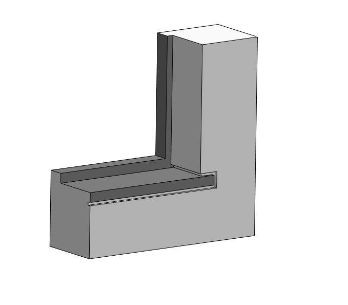

Shadow gaps around window boards?
PI build replied to PI build's topic in General Self Build & DIY Discussion
I liked the idea of the end of the board being flush with the walls to match door frame and skirting. The shadow gap would go all round the board including reveals. -
We are planning to have shadow gaps around the skirting board and door frames but are not sure about the window boards. It seems odd to me to have flush skirting and frames and then to have a window board that protrudes. I can find no images of shadow gaps around window boards - has anyone done this?

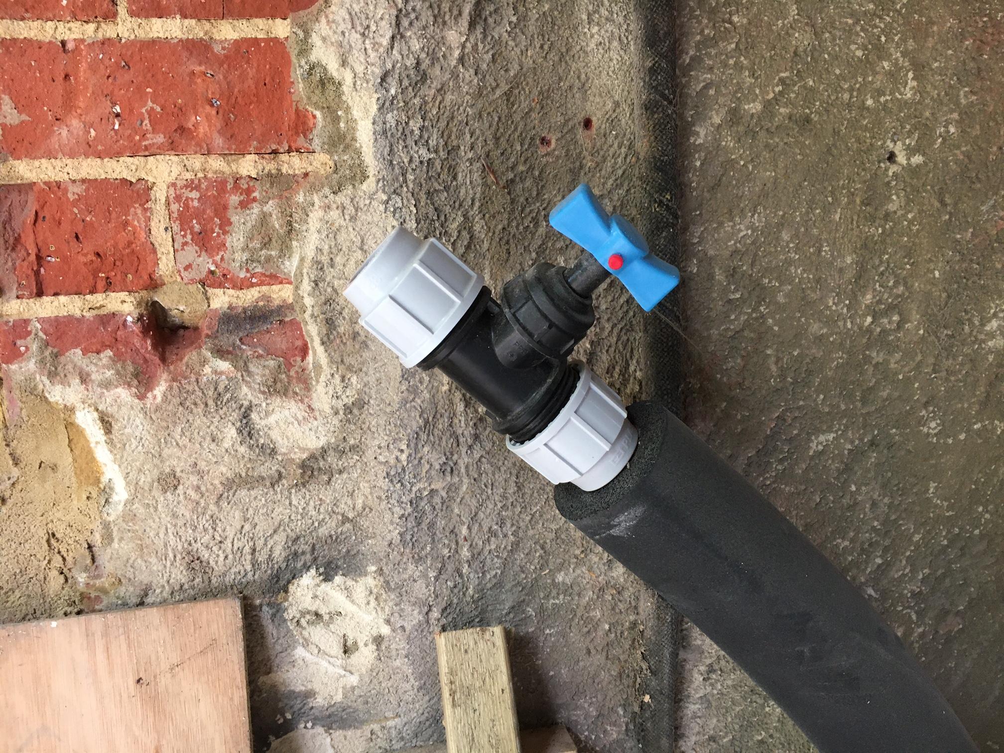

Mains water stop valve / cock value for 32mm MDPE
PI build replied to PI build's topic in General Plumbing
Thanks for all the replies. We spend ages looking for a valve with for 32mm MDPE inlet and 28mm Copper outlet with compression fittings, then found out that Plasson make a compression copper adapter set so you can fit a 28mm copper pipe to a 32mm MDPE compression outlet. Our supply pipe installation has now been approved by our water supplier -
We are having a 32mm MDPE mains supply fitted and SES our water supplier does not allow any fittings before the shut off valve. Are plastic valves suitable for this? I found one source that suggested they were not.

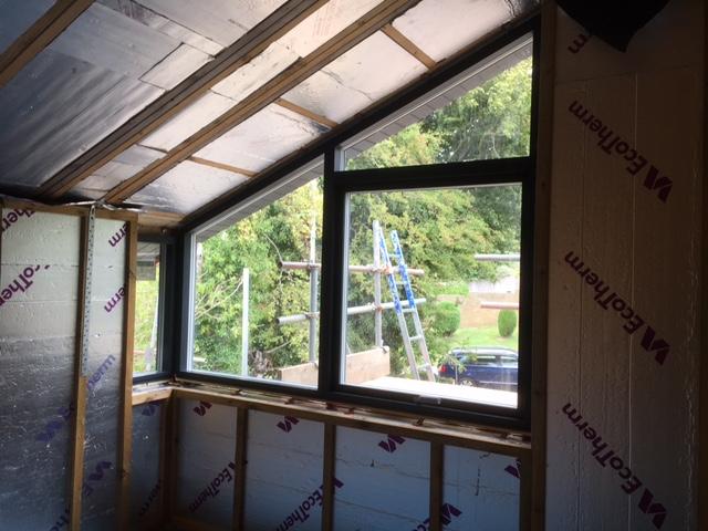

We got over excited by our architects plans without really thinking about how we are going to cover the upstairs windows. They mainly follow the line of the pitched roof and have an angled top. We are not fond of curtains (which may be tricky anyway) and conservatory style blinds are likely to be super expensive. Our current thoughts are cafe shutters which would only cover the rectangular part of the window which can be tilted by hand for privacy. Any other thoughts?
