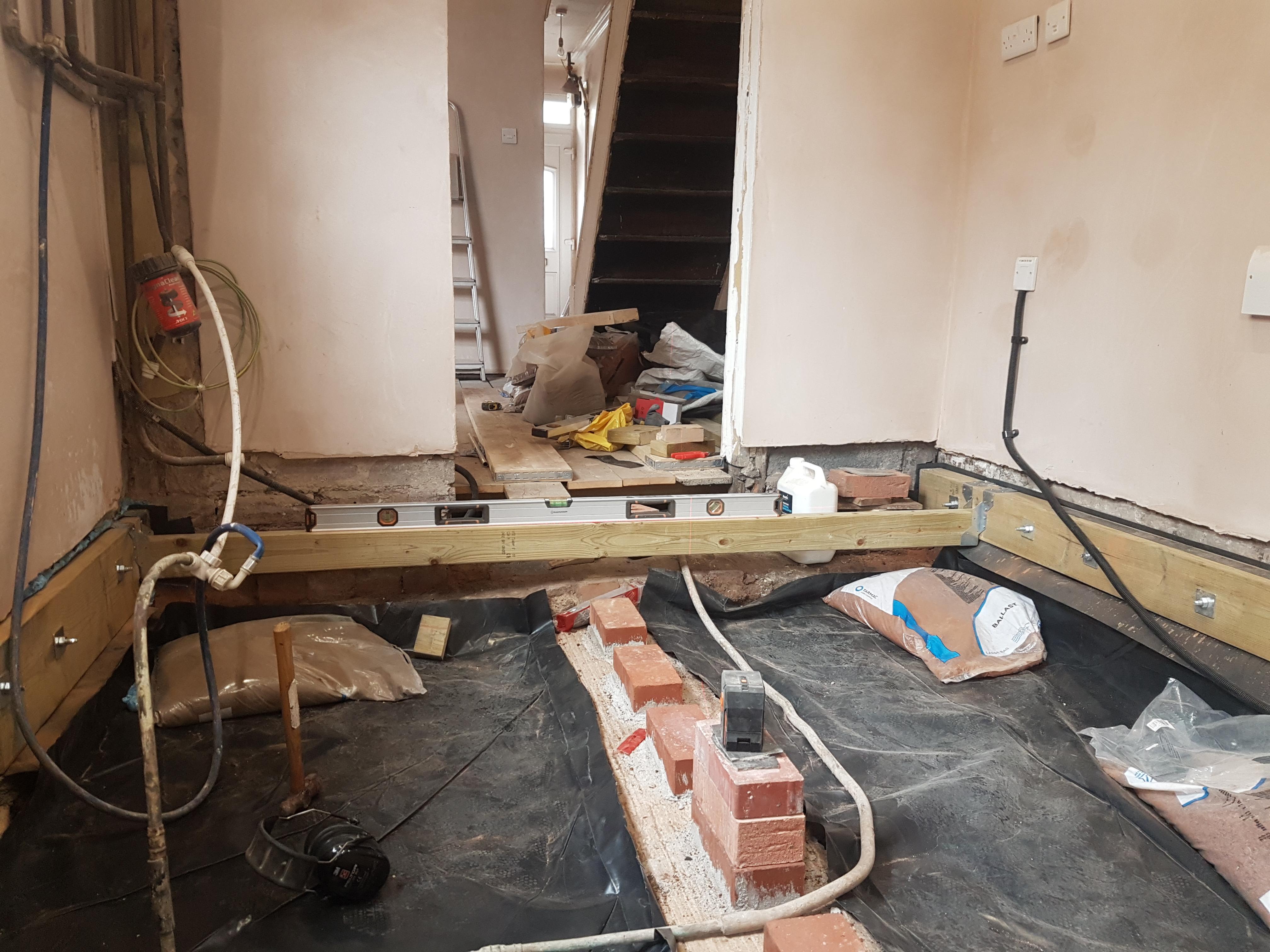

Bit of an update, I think it's the wood deflecting causing the creaking and it's only because it's not fixed in place, I think it will be OK once I nail them to the hangers and wall plate on the sleeper wall and it's all solid. New issue *sigh*. Some of the nuts on the left (as you look at the image) ledger plate have come loose. It's definitely not the fixing coming out as they re-torque up fine. I think I made a mistake, there were some gaps behind the board and I filled it with low expansion foam, thinking it would both fill the gap and give a little insulation. I think in reality, it's a little bit too flexible and allowing the nuts to loosen during deflection. What are my options here? I could try and inject behind with something hard setting? Or can I use loctite or similar on the nuts to stop them loosening? God this floor hasn't succumbed easily!

Hi Guys I've gone ahead and built this floor. I've got the joists resting in the hangers (not nailed yet) and when weighting some of the joists, they creak at one of the hangers. I can't quite pinpoint which part of the hanger is creaking but will this likely stop when the joist is nailed in place? I'll be fitting the joists permanently, fitting insulation and floor covering Saturday so want to get to the bottom of this noise before the hangers are no longer accessible. Thanks!

Thanks for the replies. Do you mean the joint depth looks small? Length wise it's cut pretty spot on I think. 100mm joists is all I could get away with leaving 150mm air gap below. With the sleeper wall deflection will be minimal. In retrospect perhaps I should have sacrificed air gap and put larger joists in. I did have concerns about the hanger not being fully against the plate but the plate is resting on brick footings, so I couldn't have anything behind the hanger but I could wedge some timber behind if that's worthwhile? The brick footings are too high and not level there's something like 100mm difference over the span of the room. I have insulation for between the joists and a new water main coiled up and ready to be ran this week but thank you for the recommendations. Thank you for the information on attaching to the wall plate. How should I attach the wall plate to the sleeper wall? Current plan was to lay it on mortar with dpc below it but wonder if I should put some fixings through into the bricks too? Thanks for all your help. It's a bit of a scrappy job and it pains me not to do it perfectly but I really didn't have much luck regarding depth to work with with the footings being so far out of level, etc.
It's a bit of an optical illusion, the joists have been installed at a level where there is 40mm between their tops and the floor level in the adjacent room and that's because I've got 40mm worth of floor covering to put on. Unfortunately you can't buy adjustable hangers for 100mm joists because no-one uses 100mm joists on floors but this is a Victorian house and 100mm is actually an upgrade compared to the rest of the ground floor! You can't see because the DPM hides it but the ledger plates are actually sat on brick footings but I've added resin fixings for good measure. Obviously in normal circumstances this arrangement wouldn't work but because it's a kitchen the ledger plate on the RHS will be covered by kitchen cabinets and the ledger plate on the opposite side is below floor level so won't be visible. It's just what I've had to deal with working with what's available on the house, everything is massively out of level. (This was the long story I was hoping to not have to type out)
Hi, just rebuilt a suspended floor at my house. Intend to build a sleeper wall mid-span and good job too as there is noticeable flex in the joists at the middle (although that is weighting them individually). It seems that I've either got enough room for a single brick course sleeper with a chunky bit of timber on top, say 3" thick laid on mortar, or two courses with no timber on top or an extremely thin board. Instinct says go for the first option but is also depends whether the joists should be attached to the sleeper wall or whether they just rest on top of it passively. Would you attach it, if so what method? Fixings through the top of the joists and down into the wall plate or through the side of the joists? And wall plate to wall, are concrete screws down into the brick Ok? P.S. Appreciate there's some odd stuff going on with the design in general - it's a long story! Thanks for any help.

I had done the cleaning process thoroughly, I just hadn't put enough resin in. I had 8 threaded rods already in place in a timber and chose to line them up with the holes and push them all in one go, this impeded my view of if excess resin came out of the holes during insertion. I would have preferred not to do it that way but was worried that if all my holes weren't perfectly straight that I'd struggle to get the ledger plate on once the fixings had set. I'd obviously not do it this way in future but at least I found out there were some dodgy fixings now and not once there was no longer access to them! Got lucky.

Ha, I didn't get round to it unfortunately. Got held up because half of the chemical fixings I fitted the day before pulled straight out of the wall when tightening. Turns out that assuming the holes were 2/3 full with resin was a bad idea - lesson learned the hard way!! Will attempt to do this after work today...
