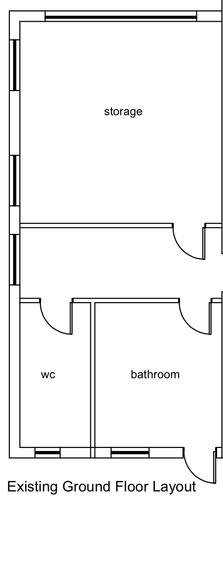

Evening everyone. The land/property I am looking to buy is an end of terrace plot which the owner of the last house has obtained PP to build a 2 storey house on and will be splitting the title for and then selling. Currently, there is an extension on that land the footprint of which is the same as the eventual houses. The extension was build in the 70s and there are no plans, certificates, or detailed planning documents. On the council's planning portal it just has the date of the application for an extension and that it was granted, without any further details. The extension has garage shutters on the outside but has for a long time been used by the current owner as a habitable room. On the new planning application is was put down as storage and bathroom. My question is, when the current owner applies to split the title of the property (and I have no idea how that process works), what is likely to become of that structure? Can it, for example, be registered as some sort of habitable space as it is? The new planning permission mentions "Subdivision of site involving demolition of garage and erection of an end of terrace 2 bed single family dwelling." One of the main reasons for asking is that between dividing the property and beginning construction may be a year or two and we would rather try to let the building in the meantime. Does anyone have any experience or clue about what would happen here and is there anything we can/should do to ensure that is feasible? I am attaching pictures of relevant parts of the application.

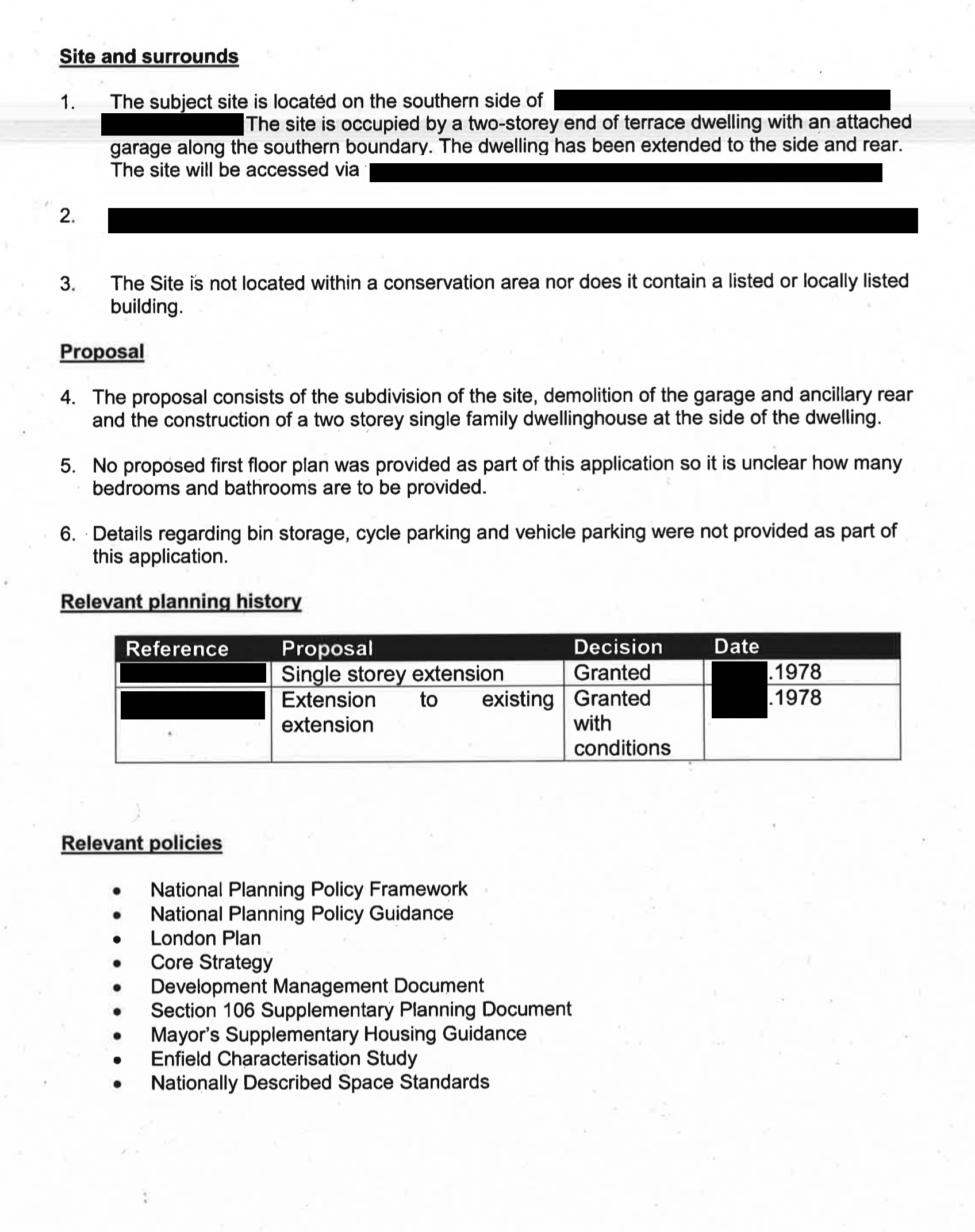

Good afternoon everyone Complete newcomer here who has no experience with planning applications or dealing with the council so will appreciate even the most obvious of advice. I'm negotiating purchase of some land that has planning permission. It's at the end of a terrace and the current owner is splitting his garden (which currently has a garage on it). In the surrounding roads, most similar plots have already had massive extensions built on them or new homes (but nothing very recently). Currently, the permission is for a 2 bed, similar to the standard, mid-terrace homes on the street. That, however, leave 2-3 metres of empty space on the side of the plot which others have included in their construction. Others in the area have also build further back on the first floor. None of this was put in the application by the current owner, but I would like to do that at the time of construction as well as add a basement and/or living space in the loft. I'm attaching an arial picture of another house which was build on an almost identical plot where they have extended out to the side on ground floor and backwards on first floor, compared to the other houses mid-terrace house (one of which is in the picture). An added complication is that the permission has the following clause and I'm trying to understanding if that means we can't do anything ender "Permitted Development" now or in the future. "16 - Notwithstanding the provisions of Classes A, B,D &E of the Town and Country Planning (General Permitted Development) Order 2015 or any amending Order, no buildings or extensions to buildings shall be erected without the written permission the Local Planning Authority. Reason: in the interests of safeguard the residential amenities of neighbouring properties and the appearance of the property in the wider street scene." Please advise what you make of the above. Also, in general, what would be the best way of going about things to try to make sure I get permission for what I want to do? Would it be, for example, to begin construction and apply for some sort of amendment? Would it be to arrange a meeting with the planning officer to see what they say? Would it be to submit an entirely new planning application, and if so, what would be the risks or benefits in that?
