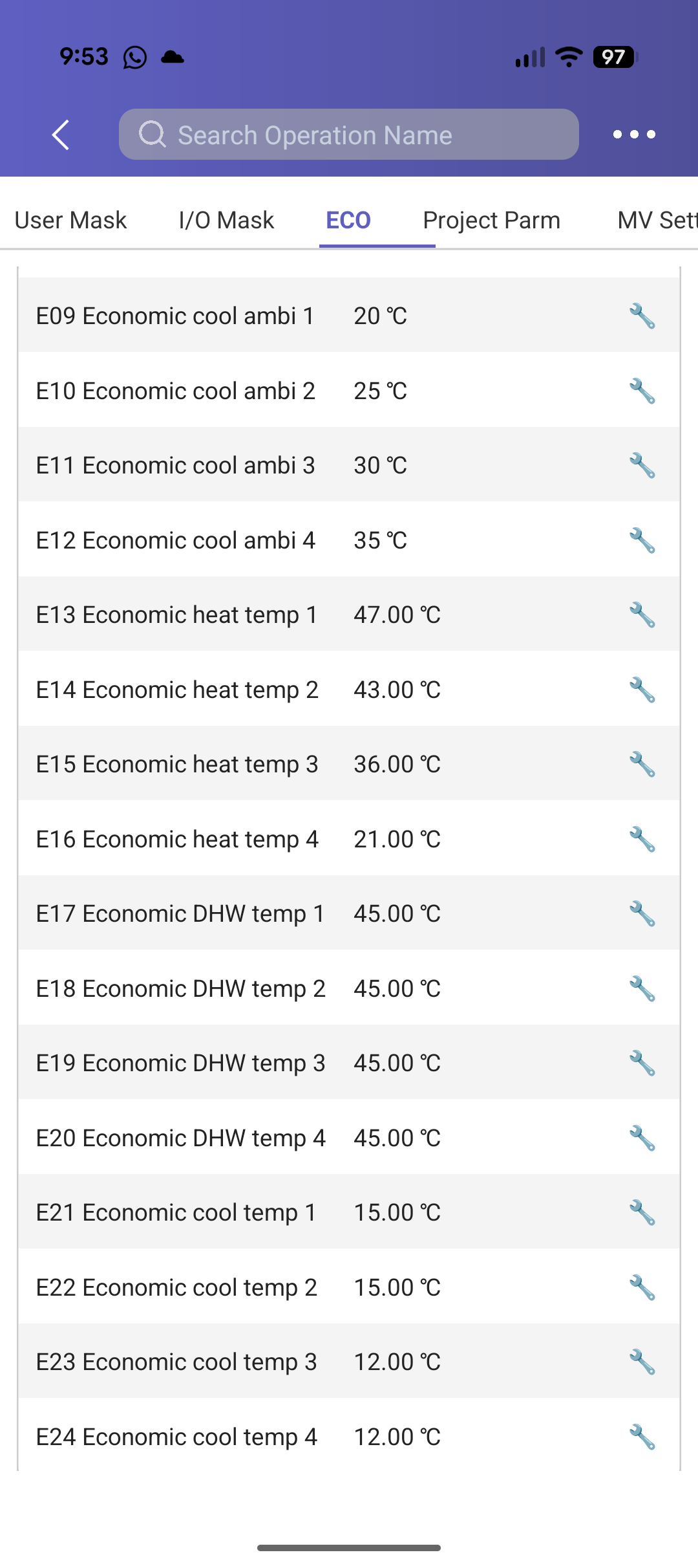

  6. @dpmiller thanks for your response. Yeah, it always displays heating when it's on and in a heating mode (either just heating or heating + DHW) It looks like the settings are the same as the Carel ones you've described. I therefore assume when in eco mode (weather comp), the DHW settings for each of the four setpoints should be set to my desired hot water temp? Also, unlike heating which is the flow temperature setpoint, am I right to assume for hot water it's the cylinder temperature setpoint? Anyway, I've adjusted the eco settings to all be 45 degrees regardless of outdoor temp (see screenshot) - hopefully that does it

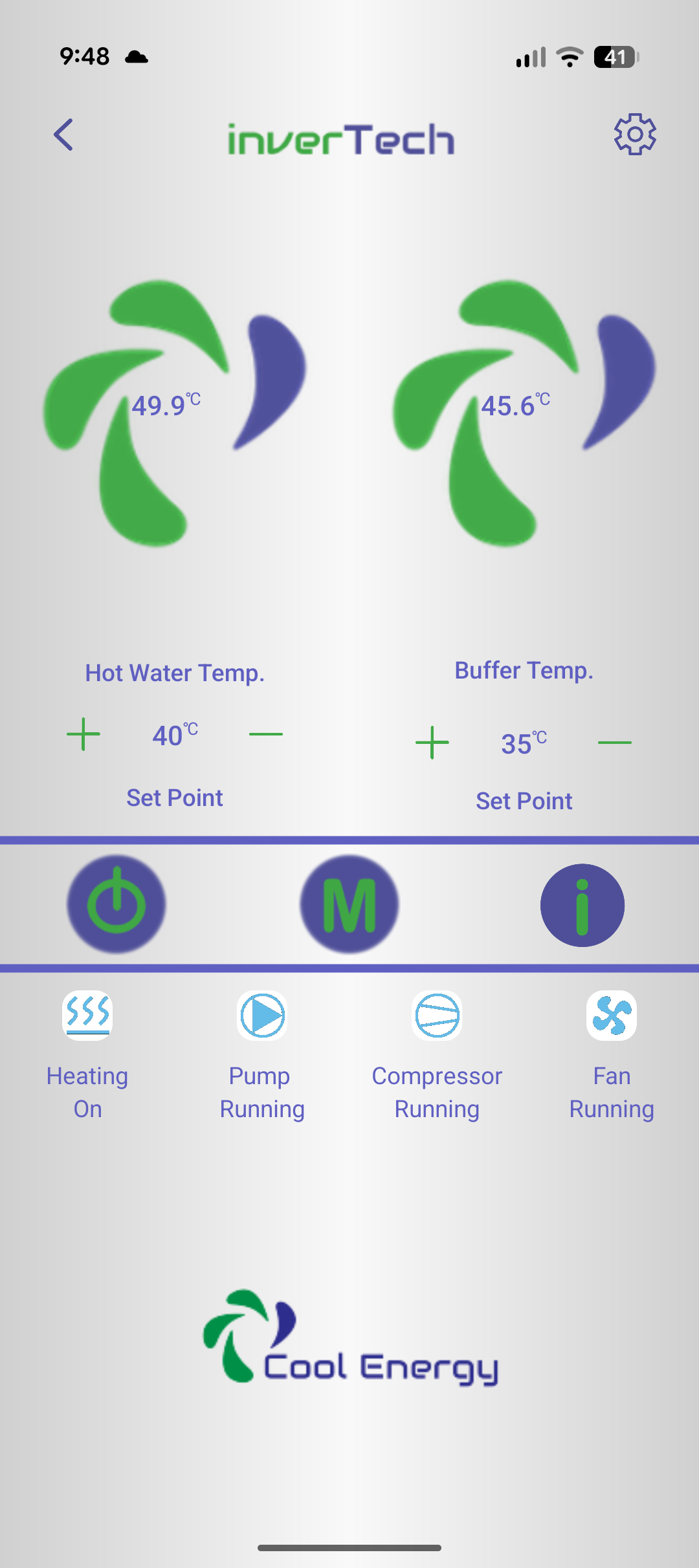

  7. Well that didn't seem to make a blind bit of difference... DHW setpoint changed to 40 degrees and hysterisis set to 5 degrees. DHW heating cycle seemed to kick in around 40 degrees cylinder temp and went on to reheat to ~50 degrees. 🤷

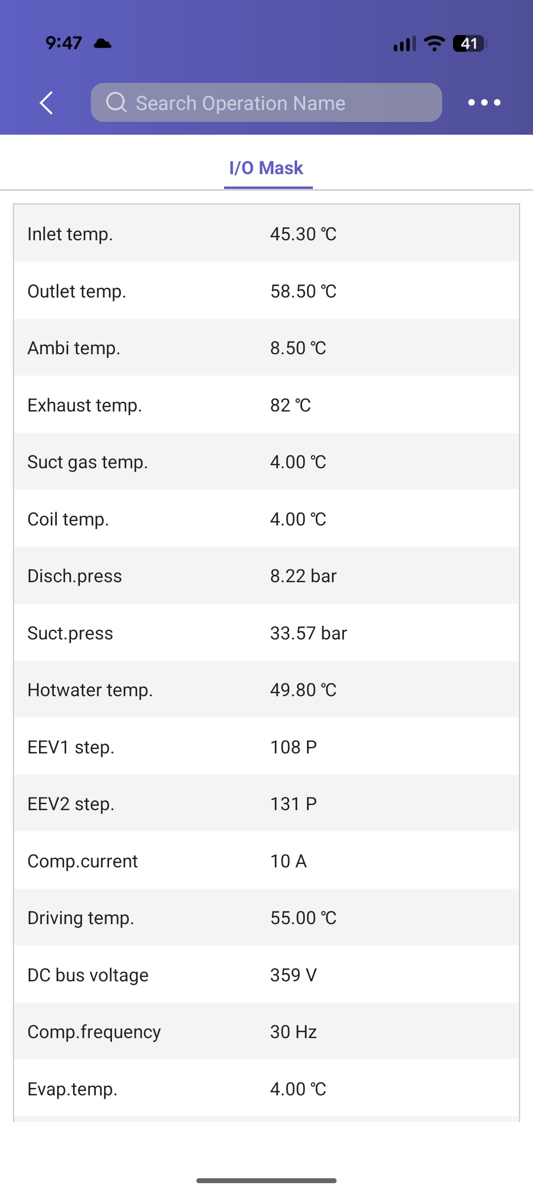

  10. I'm reading the temperature of the cylinder temperature sensor which is displayed in the controller and app - the sensor is halfway up the cylinder...
