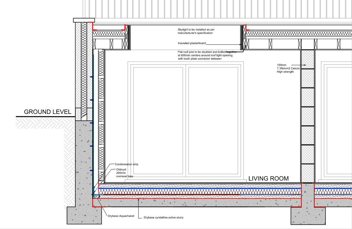

If you're using ICF and they're insisting on type C protection then shouldn't it be the detail below (if you're using delta) https://www.deltamembranes.com/technical/technical-drawings-icf-construction/ That shows the recess in the slab as you've mentioned, I did something similar in my own slab but the formwork was built off the underpinning as mine is a refurb. Not sure how easy that would be in a raft slab. To achieve type B protection would waterproof concrete not be an option? No idea how much that costs though, from what I've read you end up having a rep from the supplier overseeing all placements. I would suspect ICF lends itself well to type B considering there won't be many, if any, day joints in the concrete.

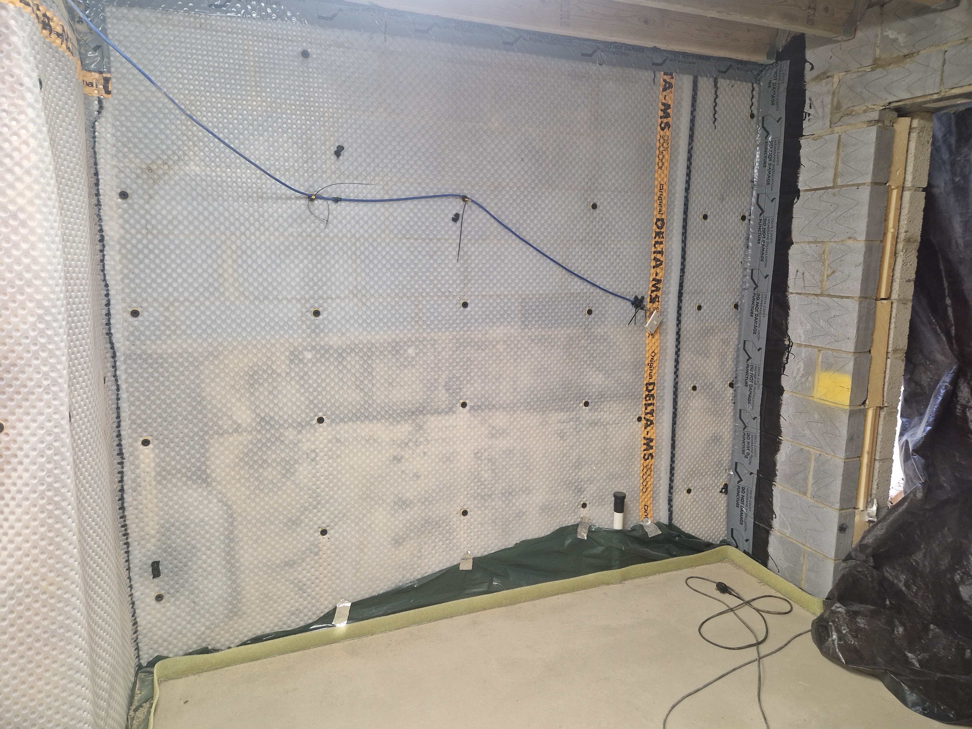

Blanks should have been blocks. The joists sit in the hangers so aren't touching the wall. I'm thinking maybe air tight sealant and then paint with air tight paint on the block wall and around the hangers. -

I thought maybe a photo might help illustrate what I'm attempting. You can see the reinforced concrete and block wall behind the cavity membrane. I'm mildly confident the cavity drainage membrane will help with air tightness even before the VCL is installed. My concern is the block wall you can see to the left of the picture. The joists are in joist hangers set on top of the blanks, so they'll also need some attention. Any thoughts? -

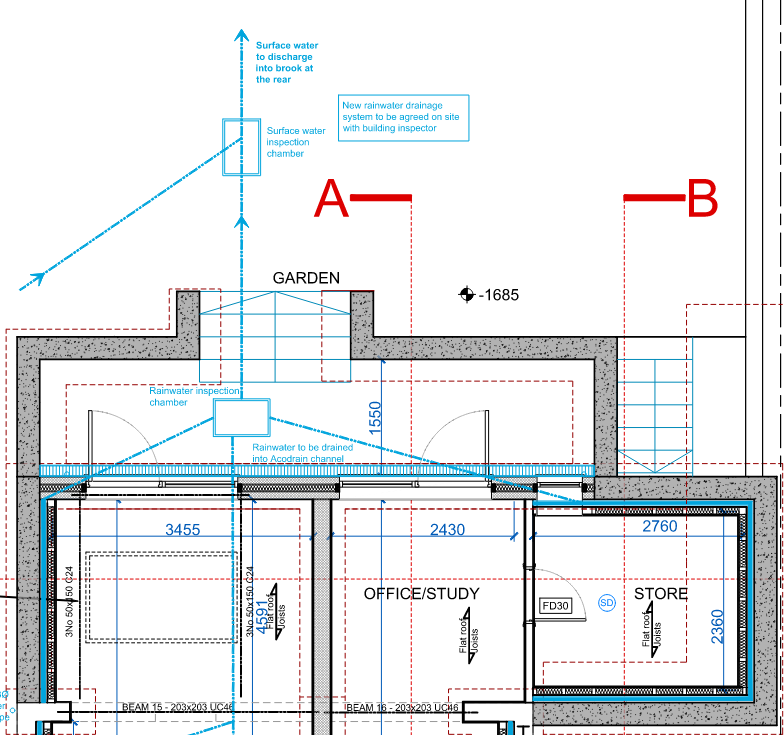

I thought it might be difficult to explain on my phone without access to the drawings. The above shows a snapshot of the extension, the back garden is circa 1.7m lower than the street level at the front of the house. We have constructed a reinforced concrete retaining wall and built on top of it. The waterproofing membrane has been installed to be above the DPC for those walls. My intension is to install the internal wall insulation to "overlap" the cavity wall insulation, as best as I can. The elevation facing the back garden is within a small lightwell. Those walls do not have cavity drainage membrane on the majority of them (snapshot below) This was something Delta Membranes detailed within their instructions as an option. I have already sealed the tops of all of the membranes and introduced airbricks to ensure there is some ventillation to the cavity, as per their instructions. I am intending to install a VCL to the warm side of the internal insulation and have already installed one in the floor, with enough left to join it onto the wall VCL. We have a warm roof on the extension, which doubles as a terrace for the ground floor. The VCL has been installed to the warm side of the insulation on this already. Hopefully some of that clears up the lack of detail in my original post. -
Prior to my finding this place I embarked on the lower ground conversion and extension. The extension is a masonry cavity wall, the original house is a solid brick construction. In the lower ground I've installed a type c cavity drainage membrane and I'm going to be installing internal insulation throughout the lower ground, overlapping slightly the new cavity walls. The extension has maybe 30m2 of bare thermalite blocks after the waterproof membrane was installed, from what I've read I around here they'll need some kind of airtightness detail to help with that. What I'd like is some pointers for how best to achieve an airtight finish within the environment I've got. Any areas in particular I'll need to look at closely?
