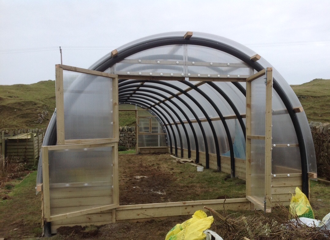

@saveasteading the salmon cages start off as big floating cages for rearing farmed salmon, when they reach the end of their useful life they get taken ashore and cut up. people use the mdpe pipe for all sorts around here as far as I know the companies give it away to save on paying to dispose of it as it would probably end up in a landfill. they fill them with concrete and use them for fencing, cut them in half and use them for animal feeding troughs, road crossing pipes, ducts, all sorts. the absolute best thing they are repurposed for is a community run company which uses the 90mm pipe for the frames of bombproof polytunnels, they have been designed and certified and you see them everywhere now, I even saw they were ordered for the Falkland Islands - proven to stand up to over 100mph wind in shetland. they are called polycrub and have a Facebook / website, worth a look as it is brilliant. im going to look into using the pipe as some sort of fill or attenuation a bit more, I think you are right about being better used in length with a lot of holes in it. -

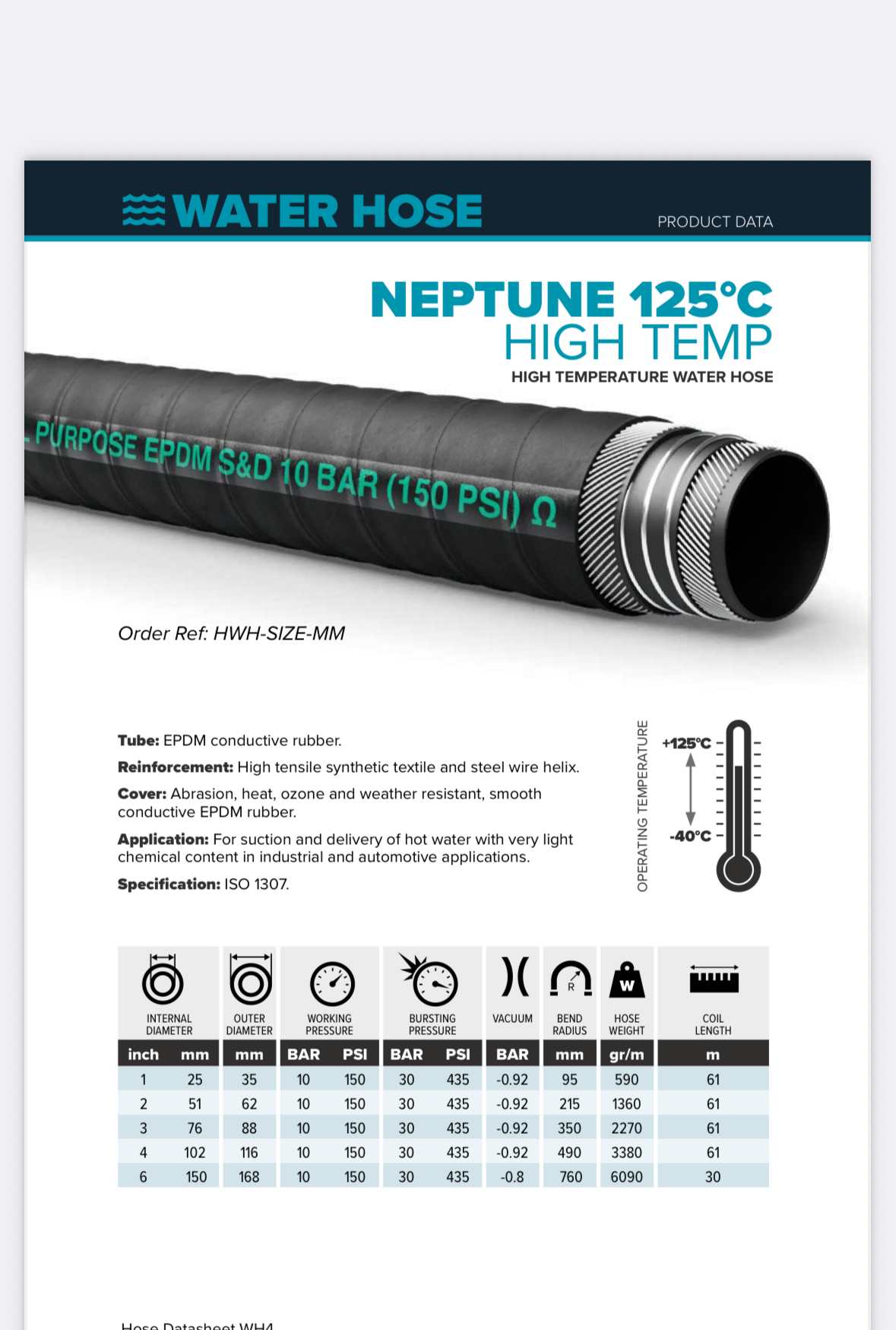

ASHP flex hoses
newbuild upnorth replied to newbuild upnorth's topic in Air Source Heat Pumps (ASHP)
Thanks for that @Nick Laslett thats just the info ive been searching for. looks very similar in spec to this stuff which i could get by the meter and get hose tails for, ill search some more to make sure theres no max guideline for hoses but i cant see why there would be. Im not planning on going crazy just 1.5 - 1.8 meters maybe. -
ASHP flex hoses
Well if i can get long ones i wont need multiples. I need flexis off the unit then also flexis up my ducts. if i can be confident in the spec i dont see any reason not to run hose from the unit to inside the house, potentially less heat loss, less joins, less turbulence? I dont see any negatives. -
Does anyone know the specifications of the flexible hoses used on ASHP. is it just 10 bar epdm lined hot water hose with a stainless braid? Basically im looking for longer hoses so i dont have to go from flexi to pipe to flexi to pipe and in doing so reduce fittings and connections.
