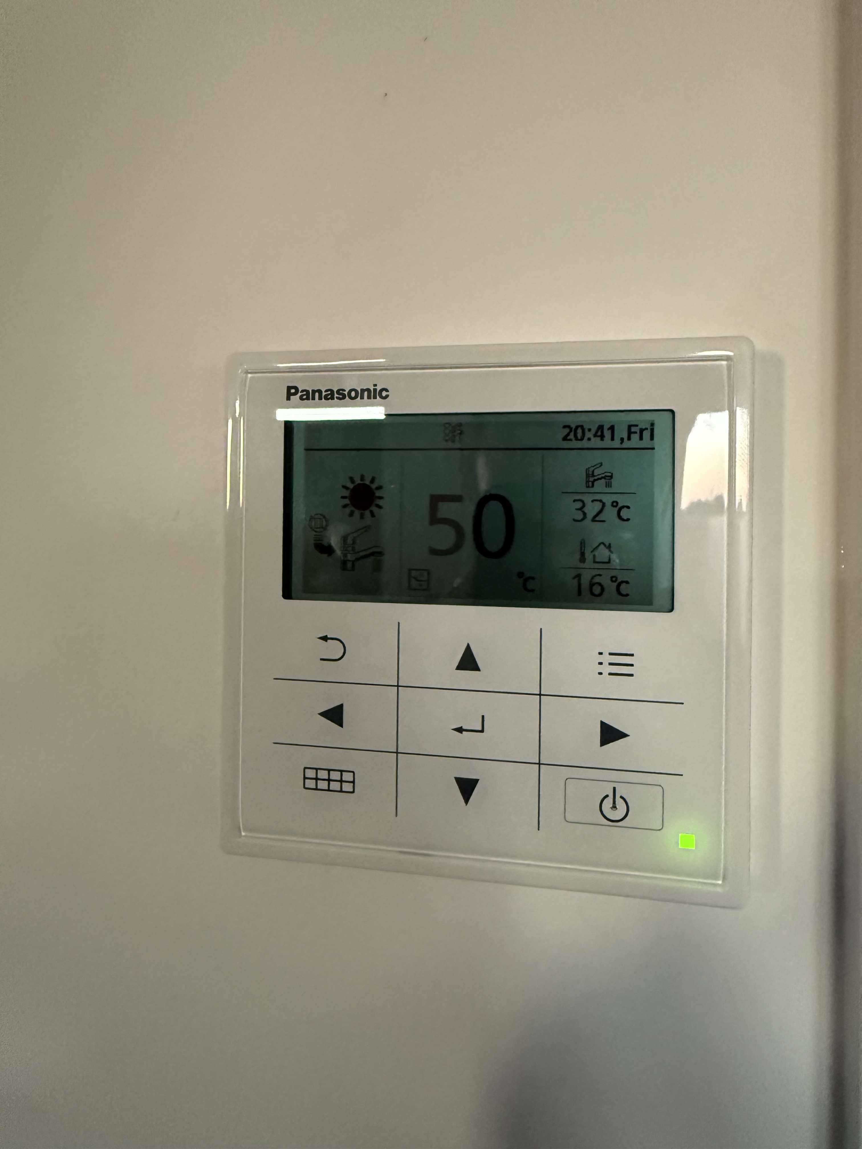

  5. Hi everyone, I’m trying to reply individually. I have contacted customer service and they are trying to help me out as for some reason I can’t reply to anyone. Below, i added a screenshot from yesterday’s kWh usage. And screenshots from today’s 8:30am when i wasn’t even home and a screenshot from 16:30 for a quick shower for my two year old son. I’ve noticed that it’s been since Monday (17/11) that we have been using a lot of electricity, I’m not sure if it’s a coincidence but our new fridge came on that day ( same as the previous one but had to be changed due to a fault ) My house is a new build that was build in 2024 and i moved in this year in February. It’s a 3 bedroom house
  6. I’ve attached weather compensation curve and weekly timer!
  7. Model: Panasonic WH-MDC05J3E5 Octopus Agile Tariff Hi everyone, urgently need help as I can’t keep up with the costs at the moment🤦🏻‍♂️ I have attached some screenshots and pictures what might be important to know My heat pump is in the back garden which is an open field after my fences
  8. hi, I’m new to this website, sorry if this is not the right place for this topic I’m a new build home owner, been here for 2 months. First time using heat pump. I messed up with the settings and i have no clue what to do. What temps etc looking for help to set the weather curve and whatever needs doing. Model: Panasonic WH-MDC05J3E5 Cost octopus tariff
