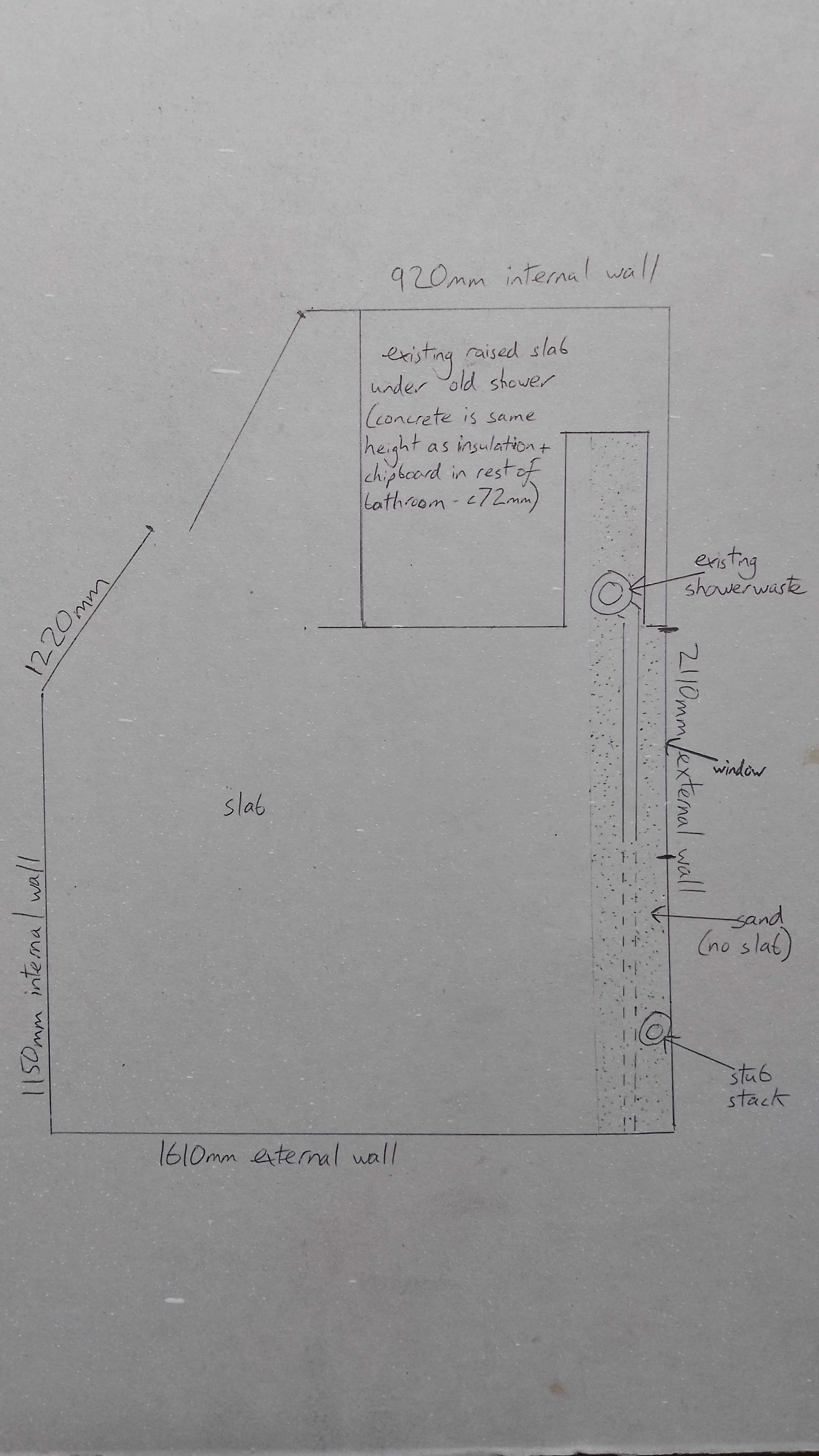

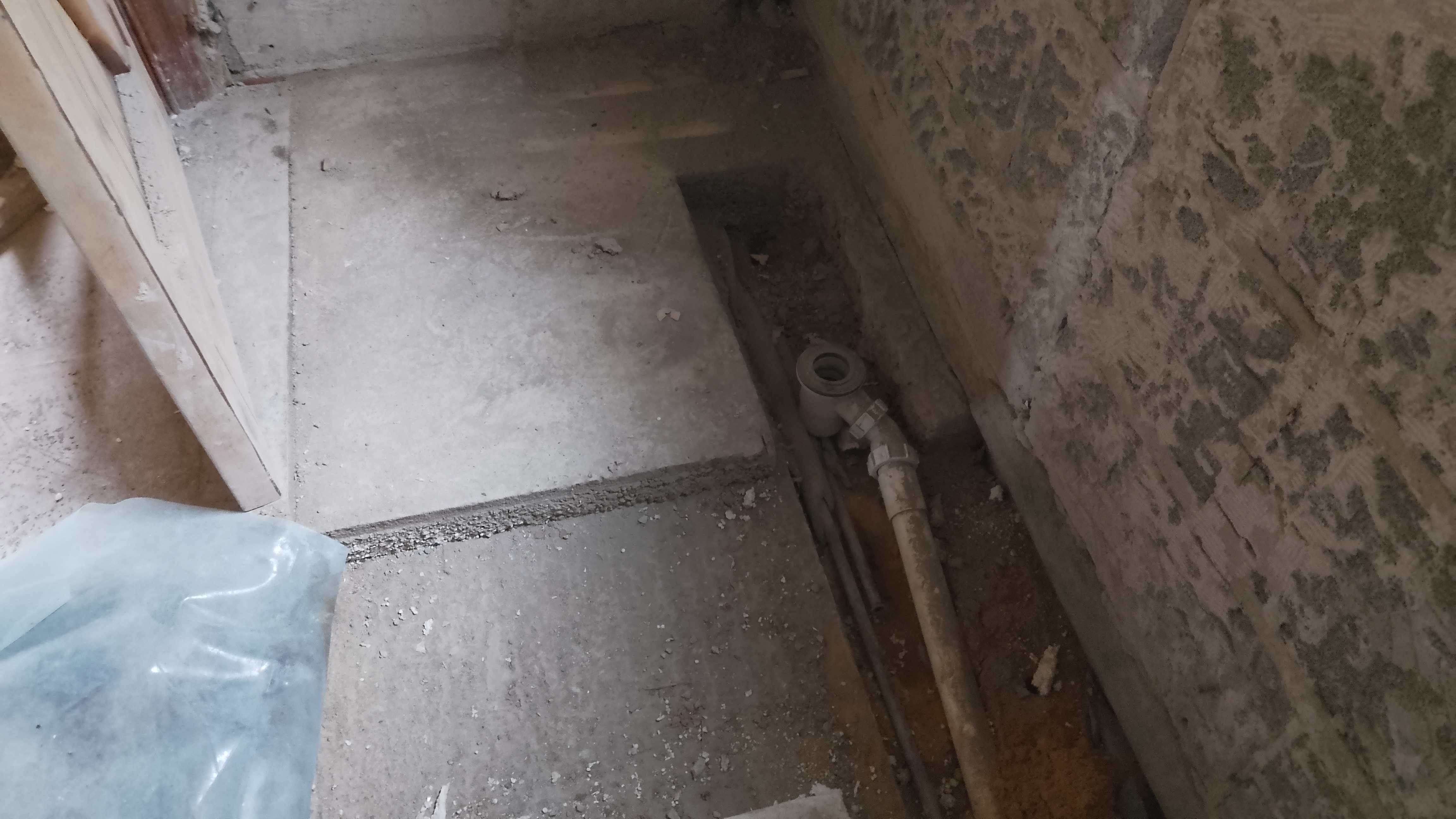

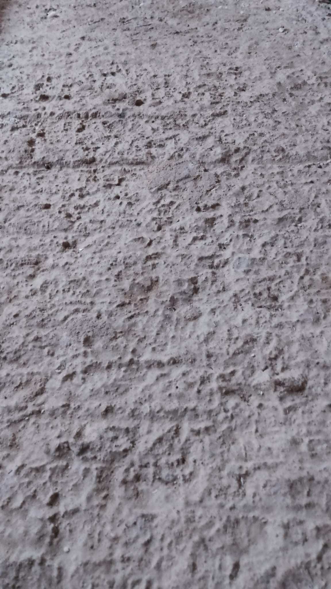

Thanks @Nickfromwales - those pictures look great. It's my first wetroom installation and I'm nervous of making mistakes, so I might be a bit belt and braces (and holding the waistband with both hands) with it. It's a bungalow with a concrete slab, so once I've installed the waste on to the existing pipework it'll be pretty inaccessible. Do you have any tips for reducing the chances of leaks? I'm presuming solvent weld rather than compression fittings, but is it worth eg embedding the pipework in waterproof hydraulic cement (it's currently rested in a bed of sand in a strip down the side of the bathroom where the slab ends before the wall). Coating the pipework in anything? Types of shower former like linear drains where the pipework might be more accessible? Or even embedding a moisture meter probe hidden in the stud wall? Thanks again!
I've taken the advice from @Nickfromwales and I've put the batten idea out of my mind! The XPS solution sounds excellent and I've been researching over Christmas in preparation. I like @garrymartin's idea of a second layer at right angles, as this will give me depth for dropping in an XPS shower former. So from concrete slab upwards: 1) 50mm Ravatherm XPS (https://www.insulationuk.co.uk/products/ravatherm-xps-x-300sb-extruded-thermal-insulation-2500mm-x-600mm-50mm?variant=52655697101134) stuck down with S1 tile adhesive. 2) 20mm XPS tile backer board stuck down at right angles, again with S1 tile adhesive. A 20mm XPS shower former will then be level with the rest of the floor 3) For the walls, 12mm tile backer board 4) Tape all joins then membrane over the floor 5) UFH mat, then - if feeling brave - S1 tile adhesive straight over for tiles My subfloor looks in fairly good condition for attaching the XPS (the slab doesn't reach the wall, however, and there is an area of sand where the drain is embedded): Does this sound about right? I'll take the same approach for the kitchen floor. Will I need to tape all joins here as well? In the absence of a polythene VCL it would act as a VCL to stop moist air reaching the slab, although in a 17sqm room all that tape will be expensive! Thank you again

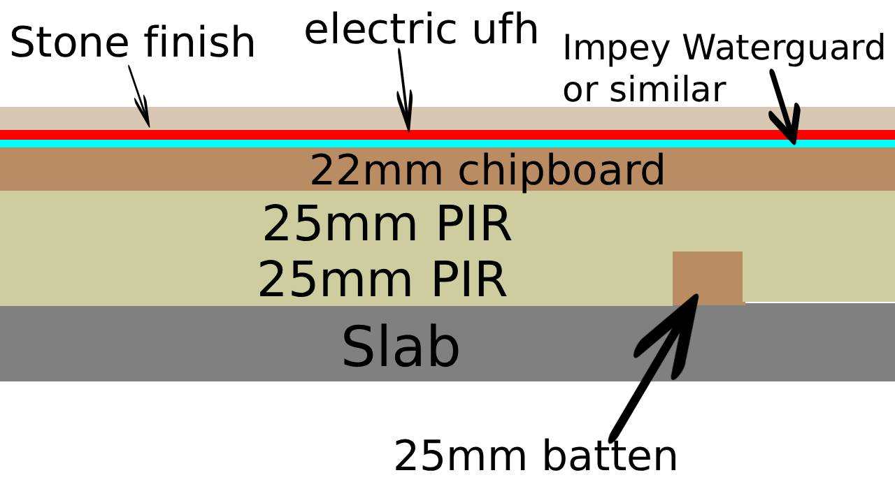

Thank you both. It's a renovation that previously had 50mm polystyrene on the slab, topped with 22mm chipboard, so I don't feel I have much choice about it being floating. My thinking was that the battens would provide more stability for tiling. I would screw the battens to the slab, then screw the chipboard to the battens. I'd originally thought about XPS tile backer boards adhesively stuck to the slab, but manufacturers seemed to think tongue and groove was essential. Would there be a better way, do you think?

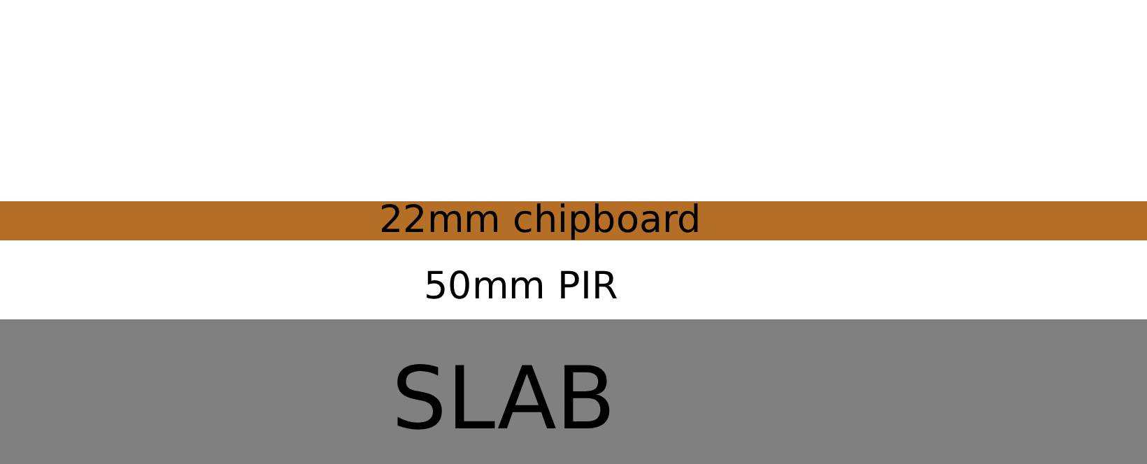

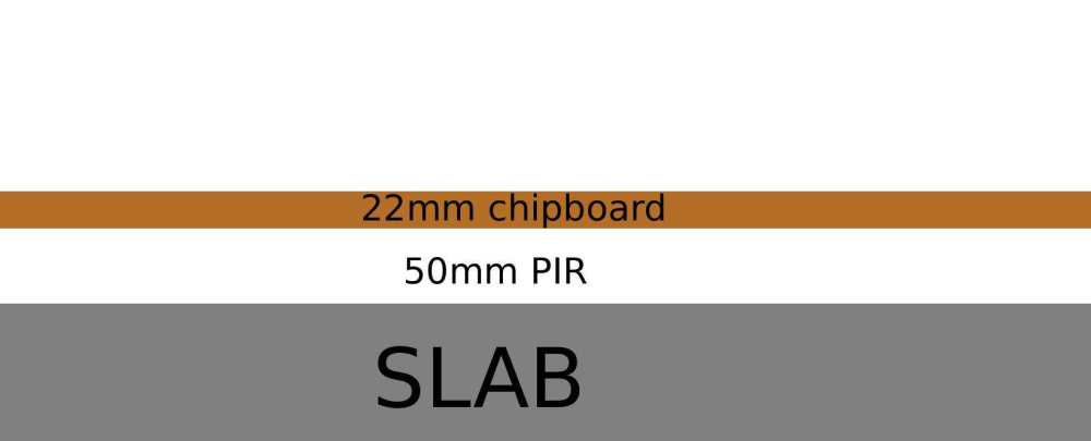

Hello - I was wondering if you'd be able to sense-check my floating floor plan, please? The wetroom is just a corner of the bedroom, about 3.7sqm. In the bedroom, I'll be putting 50mm PIR on the slab, topped with 22mm chipboard. For the wetroom floor, I therefore thought I'd do the same, then topped with impey waterguard, electric ufh, and natural stone. To help with stability on the floating floor, I thought I could add a perimeter of battens like in the picture below, and screw the chipboard into it: Does this sound like a plan? Thank you.

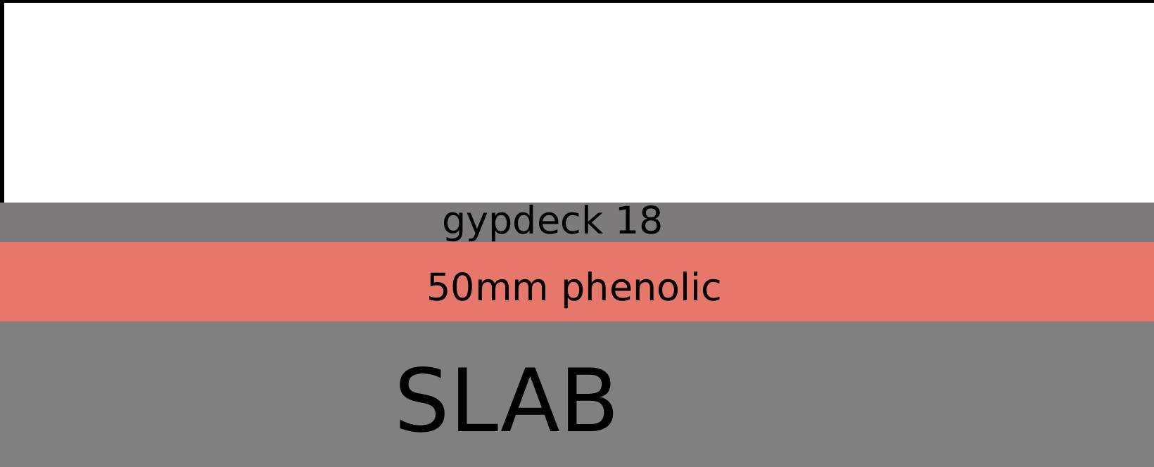

Hello! My floating floor research continues...I'd posted previously about options for wetroom and kitchen flooring and got some useful feedback. I've now got three options. It's an all-electric bungalow; bathroom is about 3.5sqm and kitchen about 20sqm. Old floor: concrete slab, then 50mm polystyrene, and 22mm t&g chipboard on top. I'm keeping the concrete slab. I'll add electric heating mats as a secondary heat to take the chill off the stone tiles. Option 1: 50mm PIR then 22mm chipboard. Basically, what was already there. Not sure about chipboard in a wetroom - would I have to cover it with 6mm tile backer board, which will add to the height? Option 2: Phenolic foam and gypdeck 18 gypsum fibre board. The best insulation (equivalent to 70mm PIR) but very expensive Option 3: 50mm PIR then a low profile wet system like this instead of boards: https://www.elementshop.co.uk/profix-plus-panel-low-profile-system-20mm-depth-14-17mm-pipe?gad_source=1&gad_campaignid=17190333812&gbraid=0AAAAAoLtzP8iYrR1bZmw5I1Nv6dekc2Bc&gclid=Cj0KCQiAoZDJBhC0ARIsAERP-F_Hahv5xh4NmuS9ME_vn1_shoXRaCY0TsHN_pwsQQTPzPKcmpZu_QkaAnxFEALw_wcB Together with electric ufh, this would futureproof me if I ever got a heat pump. Would this also give me some thermal mass if I heated the electric ufh on overnight offpeak? Are there any better options? Thanks!

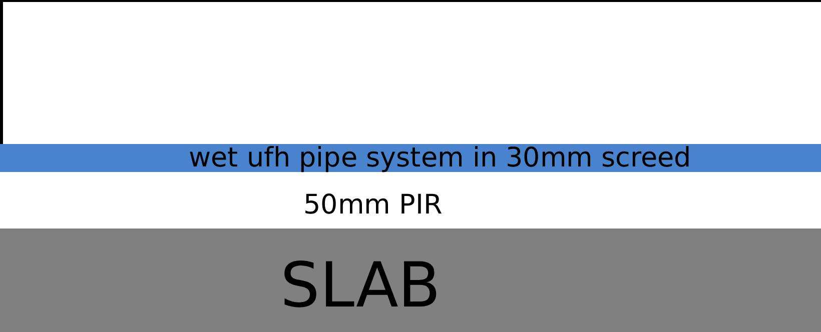

I've continued my floating floor research for the wetroom and kitchen and I've come down to three options to put on top of the slab: - keep it simple and cheap with 50mm PIR topped with 22mm t&g chipboard. - 50-60mm phenolic topped with gypdeck 18. The gypdeck's lambda is 0.038, so if I squeezed in 60mm phenolic this buildup would be the equivalent of 80mm PIR. - 50-60mm PIR topped with a low profile screed system like this one: https://www.elementshop.co.uk/profix-plus-panel-low-profile-system-20mm-depth-14-17mm-pipe?gad_source=1&gad_campaignid=17190333812&gbraid=0AAAAAoLtzP8iYrR1bZmw5I1Nv6dekc2Bc&gclid=Cj0KCQiAoZDJBhC0ARIsAERP-F_Hahv5xh4NmuS9ME_vn1_shoXRaCY0TsHN_pwsQQTPzPKcmpZu_QkaAnxFEALw_wcB which would future proof me for a wet system, without raising the floor height Floor finish will be electric ufh then natural stone. Is the extra cost of the phenolic or gypdeck worth it, or would it not provide enough difference? Has anyone had experience with the gypdeck? Thank you -
