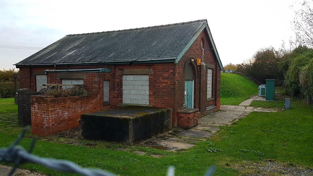

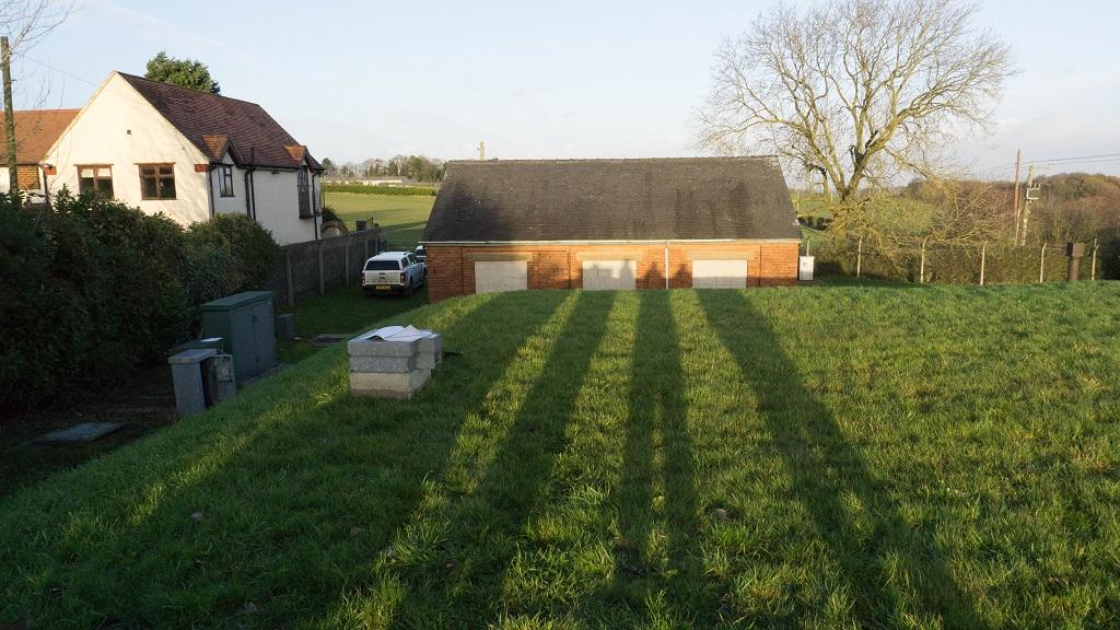

Hi, I’m trying to determine if the waste system we have on our building plot is a septic tank or a cesspit. The property is an old water pumping station, which we believe was build in the 30s, or possibly earlier. There is only one apparent chamber, one manhole, which leads into a circular brick structure which holds in the region of 3500L. The tank is currently only used by our neighbours, who live in what was the engineers cottage. Severn Trent sold the cottage off a long time ago, which is now separated from our plot by a brick wall. We need to work out how, legally to best deal with this with our neighbours, but could first do with knowing if it’s a septic tank or cesspit. The land registry state it’s a cesspit, but other documents mention a septic tank. Looking at a modern septic tank, they have more than one chamber, each with their own access hatch. So it would seem we have a cesspit, but it’s only emptied every 8 to 12 months, which seems a longtime for a cesspit. Can anyone shed any light on this? Kind regards Dave C

Hi, We're currently waiting for planning to come through the conversion of an old Severn Trent pump house and tank, but whilst we're waiting, we're starting to plan some of the required ground work. One of the issues we need to address relates to an old septic tank. The tank is currently used solely by our neighbours, who's house use to be where the waterworks engineer use to live back in the day. Now the pump house and tank are a separate plot, sold off by Severn Trent, we have the pleasure of housing the tank which our neighbours use and have access to in our front yard. In developing the house, we will need to utilise the same septic tank as there is no mains drainage. We've previously had the tank emptied and inspected, together with a camera inspection of the pipework. The tank is a circular brick construction, with a flat bottom that we believe holds 3,500 litres, this is how much the form had written on it the last time it was emptied and it was full. The tank doesn't empty into a ditch, but we believe drains into a septic field of some type. Unfortunately we have no information on this. The company that emptied the tank for us, County Drains in Coalville, recommended that we continue to use the same tank where possible as it appeared to be working perfectly OK despite it's age, rather than look at installing a modern 'plastic' alternative, as in the engineer's opinion the old ones are much better. Our concern now is whether the tank is big enough to accommodate the requirements of two houses. Our neighbours house has six bedrooms and we're looking to build a property with four bedrooms. I understand you can calculate the required tank volume from this, but I guess I was more interested in knowing: 1. can two houses share the same tank and if so, are there any restrictions around this? I guess as our neighbours have a right of access to the plot for the purpose of emptying the tank, we need to continue to support their needs. 2. could we make the existing tank bigger, i.e go down or is this simply a non starter? ( not a job I'd be volunteering for ) 3. if we were to replace it, I'm assuming it would be less hassle to retain a single tank for both properties rather than ask them to get there own... think there would also be some legal implications as well and bad feeling if we took this route. 4. should we look at a more modern water treatment option rather than just a replacement septic tank and if so, which options are available to us. Would anyone have any contacts in the local area, Melbourne in Derbyshire, that they would recommend we speak to in order to get some advice and pricing? Many thanks Dave C

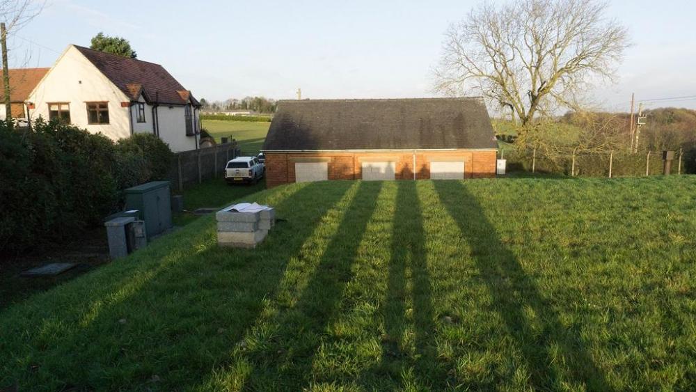

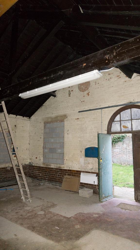

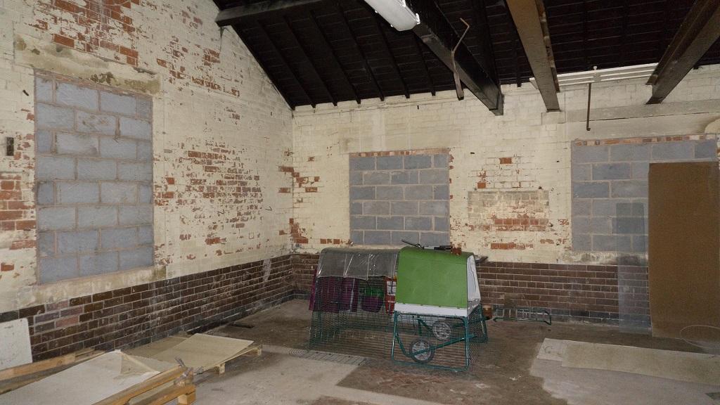

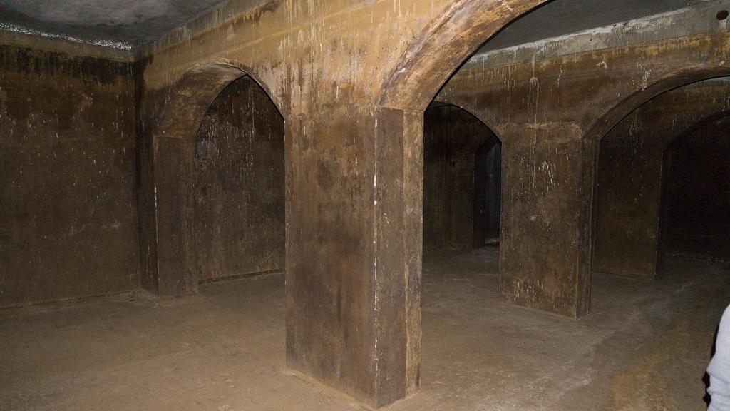

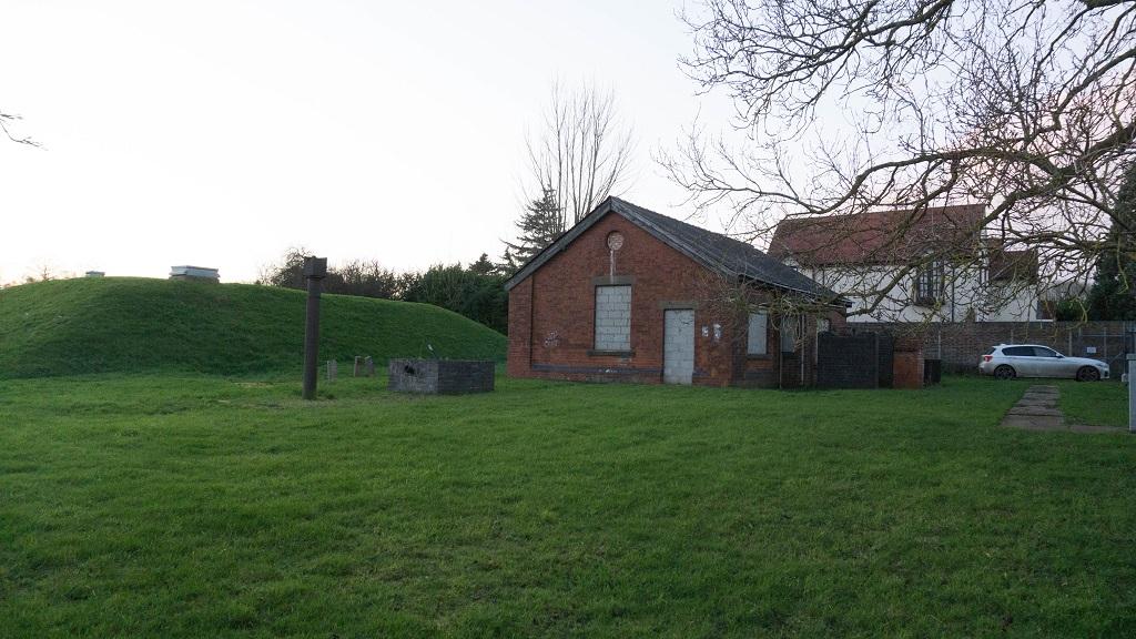

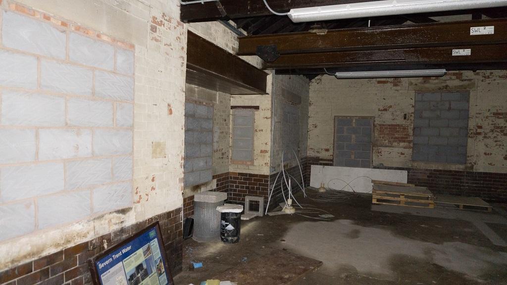

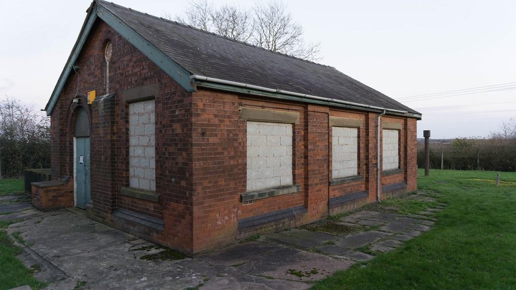

I'm hoping this site will be both a source of inspiration and a shoulder to cry on over the coming months, if not years. My partner Helen and I purchased a disused Severn Trent Pump House and DSR (Distribution Storage Reservoir - great big concrete water tank) back in February 2018. The half acre plot came with full planning consent to renovate the existing brick Pump House, build a new section to link the Pump House to the concrete water tank and to convert the tank into living accommodation. It was a very contemporary, flat roof design, not really us, so we've spent the last year coming up with a new scheme and starting to clear the site ready for the build, once planning have given their seal of approval. This is the first time Helen and I have taken on a project like this. We've both undertaken extensions and small alterations in our separate lives, before we met, but nothing on this scale. Whilst a slow start, this has given us time to think. I can't count the number of visits we've made to the plot with a picnic in hand, to sit on the grass roof of the tank and get a feel for the place and to imagine what it would be like to live there. We've also had time to look into the history of the site and helped by John Simpson from Severn Trent Reunited - http://www.st-reunited.org.uk, we've been able to find out quite a lot. We've even had the pleasure of meeting the children, who's father worked there and his father before him. Some of the old photos have also been passed on, a lot of which are on the reunited web site, but I'll post some of these as we progress. I've attached a few images of the site, as it was when we purchased it back in 2018. We've since removed the earth banks from two sides of the tank, so I'll upload some more recent shots later. We're both very excited about the build, but realistic about the challenges ahead. We couldn't have wished for a better location and the opportunity this has given us. Happy days! Dave & Helen
