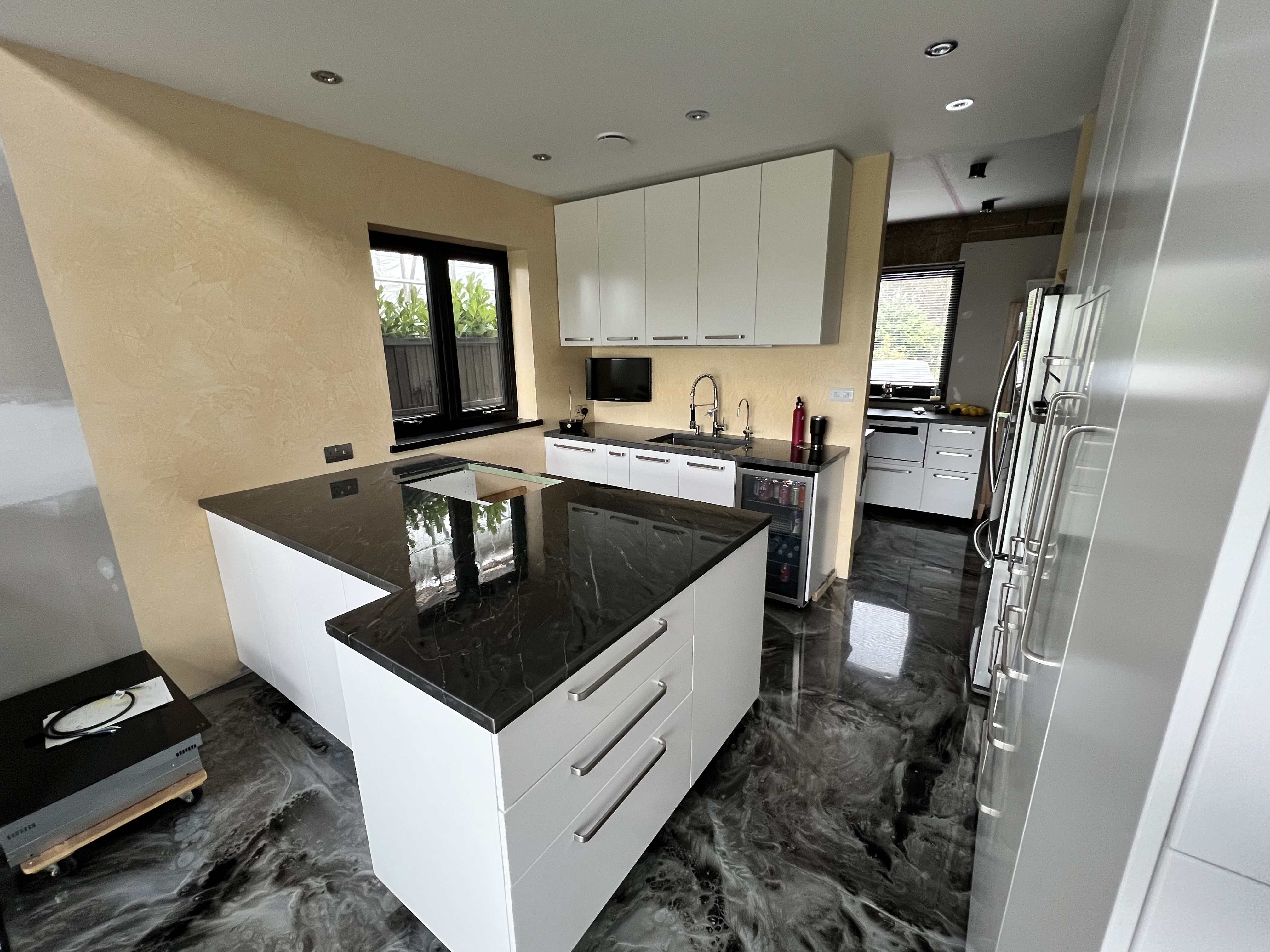

  3. My plan now is to try again using microcement with black pigments for the worktops. Should be good with hot pans etc.. I’m just not sure if I should put the microcement on the existing resin or if having the resin coating underneath would still give issues if hot items were placed on top? Trying to take the existing resin off the MDF base is probably going to be a nightmare so might be easier just to start all over again from scratch. The only good thing is that I only spent £150 in total for the two worktops (not giving myself a penny for the labour, obviously) and I would happily do this again in utility room or similar where heat was not an issue. The microcement would need a waterproof coating on it and I was thinking of using 2-part resin polyurethane there. I used this PU to seal the kitchen walls. The yellow walls are actually Venetian plaster, but unfortunately look like they’ve been rag-rolled. Another first try that didn’t really turn out how I wanted. Especially the colour. Any thoughts on using microcement for kitchen worktops?

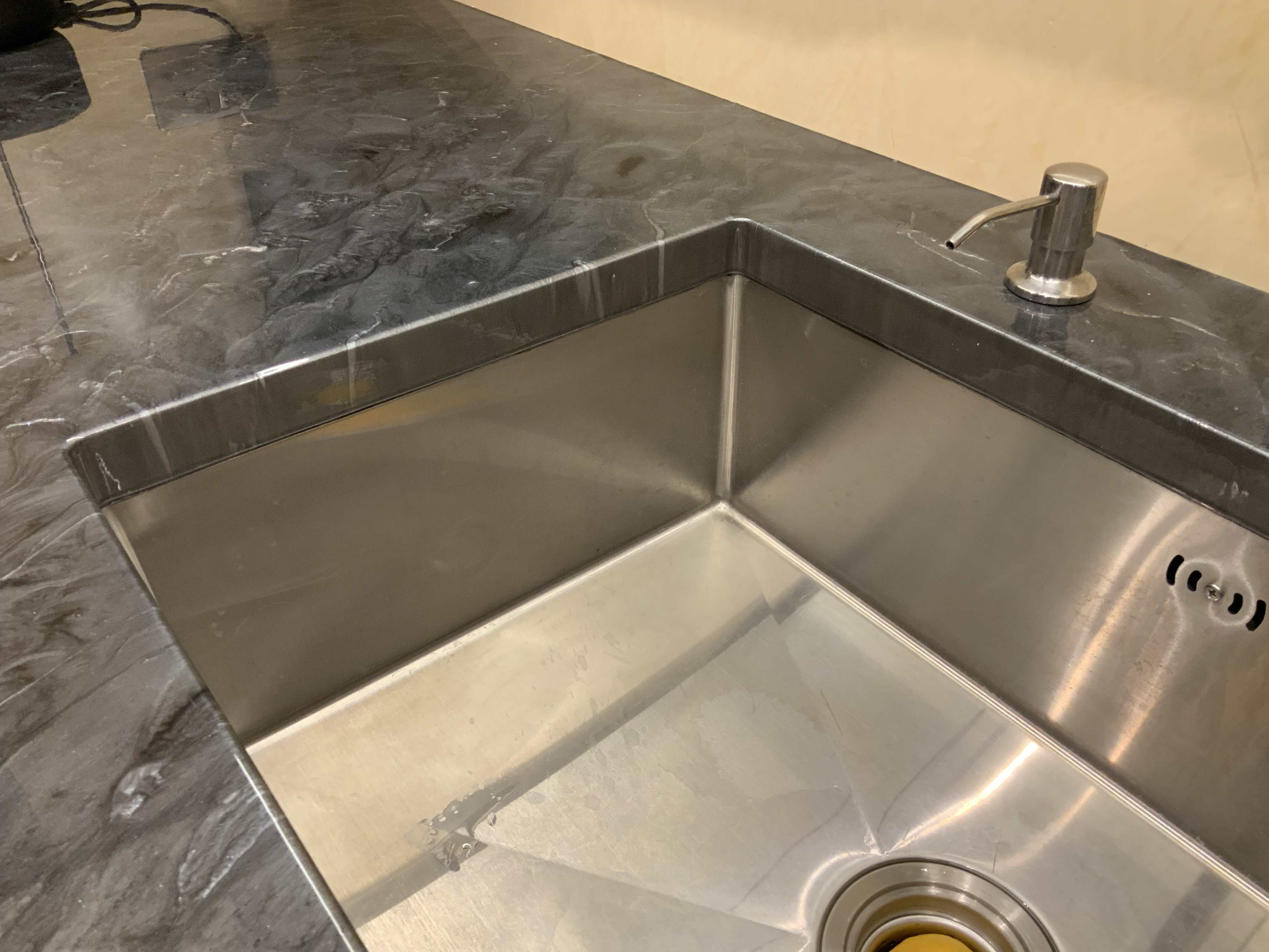

  6. Thank you LDNRennovation and Beau for your kind comments. I was quite pleased by the way the opening for the underslung sink turned out. Unfortunately, the hot cup of tea left an indentation in the surface and cannot be buffed out… I think I’m just gonna admit that the whole thing is going to start looking pretty bad quite soon. And when it starts to annoy me too much, then I’ll try something else…

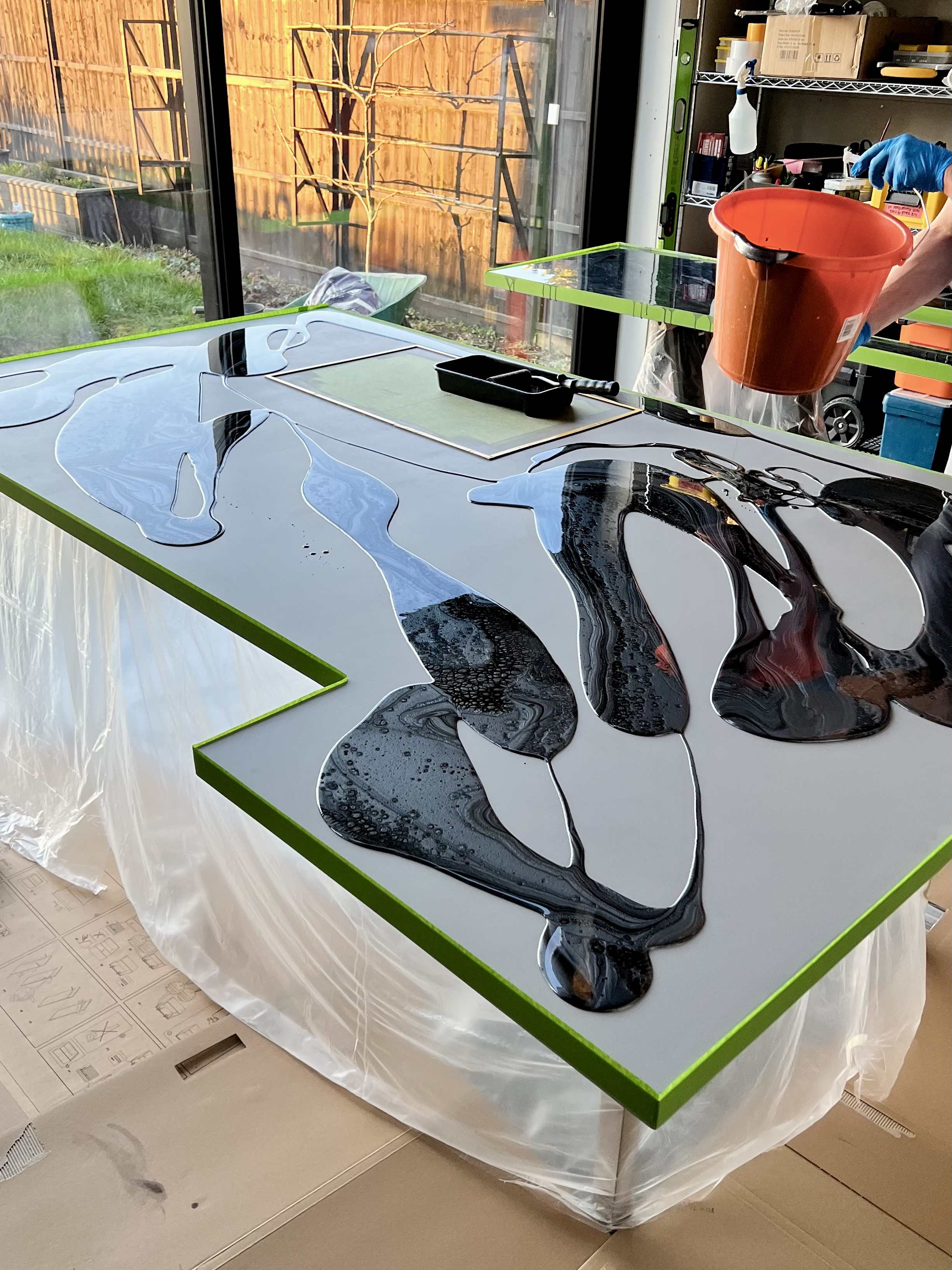

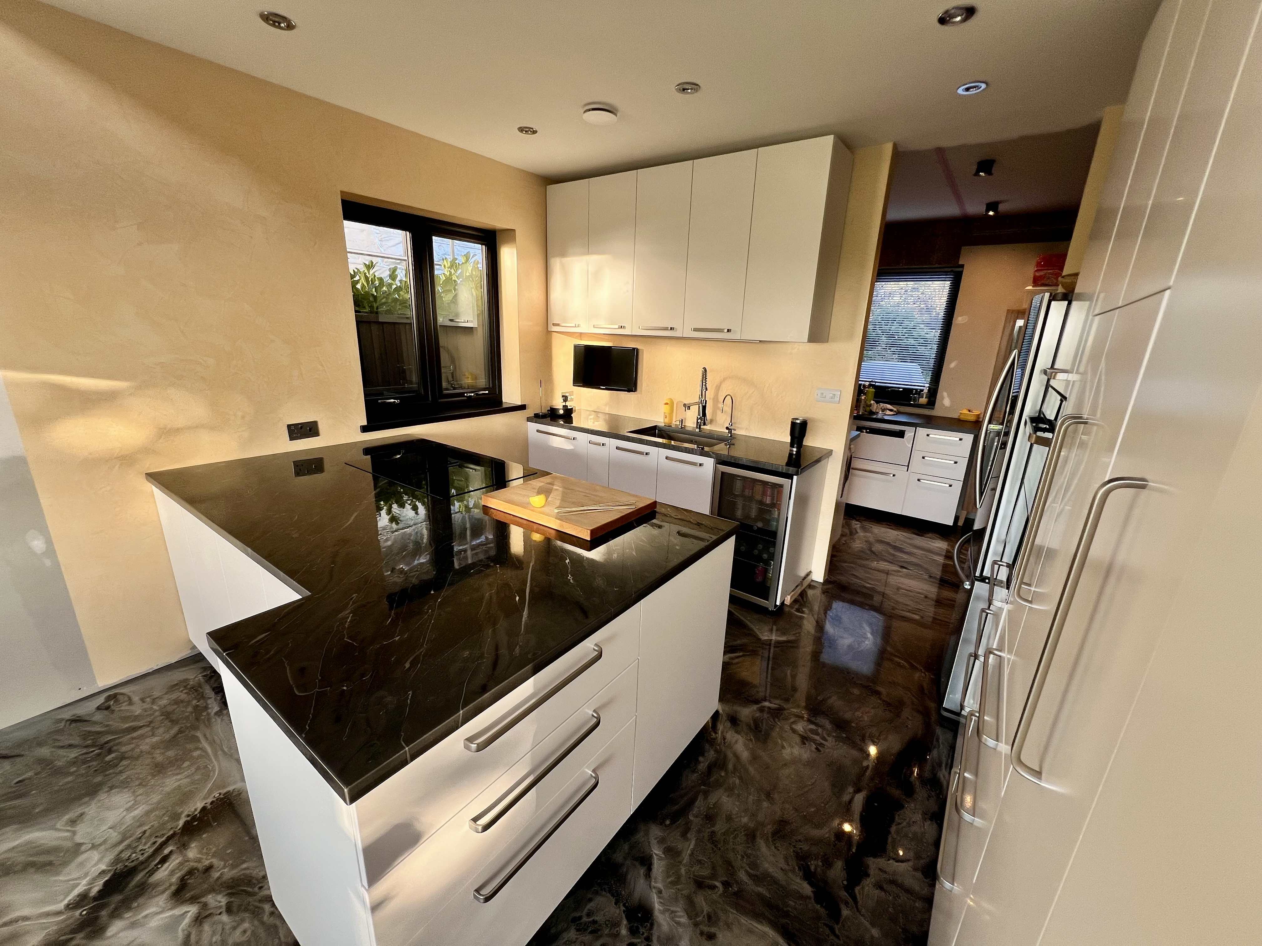

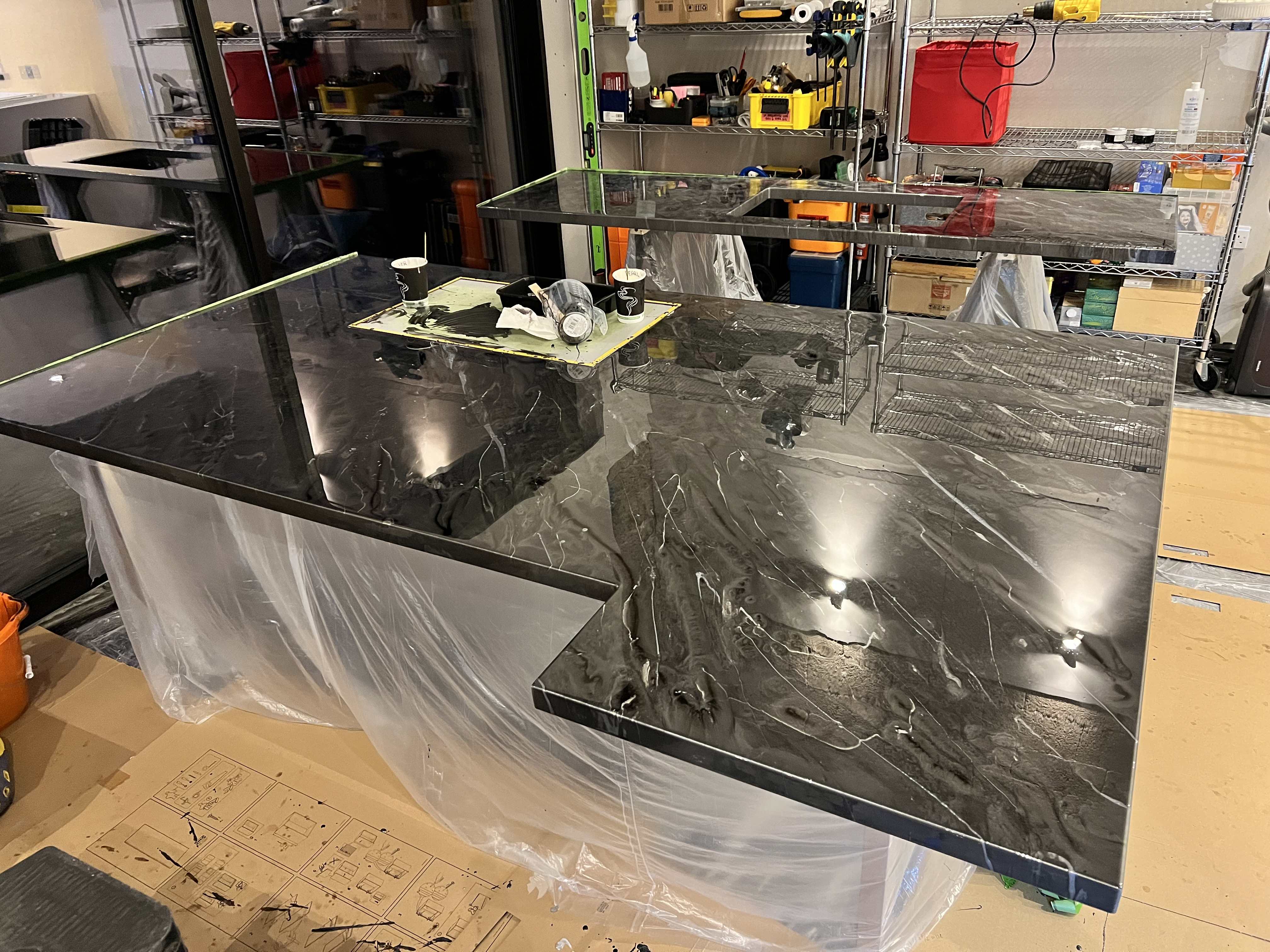

  9. Hello all! Has anyone tried (and had success) pouring resin to make kitchen worktops? Our self-build project is nearly finished and there’s no money left in the pot, so we decided to make our own worktops. We already have resin floor, which we poured ourselves and we are very happy with it (you can see it in the photo). So to make the worktops, we used sheets of MDF, plenty of prepping and priming and then poured the resin. We were pretty pleased with the result, considering it was our first attempt, though we were hoping for a darker colour finish. Anyway, left it to cure for couple of weeks. Then made a cup of tea and left it on the worktop for a minute and it “melted” the resin, leaving a permanent mark. Having seen these sort of DIY resin worktops advertised online showing hot pans placed directly on them, I didn’t think they would not be extremely heat resistant. Well, as it turns out, they’re not. Has anyone else had similar experience with resin? And do you know if there is a type of heat resistant resin or other coating that could be used for similar purpose? Any advice would be much appreciated!
