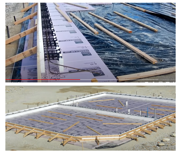

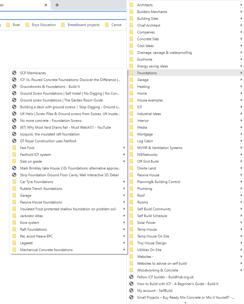

Thanks for reply. Yes planning was given over 2 years ago. SE calcs done though by you saying that I am assuming you think the plans should include what foundation type? I have added the plan for you to have a look. No way it is not going to be ICF. As I said we built a log cabin ourselves, no help from anyone except You Tube videos. Fairly competent DIYer, father was a builder and first job after leaving school was working on a building site (just 6 months though) so have some background in the trade. I know the easiest route is find a SE but like I said the decent ones just like builders are unavailable. So far not tended to go the traditional route. Car tyres under the driveway. Car tyres, concrete piers as the foundation for the log cabin. Did the roofing, insulation, electrics, tiling, made the lights, everything myself and so far so good. Living off solar and propane- not connected to grid at all. As you can see from the screenshot of my bookmarks I have researched for the last 2 years - Just thought there might be some bright spark on here who would emphatically say YOU NEED THIS 🙃 -

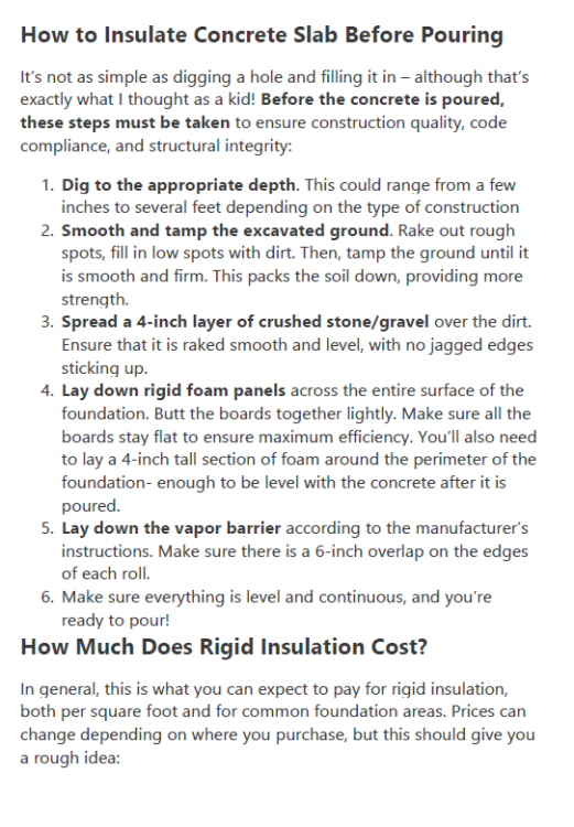

Hi Russell & Thorfun No design for the insulated slab. the house is ICF. The only builder with any experience in this field in the whole country has been away to England for the last 2 months. There is a forum on Facebuild selfbuilders NI and no one has stepped up to recommend anyone else. ICF is still seen as a mythical beast and even the banks here won't offer a mortgage as it's not been proven over here yet as a reliable building product. Mad but true. My SE was ill for 3 months and has a huge backlog. I did ask him the same question but hasn't responded to my last 2 emails hence why I came here. For the moment I just want to fill the void and thought it might be an easy answer to the experts on here. I have 3 young children and just don't want them falling into the void. As we have to walk 50 yards to the outside toilet this is a distinct possibilty 🤫 the attached was pretty much a summary of what I was hoping to do. Thanks for your advice though. -

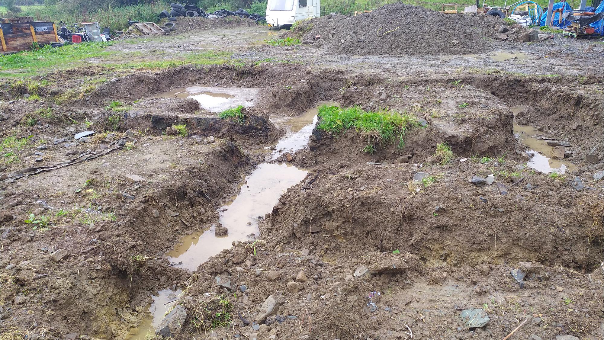

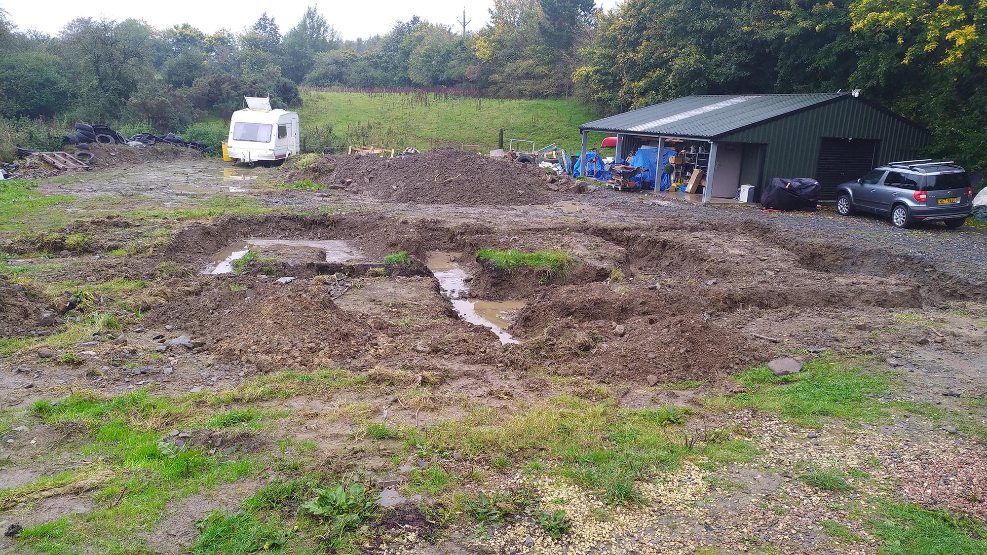

Any / all advice would be welcomed. Ok a bit of background. Bought a small bit of land few years back in the hope of building an eco house. Unfortunately we had watched too many episodes of 'How to build a house for under £100k' and actually thought it could be done. Then Covid kicked in. I lived in a caravan for a year. Found electricity cable on the land (not in plans, drawings and NIE did not know it existed - they turned up one day cut the cable and knocked on the nearest neighbour 200 yards away asking 'Is your electricity on?) as digging and when NIE finally removed it 9 months later prices had skyrocketed. So we built a log cabin instead and decided to build the house as and when we have the money. There are 5 of us living in the log cabin. It's a bit tight to say the least but so far so good. So we have the money we think for foundations but can't find a builder. Been let down 3 times already. All the best builders are booked up to at least 6 months. Plans are for an ICF house. When we bought the land there was a strip foundation in place. Over the last few years of building the garage and cabin topsoil, car tyres (another story) and all manner of debris has fallen in so spent the last few days digging it all out hence the pile of earth in the background. See photos. Question - Going for a slab on grade foundation. What do I fill up the space with? Gravel? Better soil such as loam if I can even buy that? Sand and gravel? Clean stone? the soil excavated is clay and very porous in these parts hence the need for a raft foundation. I initially thought I'd be able to refill the excavated clay soil with a more stable soil such as loam, then 6 inch crushed stone/ gravel followed by rigid foam panels EPS, vapour barrier then the concrete. Apologies for sounding amateurish.

any clue as to what you would suggest? I have added clearer photos and I have attached here what currently has been done.
