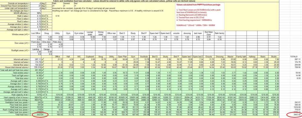

Thanks again @JohnMo - I orginally used the 1 ACH for the calcs and then changed it to 0.6 for my latest few versions of the spreadsheet although these arent shown in the screenshots above. All the UFH spacing on the graph above come from the figures using 0.6. I have been using LoopCad also - but was struggling to make sense of how to get the wall, ceiling and floor buildups exactly what I wanted. The results came out pretty similar tho which was good. -

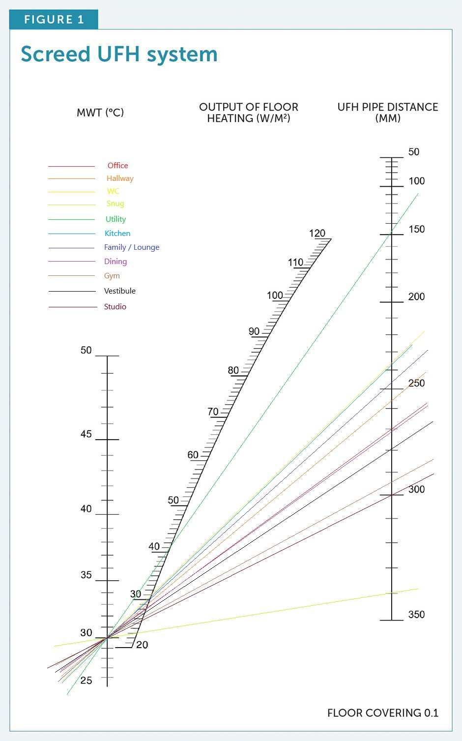

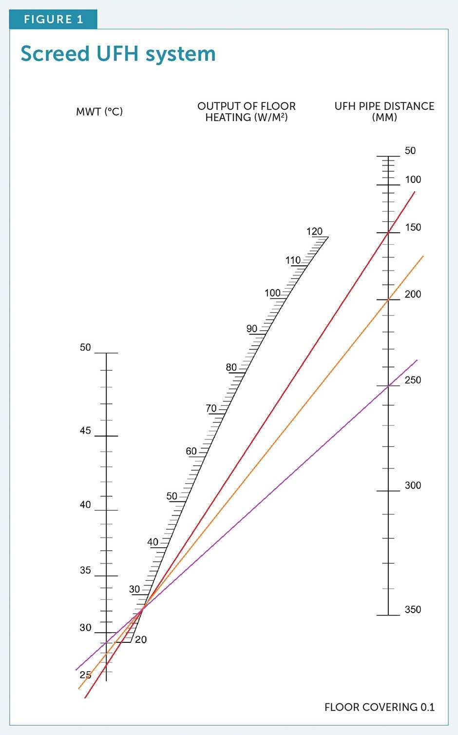

5. With these heat loss figures I then calculated the required UFH spacing for each room using the graph that @JohnMo posted earlier. I assumed a Mean Water Temp of 30 degrees. The 2 outliers were the Utility room and the snug. The Utility room has a small useable floor area for UFH so needs tighter spacing. The Snug is a bit odd - and might need another look, but am assuming that the wider spacing is down to the relatively large useable floor area and the fact that there is only 1 small window. -

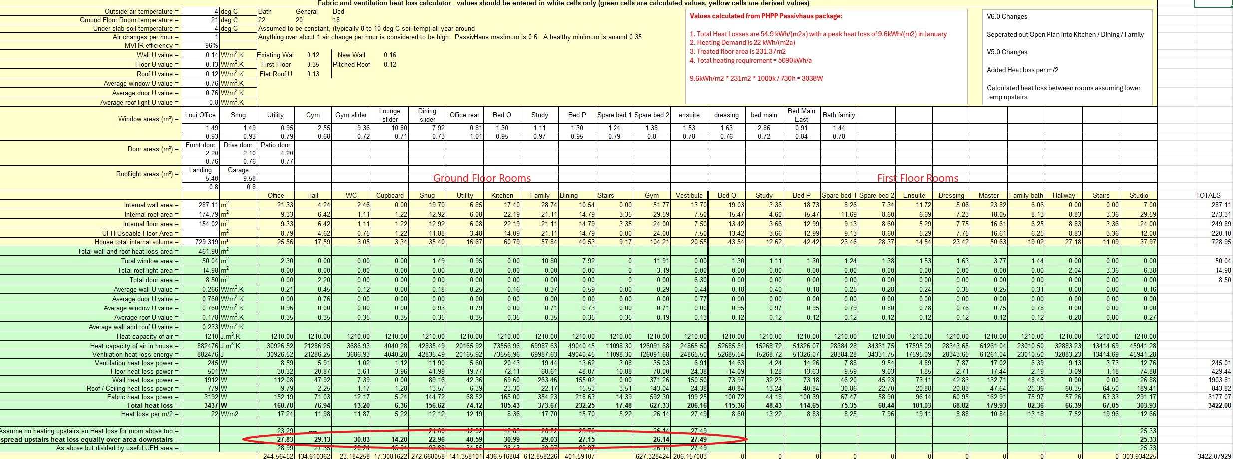

3. I then accounted for the different U values in different parts of the house so that the individual room calcs reflected reality. 4. As we are likely to have no heating upstairs (will likely fit it but hopefully not use it) – I then added another row to the spreadsheet to calculate the Heat required from the UFH in each ground floor room so that it was able to account for the heat loss in its own room as well as the room and warm loft above it. -

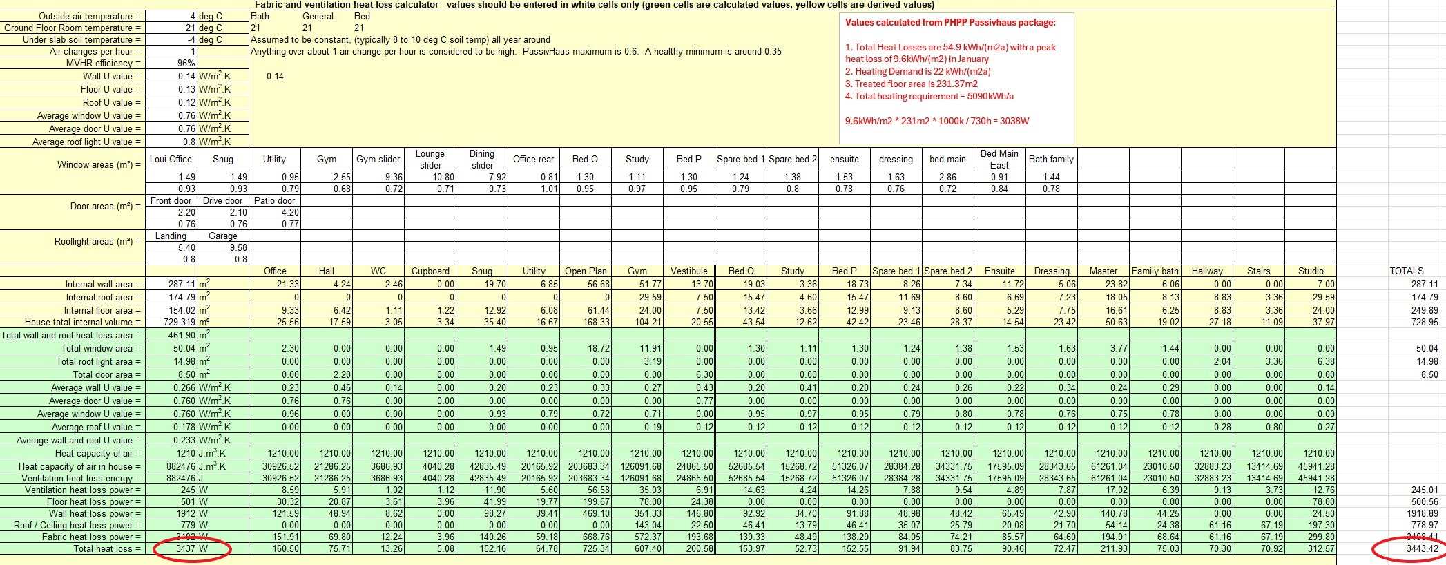

As promised – I wanted to share the stages I worked through to calculate the individual heat loss from each room and the required pipe spacing for the underfloor heating in case anybody finds it useful: 1. I used Jeremy Harris’s Heat Loss spreadsheet to calculate the Whole house heat loss using average U values at this stage rather than individual U values for each type of roof and wall buildup 2. Once I was happy that the whole house calculation was as accurate as it could be – I used the same spreadsheet to create an extra column for each individual room. Initially I also used the average U values so I could be sure that the sum of the heat loss from each room was the same as the whole house. The results were a few W out, mainly down to internal wall measurements and slight rounding errors. -

Thanks @JohnMo that makes a lot of sense. So it would be better to do individual room heat loss calcs so that I can find the optimum pipe spacing for each room rather than having the same pipe spacing throughout. Once I know the individual heat loss for each room I can then use the graph to determine pipe spacing for various mean flow temps and I need to make sure that I don't go below the min flow temp of the ASHP. e.g If the min flow temp for the ASHP is say 25oC - should I aim to get all the way down to this with an appropriate spacing? I guess these calculations are all for the worst case coldest day - so would you also do the same calcs for the shoulder months to make sure the flow temp on those days is also above the min flow temp for the ASHP or does that not matter? Thanks again - Hoping to gradually understand this as its such an important part of what we are trying to work towards in terms of a relatively low energy renovation.
