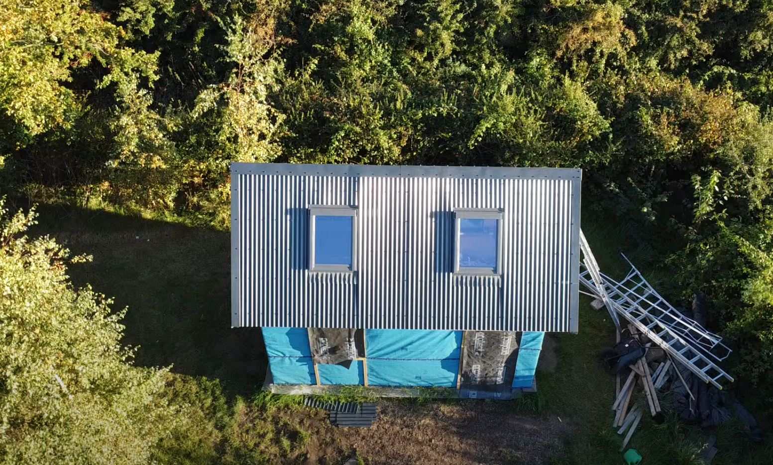

  4. I thought I'd share my approach to wire mesh with board on board cladding. I couldn't find any real detail about this is trada publications or internet. Mesh is held behind the counterbattens or under a batten at the sill level, then folded over the first boards with a couple of staples to hold it in place. Where the mesh would show it's cut away and then the top board holds everything in place. Fairly quick, simple and relatively inexpensive for a roll of stainless mesh.

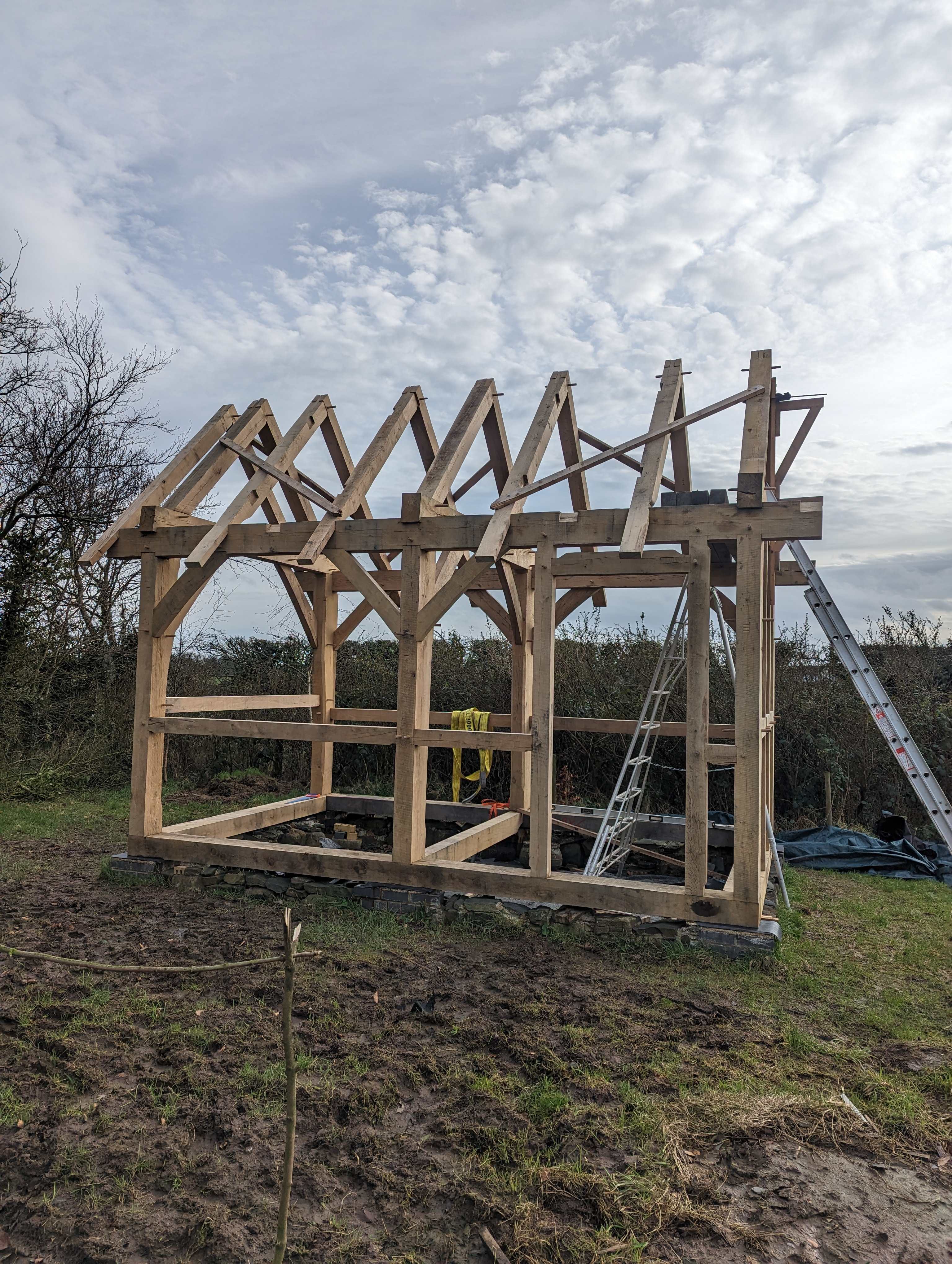

  6. First saw this site when researching info for installing velux roof lights in a new corrugated roof and then when trying to find out how to insect screen board on board siding. Thought it was time to join up and maybe add my 2 pence worth. I'm in the process of making an oak timber frame (mortice and tenon post and beam) to be a room in the garden. At the siding stage.
