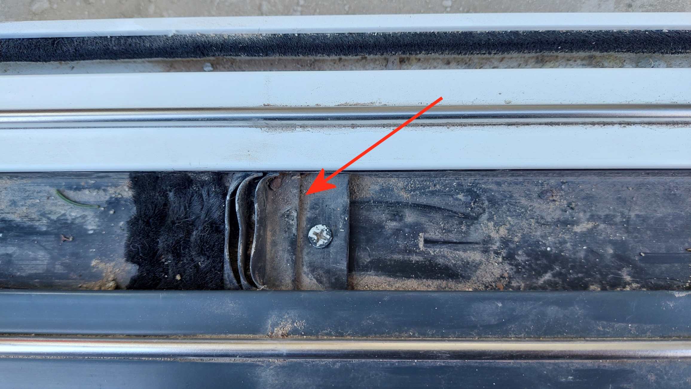

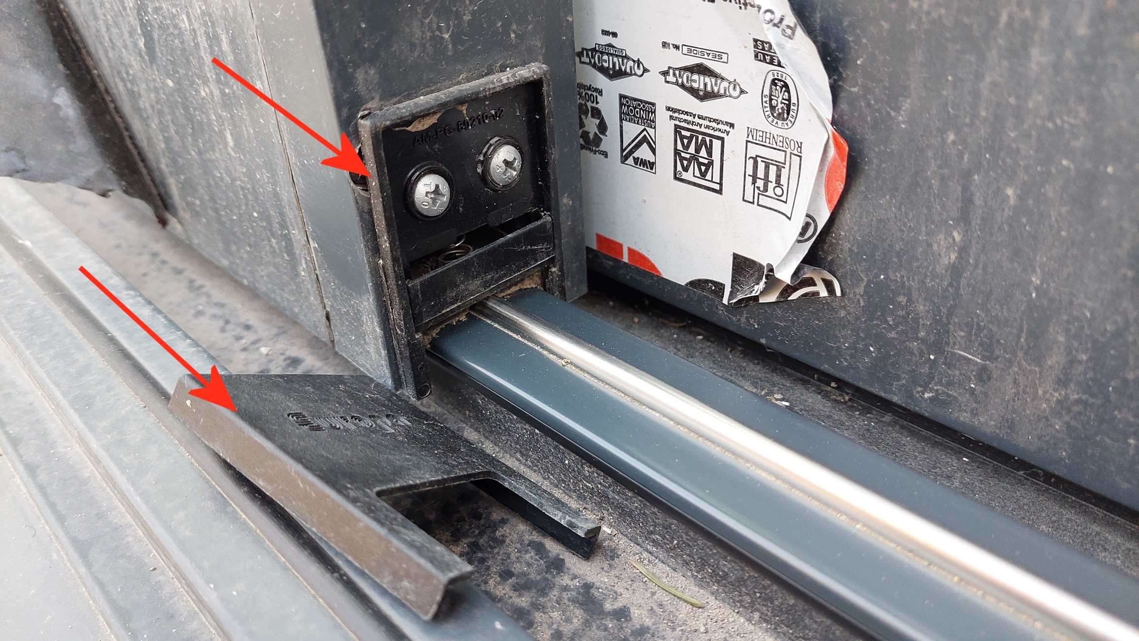

I've found the following part number chart: ESS47 Wallchart This suggests the: 1. Draft strip / baffle = is a "Sealing plug" and has part number SR-12717 (or possibly PS-7) 2. Spring assembly and "Europa" cover = is a "Plastic Cap for Interlock" and has part number PG-80210 I checked with Alunet and unfortunately they won't sell spares to retail customers. I did find that they have just been purchased by Eurocell, so maybe they will stock the parts in the future (they didn't yesterday): Eurocell Acquires Alunet Group If anyone can suggest somewhere to buy spares I would be very grateful.
We have a large sliding door. I think it is a "Alunet ESS47" profile but I am not certain about this. The door system has two small parts which are causing problems: 1. Draft / Baffle strip - This is under the sliding openers at the point they interface with the outside. Each strip consists of moulded plastic part with a screw hole, a brush approx. 20mmx200mm and 3 or 4 "gills". 2. Spring assembly and "Europa" cover - There is one of these on the top and bottom of each sliding opener. The spring assembly pushes a foam strip against the sliding rail. Presumably, this is to provide further draft proofing whilst also allowing the opener to move. It has an easily removed cover with the brand "Europa" on it. I have attached two pictures to this post. I would be very grateful for any advice on how to identify part numbers and/or purchase spares for these items which look like they will wear quickly and need to be replaced several times during the life of the door system.
