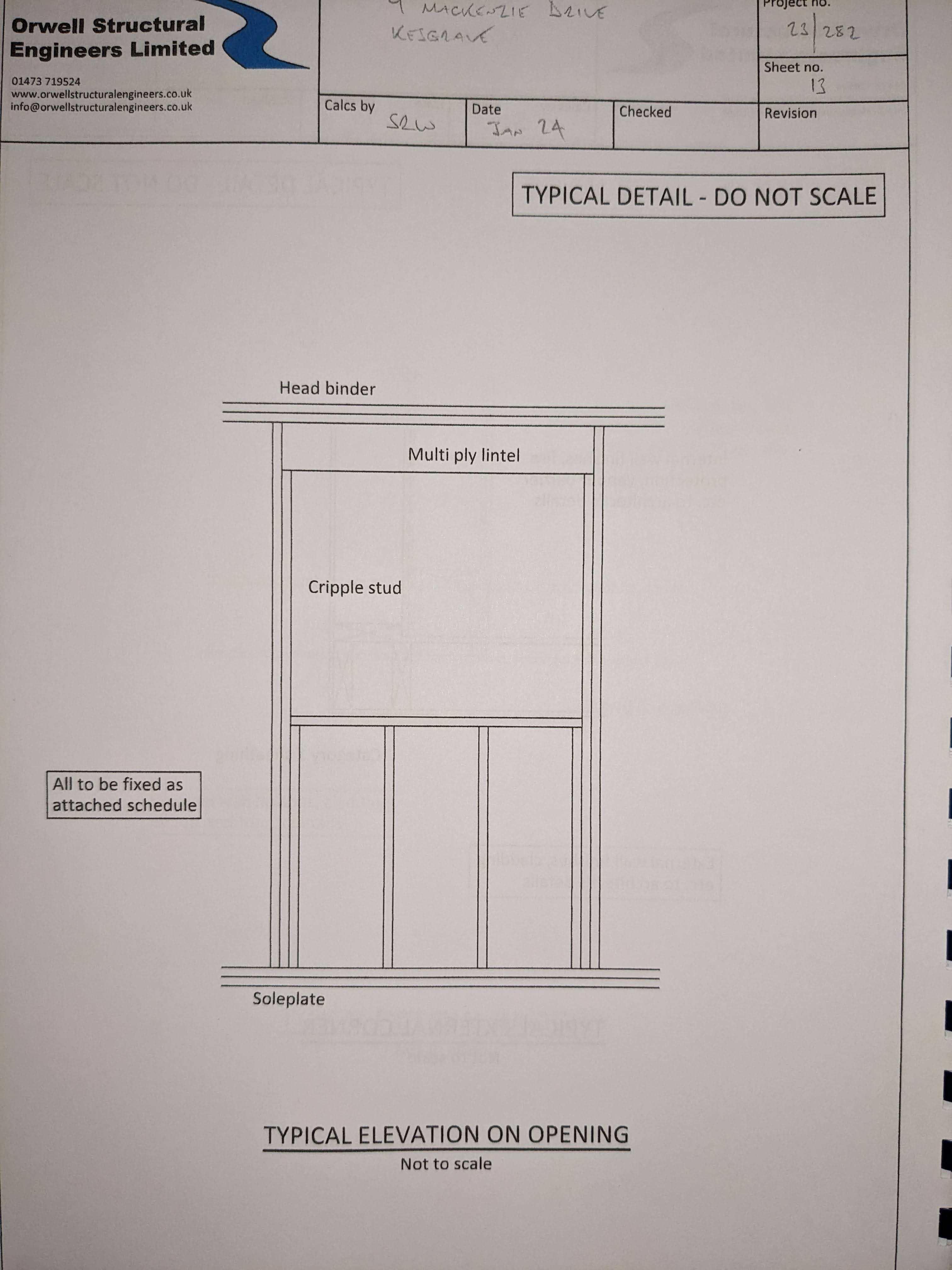

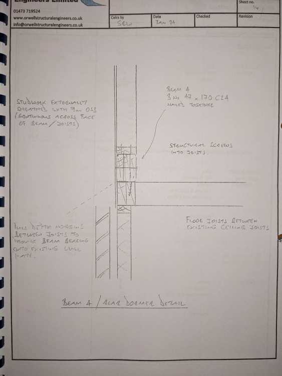

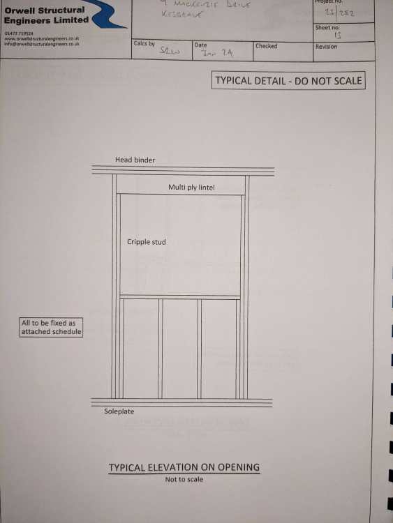

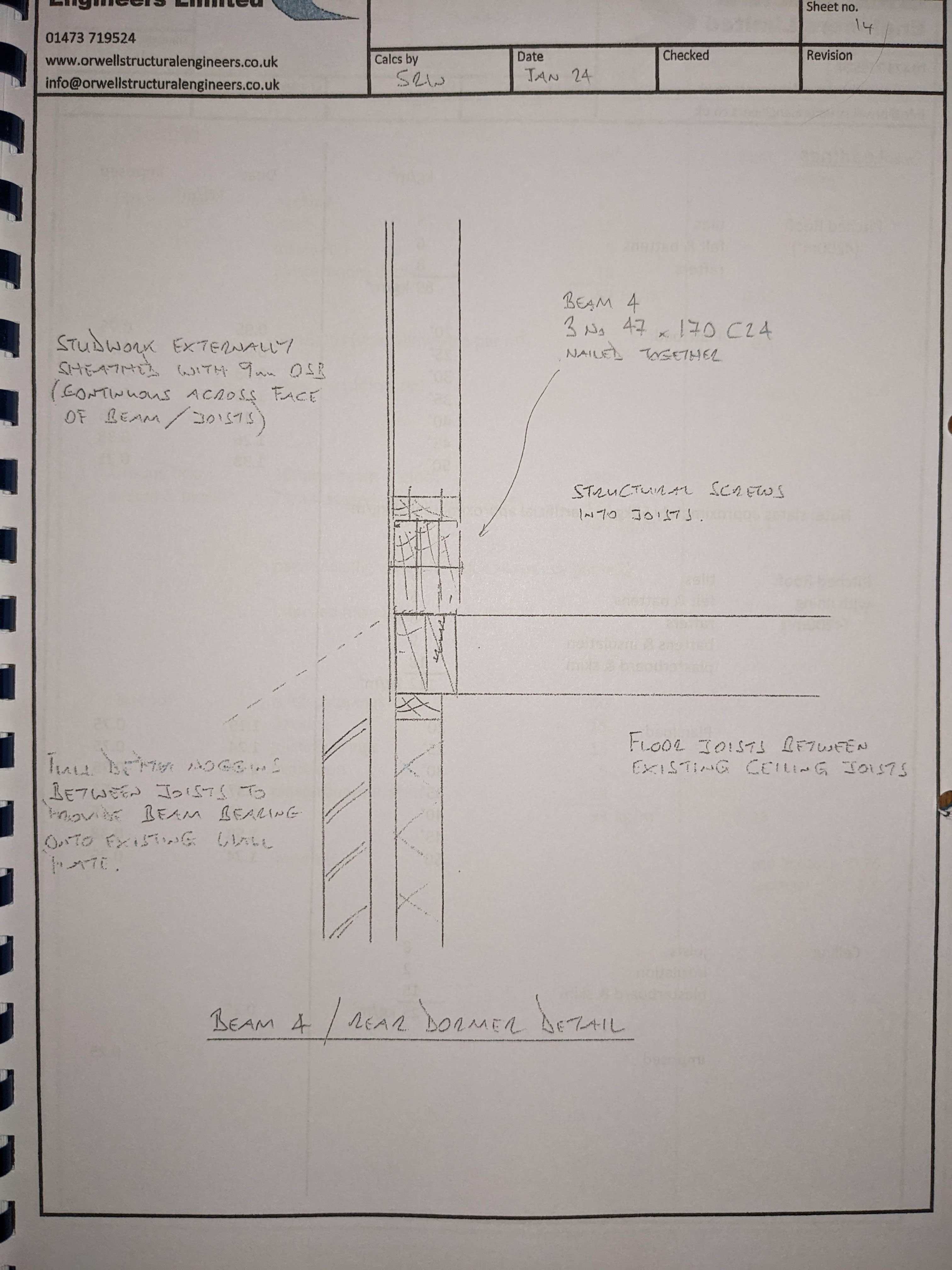

  10. My SE detailed how he wanted it built. 3 175x50 C24 bolted together and structural screwed into the joists, this was the sole plate and runs the full 10m length of the bungalow. Then window construction with studs in-between, and finally a binder top plate, all in 150x50mm C24.
