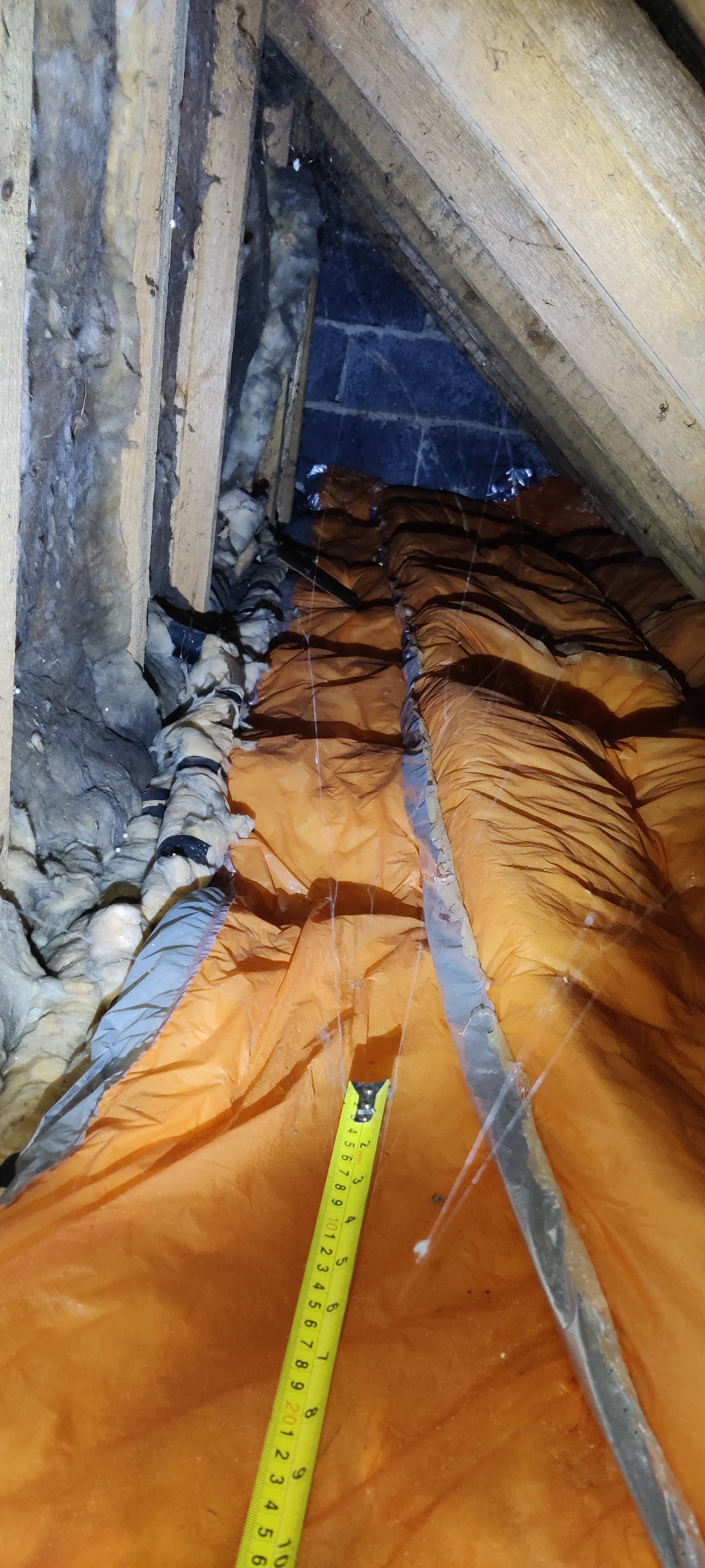

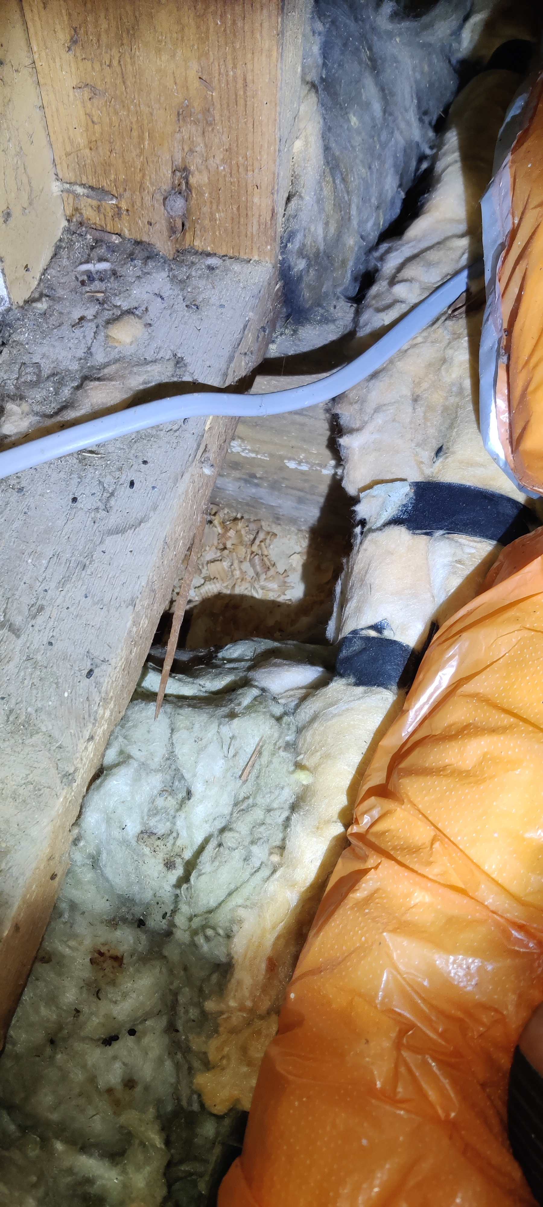

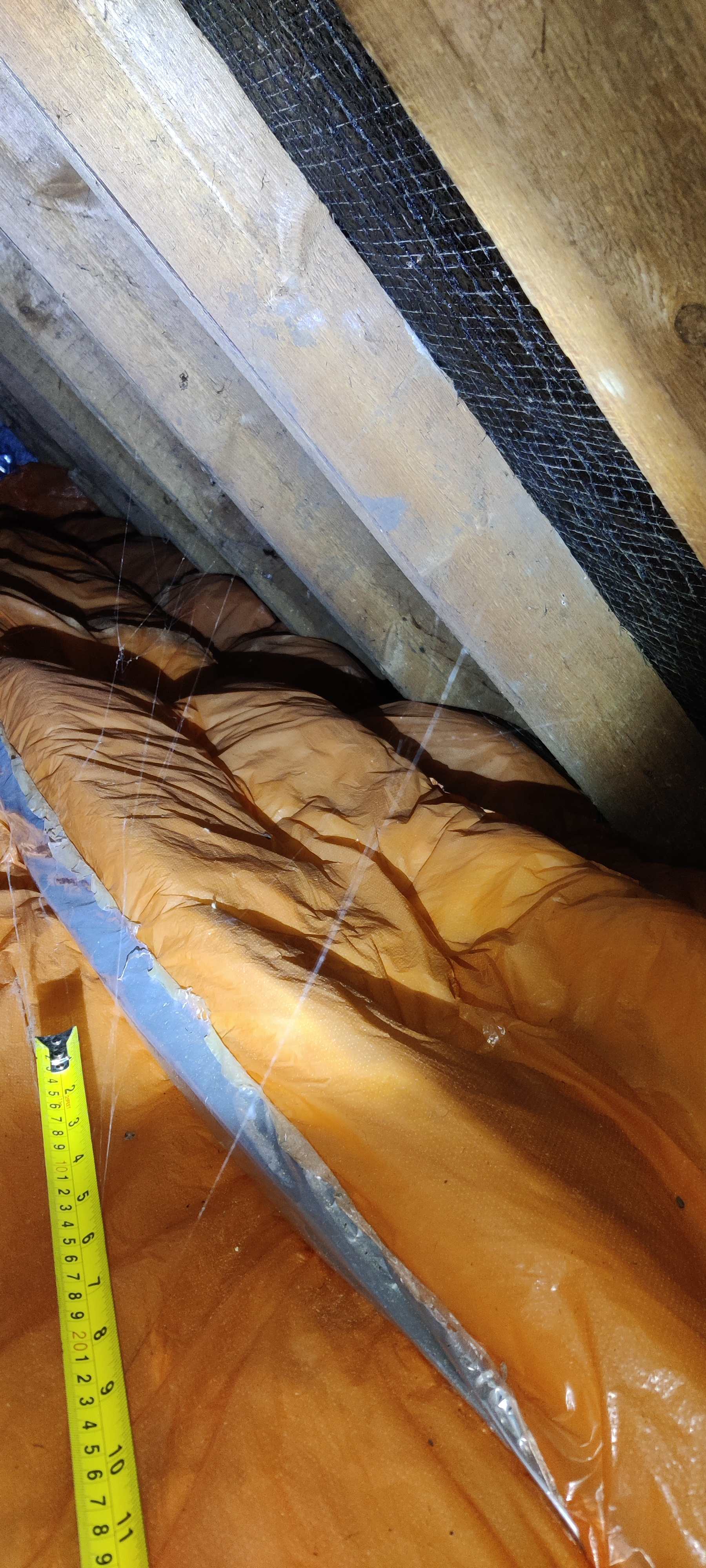

Thanks to all the above comments. I have spent the last few weeks trying to fill the gaps left by the bad fitting warm roof, using PIR cut up into blocks and foaming them in I used a airtight foam on the inside perimeter and a large area 'coverage' based foam on the outside. Still not sure I have got all the gaps, due to the now inaccessible cavities between the outriggers and the roof edge Had many sleepless nights adding up all the area of the blocks I have cut, to literally cover the daylight coming in. Had this not been addressed, at least partially by my efforts, it would have been like leaving a window open continuously. I think the best way to have installed this would have been to fill the gaps between the outriggers, prior to the installation of the roof section, as you would have far more access. The roof could have then been built onto a continuous layer

The gaps around the outriggers are due to added packing required to bring the roof deck level due to the discrepancy from the interface with existing building

I am mid way through an extension and house refurb The extension is a timber frame using a warm roof on pozi joists and I am increasingly worried about the separation of the roof insulation layer from the conditioned space below due to the difficulty in sealing up the gaps between the pj and the top layer of the walls with PIR To further compound the problems, I wanted an overhang around the extension. Whilst the PJ's facilitate this structure naturally on the one face, the two sides are forming the overhang using outriggers Combine the outriggers, packing and the roof fall angle and you can currently fly a drone through some of the gaps between the roof deck and the walls Whilst air tightness could be achieved using a vcl, heat loss from the break in insulation continuation cannot and I don't understand how we have got here Possible solutions I have considered are commercial spray foam sealing from the outside of the roof cassette and the inside or my latest idea to fill the area below the roof deck with blown in insulation. Please share your thoughts and possible solutions

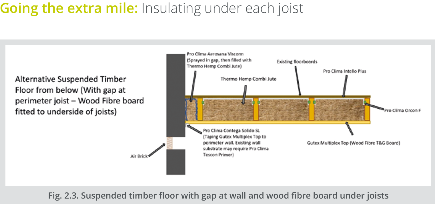

Just noticed, on page 20, in the downloadable guide that Ecological Building Systems provide for implementing this system, they advise the use of wood fibre cladding under the joists. This would provide the windtight and breathable layer whilst reducing the cold bridge into the floor joists and negating the need for the lower Pro Clima membrane. Would imagine they would be a pig to fit though...

Yes, I will be trying to follow their example as closely as possible, using the upper DA membrane. Im not opposed to using the materials stated, Im just conscious they are a merchant selling those products and in a world where I had a bit more cash, I would probably tick the boxes and get it all delivered. Just wondering if I could save a few £'s by using other materials
Throwing away all my desires and plans for going fully UFH with a solid, insulated sub floor in my 1960's dormer, due to proposed builder quotes, I have reverted back to plan B, which was to insulate between the joists and stick with radiators in the rooms. Following the great guide on the subject on Ecological Building Systems website, my question is is it really necessary to use Pro Clima Solitex Plus as quoted, or could I get away with another, cheaper material in this layer - like some of the better roofing membranes that are available? I would anticipate the membrane would not have to handle a great deal of moisture moving from the insulation to the ventilated space and act primarily as a windtight layer. I have no doubt the Pro Clima is good stuff, but is also expensive when compared to good old Tyvek roofing membrane, which also comes in larger sheets, so less taping Any thoughts or experience in this area?
