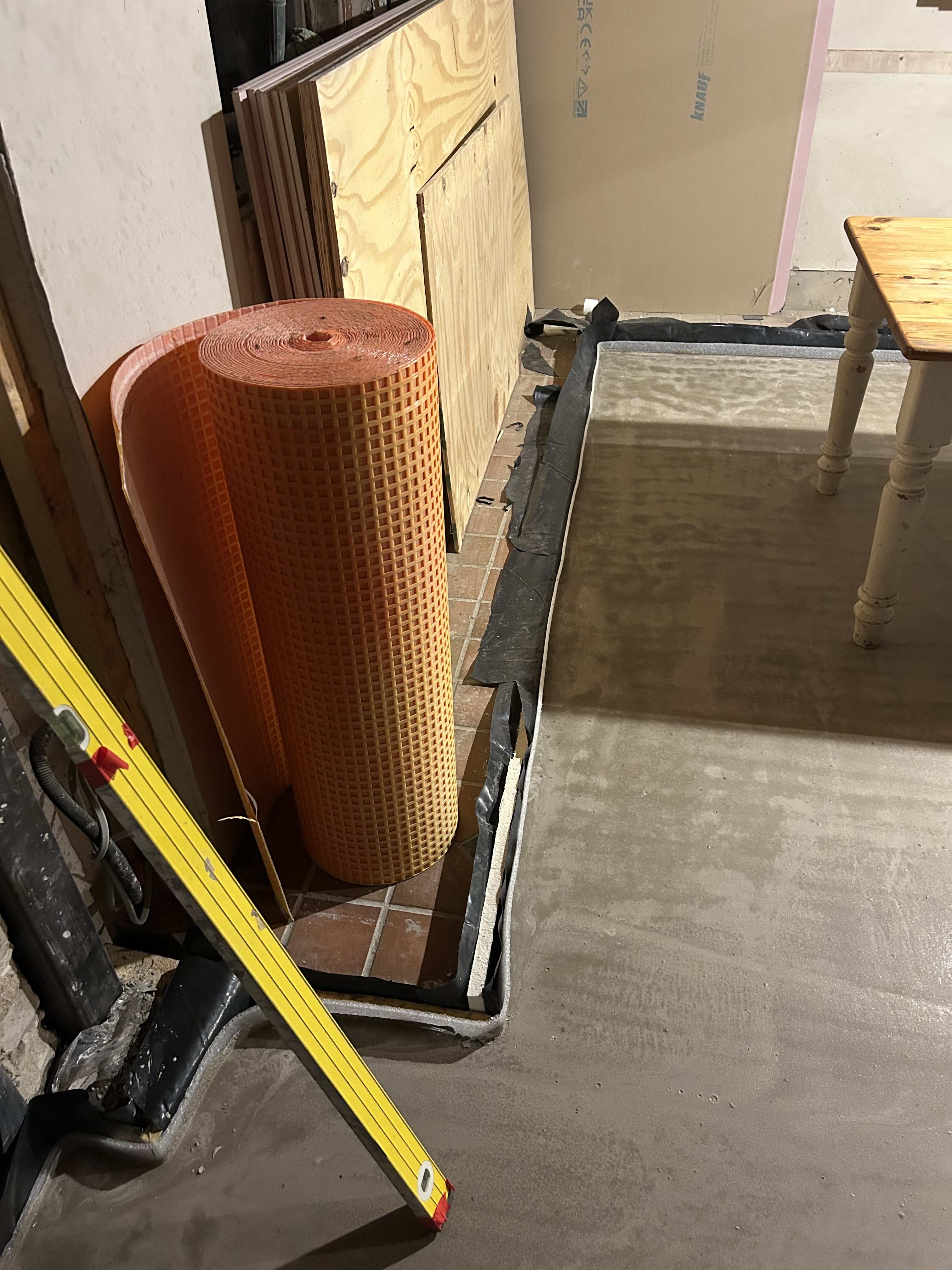

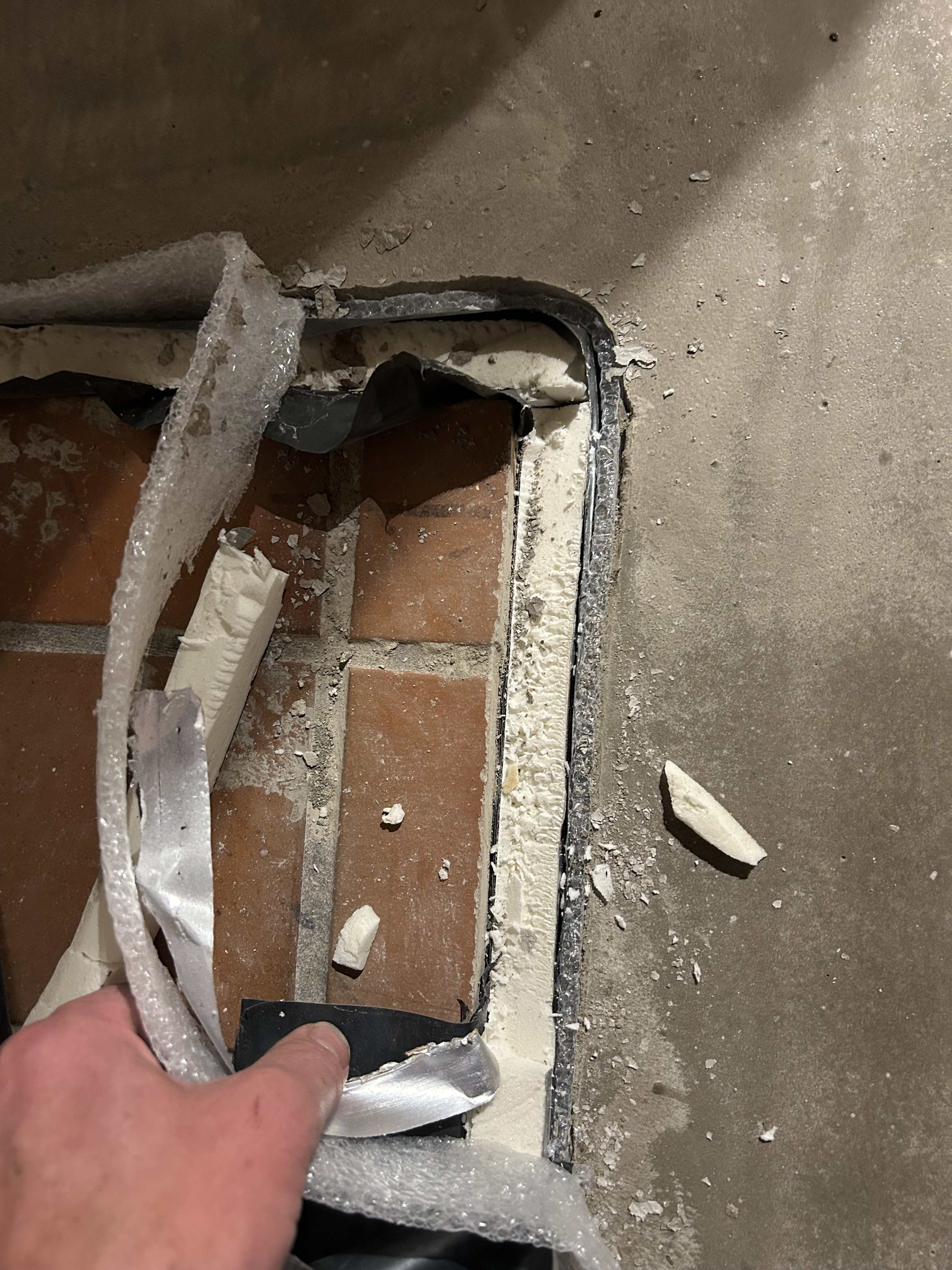

Installed UFH in new extention (over block and beam) and Exisiting house (over new 100mm conc slab). In the existing part I left in bits of old floor in two parts because new kitchen run is going over top and elsewhere because area covered by current kitchen units (we’re still living here) which in time will become toilet&utility room so not bothered about UFH. Now covered with cemfloor 50mm liquid screed. To avoid heat loss from UFH screed slab I used 25mm PIR upstand insulation and the 8mm expansion foam right round. It was all busy busy and my head was fully down to get ready for liquid screed man window - miss it and it would have be 3weeks till next. Now everything’s dried I’m wondering if the 25mm+8mm is going to be ok to jump with the adhesive and decoupling mat below the tile. I’d be really interested to hear people thoughts 🤔😬 in most places the border between old and new will be 50mm under unit kick boards but in a couple of places it’s more out in the open of walkways. (Edit: the old terracotta coloured quarry tiles will be sds’d off and self levelled up to same high as screed, the decoupling mat (pictured) used to cover right through and tiled on top. TIA

Hi Jackie, Came across your post as in a similar position and looking for clarify on perimeter insulation. I’m also on BB floor with UFH and have the inner skin removed. My take on this detail is floor insulation up to inner face of outer skin then perimeter insulation stick to block wall with spray adhesive (spray wall, sparky insulation let tack off then attach). On mine this perimeter insulation. Is 60mm high. Then bath tub the PIR slab in DPM and then 8mm expansion perimeter insulation on top of that and tape the skirt on that to the floor with gaffa. The 25mm PIR is to eliminate cold bridge and the 8mm has some give to cope with thermal expansion. Two difference jobs. Posting hoping others will confirm this approach really, most of what you see has people only using 8mm. I’m using decoupling mat on to of liquid screed and as away carry the tiles over the 25+8mm gap. …. -

@JohnMo thanks for the notification tip, wondered how to do that. Sorry must haven’t been clear, only jumping from insulated slab to non insulated with tiles and decoupling. UFH pipes will only be in new slab. Cheers.

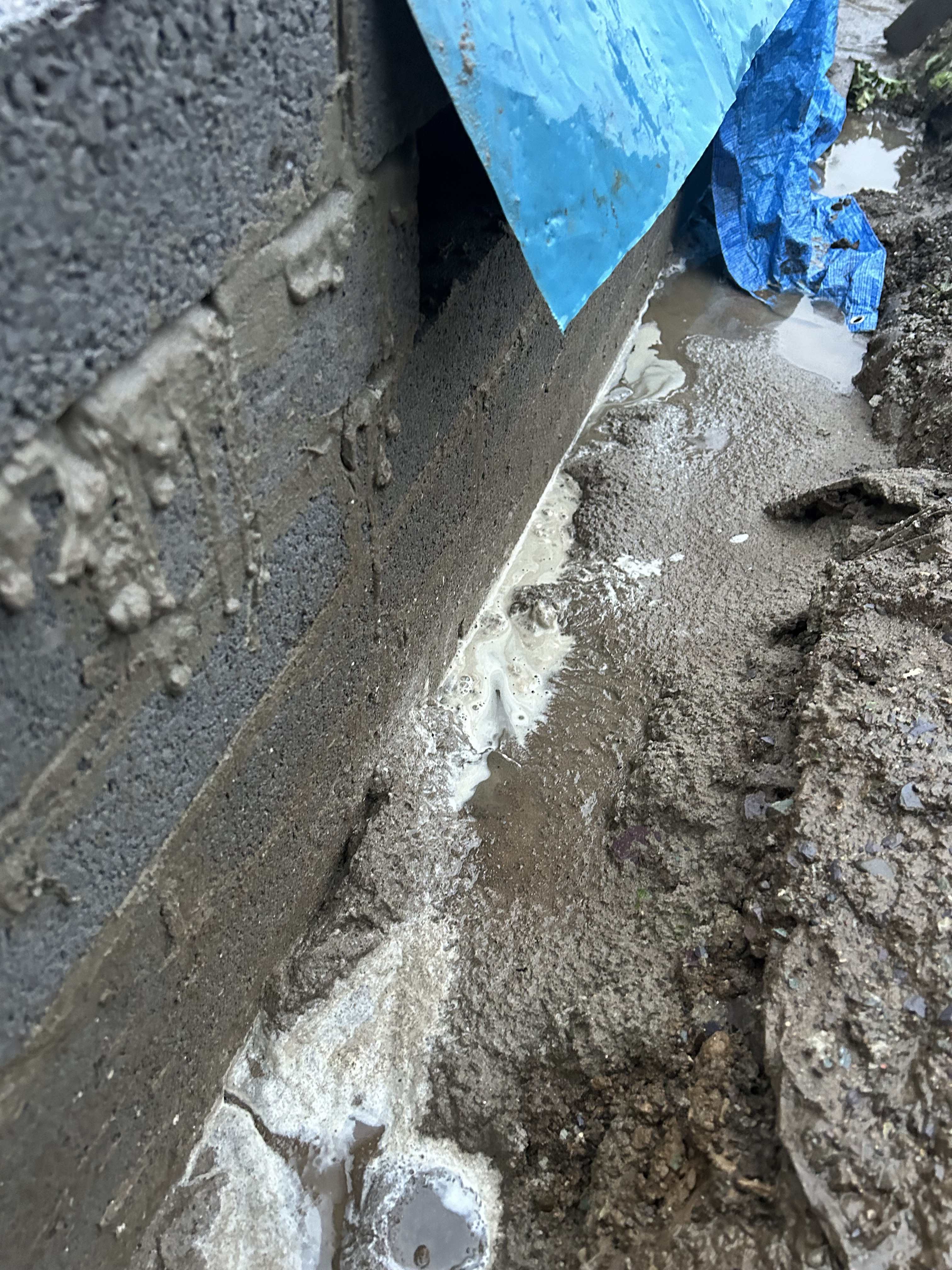

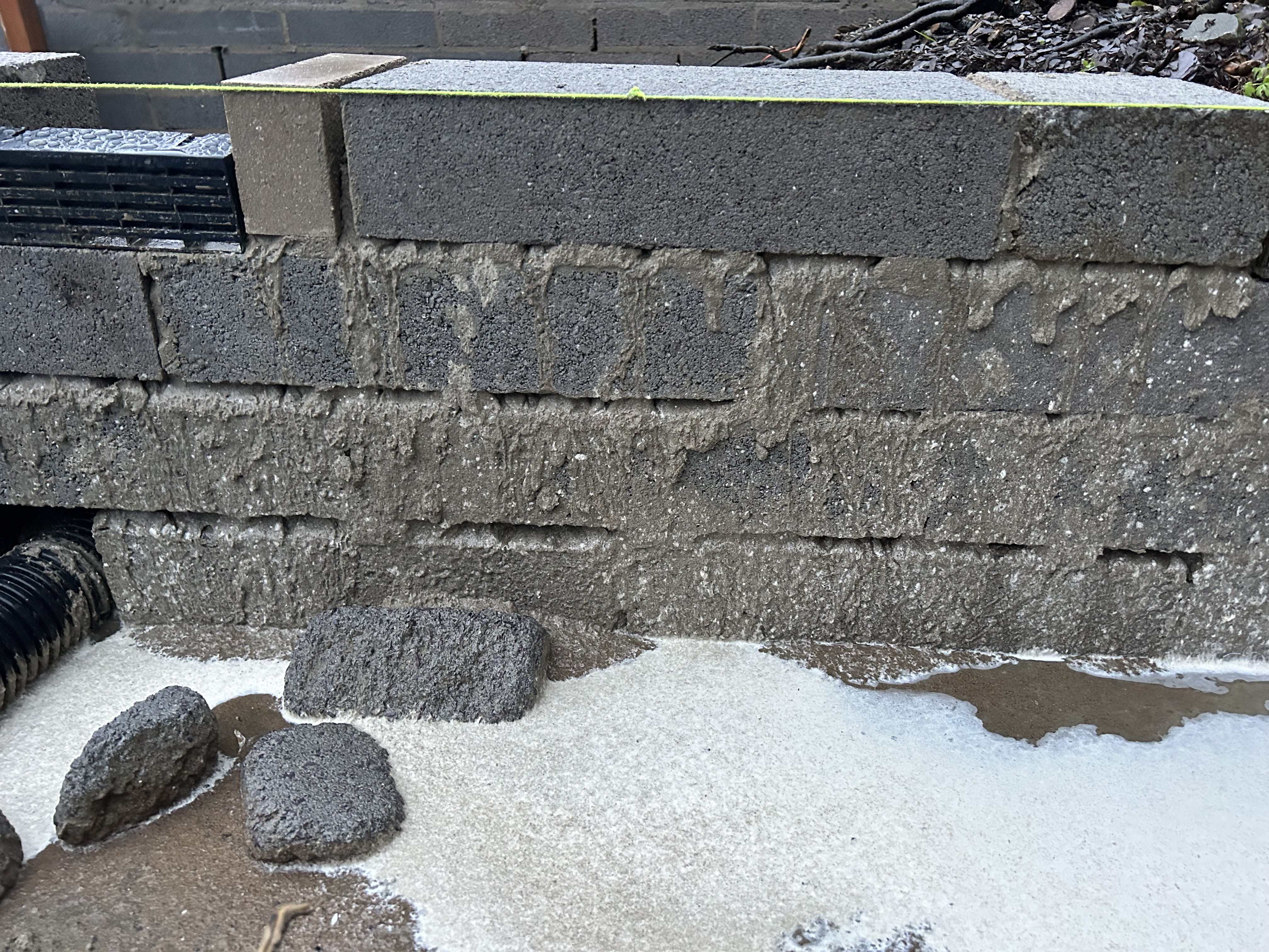

..just to add, I messaged him with some pictures to say a lot of mortar had washed out and he said he’d come repoint when he comes back to finish it.

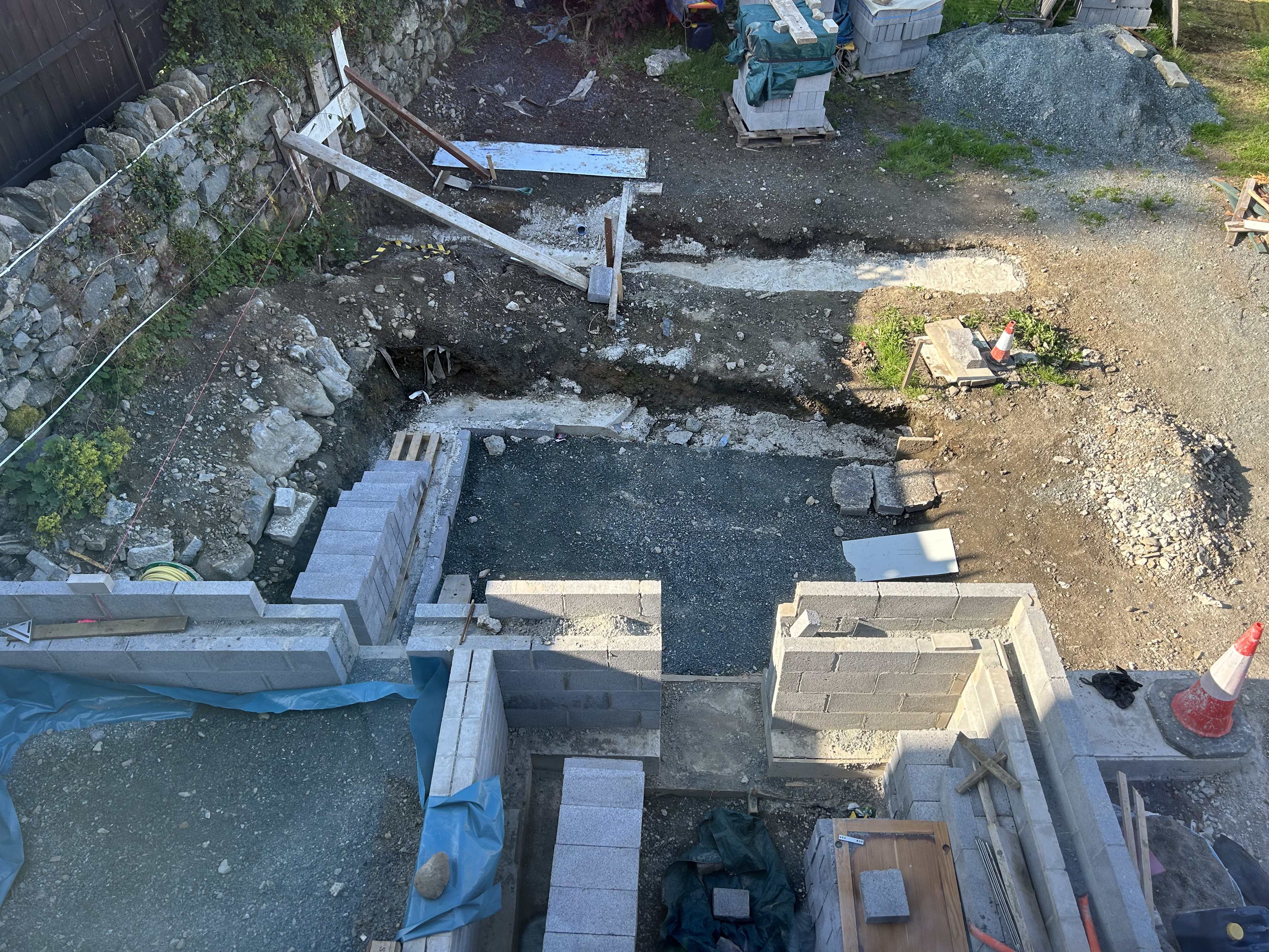

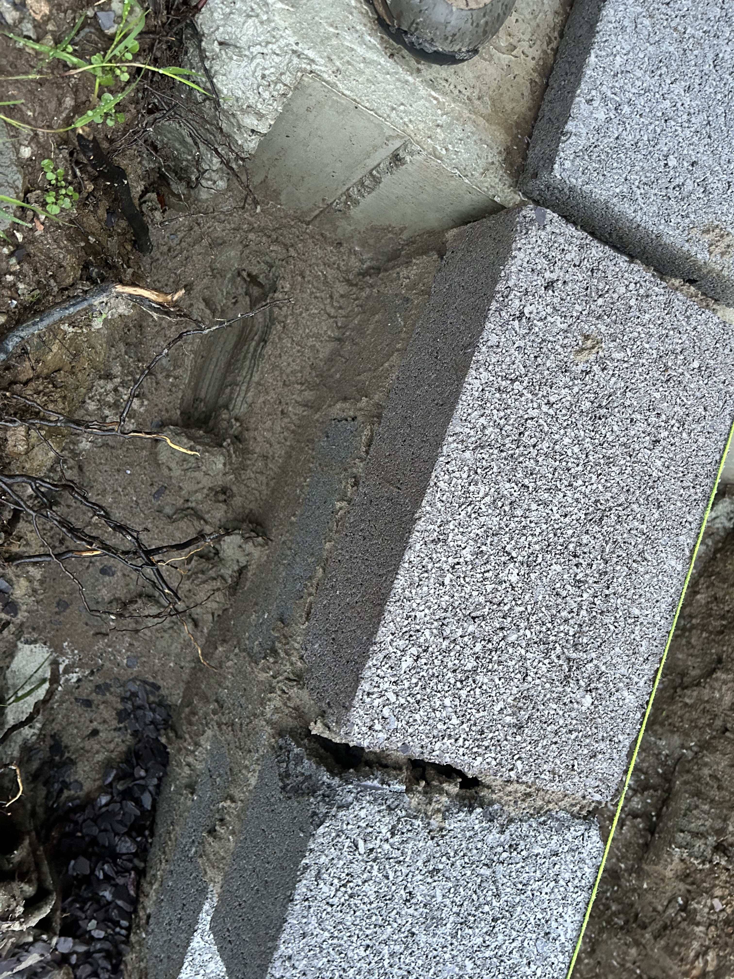

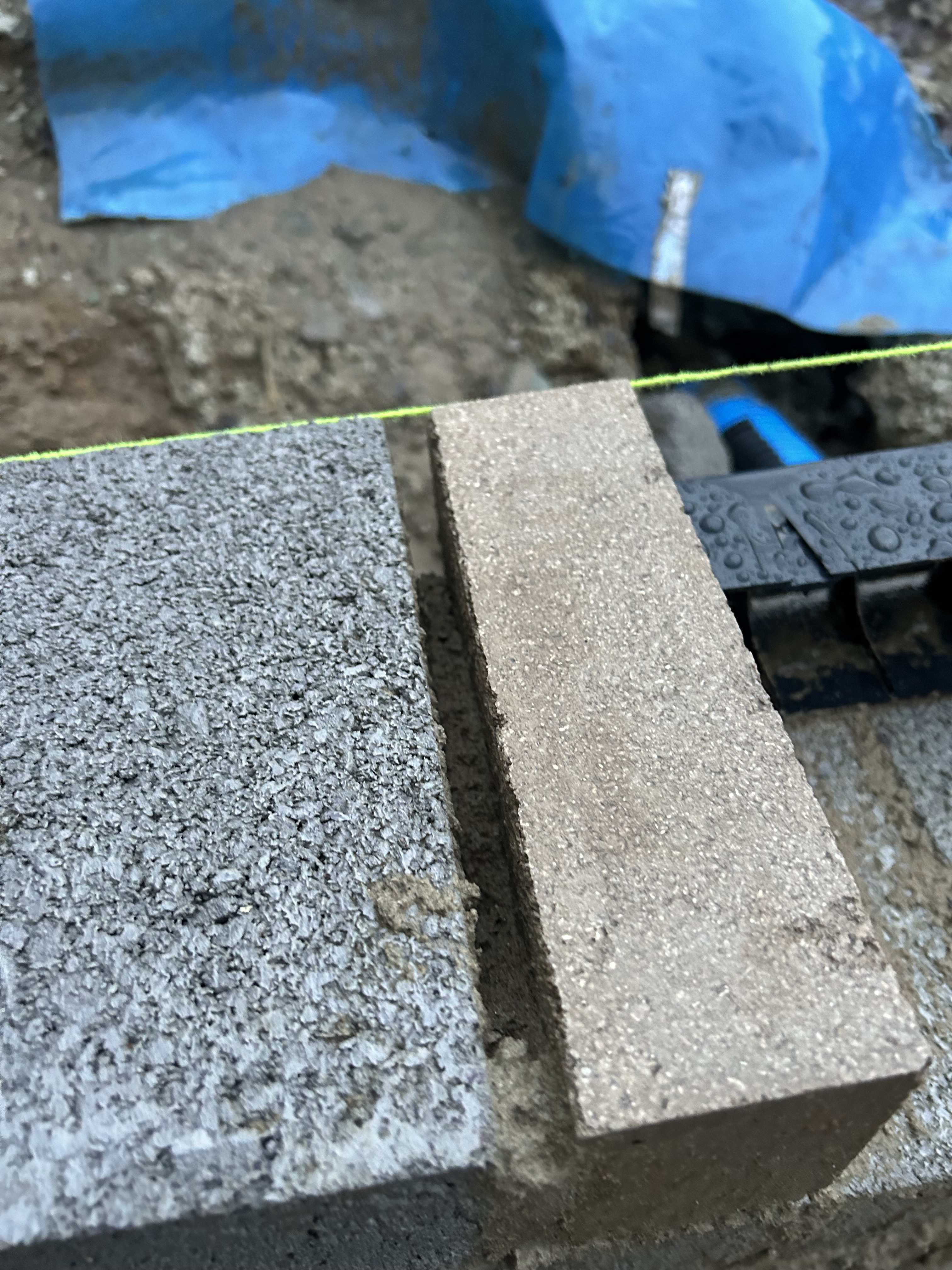

Hi, just jumping on this thread with my issue.. block layer was suppose to come yesterday but was a no show, arrived this morning unannounced and caught me unawares as I was off to work. He set his lads going on the 7M 215mm block flat wall they are building for my block and beam and himself left site. When I spoke to him mid morning to see how things were he still wasn’t at my house. Came home this evening to find standing 30mm of water in parts of the trench and a load of, what looks like run off mortar, in the trench (looks like a lot - might they have thrown some sand in to try and soak up the standing water - is that a trick if the trade?) Any way there were token tarps thrown here and there but only half covered and not tidy. Had a poke around with a wall tie about 6pm and found the bottom beds soft and exposed vertical ones soft and washed out not much better now at 1130pm. The trench had a load of fluffy bubbles on the sand/mortar spoil like which I guess is the plasticiser. I’m not happy, and don’t see why I should have to compromise on a weaker wall, he can’t be saying this is top notch work - for one he wasn’t around. However ,I read in a few of the forums that actually mortar isn’t too affected by wetness. Please can the experienced brick/block layers provide their thoughts? I’m not to worried about the cosmetics as the wall will get rendered. Is the structural strength compromised and does it all need taking down and starting again? It’s a outside wall to carry the end of 4m block and beam patio. Thanks in advance.
Thanks Connor. Committed to b&b now.

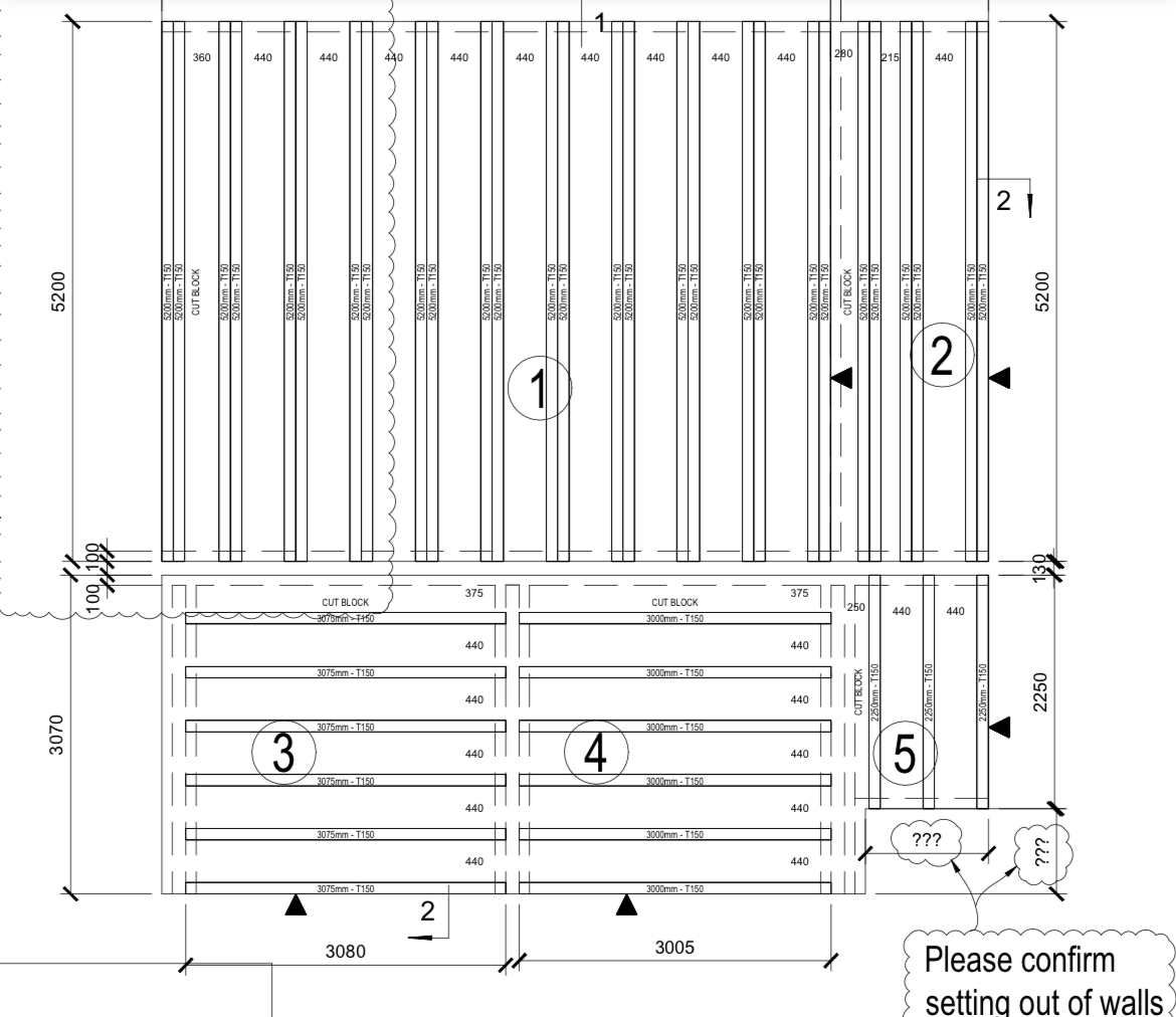

Thank you all for your comments. After stumbling across another thread on here I’ve decided to put in an intermediate wall and split the 5M in to 3M & 2M. Mixed myself with bell mixer and at just short of a cube it was a long day! I already had the materials on-site so apart from cement it wasn’t that expensive. The 3+2 spans are likely to mean I drop the double beams saving 14 lengths of 5M equating to about £500. More importantly though, any chance of bounce should now be gone. For any that follow behind me on the issue of bounce on 5M spans have a look for the thread titled ‘Spans - Precast Flooring or intermediate support’ started by moggaman
Looking for peoples experience and thoughts on block and beam (B&B) bounce please… I’m middle of Self building single storey K/D extension and due to ground levels using block and beam (B&B) for the extension itself and the patio which leads on to back garden. Extension floor slab B&B to be set off internal block skin and external patio and side walkway B&B to be build off external skin. Extension above ground cavity block work to then continue up off of these. The patio span is 5.2M (by 7M wide) and currently have extension subfloor walls built, and garden supporting patio B&B foundation poured. Plan back from B&B manufacture is attached (FYI price on beam only is £1.4kExVaT) Their response to my follow up enquiry asking about bounce the manuf. said: ‘The design currently has a natural frequency of 4.35 Hz. We could improve to 5.28 Hz by reducing all block spacing to 215, or 6.09 Hz by using 150 wide beams only & 215 spacing. The only way to improve on this would be to introduce a spine wall and use shorter beams.’ First off I’ve no concept of bounce from the plan or the improved levels from the proposed alternatives - do folks think the real life experience will be bad/annoying? (very subjective I know but don’t want to be stuck with this and it grate on me at family bbqs or when have friends over entertaining as I guess all will experience the bounce not just person moving. Secondly, do the reduced figures significantly improve things?! These would further increase cost and Seriously considering getting the plant back and digging and pouring another foundation to split the 5.2M span down in to a 3M&2M to reduce the bounce. Downside is this is costly as wet conc (and additional pallets of blocks for wall) has to be moved in telehandler bucket driven backwards down a 400m very narrow lane. (Ahh joys of rural living!) Lastly do people advise on screed topping to further bind the ‘slab’ beyond that of just grouting as a way to reduce bounce. From my reading it seems common occurrence but this does seem in an internal setting. (I’m using 100m concr finish for the internal floor slab but thinking/hoping don’t need to for patio outside. Thanks for any input. ed (note photo shows a partial foundation already but this was added just for a small upstand wall to retain the earth)
