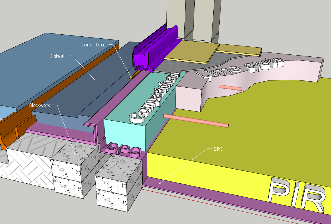

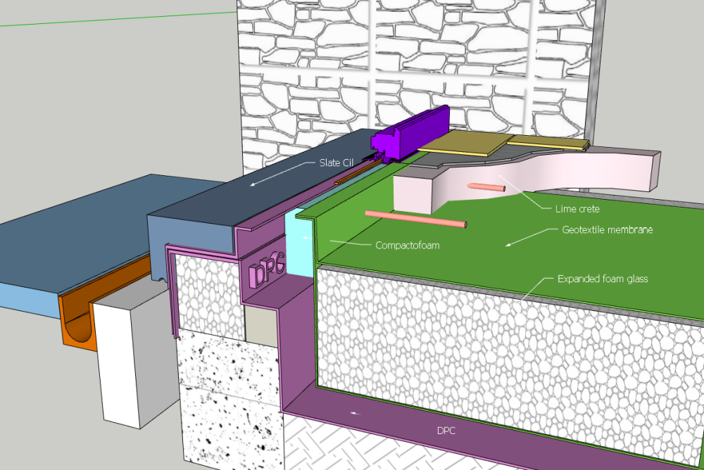

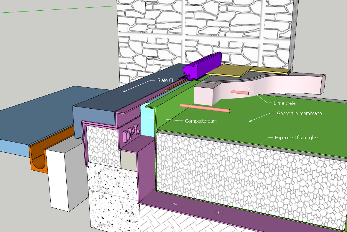

  1. Can someone tell me if these details are ok? I'm concerned if the DPC is in the correct place - many thanks all feed back welcome!
  2. Thanks - I'll check the flow rates - BTW of the two examples the first one was the one that was amended the seconded was the one I wasn't happy with - cheers
