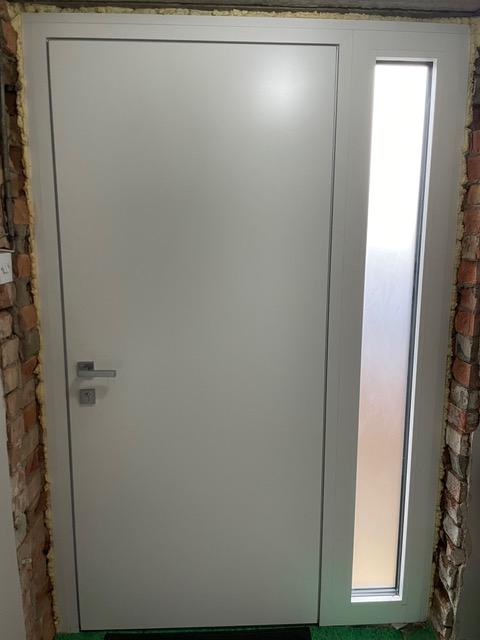

  14. A company called Entrance CDS in Nottingham do smooth finish doors. Comp door now also does smooth skins on a selected number of designs. Does anyone know of any manufacturers who also make the frames for their doors? Many of them buy in the frames so i’ve been told that the colour and texture is never an exact match and is visible more on some colours, for that reason most retailers recommend a white frame.

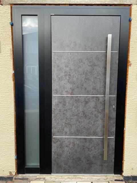

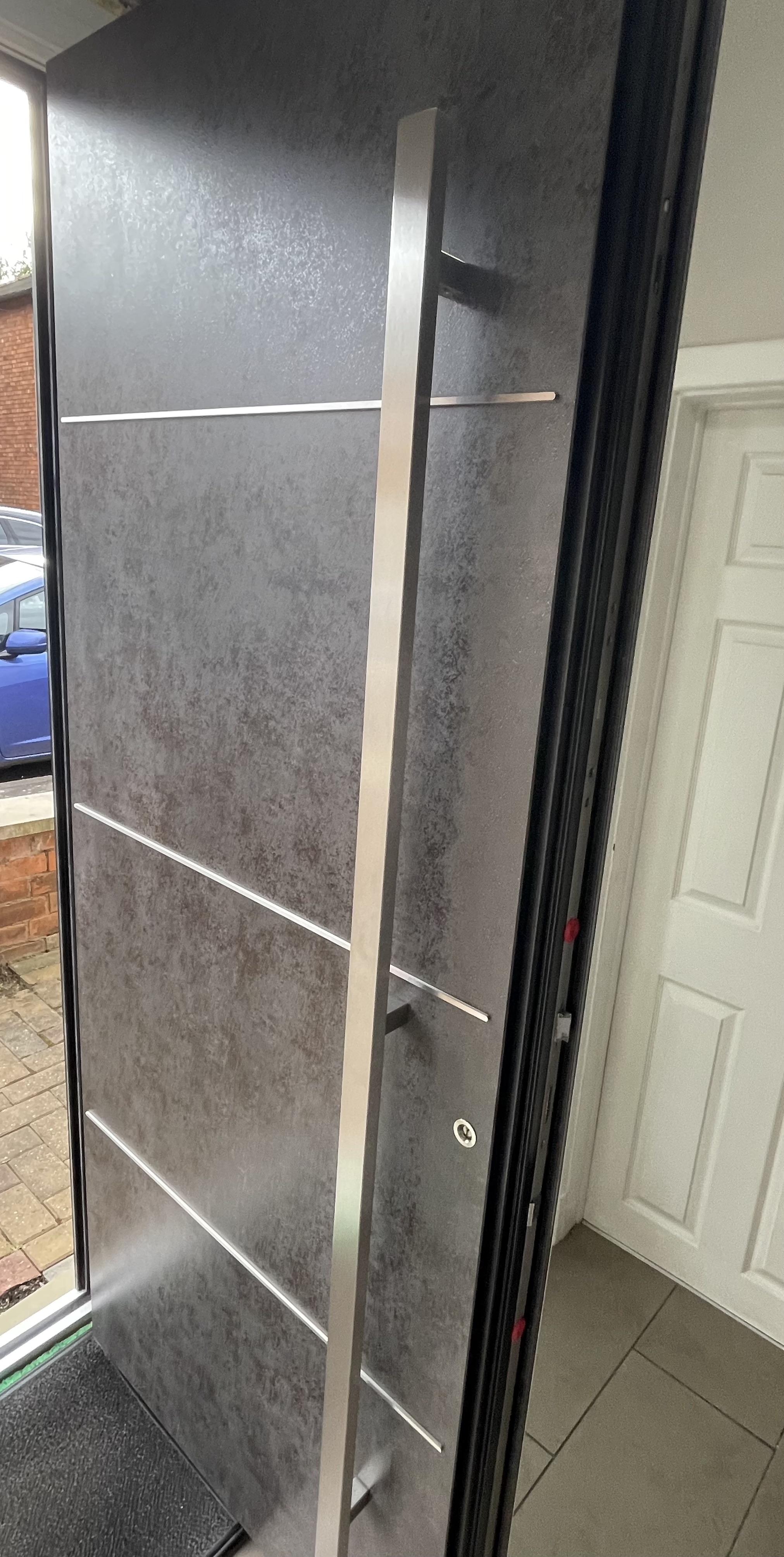

  18. Hi Everyone, I am selling a Internorm A410 door in Art Steel with a sidelight, which was purchased in 2021 as part of a renovation project, which was never finished due to unforseen circumstances. It's in excellent condition (please see photos attached) and has been uninstalled and stored with care. Here are the details of the door: - Size: 2180 (H), 1440 (W), with a 440 sidelight, Depth 93mm - Finish: Art Steel, Frame Ral m9005 (Matt Black), interior Traffic White - Santino white glass - Still has transport bead attached to the bottom. The door is located in Leicestershire, and I would be open to any reasonable offers. Please direct message me with any questions. Many thanks
