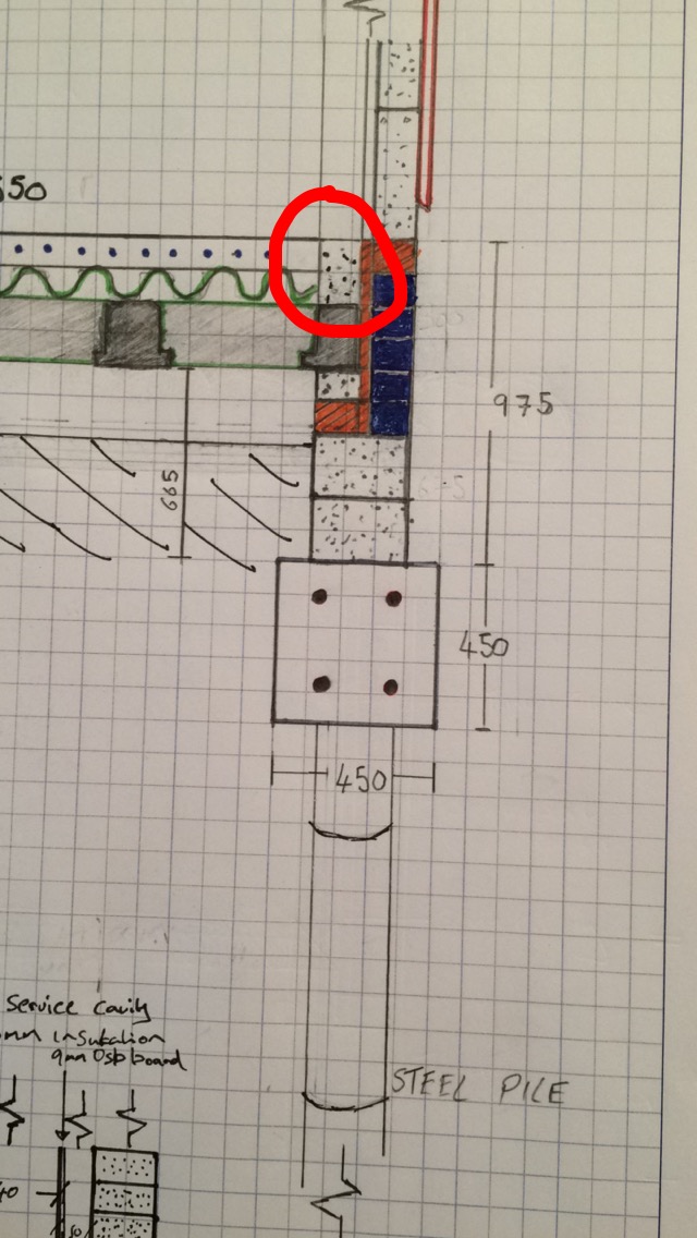

  3. Thanks @RandAbuild - I am leaning towards this due to cost. Jet floor recommend this so I hope it will not affect the thermal qualities of then build to much.

  12. With a compression strength of 2.9 compared to that of 7.3KN of the aircrete block - will this cause a problem - Also as that block will need to be 150mm (140 Foamglas +10mm bed) Foamdglas is pretty expensive (extra 2400 pounds than I budgeted for this part of the build). Is this the way forward you believe?
  13. Hello All I know this topic comes up a fair bit. Could someone tell me what the best material would be to use on the circled area? I am using the Jetfloor system - Foamglas is coming in really expensive & Fonterra (jet floor) are telling me to use an Aircrete block. The timber frame will sit on this. Cheers James
