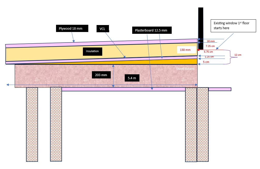

  1. Lower of the beam is not possible unfortunately as it is a mesh of beams and they are welded.

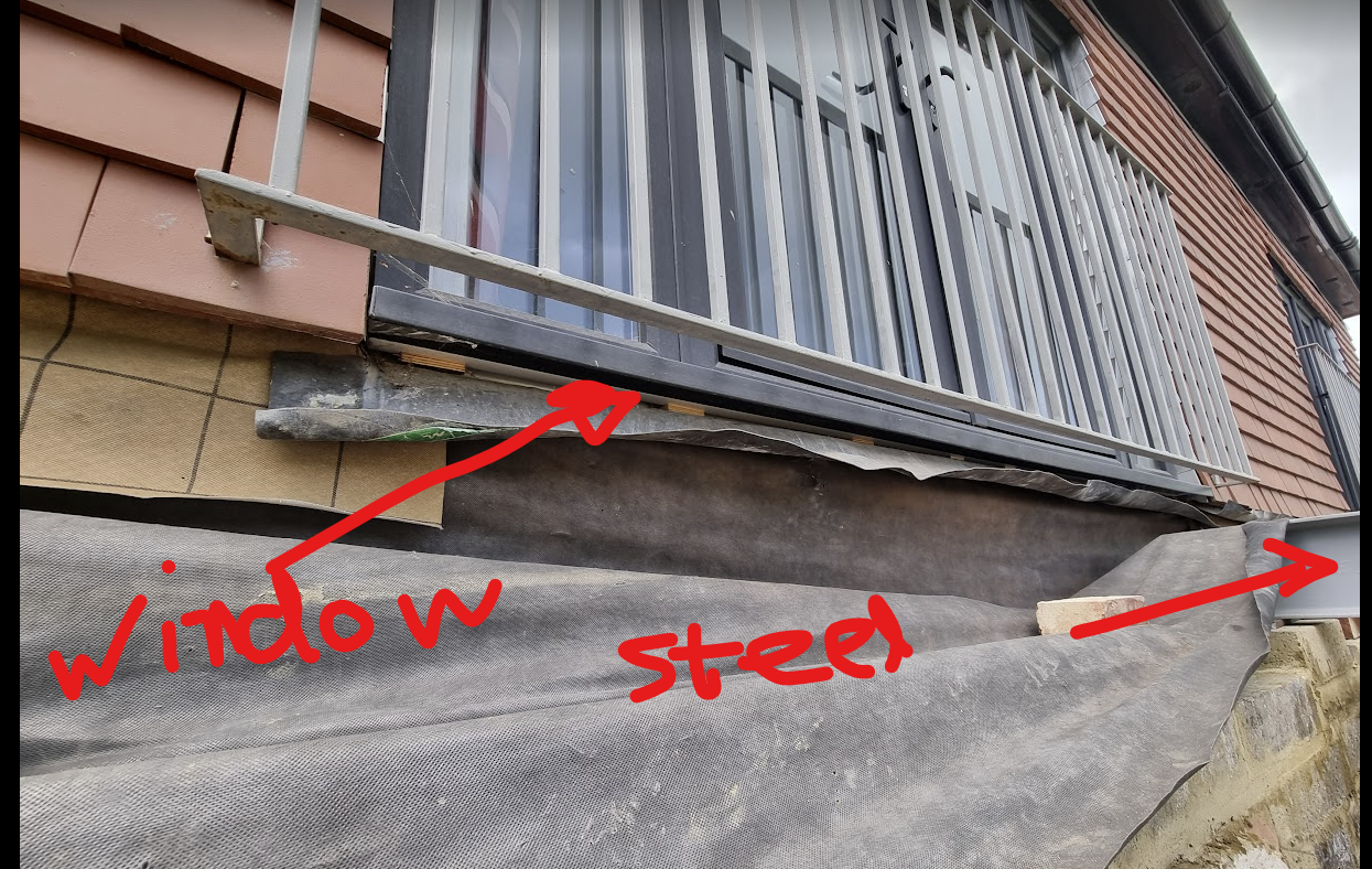

  2. Thankyou Carrerahill and Conor. The mistake was made by both the architect and the builder. The architect did not take the measurements properly, and the builder followed the architect's drawing without verifying, only to discover the issue later. I believe the best solution is to replace the window with one of reduced height. Thank you again.
  3. Thankyou for your reply, does it mean moving the beam lower ? If yes, it is very challenging as it has been welded at the other end.
  4. There appears to be an issue with the height of the new flat roof on the rear extension. The increased height doesn't leave enough space for proper flashing installation (clashing with Window). Unfortunately, we can't lower the steel beams as they have been welded. Could we discuss potential solutions to address these concerns?
