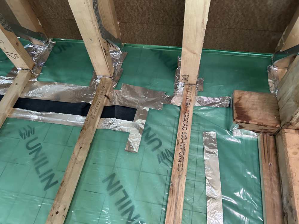

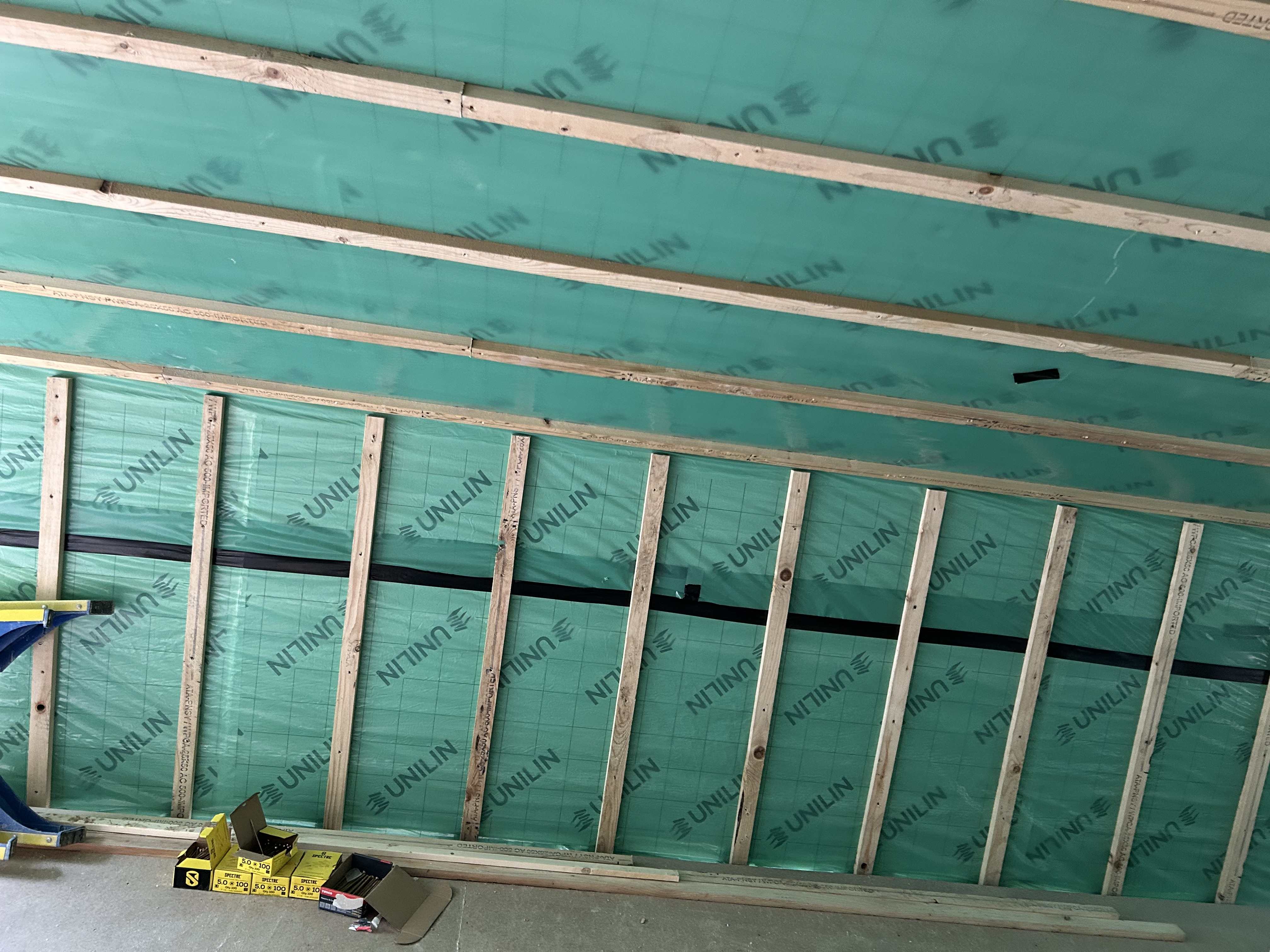

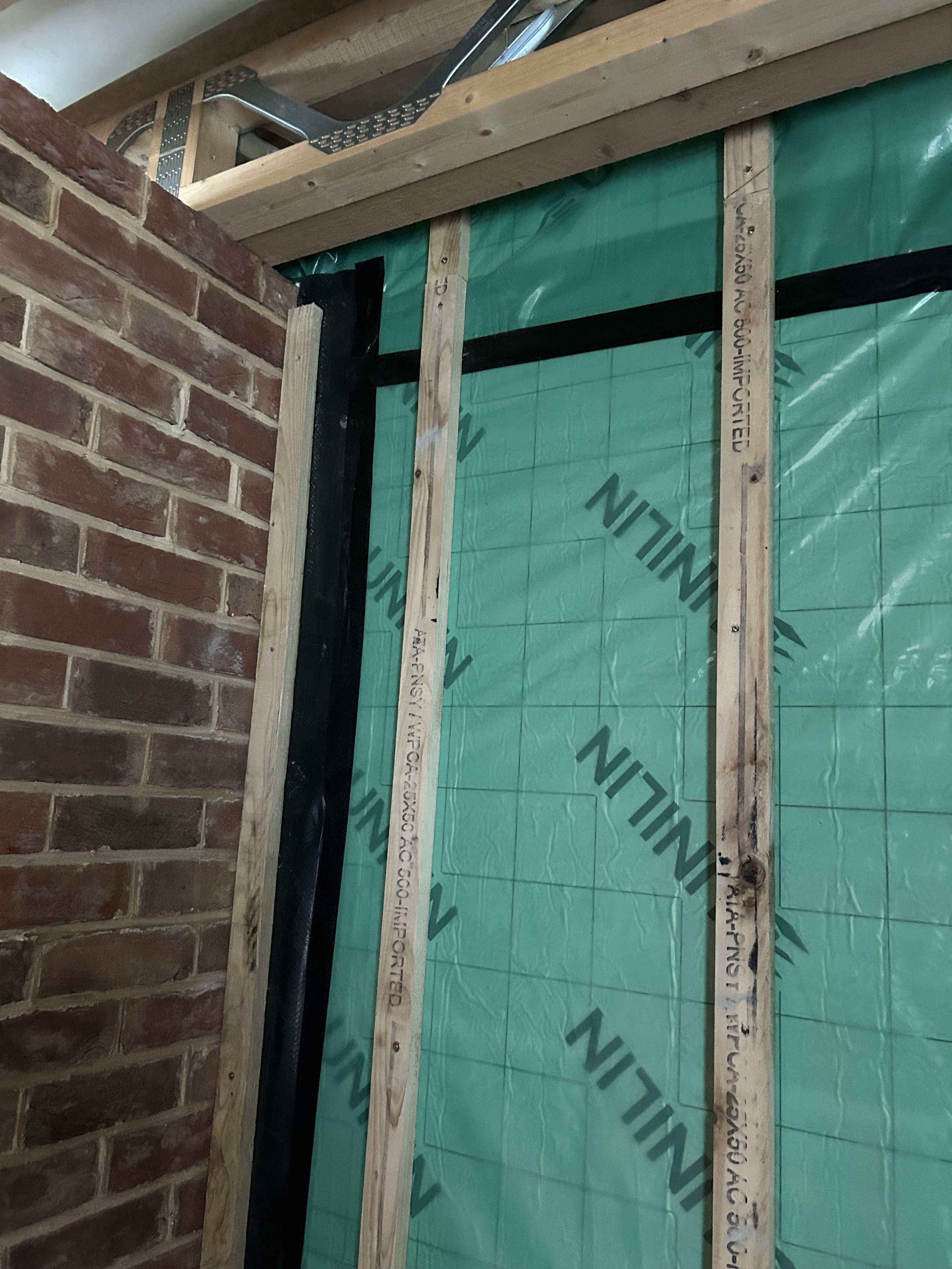

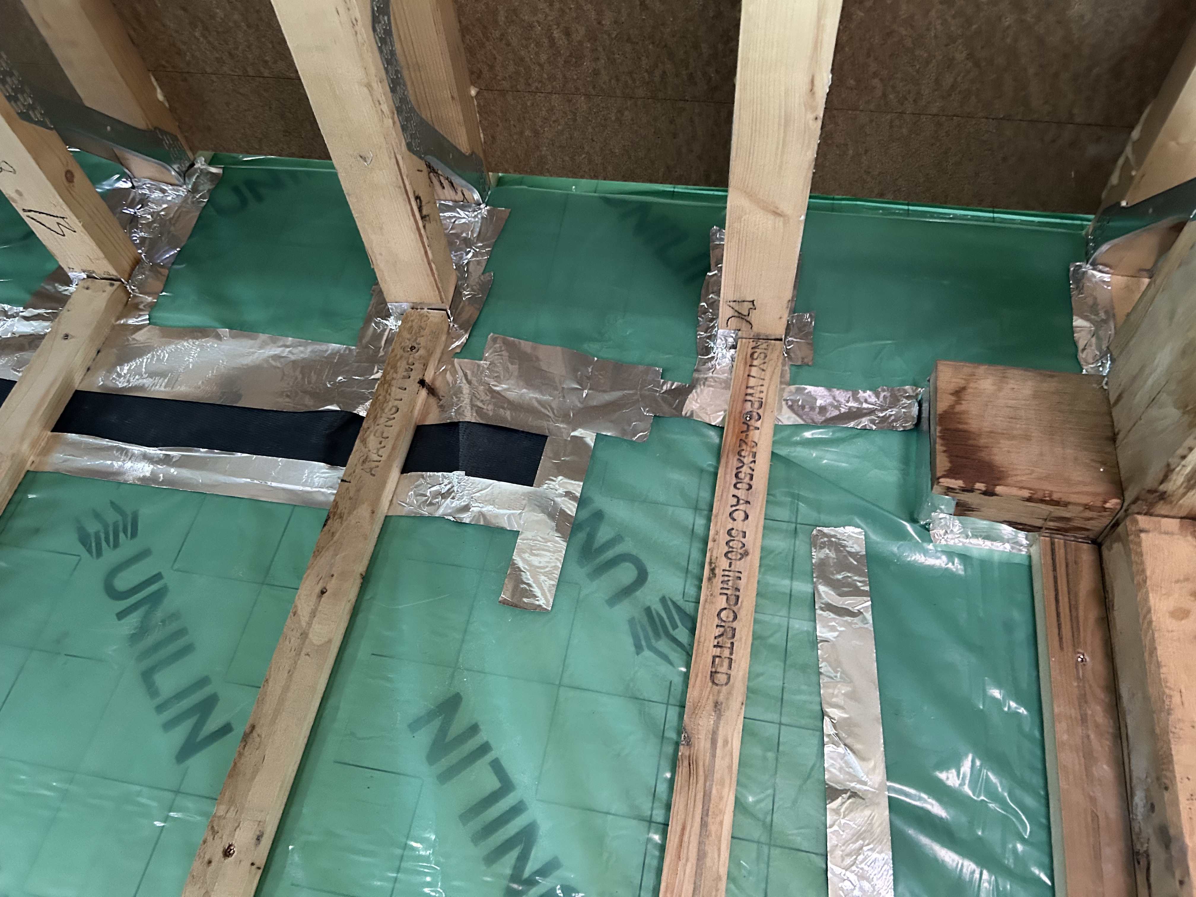

  2. What about creocoat ? I made a trough out of timber battens, lined it with polythene and dipped it all. It covered all sides and ends at once and was quicker than brushing or spraying. i stood the treated boards in a bucket to catch the run off for reuse.
  3. Mr P the internal walls are block, or brick downstairs. There is 50 mm of pir insulation between the internal and external walls ends. starter ties were bolted to the walls, through the insulation to avoid cold bridges. the original plan was stud wall but we preferred this option. all this was completed before AB arrived.
  4. IW insulation with air proof membrane and attention to detail got my initial reading down to 1.7 Aero barrier guys. We’re impressed with the workmanship. the magic mist got it down to 0.2 acp cost £2,200 no VAT as self build
  5. Aero barrier have been and gone. initial air changes per hours was 1.7 builders did an excellent job and AB guys were impressed. after their magic mist was finished, they got it down to 0.2.

  12. Hi Guys an update for you. The walls are up, 2x dense blocks with 50 mm uninsulated cavity. 100 mm kingspan and air barrier fixed to walls with 150 mm concrete screws at 400 centers. building regs and warranty company are totally happy. the walls and insulation feel solid and warm. All joints were taped before air barrier etc was installed. the battens will give a good fixing for plasterboard and any shelves etc. required. i have placed an order with AeroBarrier, but my builder thinks his attention to detail will give a pretty airtight finish anyway AB was £2 k
