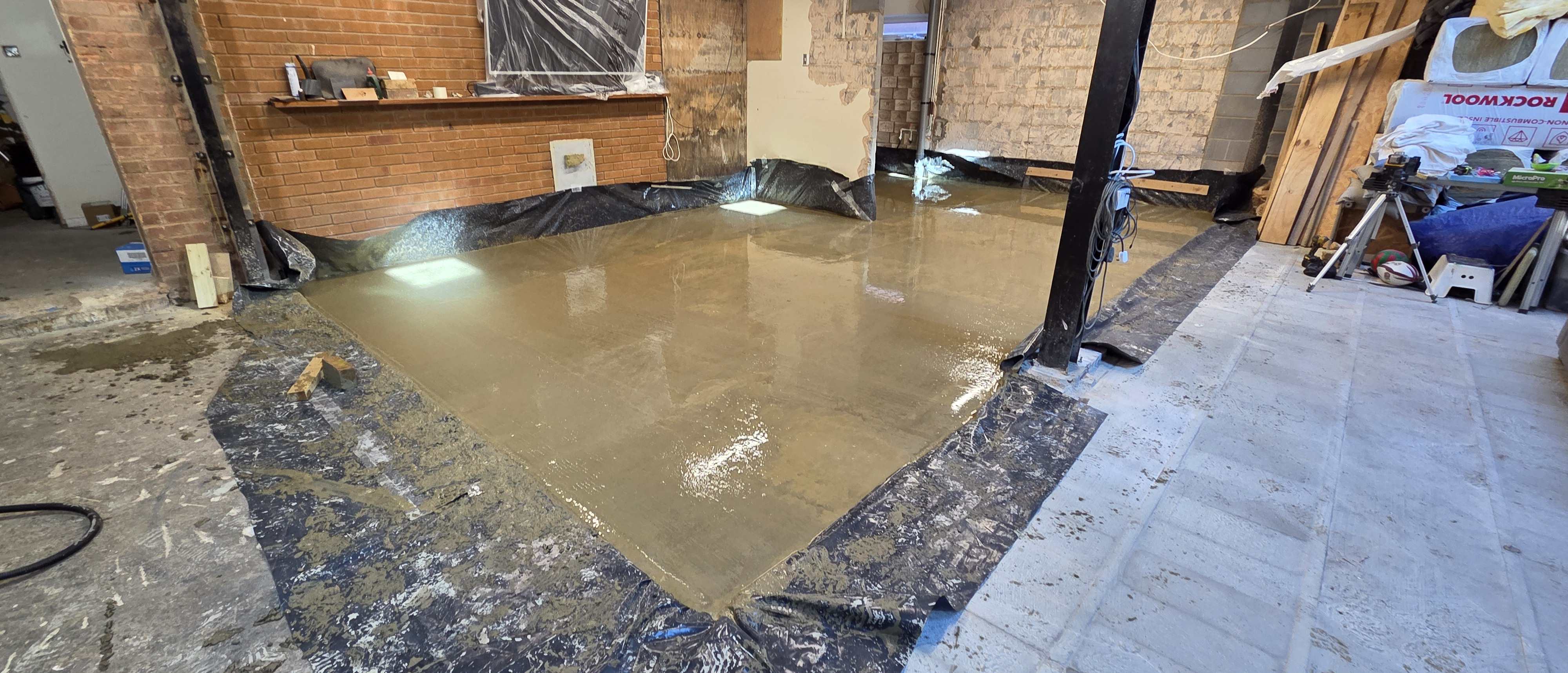

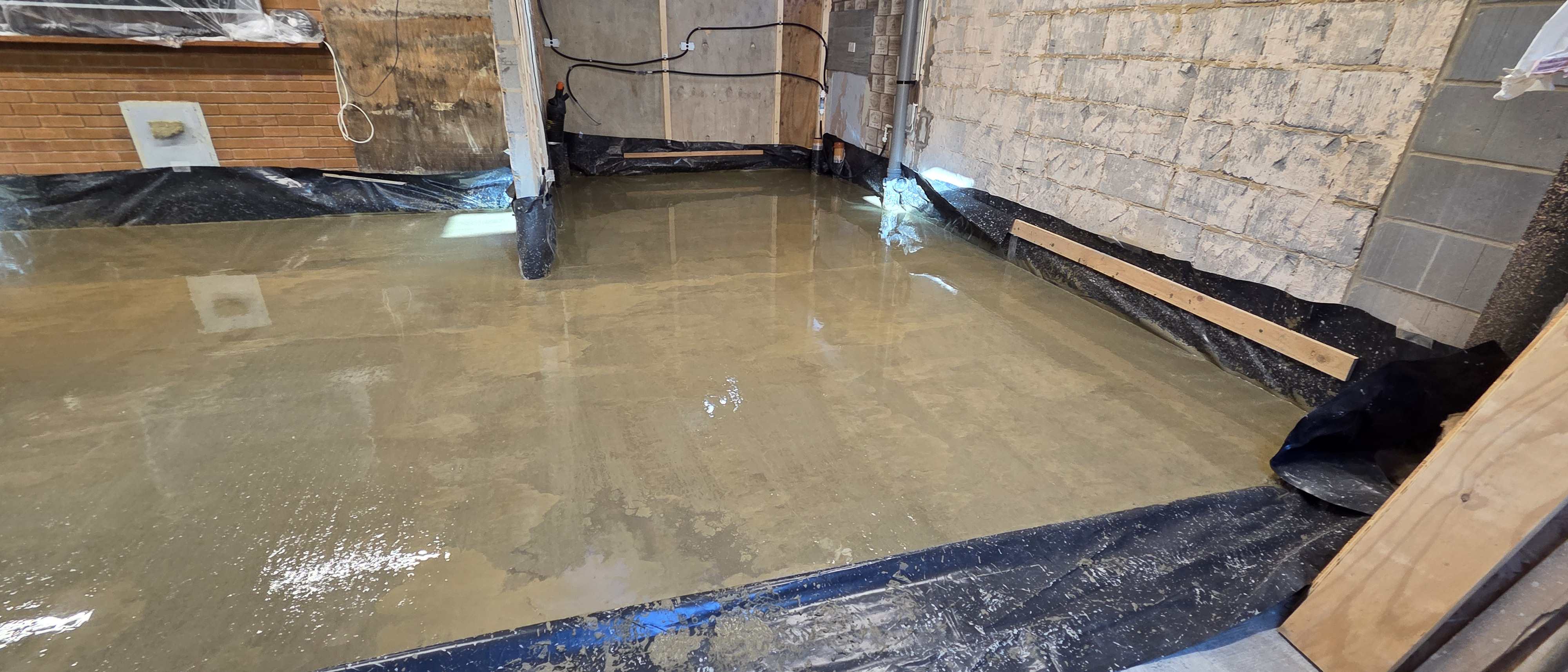

I was under pressure to get PIR down, UFH installed and pressurised to get the CemFloor installed pre Xmas so I got a fella in to do it in the end. He flew through it and did a great job tweaking a few bits on site that the layout plans hadn't allowed for. It was sad, yet a relief to see it disappear under the screed! And another +1 for liquidscreedpumping.com if in the East Anglia area 👍🏼

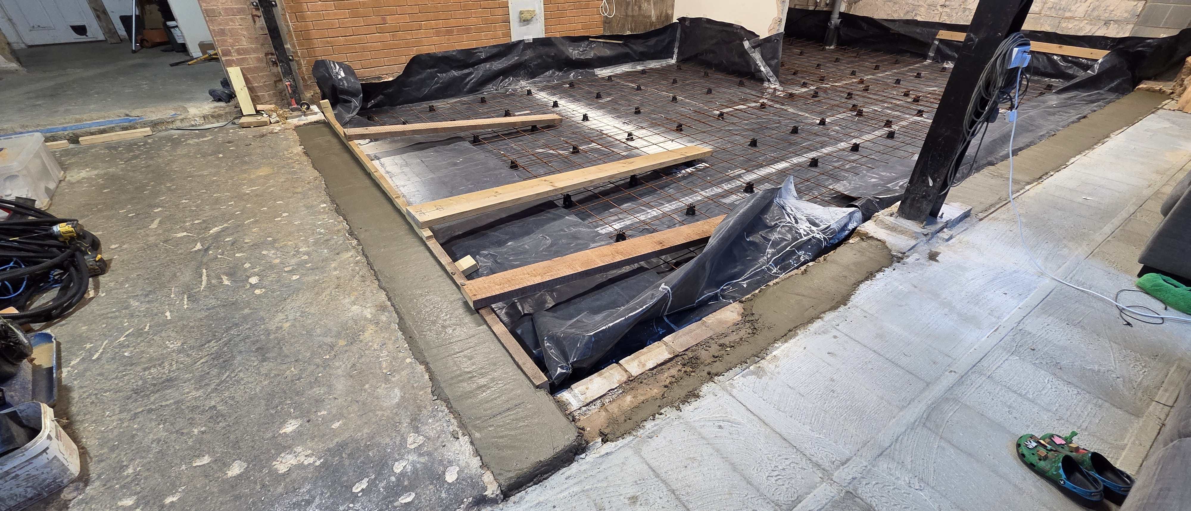

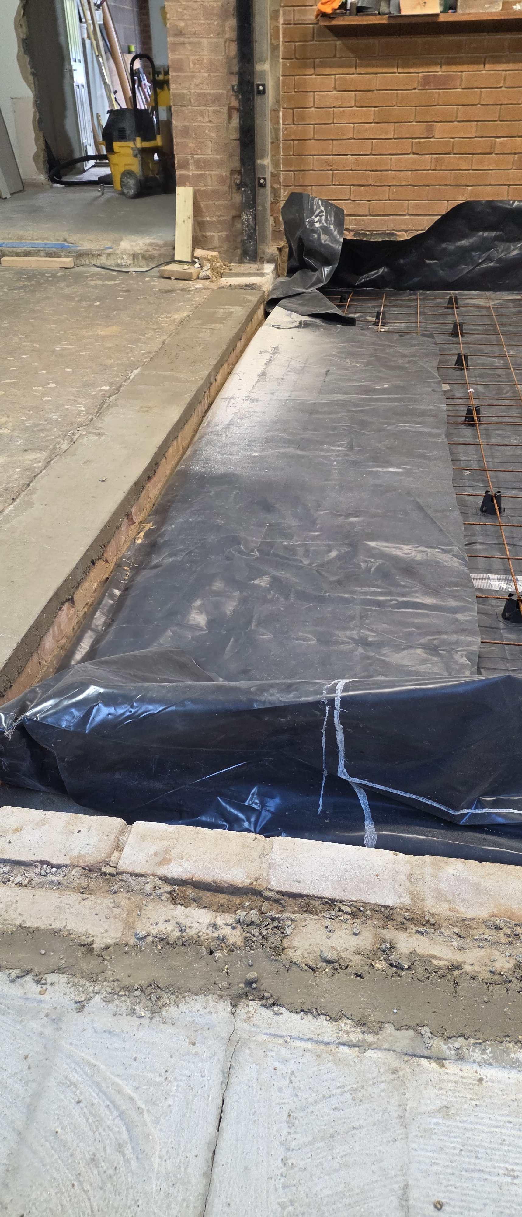

Morning @Nickfromwales, This is the structural ground floor slab, I excavated the existing slab to allow for the new floor build up. Once the slab is down, then it's a layer of PIR across the new slab, existing slab and the B&B floor. Then UFH clipped and screed over the top. As the new slab will be abutting What's left of the walls I've demolished I wasn't sure whether to use the UFH foam to, in a way, decouple the new slab from the existing structures to allow for expansion & contraction. Thanks
Afternoon all, I'm having concrete pumped for our new slab tomorrow morning and just had a thought...... Where the new concrete slab butts up against existing structures, i.e. old foundation, external and internal house walls etc. would would it be wise to put in some UFH edge strip to allow the slab to expand/contract? Or just poor it tight to the existing? On top of the slab will be PIR, UFH and then finished screed. Thanks

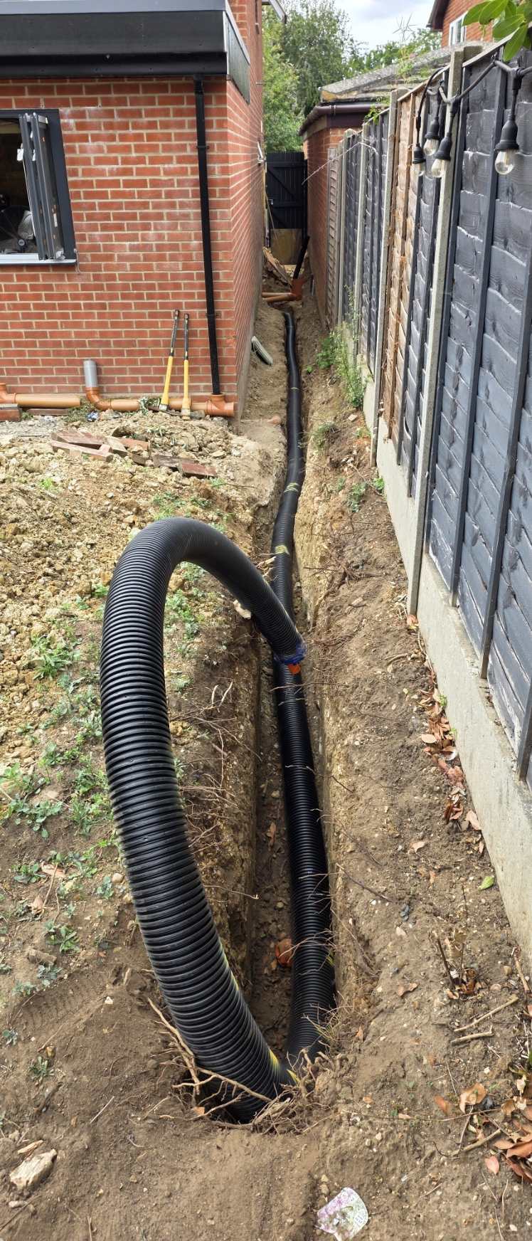

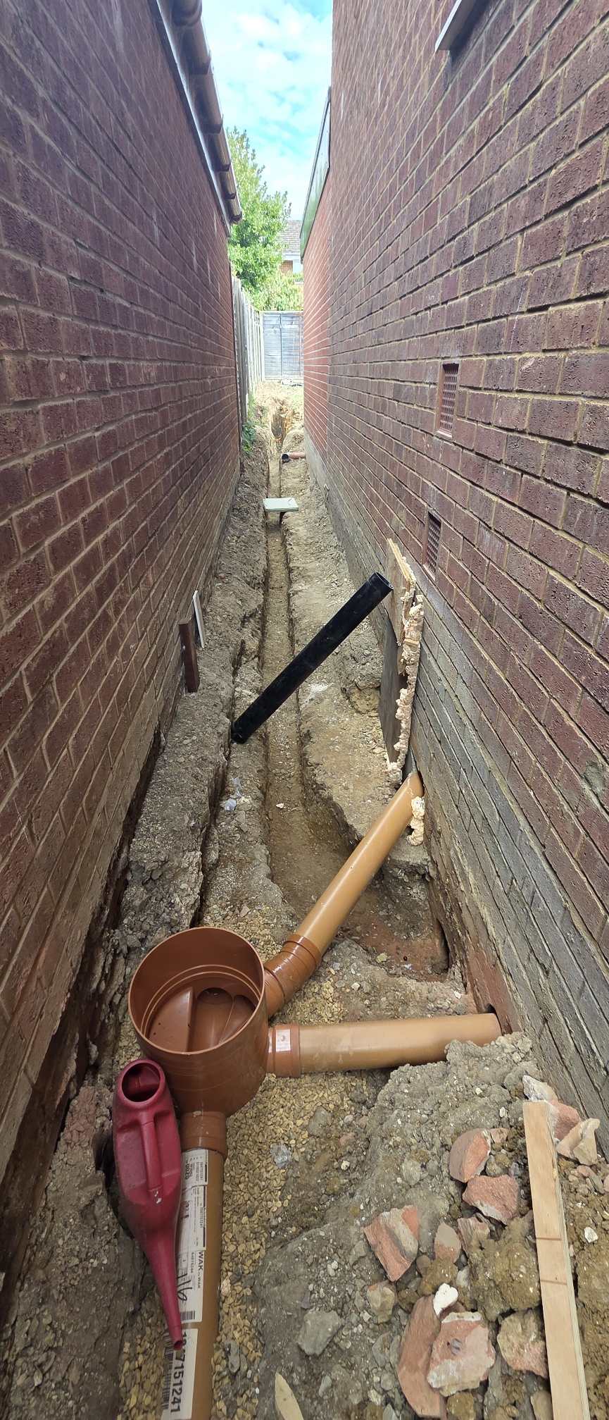

Thanks @crispy_wafer, I was looking at the plastic duct chambers and perhaps doing the joints in those, while it means they are accessible they would then have to be a decent size to allow bending the mdpe back out of a connection and in again if they ever needed to be changed, And if they're unlikely to ever need changing, then why bother with the access chamber, Another example of the procrastinating I'm doing! -

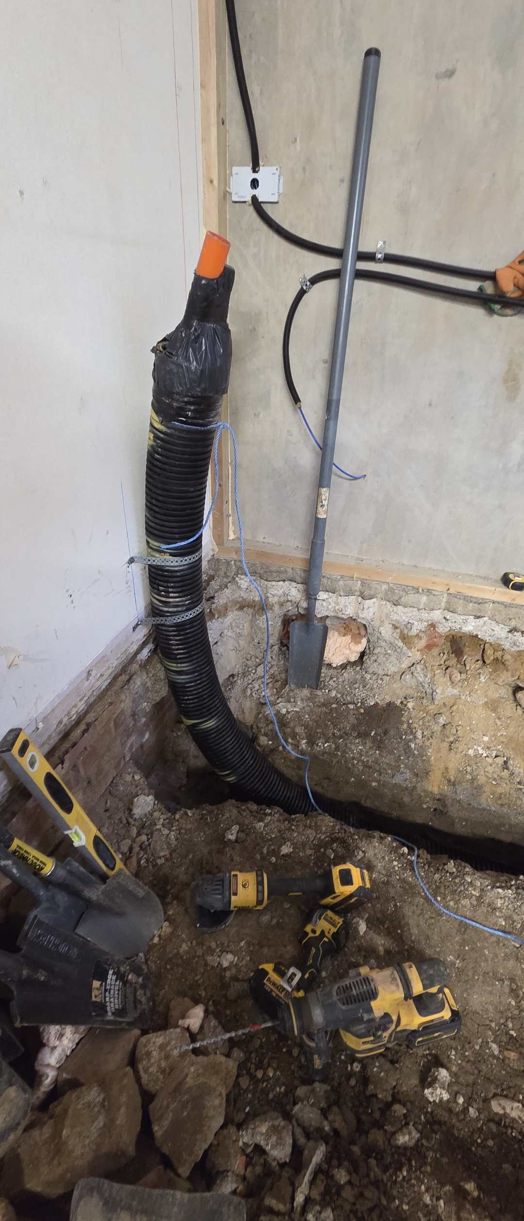

Also, if I may. I'll be running a new 32mm MDPE main along the same trench and I see Plasson couplings are well thought of on the forum. I will be using at least two tee's to split the new mains feed, one x 'front garden tap', 1 x 'house supply' and 1 x 90 for a 'Rear garden tap'. Would you try to keep the fittings accessible or are they genuinely a fit and forget product? Is there a preference between push-fit / compression? If accessible any recommendations on how? Thanks -

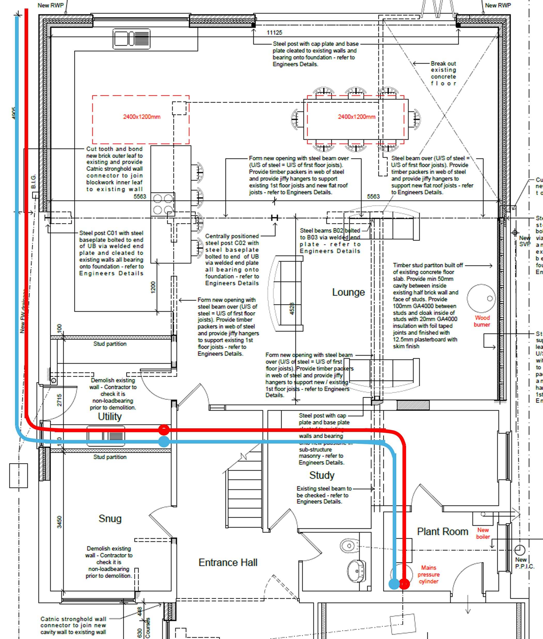

Thanks again for the insight @JohnMo, I understand what you mean @SimonD, as a compromise I've seen some run from central manifold in 15mm to a manifold in the bathroom and then split to outlets. With en-suites typically used morning/evening in conjunction with a shower I guess it reduces the time waiting for HW to arrive. I can see from the forum that Hep2o manifolds are well recommended I've seen repeated reminders by @Nickfromwales and others to ensure any garden taps are not connected to the DW manifolds. So I'll start sourcing those material in due course, I'm now back to weighing up whether I do have to sacrifice part of the utility room for ASHP performance and efficiency (i.e. locate the UVC in there and associated plumbing/manifolds) or whether the ASHP could still perform efficiently if I extended the flow and return to the plant room. But looking at the specification tables it appears just the now installed subterranean flow and return (22m pre-insulated pipes with ID of 42mm) may be a little over ambitious....... I'm now thinking a run similar to that outlined below (approx 30m ish) would definitely be a little too ambitious! As a side note, it's today that I really wish I had concentrated and finished my M&E apprenticeship all those years ago. -

Evening all, I'm trying to finalise a plan for re-plumbing our renovation but excessive procrastination on my part has me here seeking guidance from BuildHub members, In short, we are renovating the entire house which necessitates a re-plumb and re-wire, We are moving from gas fired Warm Air Heating (Brink B-23D) and Immersion hot water to an ASHP with Unvented Cylinder (finally hot water at decent pressure!). We have a HeatGeek proposal from a local installer, but I have decided to take on the UFH downstairs and UFH overlay upstairs to reduce the quote, and owing to build timescales I have run a length of pre-insulated pipe below ground from the proposed heat pump location to the utility room shown on the drawings (approx 20m). House heat loss has been calculated at 13.42 kW and the design done to -3.0 C (Cambs) - Vaillant aroTHERM plus 12Kw Heat Pump - Vaillant uniSTOR 300L HWC We would like to install a Water Softener too, as we are in a hard water area. I had initially intended to put the UVC and plumbing manifolds in the plant room but it would result in a pipe run from plant room to the kitchen sink of approx. 22m which strikes me as being less than ideal. As the insulated pipe for the ASHP comes up in the utility room, I am now considering putting the UVC in there as well as the plumbing manifolds, I am yet to run a new 32mm mdpe mains supply, which will be either into the utility or plant room once I've bitten the bullet! I've come up with the following manifold configuration for outlets, Redacted Drawings.pdf Being more familiar with a branch and tee system, could I ask your opinion please on the proposed manifold configurations for DHW and CW please? - Given the length of the runs would you instead opt for one run to each room and split within i.e. a 22mm run to a manifold in the bathroom and then 15mm feed to each outlet? - Is there a general rule of thumb on pipe size to certain outlets? (i.e. 22mm to bath, 15mm to sink etc....) - Any other general pointers? I've attached the floor plan below

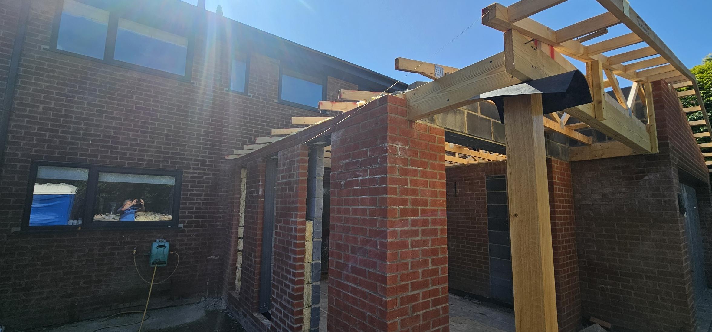

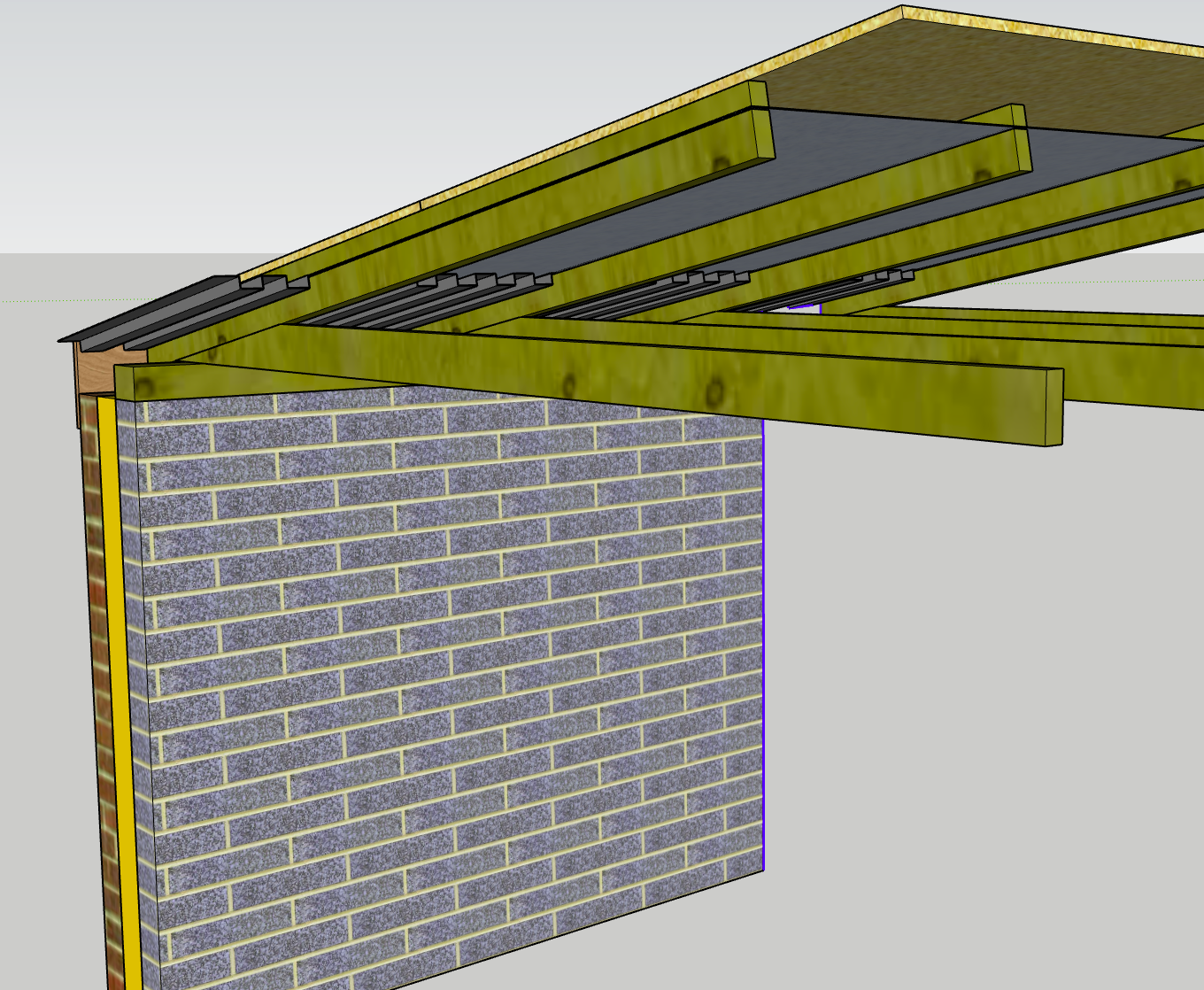

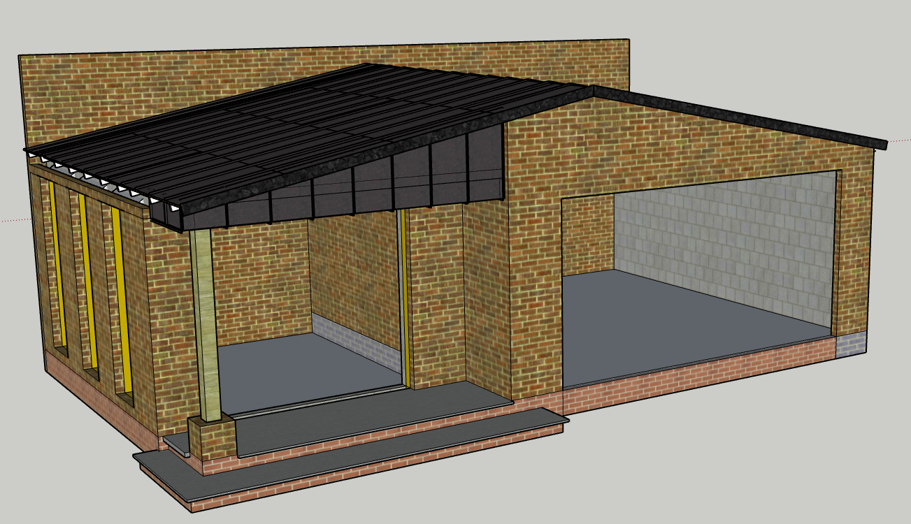

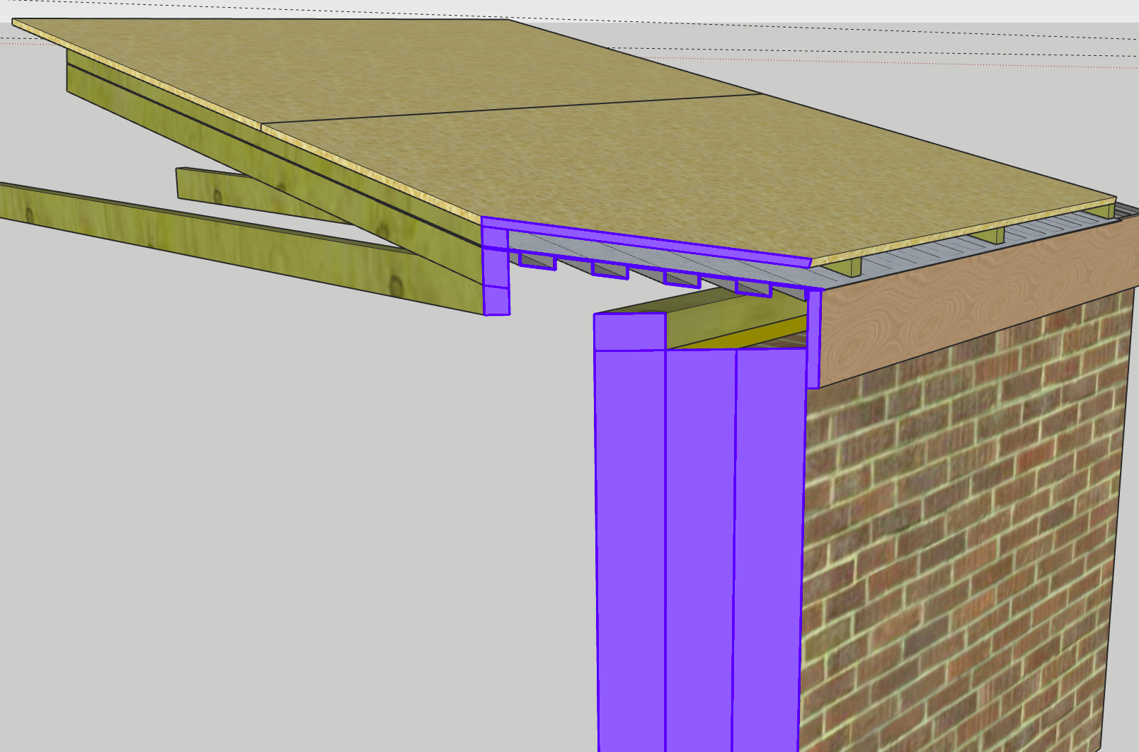

I am about to start building the subdeck for a standing seam room, I'm getting splinters while I still procrastinate zinc, steel etc. I have been discussing the supply of Standing Seam from Pagurek with Patrick who has been very helpful but I'm after some pictures or advice from those who have done similar before I climb up onto the trusses and have at it. The roof concerned is a gable roof, it covers the porch (extension) and garage (existing) and is a move away from the flat roof which was on the garage before. Trusses are in, 600mm centres and an 11 degree pitch, the entire roof area is about 48m2. Regardless of the metal covering I opt for the deck construction appears to be very similar the only obvious difference I can see being zinc may require the last rip of the deck to be 5mm thinner than the rest of the deck. Attached are some photos of the roof as it stands, how I want it to look and a cross section of the deck I am considering. I can't switch to a warm roof (not enough clearance below existing house window where the ridge is) so I know I will be tight for space above ceiling and the roof near the eaves and I need to allow for sufficient ventilation. I also want minimal, if not flush eaves, but this area of the roof is giving me cause for concern when it comes to the roof and the breather membrane (for any condensation) terminating in the gutter, For those of you who have done similar before, have you any photos of your eaves detail which you would be happy to share? My proposed build up is outside to in Standing Seam Powerlon Metalix Breathable Membrane 18mm Plywood 38mm batten (Does VMZinc really require 50mm?) Breather membrane (Strotex) 800mm Manthorpe Continuous Eaves (to maintain space between insulation and breather) Truss Questions I am mulling over are If opting for the above build up does the breather membrane (5) need to be able to run off out into the gutter? If the continuous eaves roll (6) is below the memberane (5) am I asking for issues if condensation occurs between the two? (i.e. it can't condense and run into the gutter) How, with a flush fascia do you permit ventilation? Do I need to use some batten to keep the plywood rip out slightly from the brickwork? I may be totally over thinking this so would welcome your thoughts,
