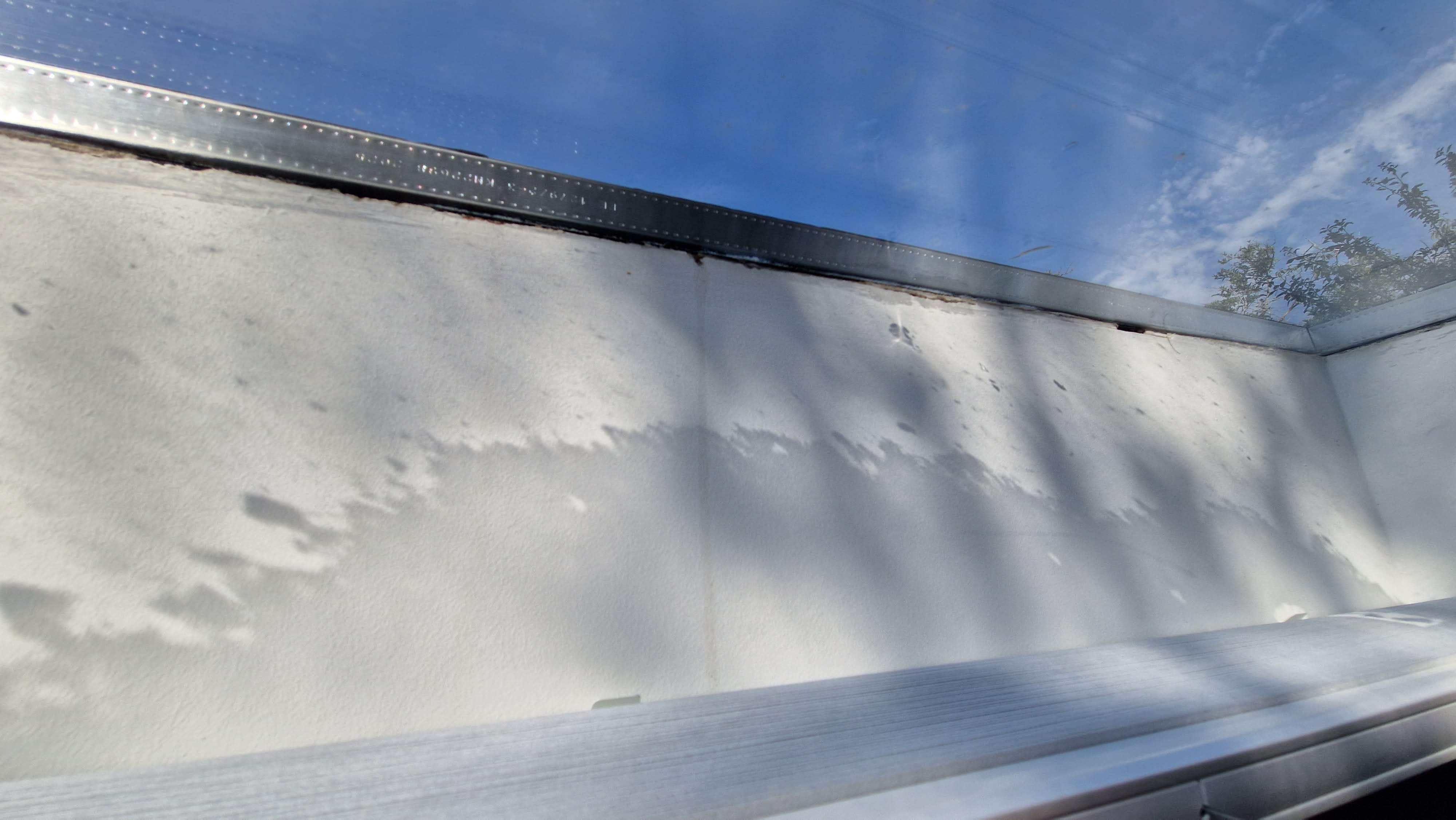

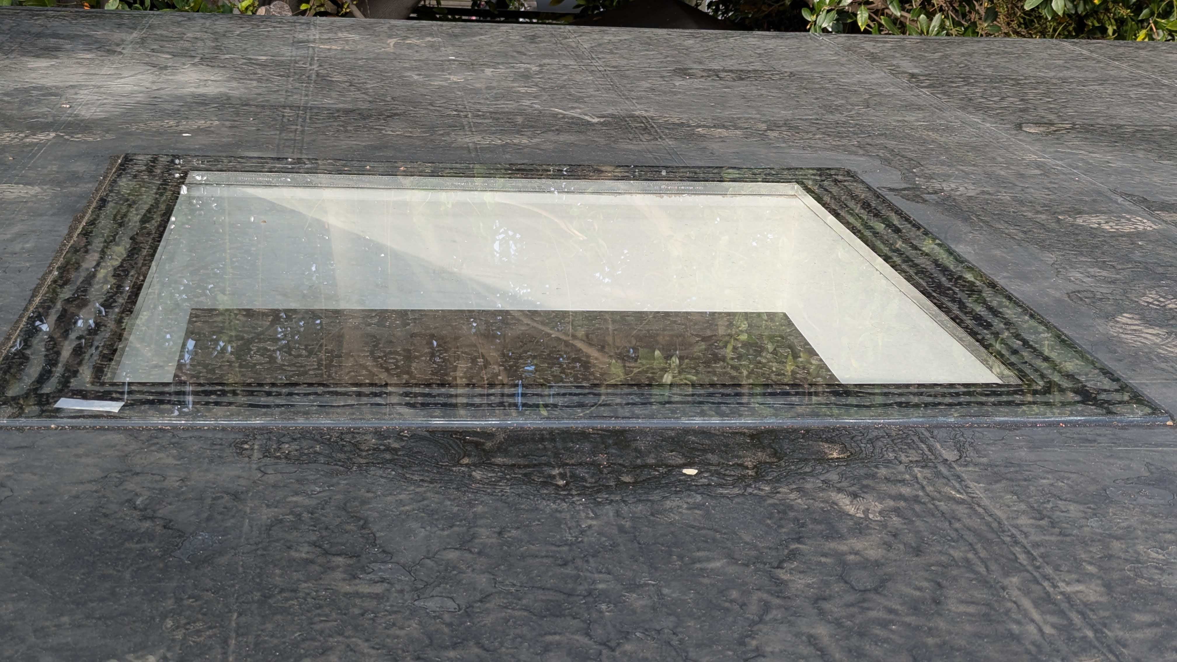

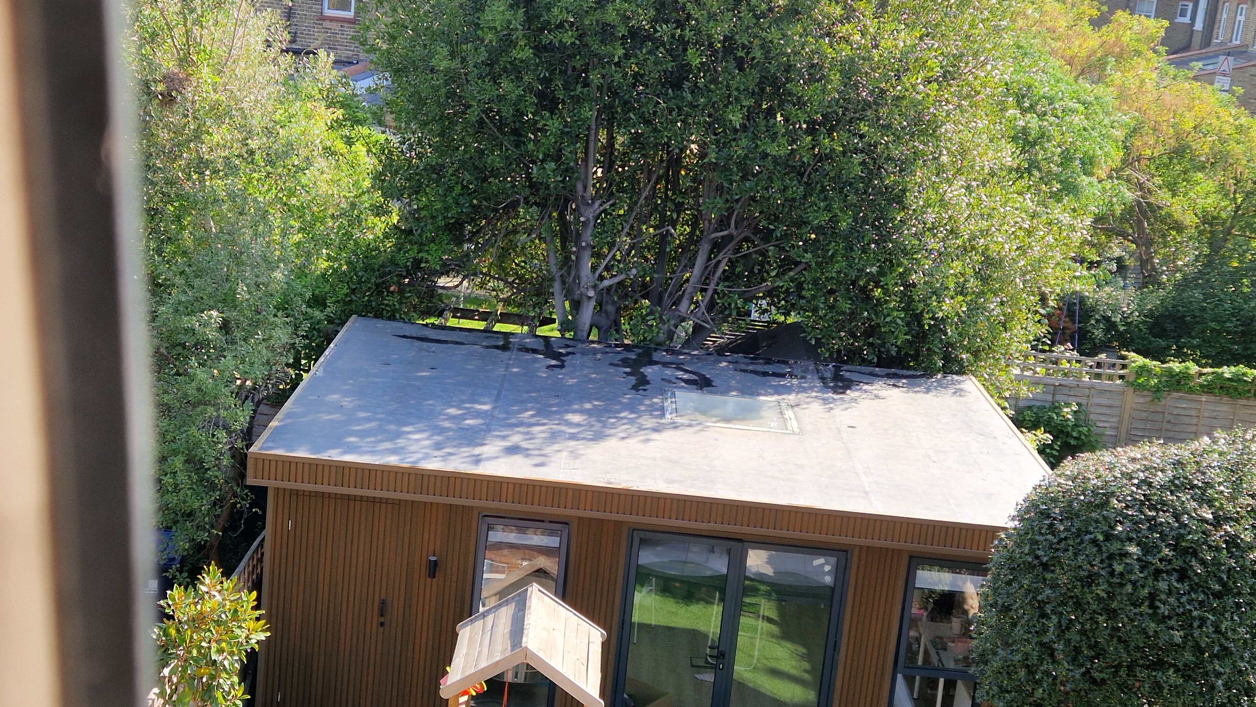

Thank you for all the info... And the temporary aluminum cover 😀 I have decided to get a new window as this window is low quality. I planned to add uv film to help with thermal insulation but now with the upstand, and leak, i think it will be better to replace the window all together
thanks. I'll look into getting an upstand or replacing the window alltogether. Anything I can do to seal it temporarly until I resolved this with a permamnt solution?

Hi, My builders have installed a cheap flat rooflight on my garden studio (see attached photo). Roof is made of steel beams+OSB+epdm. It is flat with ~1 degree slope. I have started seeing some leaks in the inner part of the rooflight (see another photo). Questions: 1. Is this a valid use for such a rooflight? or should I gotten an upstand for the rooflight? 2. How do I seal the window? I think I need something that covers the edges of the window and onto the epdm. I am no longer in connection with the buulders as they have never completed the job so I cannot contact them to fix it. 20250812_093511.mov

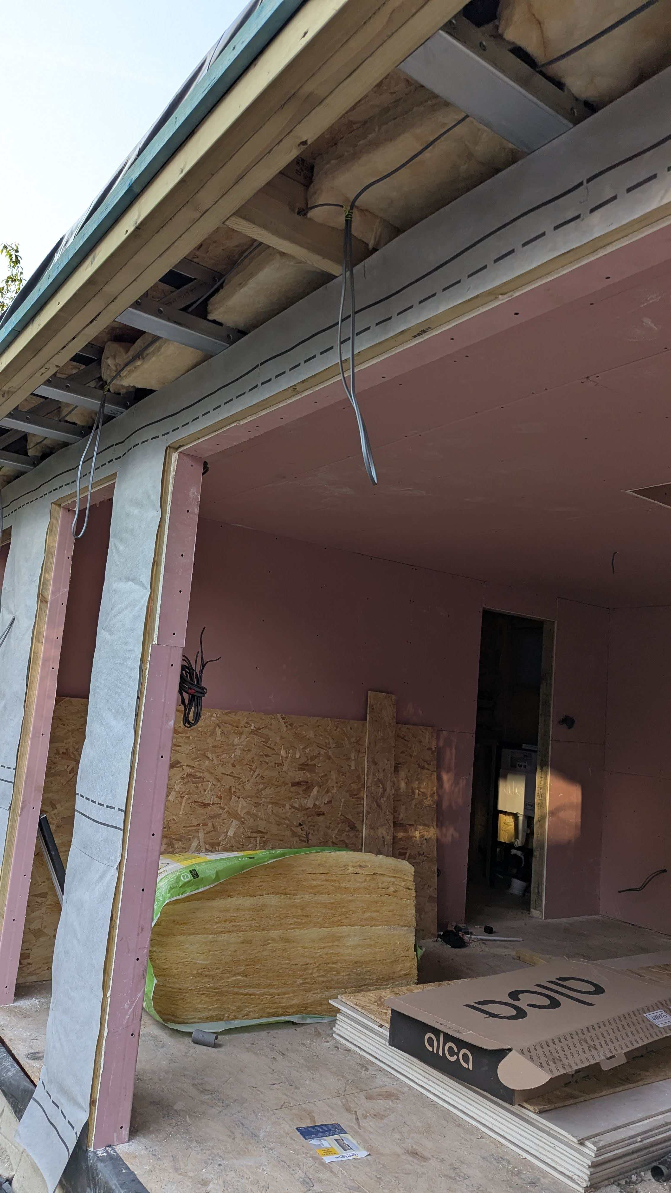

We are building a garden office space. The office has steel beams with OSB and PDM on top and plasterboard below. Between the beams, we have Isover glass wool for insulation. The builders said that there is no need to insulate the 45cm overhang before closing it (see image) but this seem strange to me. I have no experience/knowledge but I am worried that there will be too much cold air coming through the uninsualted part. Am I paranoid or do you usually insulate the overhang too?
