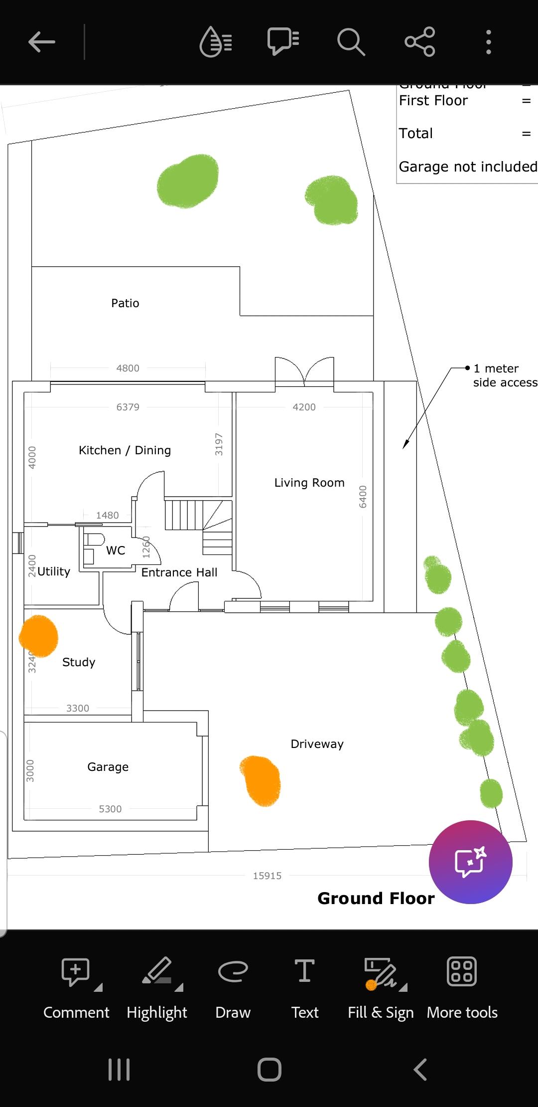

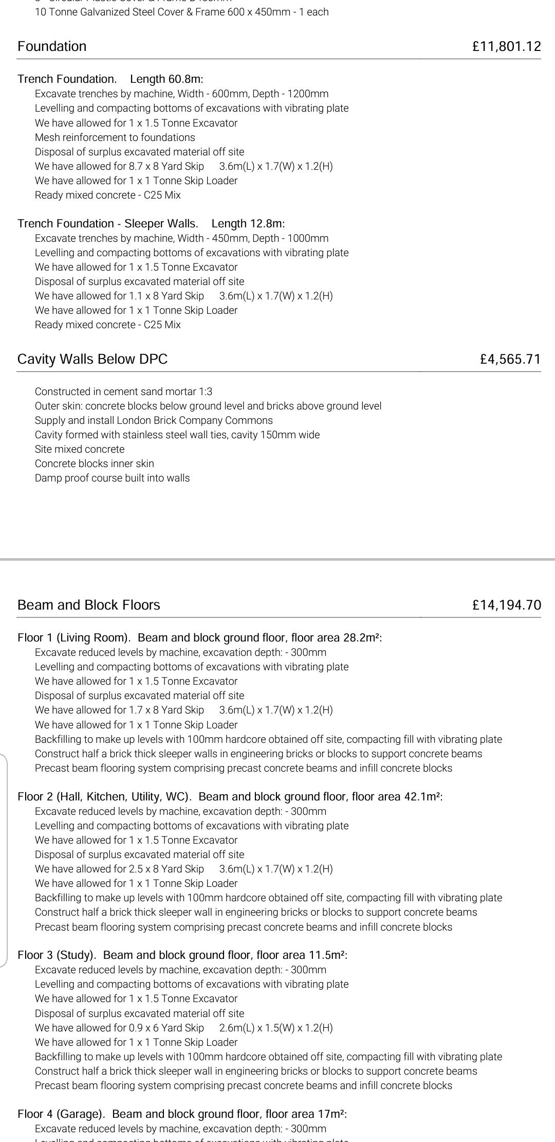

Thankyou @saveasteading, @Roundtuit and @Conor for your thoughts. Will the species of tree stump make a difference? I thought I should ask what type of trees the stumps were and how long ago they were felled. It is being sold with outline planning, all matters reserved and vague in terms of building detail. The building shown on the application plan is to the right side of the plot, smaller (about half the footprint we would like ideally) and fairly uncontentious. The estimator then drew a plan to estimate from which is scant and overall actually slightly bigger than we are opting for, but the way our planned house will sit on the plot is similar except that the front of the build (the garage in the illustration) will not jut out as close to the front boundary as shown but the lounge will be be extended just over half a meter towards the front, right at the side of the leylandii. I've very 'untechnically' added the trees in green (conifers at the front, plum and holly at the back), and the stumps in orange. -
Apologies for the long post....We are almost ready to exchange contracts on a plot of land in a conservation area which has a couple of garages on there(to be demolished). The house we plan to build (approx 150m2 over 2 floors) will fit fairly tightly on the plot allowing for just enough parking space to the front and not much more than a postage stamp sized garden to the rear - but big enough for us! We have a couple of trees (plum and holly) at the back which may mean we need to adapt our foundations according to the labc calculator due to clay soil being highly likely(no soil tests done yet though). At the front there is a row of leylandi and a couple of large tree stumps which I hadn't considered. One of these stumps will be directly where the side wall of the house is planned and I've suddenly thought that they will probably also affect the foundations. Obviously the stumps will need to be removed but then what? What about the roots coming off these stumps...do they also have to be removed and to what depth and radius? How might these affect the foundations. I've had a ballpark estimate done for the build and I've attached a photo of the foundation estimate. I think these did not account for trees or stumps but did assume clay soil. So the thing I'm struggling with are the potential costs of all of this. Is there an easy way to calculate extra costs? I'm thinking that in the costing the allowance is for 1.2m deep trench foundations. Do I just add 50% if we need 1.8m trench or double it for 2.4m, or are there other costs or complications associated with the extra depth eg reinforcement. Could they prevent us removing a Leylandi or two with it being a conservation area and could the stumps prevent us from building what we planned? May be it's just a bit of panic before we take the plunge...
