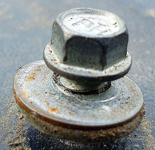

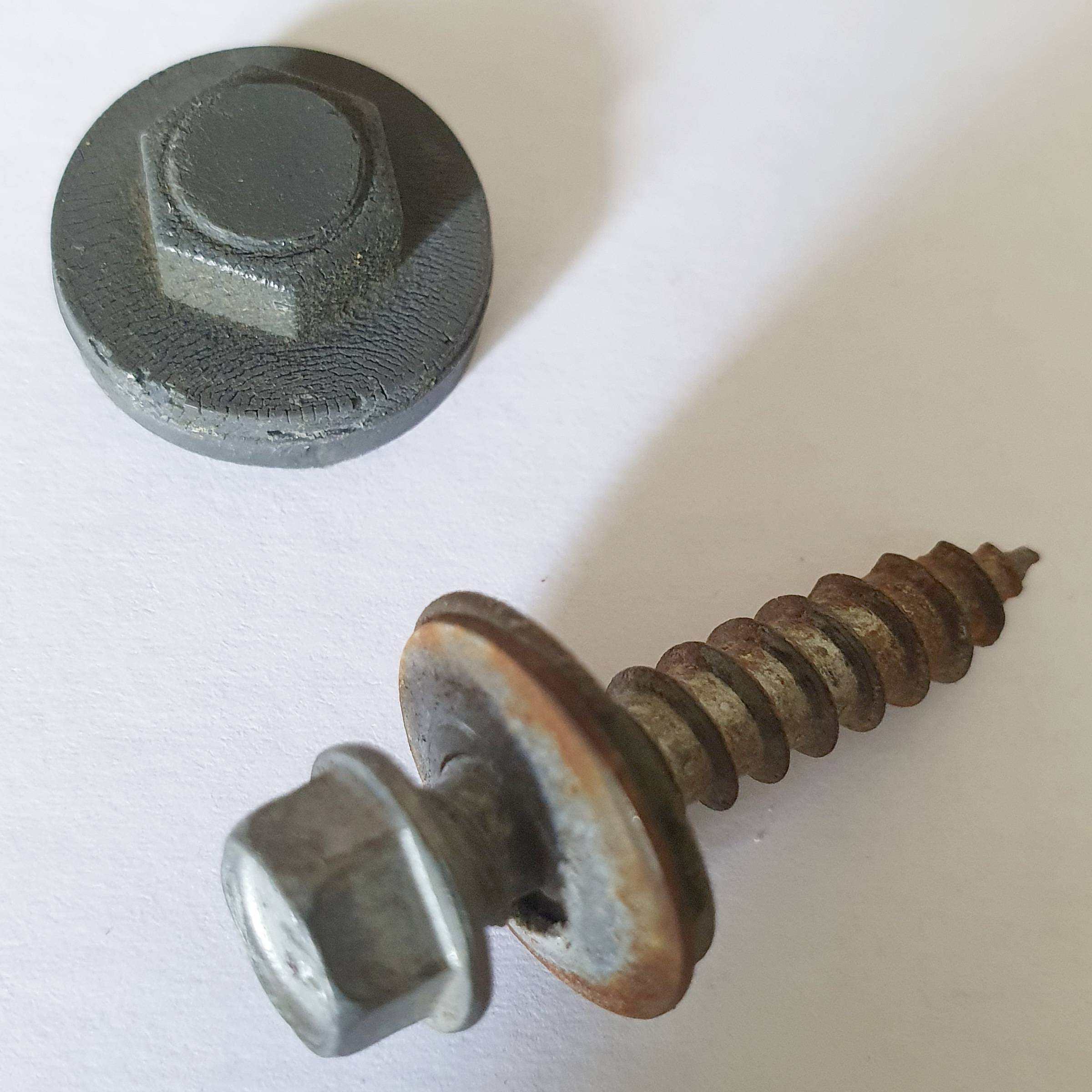

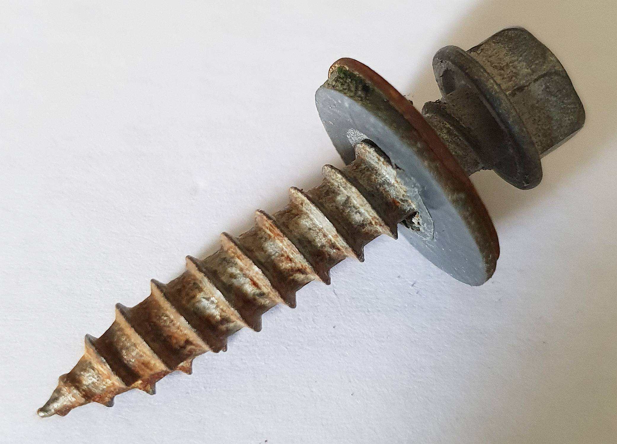

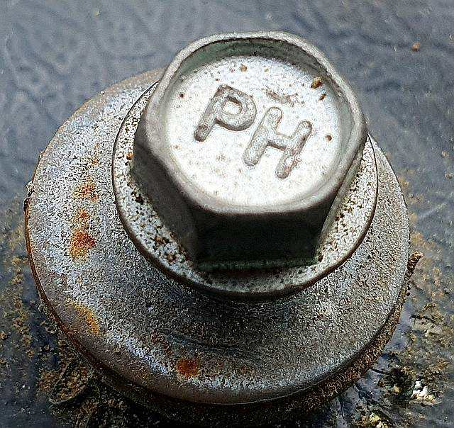

What fixings may I need to stop leaks?
David001 replied to David001's topic in Roofing, Tiling & Slating
@saveasteading, a Technical Advisor at Ejot has advised that they don't offer any TEK screws wider than 6.3mm, and I haven't noticed larger ones on other sites, so I'll order new 19mm washers+neoprene, then just take the screws out, change the washers, and then carefully put the screws back in. I'll be using a spanner, so I guess I need to make sure that I insert the screw only so much that the neo-prene is very slightly compressed. If you have a tip on doing this by spanner, I'd welcome it! Thank you. -
@saveasteading, thanks. I should have photographed my screw from another angle to show the gash in one side of the bottom of the thread, which I think is the "self-cutting point" you have referred to. At several online stores I haven't found a Tek screw with a width larger than 6.3mm. There's smaller (5.5mm). I have found that there are replacement washers for Tek screws for sale, and some are the right size for my existing screws, but so far I've only found them with "bonded rubber" rather than "bonded neoprene". What would be the disadvantages of only replacing the current washers with these (i.e. using the same screws as have already been used)? The number of "turns" or "rings" in the thread of my screw is 12. Fastco.co.uk offers a same-sized screw with a neoprene washer but 14 turns in the thread. I imagine this is not a "coarser" screw? Tcfixings.co.uk offers a same-sized screw with a rubber washer and 10 turns in the thread. So is this "coarser" than my screw, even though it's not wider? Thank you. -
@saveasteading, many thanks for your above advice. I have taken out one of the screws, as in the two pics below. Without the plastic cap, the total length of the screw (from top of the hex head to the sharp tip of the shank) is 3.7cm. The outer width of the thread on the screw (directly under the washers) is either 6mm or 7mm. The diameter of the plastic cap is 1.9cms. Is this a screw which is well-known? Bearing your advice in mind, I think I need now to find a supplier of similar screws which are 3.7cm in length, but which are 7mm or 8mm in diameter at the widest part of the shank. Would that increase of just 1mm be sufficient? When you recommend a coarser thread for the "repair screw", does that mean a shank which has slightly fewer "rings" forming its thread? An USA page includes the following: "a neoprene washer (already light years better than traditional rubber) . . . is independent from the screw head allowing overcorrection during install. They also have a slightly larger and slightly domed metal washer stacked on top which creates an umbrella for the neoprene that guards it against the UV rays that cause cracking. We are seeing screws that at this point can live roughly 50 years if not longer without failed washers. Some companies are now even offering screws with oversized heads and washers with military grade strength that are guaranteed for life" Are neoprene washers available here in the UK? Although the roof would look a bit peculiar with only a handful of its caps being of a different kind and size from the rest, maybe I should use them anyway. I live 90 minutes' drive from the nearest big town, so unfortunately I can't easily visit a specialist fixings shop. Can you recommend a helpful online supplier? Thank you. -
@saveasteading, it's been a busy summer for me and only today have I finally put up a ladder to the roof referred to above and investigated the nearest fixing. Then coming back to your information and images (above) has been most helpful, because your information now makes sense to me. I prized off the plastic cap and saw the metal hex head. I gave that a few anti-clockwise turns with a spanner and then discovered that the round metal washer and a rubber washer are separate from the screw. At first it seemed that the metal washer and rubber washer were fused together, but this must just be the effect of pressure and time. It seems to me that the black rubber washer is so much thinner than the one in your image, above, and in similar images of such screws on the web. Is it likely that the rubber washer shown in my photo below has become thin over time? For this kind of roof is it correct that each hex screw consists of four parts: the screw with its hex head, a metal washer, a rubber washer, and a plastic cap? Would it be unwise for me to remove the screws suspected to be letting in water, change their rubber washers, and then screw them back in? Are rubber washers supplied separately for these hex screws? If so, then as there seem to be different sizes of these hex screws, I would need to find out what size the screws which have been used are. The diameter of the lowest (round) part of the plastic cap is 2cms, or perhaps 19mm, but perhaps that won't help identify the screw. Thank you. -
