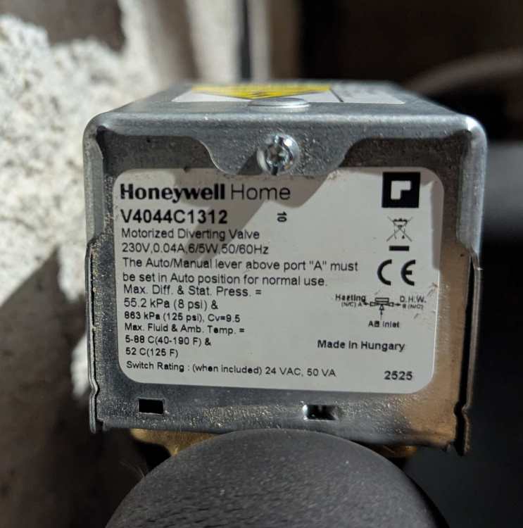

  15. also what 3 way diverter are you running? Maybe this should be changed on mine to, while we are making changes.

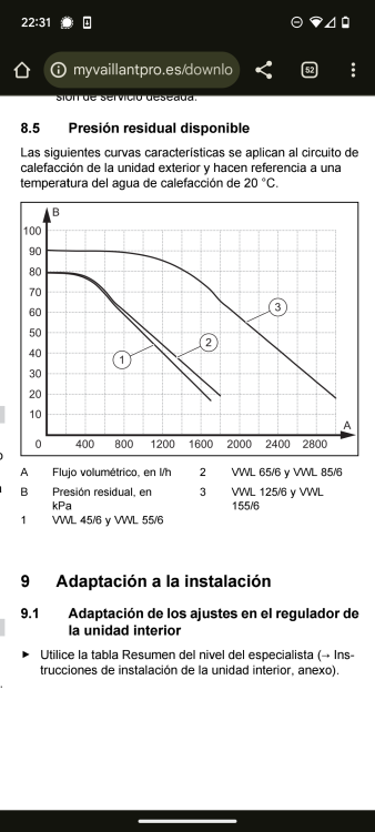

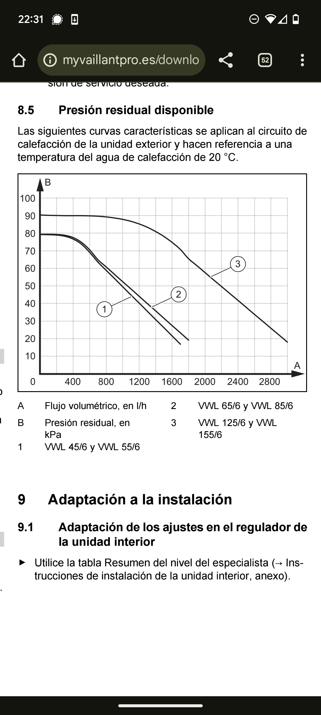

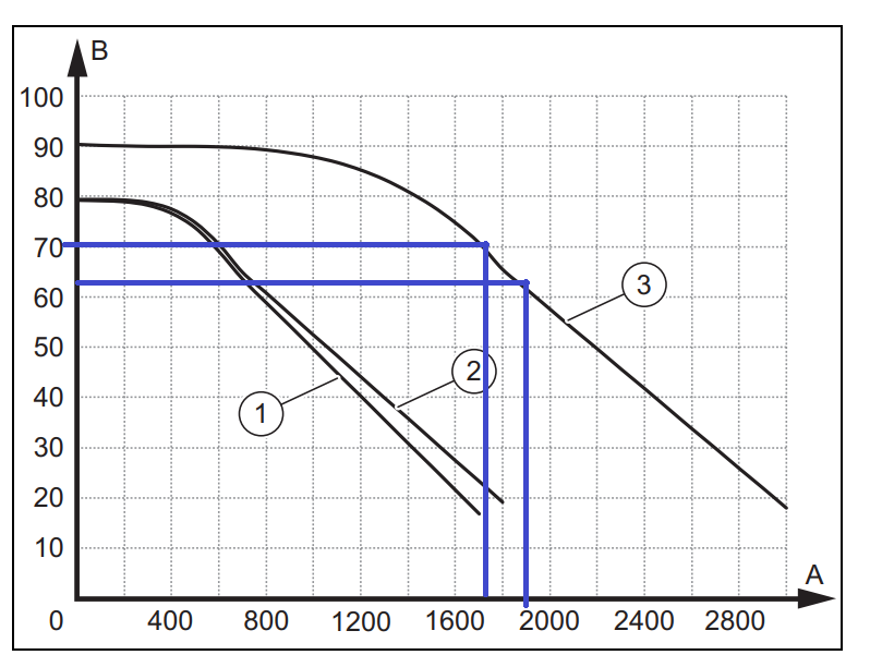

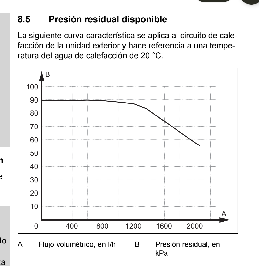

  18. Thanks for the explanation. That's interesting. The graph, which I didn't copy well I re attach. It is 'residual.pressure available'. Page 39 here https://www.vaillant.es/product-images/0020326641-03.pdf.pdf Let me have a think about your point, though I think it would be a case of pushing vaillant to confirm that, after having changed piping. I'm just concerned about pushing the installer to change piping, but not for a buffer, and then still not hitting this magic flow rate. And then having the fit a buffer still, or just not fitting a buffer if we hit a flow rate I deem ok.

  20. Hi, maybe I've made a false assumption, but I read it from the pump graph from vaillant posted above. Flow rate l/h v Residual pressure kPa. Dies it not work like this? If we have flow of X at pump running 100% then it's working against pressure Y?
  21. Can somone point me to a post on how a true buffer tank would work. I'm assuming it just does it exactly the same way as it would without a buffer (running true WC) and then that heated water in the buffer is pushed around the circuit by a secondary pump and then is returned colder which retunes to heatpump. The inefficiency people talk about comes from lost heated water that's mixed in the buffer and secondary pumps. I'm still not sure we would hit the magical 2000l/h from just changing the primaries - it would be close and depend on what losses are incurred by the connections and 90s. At 1750l/h we have a pressure of 70kPa. I calculated the current primary as 11.5kPa and that reduces to 4.5kPa for 32mm internal. Being generous we come to 60kPa which moves is to 1900l/h. This does give a 11kW at delta 5C or 13 at 6. The 15kw machine is capable of 11.3kw at -7C for 45C - so having more flow doesn't seem needed, but perhaps I'm overlooking something. I'm inclined to think a simpler system the better. But maybe I'm making a mole hill and just re plumbing the volumizer we have as a buffer is just ok too. Shame this subject seems to be a bit of a (unnecessary) art and argument on what's best with different experts.

  24. Yes 32mm internal. And again, it's a situation of computer says. He doesn't run a heatpump at home so it's only from what the computer (vaillant training) has told. The installer has said he's happy to change the pipe, though there will be a small cost to me - which seems fair. The issue with 40mm plastic is it's 4m long bars which will need connectors that reduce flow. The alternative is 35mm copper which has full bore connectors. And hope this change is enough to bring the flow rate up and avoid fitting a buffer. My calculations make me feel it will be.
