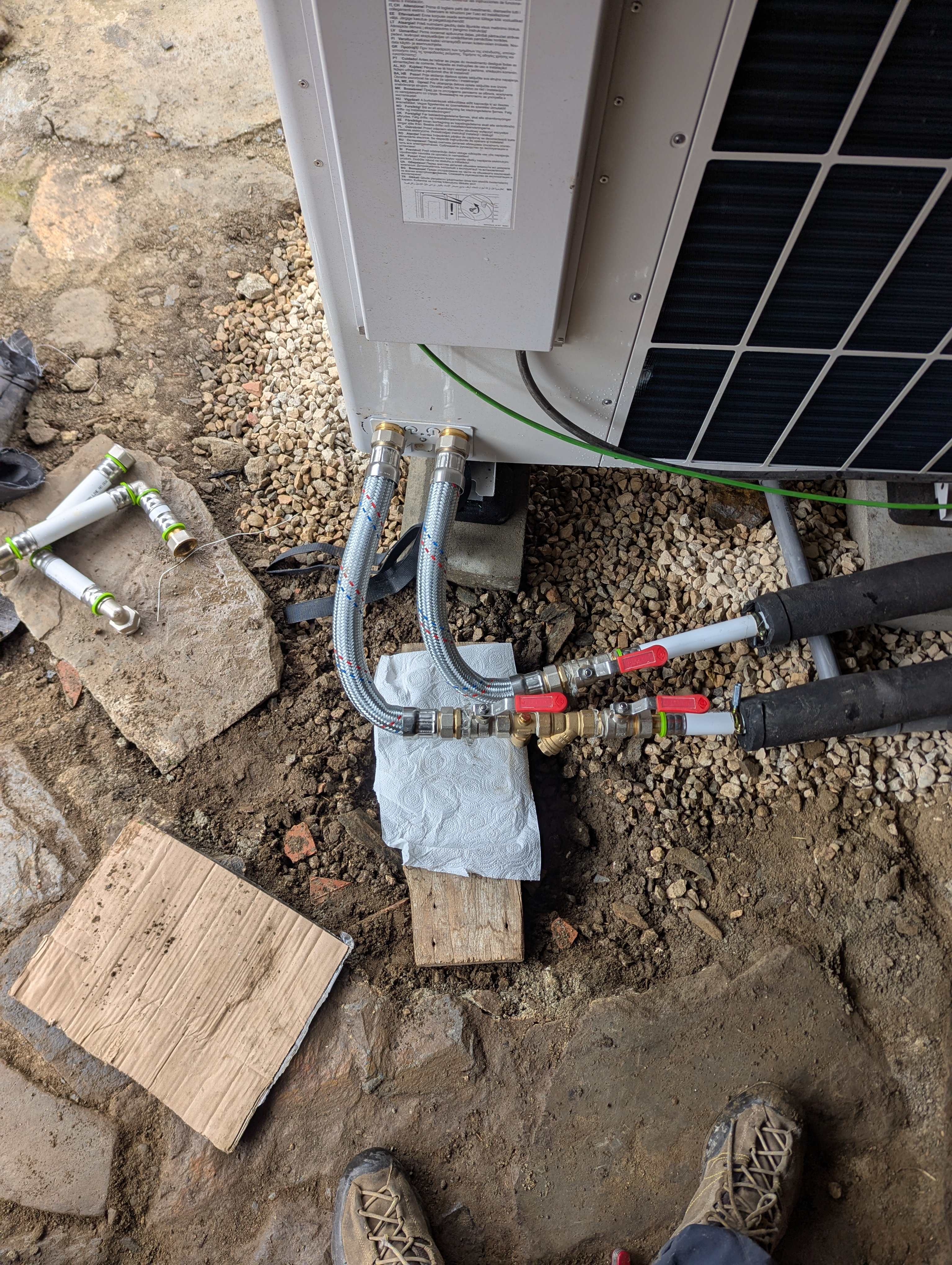

  2. So there hasn't been an update on this as I was hoping the installer would have some decency, sadly they're now a ghost. With it being winter I can't do much. However due to issues with antifreeze being too high and two connections leaking I needed to resolve the situation behind the machine. I took the opportunity to swap the hot mess of 90s to a braided flexi. And as prediction the flow rate went from 1740 to 1860. It's not pretty as the plastic pipe is a bit long but I don't want to drain the whole system to fix it, I'll sort it in the next warm period or properly in summer.

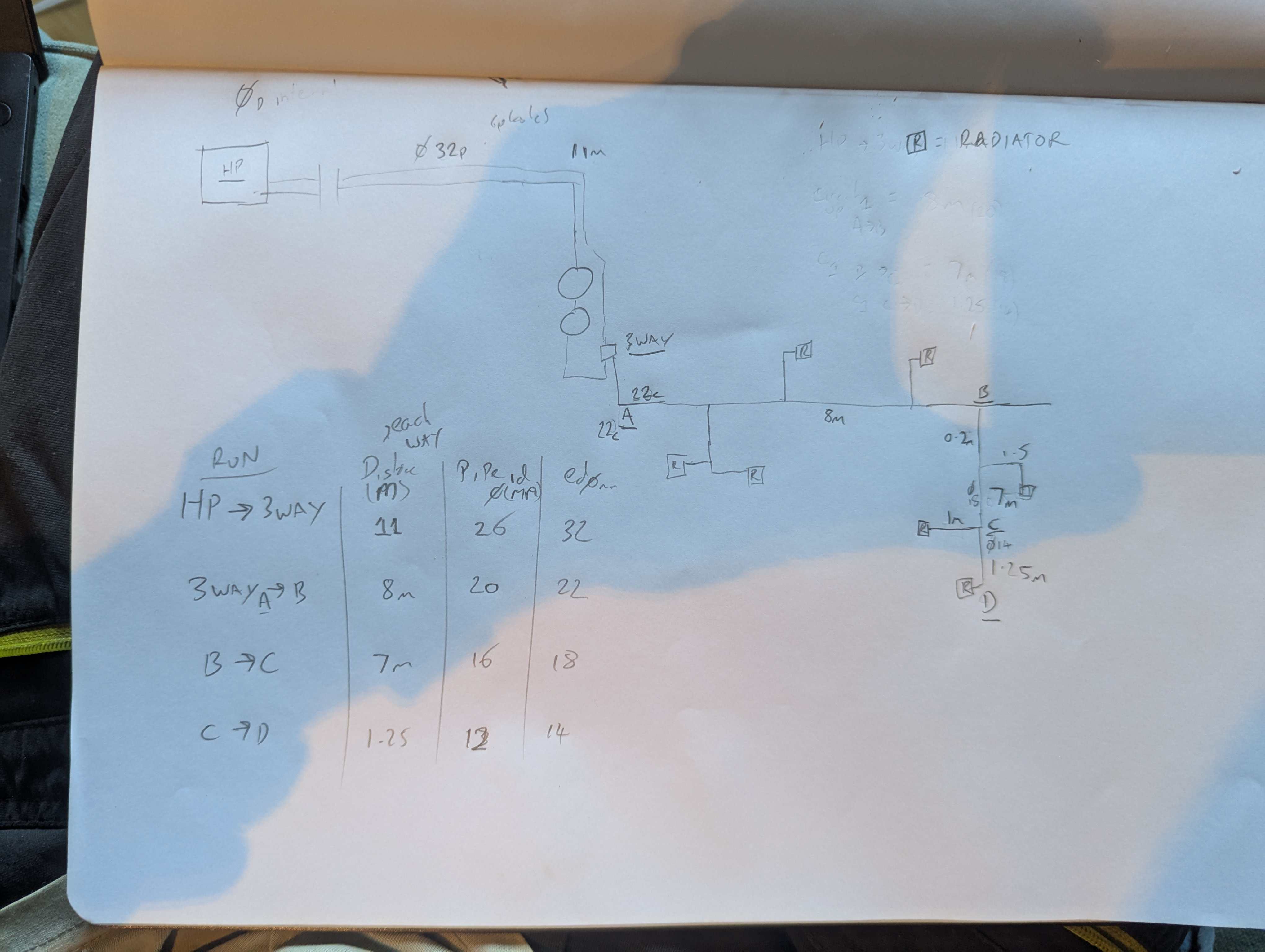

  10. Would you propose using a Flexi to exit the back then? As we need to make a 90deg to enter the building. Perhaps just bend 35mm plastic

  13. Yes okay thanks for your time explaining that. Looking at a DN32 ESBE 3way, the KVs is 16, so (18.5cV) so the pressure drop would be ~ half or 3.5kpa. I'm not sure that's insignificant. If I'm saying moving from 26mm i.d. to 32mm i.d. primary will reduce pressure from 12 to 4.5 kPa, a reduction of 7kPa.

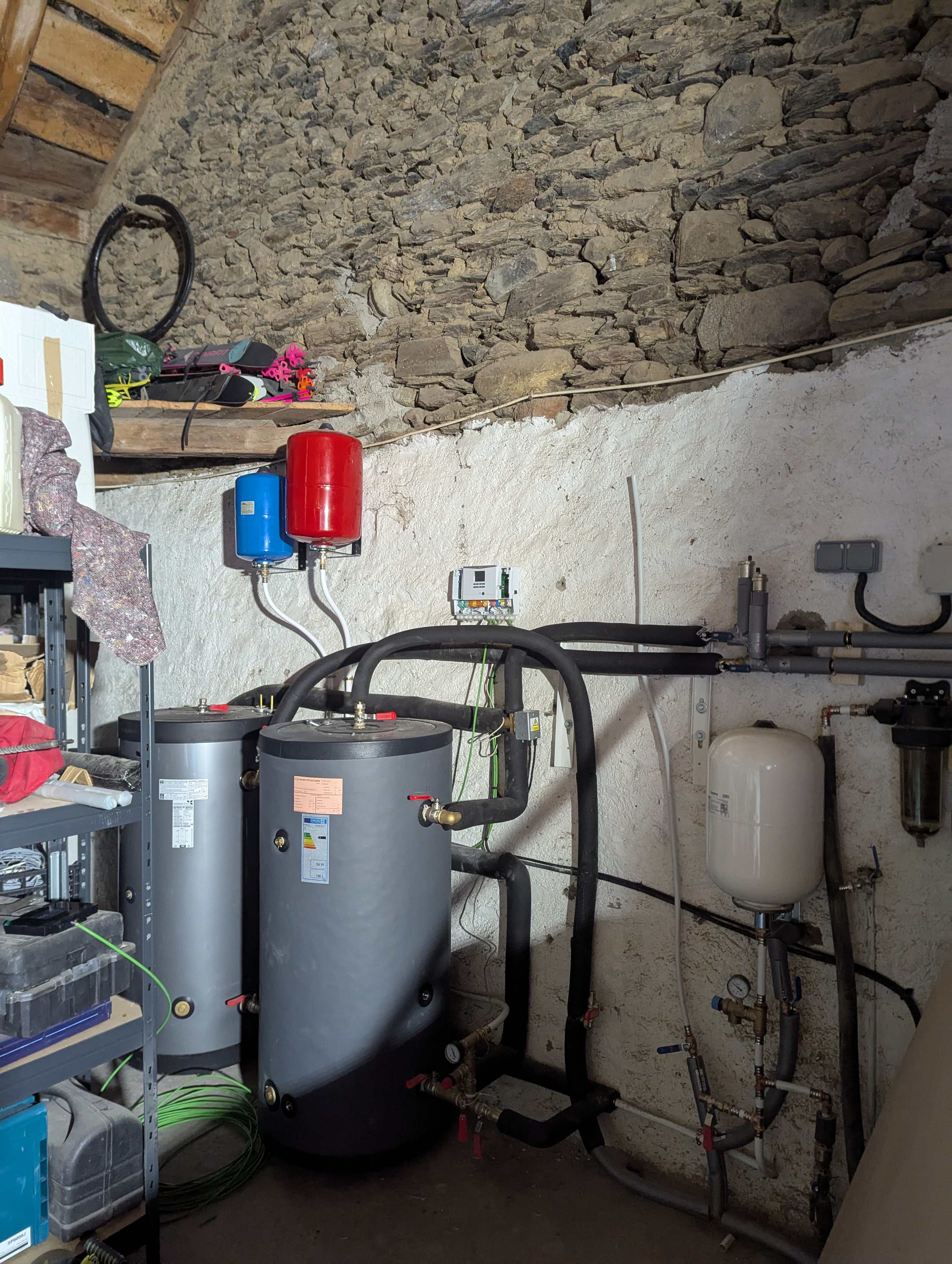

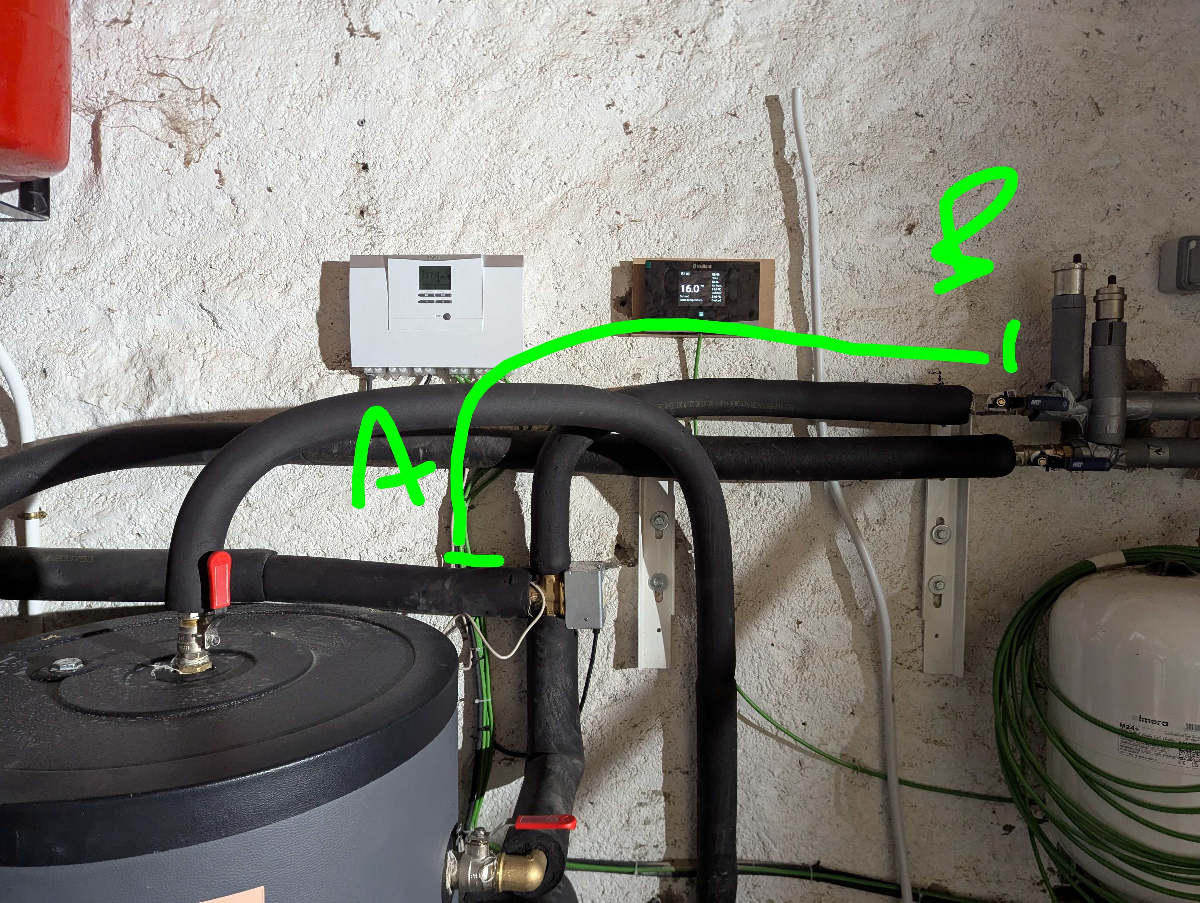

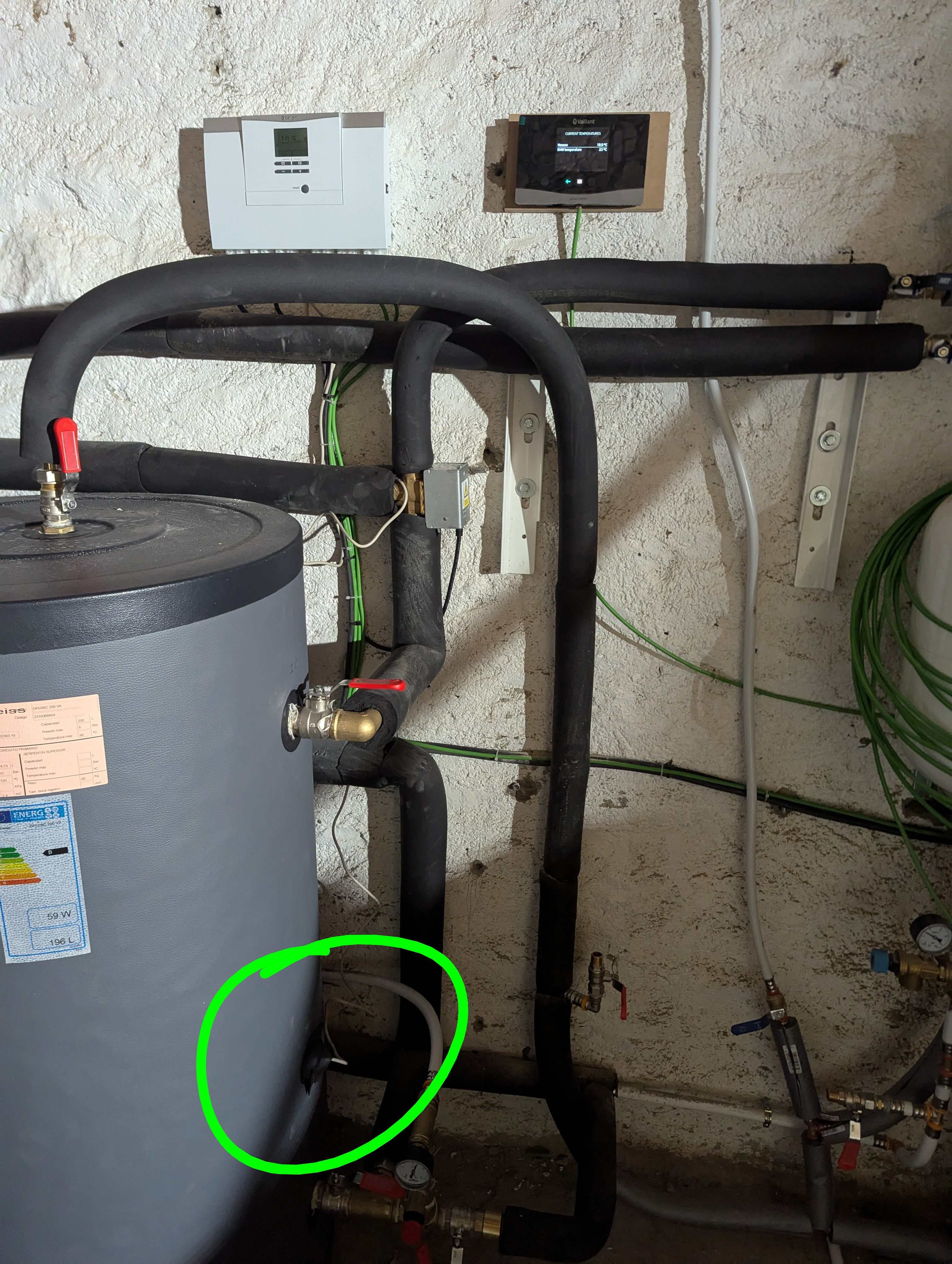

  14. Yes you're right I am. I have seen others mention using bigger 3ways for bigger pipe. I just wondered if it's better the change what's possible, while there changing pipe, than then try come back later and do it. I'm going around on all aspects to decide what I request is changed and what can stay. Because if we change some stuff and can't hit near 2000 then I'm going to annoy the installer - who just wanted to put a buffer in in the first place (but fitted as volumizer on request), so I'd rather get it right second time and hit as needed.
  15. also what 3 way diverter are you running? Maybe this should be changed on mine to, while we are making changes.
