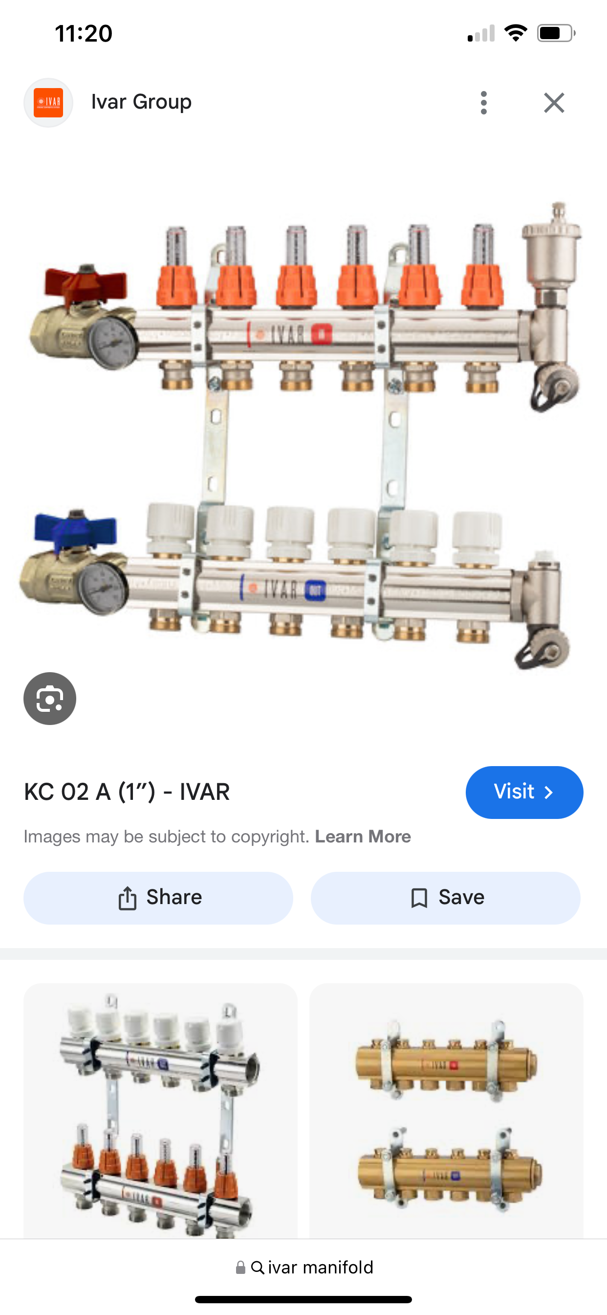

ASHP UFH manifold flow meter setting help
MechanicalBuilder replied to MechanicalBuilder's topic in Underfloor Heating
I’ve got the WDC down to ask for 28’c but the ASHP won’t modulate lower than 30’c which is fine but it’s overheating the house -
My concern here is if I turn it down any more I’ll have little to no flow on the flow meters, I think the shorter loops are already down to 0.6l/m. are you suggesting minuscule adjustments as in 1/4 or 8th turn. It’s an ivar manifold similar to the pic -
The HP is a daikin edlv08 for reference -
Hi John, thanks for the reply The manifold is connected directly to the HP with no buffer, mixer or pump. I have room thermostats but I’m not using them. I have the LWT controlling the HP and it’s now modulating using the WDC which has it running more efficiently than it ever has before! -
Hi, im after some help setting my UFH manifold. The plumber set all my actuators wide open even though I have varying loop lengths (1 is 60m, a couple are 90 and the remaining 100m-ish) is there a rule of thumb for adjusting the flow meters? Had a mate come over and adjust them using a calculation given by the ufh installer but he then readjusted them using pipe clamps to try and get a difference of 5’c. ive a feeling they still aren’t right!
