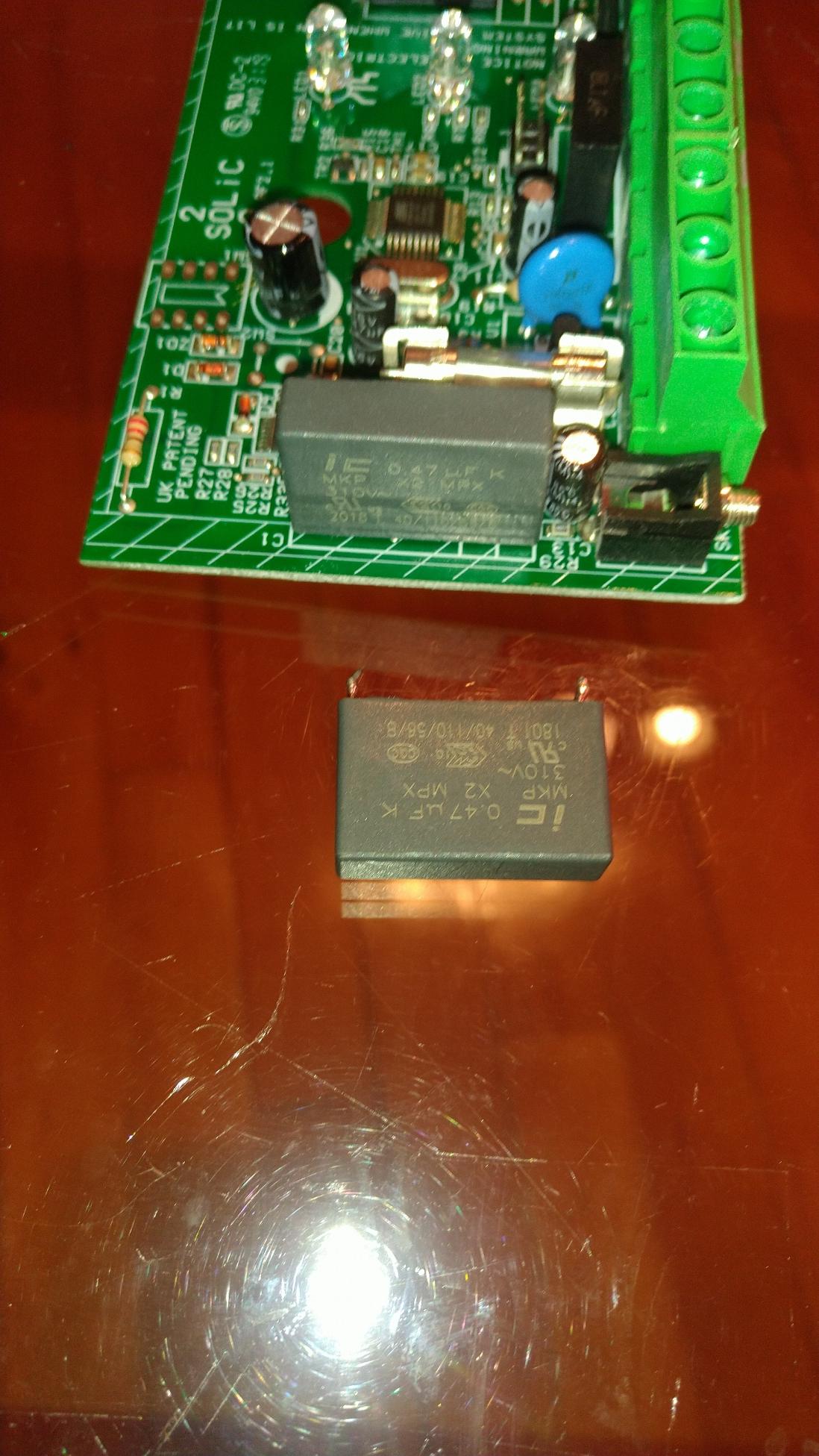

  1. btw , use a new capacitor , only if electrician have the possibility to measure the capacity use old one! is cheap...
  2. please , ask your electrician to use non polarized capacitor 0.47 micro farad( this value is compulsory) minimum 300vac voltage! if use bigger capacity can burn the board , if is less you can have same problem as now! good luck
  3. change the capacitor and will work !
  4. very easy https://www.youtube.com/watch?v=XUp6x9dvZOA
  5. I measured the capacities of the 2 capacitors, of the 2 solic 200, the normal capacity( marked on the capacitor housing) is 470 nf (0,47 uf) , I got 198 nf for one and 220 nf for the second one (as I said, I have 2 solic 200)! I don't think it's about saving money, I paid for a quality capacitor (epcos) under 1 euro .Also 310vac is ok I think the quality of the capacitors used is poor or they have an old production date In any case, it is not very important, the important thing is that the problem can be solved cheaply. It is a capacitor that can be bought without problems from a local store, specialized in electronic components
