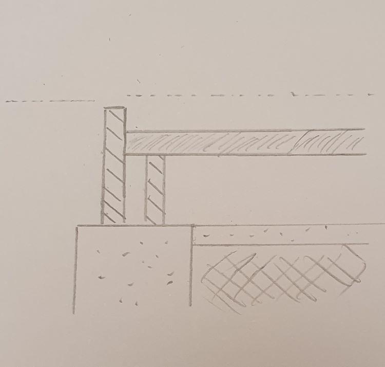

	There's no DPC and the floor blocks and beam ends are tight to the outer wall. I cannot be sure but I do not believe it was as a designed kit.
	Thanks for the replies. It's not quite as much of a concern as I had first thought. I anticipate the DPC layer to be between the blocks and insulation. The PIR wall insulation technical doc advises to take it down to the bottom of the beams for this type of construction. Though with no cavity left at the door openings, the perimeter can have no more than the 120mm planned floor insulation depth below its top. Though it can go lower other than at the door openings.

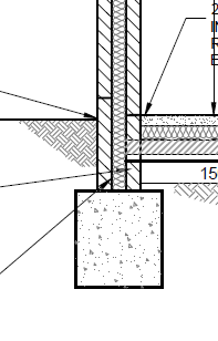

	I'm not sure exactly which would be the right sub forum but hopefully this is the right one. Though I'm not posting in the insulation board to avoid a biased answer. I'm having an extension built with construction details and thermal standards to be broadly the same as the newish build existing house. The beam and block floor has just been put down, but it is unlike any drawing I have seen where the door openings are to go. My construction drawings do not detail the openings, but match to what I would expect in that the ends of the beams and blocks go as far the edge of the inner block where it meets the cavity. For the sliding door openings, as built the beams and blocks have completely bridged the cavity. This bothers me that it might not be right and leave me with a thermal bridging problem. This is compounded by having no insulation in the cavity at or below the beam/block level. I have attached the drawings and a sketch of what has been built so far. The dotted lines will be finished floor level and patio outside. Note that DPC level for walls started already is higher up than that line as required. Am I right in being concerned about what has been laid? If not right, is it just not best practice, or is it something building control would be unhappy about?
