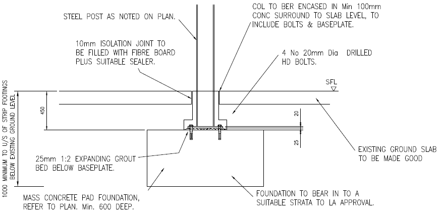

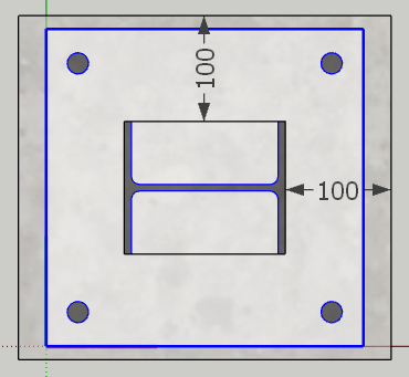

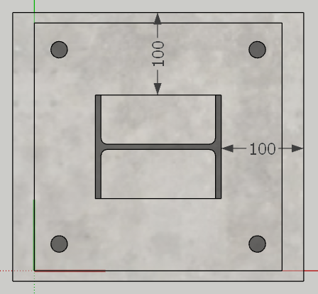

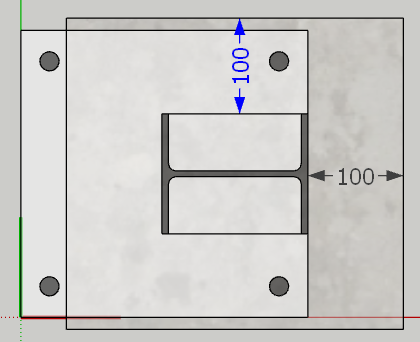

My engineer has stated the following on our drawing "COL TO BER ENCASED IN Min 100mm CONC SURROUND TO SLAB LEVEL, TO INCLUDE BOLTS & BASEPLATE." along with i am trying to understand what is meant by "100mm CONC SURROUND TO SLAB LEVEL" is it that the concrete should project 100mm from every edge of the beam like and in the case of an offset column like The reason for my confusion is that the drawing does not seem to illustrate such a mass around the column and foot , making me thick I am misunderstanding. Thank you
