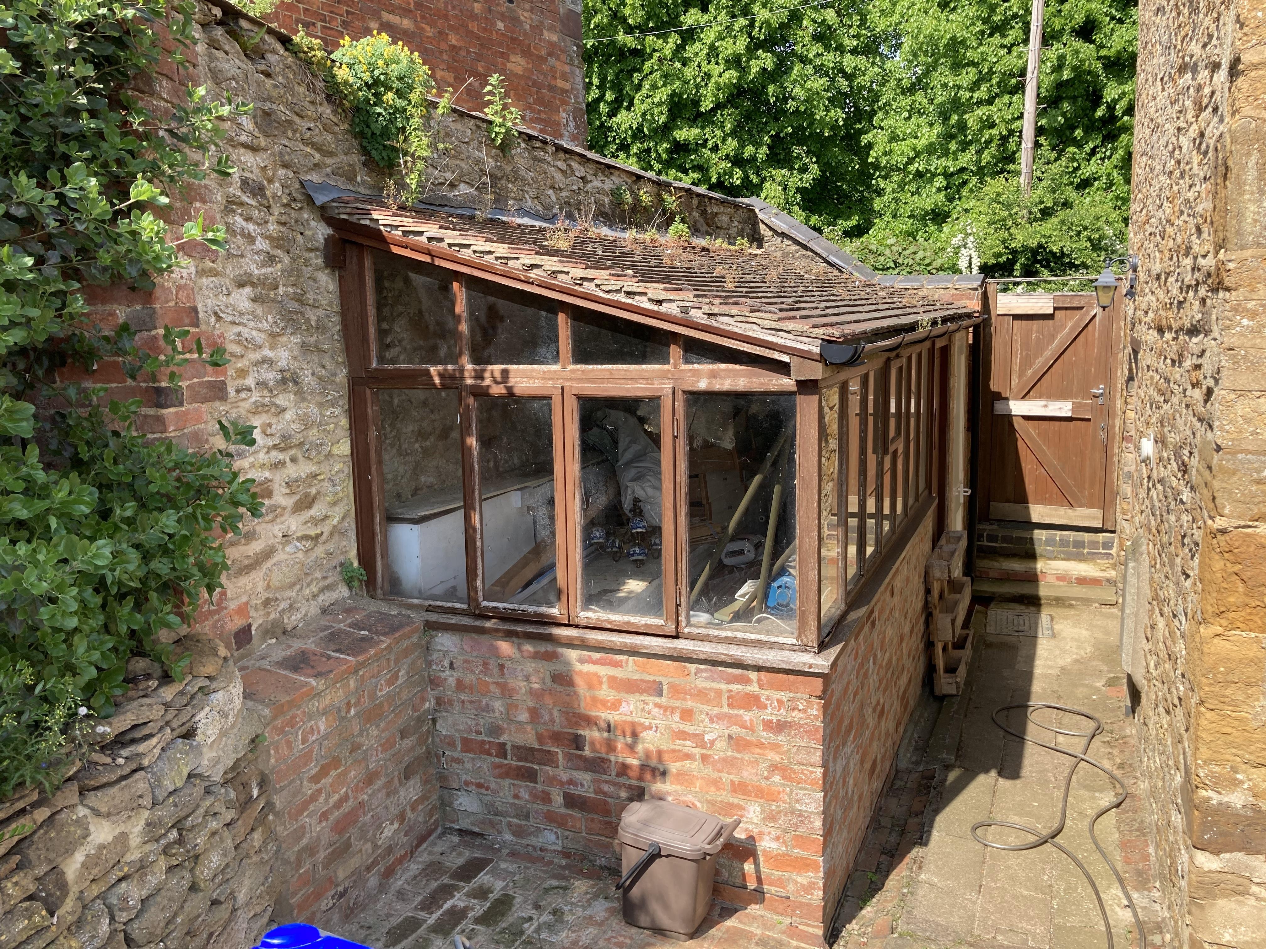

  1. Hi, I have an outdoor toilet with double skin wall and cavity, it has tiles directly on concrete floor and used to have a door. Attached was a outhouse shed which I've converted into an office and then cut through into the toilet and blocked up the old toilet door. The office has it's own door too, so now there is a cold damp toilet and separate office which is fully insulated and warm (thus far). That's on the context. The issue is the toilet has dirt up the side where it meets party wall and after rain it's ingressing the bottom per picture. 1. Is it worth putting a water proof paint on there walls? As I cannot fix the source of the issue, so it's just a case of preventing the ingress. I put in a new (cheap) sink stand as there wasn't a sink before (attached where door was), as this is sat on the cold floor and there is no heating in the toilet, it's covered in mould already, however the wooden shelves that have always been in there are not mouldy (above toilet). 2. Is this a wood/cheap issue? Where it's just got a high moisture content? Or am I supposed to be putting a heat source in there? or dehumidifier? I have insulated the old door and insulated the roof. Thanks

  7. I have an existing lean to that is leaking through the underfelt. It’s tiled well but I suspect there isn’t enough fall. I was hoping to remove all tiles, felt and battens and squeeze in a warm roof without changing the existing lead flashing and existing roof joists. I was hoping to fit 11mm osb directly to joists then 50mm PIR and then another 11mm osb with a final corrugated metal roof with a underfelt (drip stop) for condensation control. Does this sound viable? Would you screw the metal sheet roof all the way through the warm roof to the joists to sandwich altogether or would this compromise the warm roof? How does all the above fix without compromising the warm roof?
