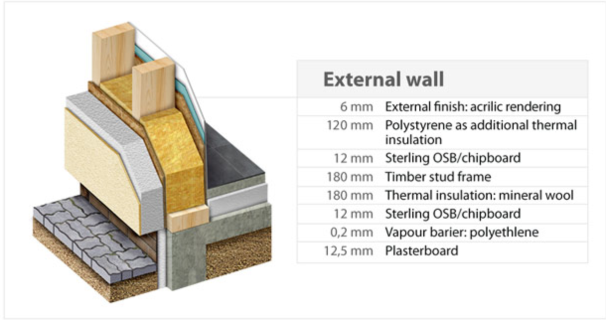

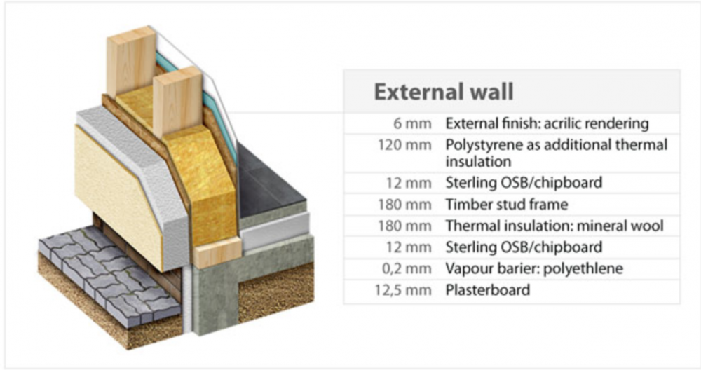

  8. Hi there thanks for your reply, no they didn't but I was planning to ask them what their system is for when they do the cladding, so I could pass this information on to whoever we choose to clad it. My main concern is not to jeopardise the high level of insulation performance the kit house offers when we clad. The kit house company are not happy about us undertaking it ourselves as it could void our warranty but we don't really have option. re: how far into the build we are - currently doing final tweaks to the house design.
  9. We are going with a company called Dan wood attached is their wall build up which is their standard base package finish. They were going to charge £17k for a Siberian Larch clad , but due to our ground works coming in more expensive than anticipated we had to strip the cladding off in order to have funds for the ground works. With the view of cladding the build ourselves in accordance with with our planning once we save enough money to do so, hence reverting to their base render option. We are totally new to all this so any help or advice would be incredibly welcome! thanks Oliver
