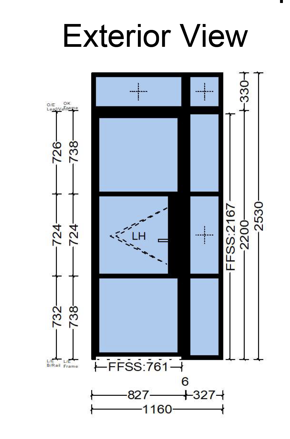

Completed a self build around 4 years ago - very open plan but finally concluded we need some internal doors for sound proofing we are yorkshire based, can anyone recommend cost effective supplier for bespoke internal aluminum doors - I've enquired with marlin but cost came in at £1.8k just for one door. Looking for spec as below , any advice welcome

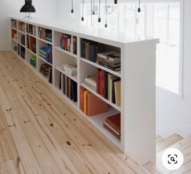

hi guys im putting a bookcase balustrade on the landing on my new build (similar to attached) I just wanted to ensure i've read building regs correctly and that it needs to be a min height of 900mm? thanks in advance
