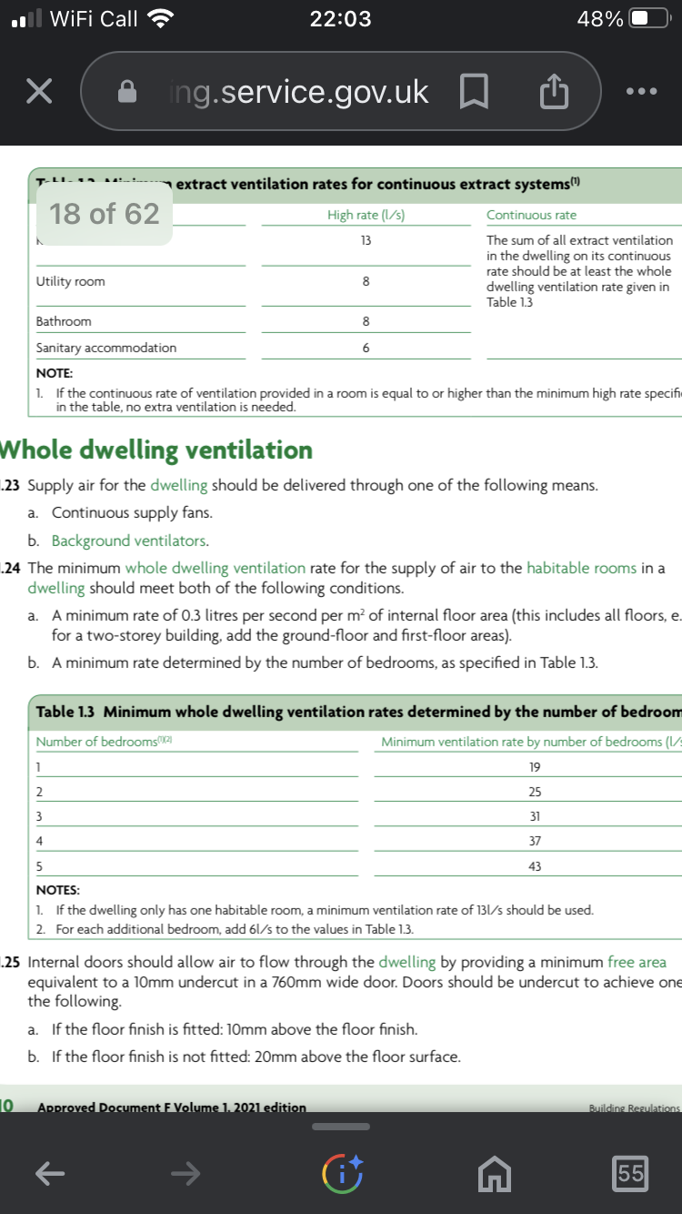

Document F are these rates correct?

Little 3 bed terraced diwnstairs 2 rooms and kitchen and bathroom I’d say 60 sq metres? Not massive, 3x5 m rooms x 3x3 bathroom and add a few for hallways etc -

213 volume of house, 2 extract rooms 4 supply rooms -

What should it be for mvhr for whole house? -

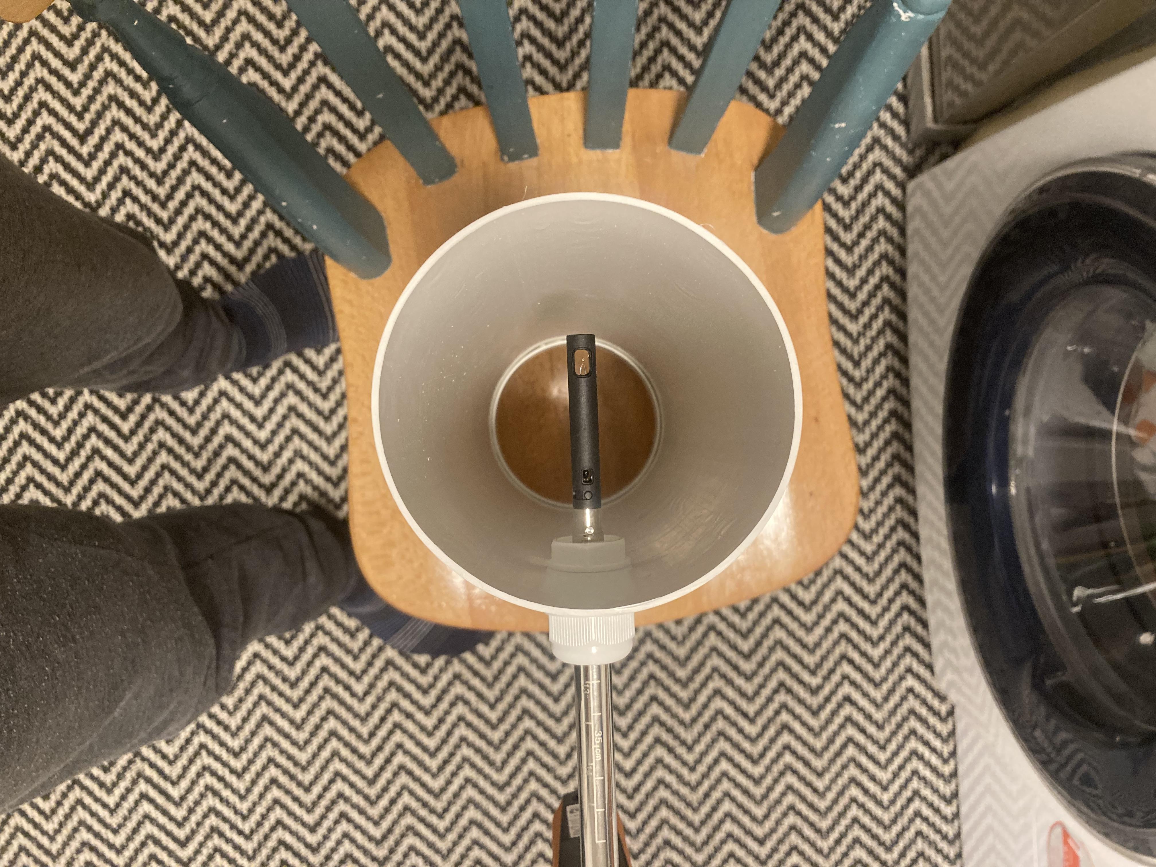

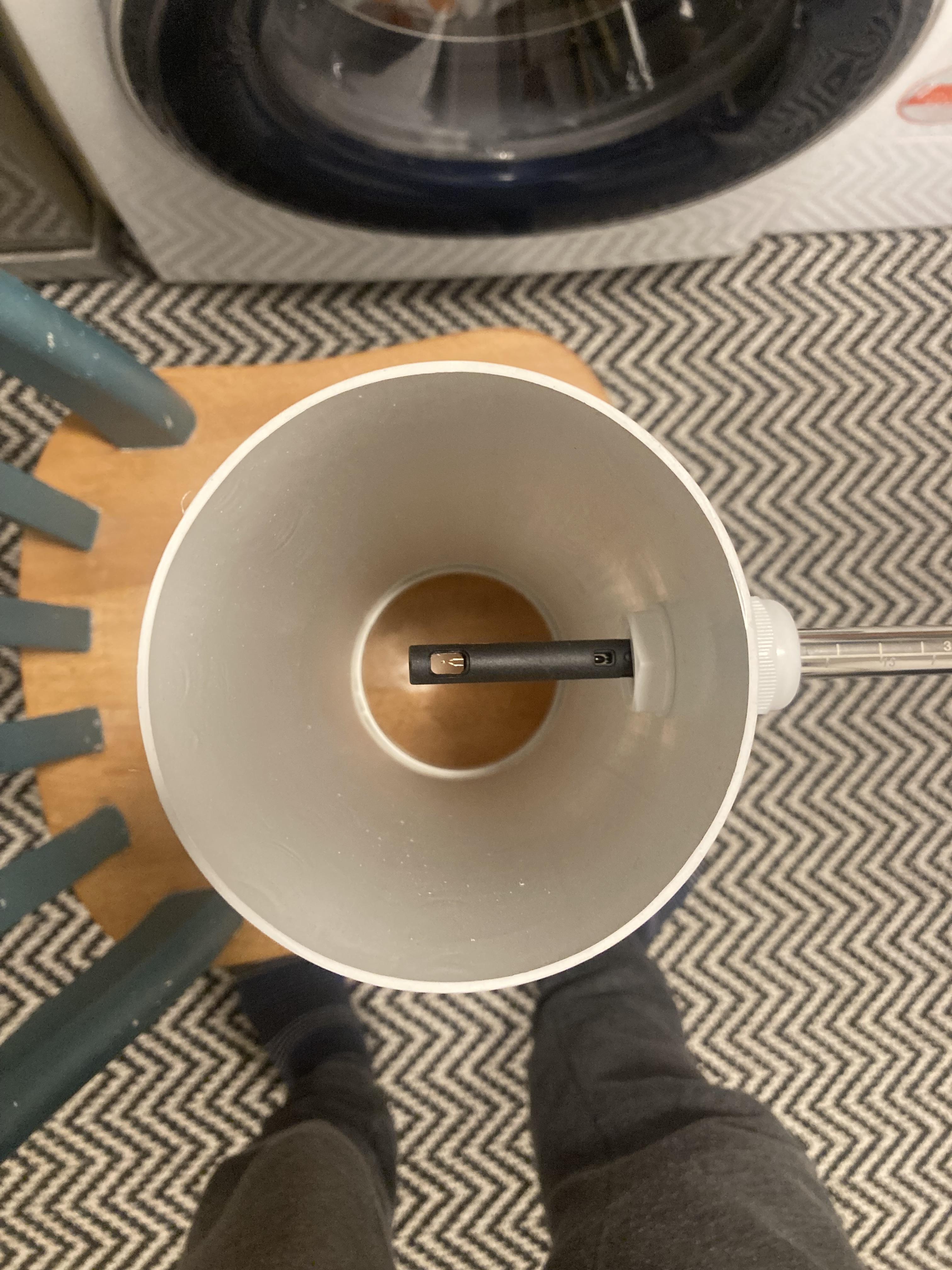

Testo 405i setup
Deniance replied to Deniance's topic in Mechanical Ventilation with Heat Recovery (MVHR)
These are the 2 positions I used, one gives 21 l/s and the horizontal one gives 25 l/s and it’s repeatable I went for the lower one in the end as it made the machine a tiny bit quieter when running -

My Brookvent unit is push fit when it leaves the unit, so I can wiggle the bit of flexi duct out revealing the hole , I then pop a 300mm piece of 125mm pipe in there that has a stuffing gland for the probe , so this is air produced by the unit after the filter , I can’t do the same for the extract as it’s too tight, but tonight I will go outside to the exhaust and measure that as that will be after the filter , this way I can get both supply and exhaust direct at the machine after filters and get them super balanced! The exhaust is straight out the wall after the machine so is as short as possible -

Glad you’ve said that because it’s driving me mad, been up and down stairs about a million times!! I’ll give it one more go later the pulling the probe back a few mm really does put the values up though if I put it in centre of duct with the damping settings on the testo you can get a stable reading, and if you pull it back about 15mm which makes one sensor close to the edge and one sensor dead centre you get a higher reading and that is also stable -

Yeah that photo is wrong, I’ve spun the duct so probe is further away from the action so to speak, it gives more stable readings further away I’ll give it another go tomorrow if I get time , I watched a video where a guy measured a 16 inch duct and takes readings a few times as he pulls the probe out then takes averages, so maybe that’s what I got to do even though it’s only in a 100mm duct -

So managed to get some time today to fiddle with the flow rates charged phone, new batteries in testo took the supply to the house off and put probe and piece of duct into the mvhr and managed to get the unit to feed 20.8 l/s, so then I went to the 4 supply grilles and managed to get each one equal except they totalled 22l/s! I was expecting less as you should lose some to the ducting and the length of ducting? so I repeated it again and same result, slightly higher total of all grilles compared to why the unit is producing but then I discovered that the flow rate differs if you move the probe inside the duct! so I had the probe set in the middle of the duct, but if you pull the probe out until one of the little sensors is close to the edge of the duct the readings change a lot! so centre of duct I got 20.8 just off centre I was getting near 25! but head is scrambled now, don’t know what one is right or whether to measure both and take an average!? -
