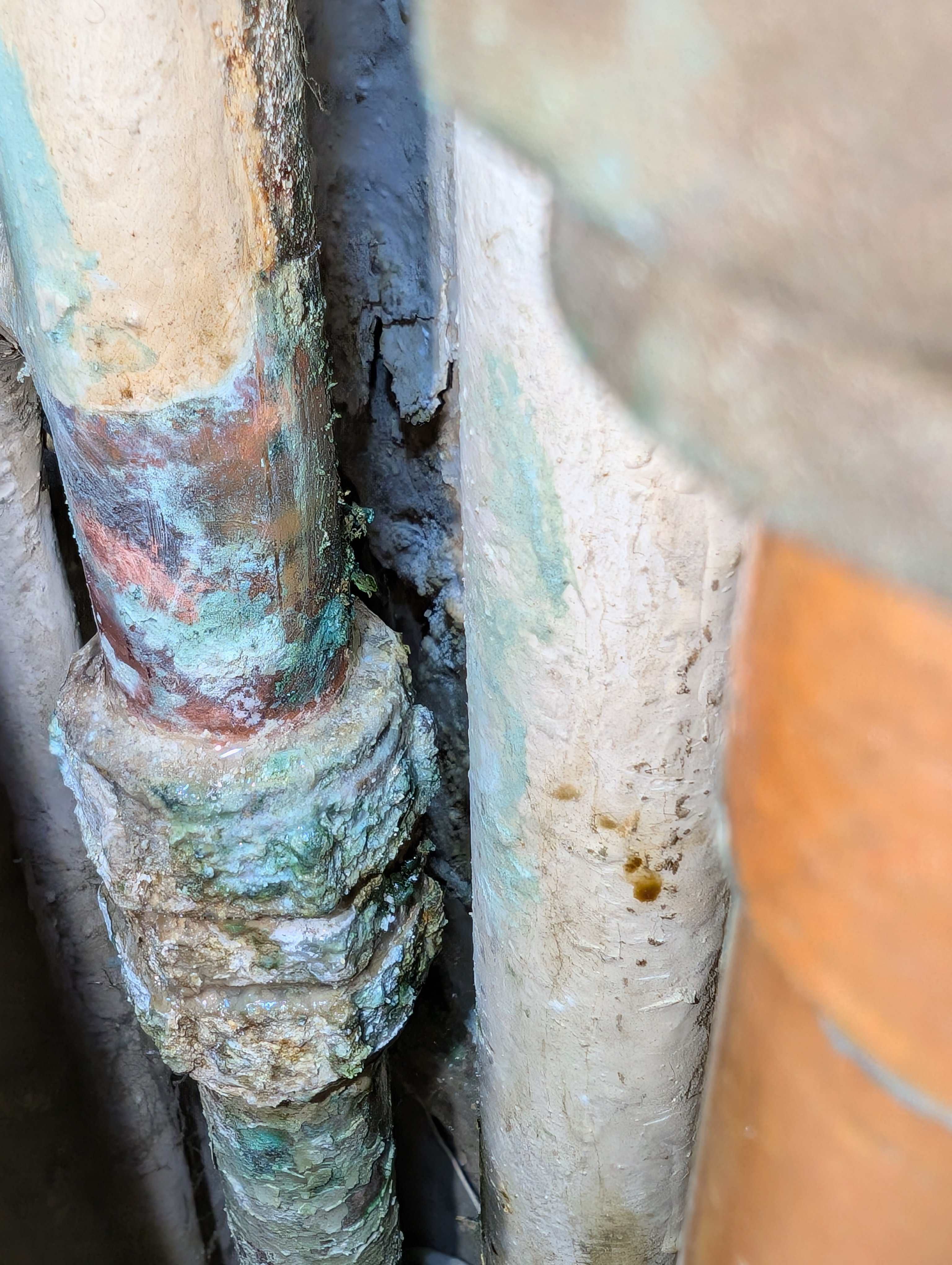

  5. Hello all This joint is leaking and looks like it's done so for a while now. As a result the actuator below it keeps sending mixed signals to the boiler! My question is what causes this? Is it just a badly made original joint/pipe vibrations loosening it or is it the dielectric or brass to copper that is causing an eventual failure (it's possibly been in situ for 50 years now). I think it is the heating flow. I'm planning to hunt for a shut off valve, cut the area out, replace the T (the small pipe behind feeds a radiator in a bathroom behind the wall) and replace with a 15mm coming off the main 22 so that I can add another radiator on the same spur; and replace with soldered connections everywhere It's not great access though! If this is the hot water line (I should know but I don't yet) then it's just replace like for like but with soldered connections. All (on topic) advice welcome!
