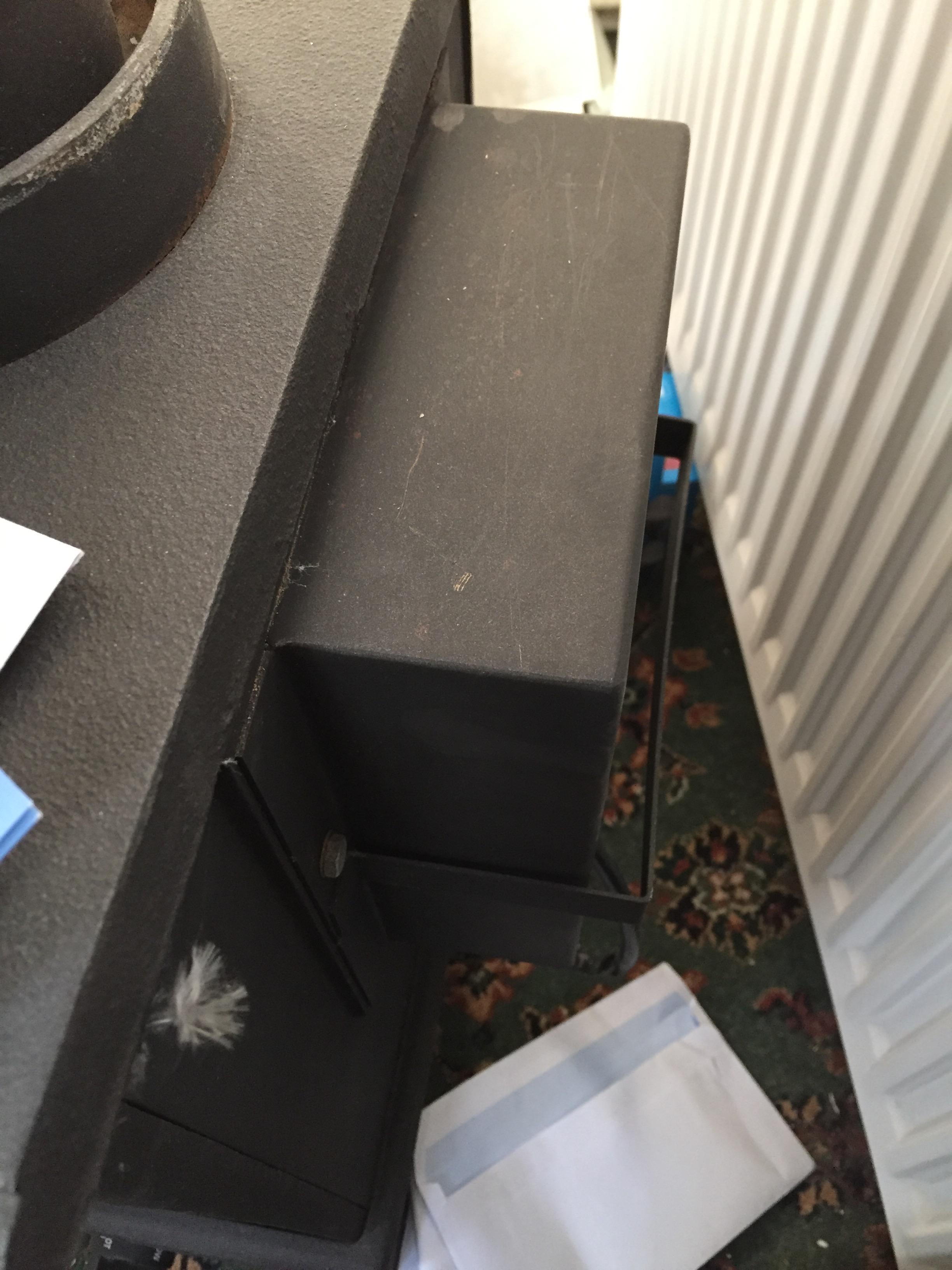

  4. Great, thanks for the link! I guess it can't be removed :).

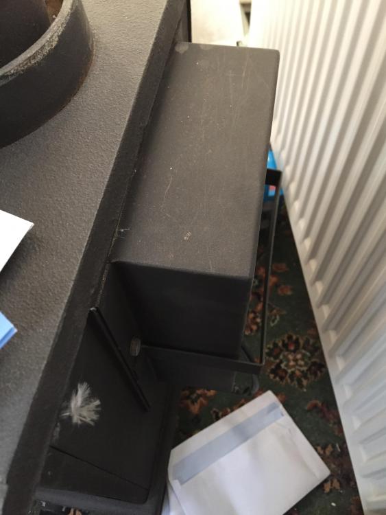

  5. Hi All, I have just picked up a Firefox 5 Gas stove. I will be having it installed by a gas engineer but I am preparing the fireplace myself. I took the old fireplace out and am straightening up the brickwork on the sides to fit lining and a new hearthstone. Round the back of the stove, there is a metal box bolted on. There is what looks like a cable connected to it but there doesn't seem to be anything inside the box section itself. Does anyone know what this is and if it can be removed? If it can be removed I can put the fireplace further back inside the chimney so it does not stick out the front as much. Any help would be appreciated. I have attached a picture of the box.
